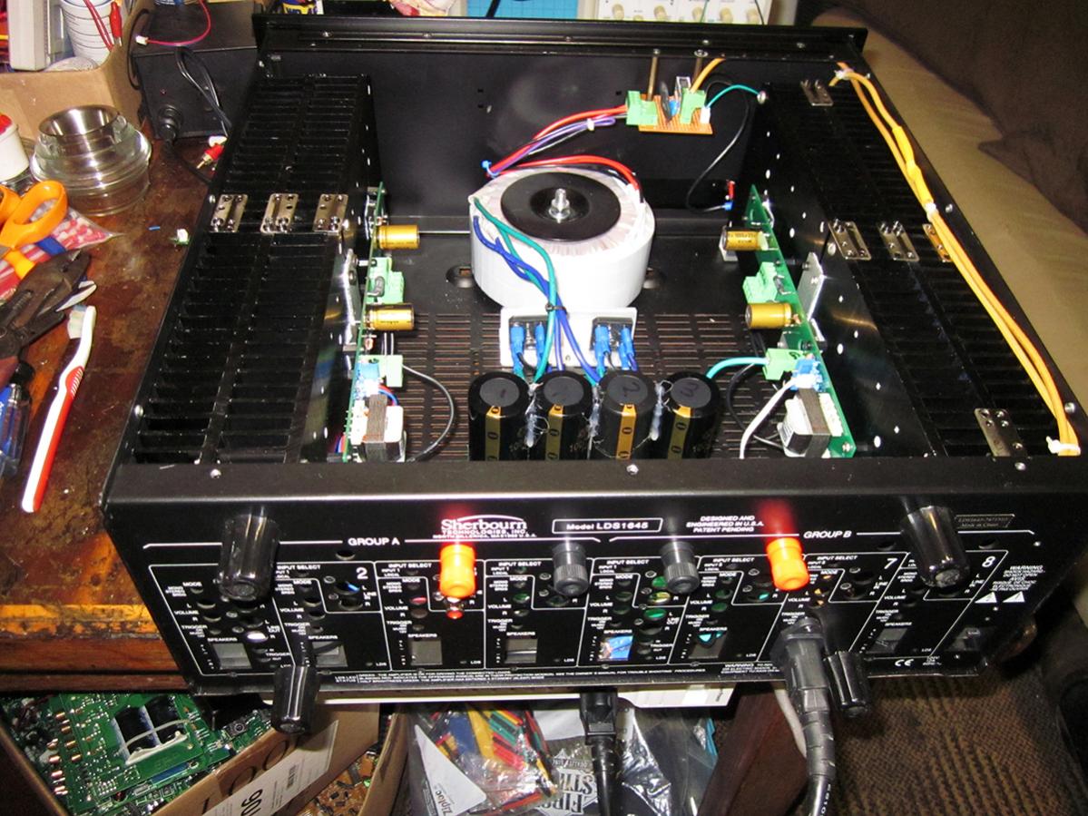

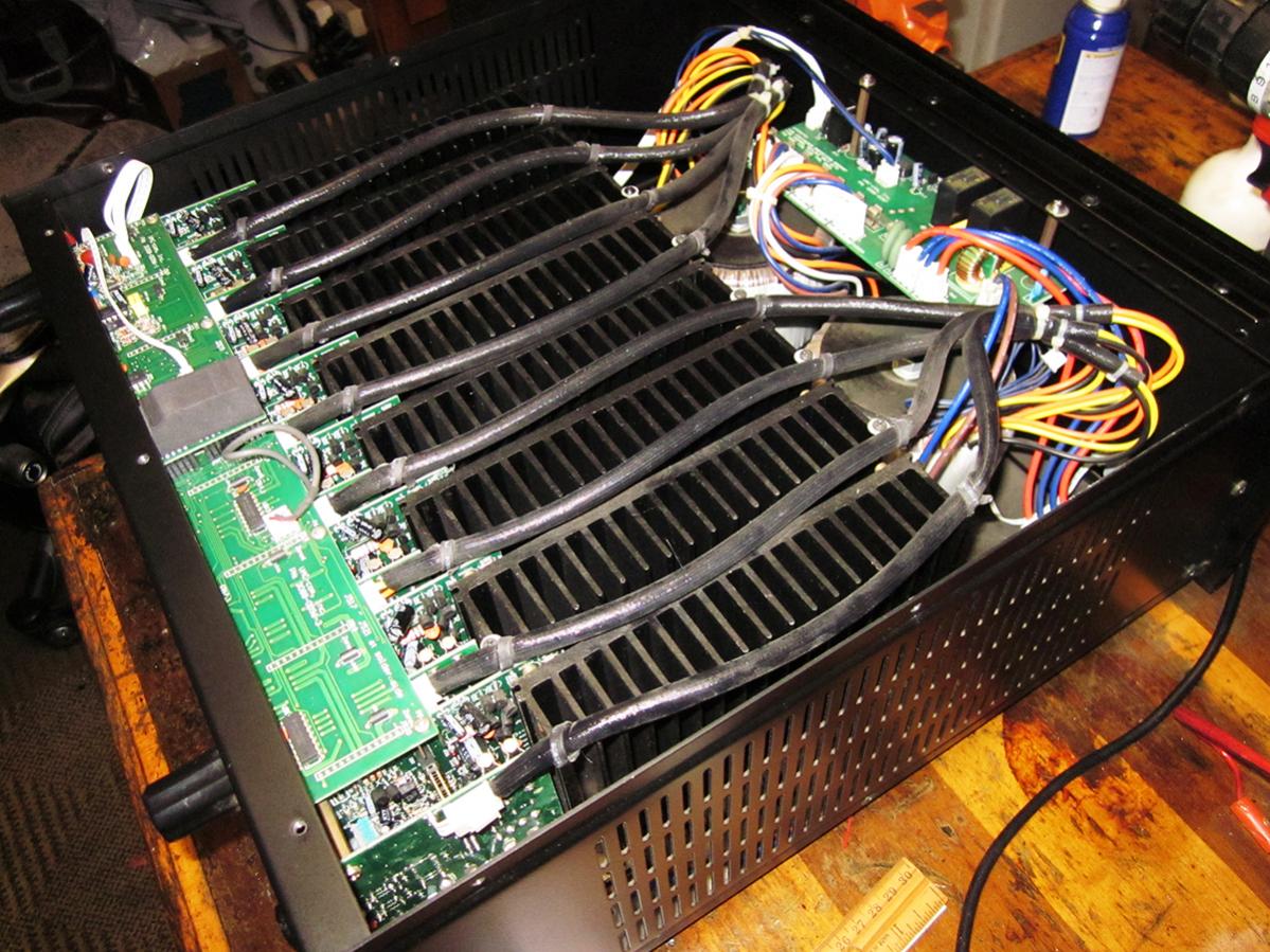

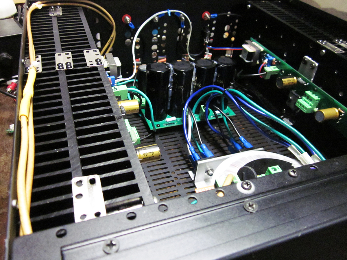

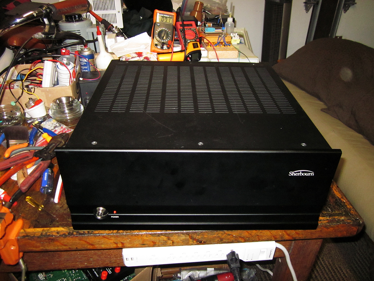

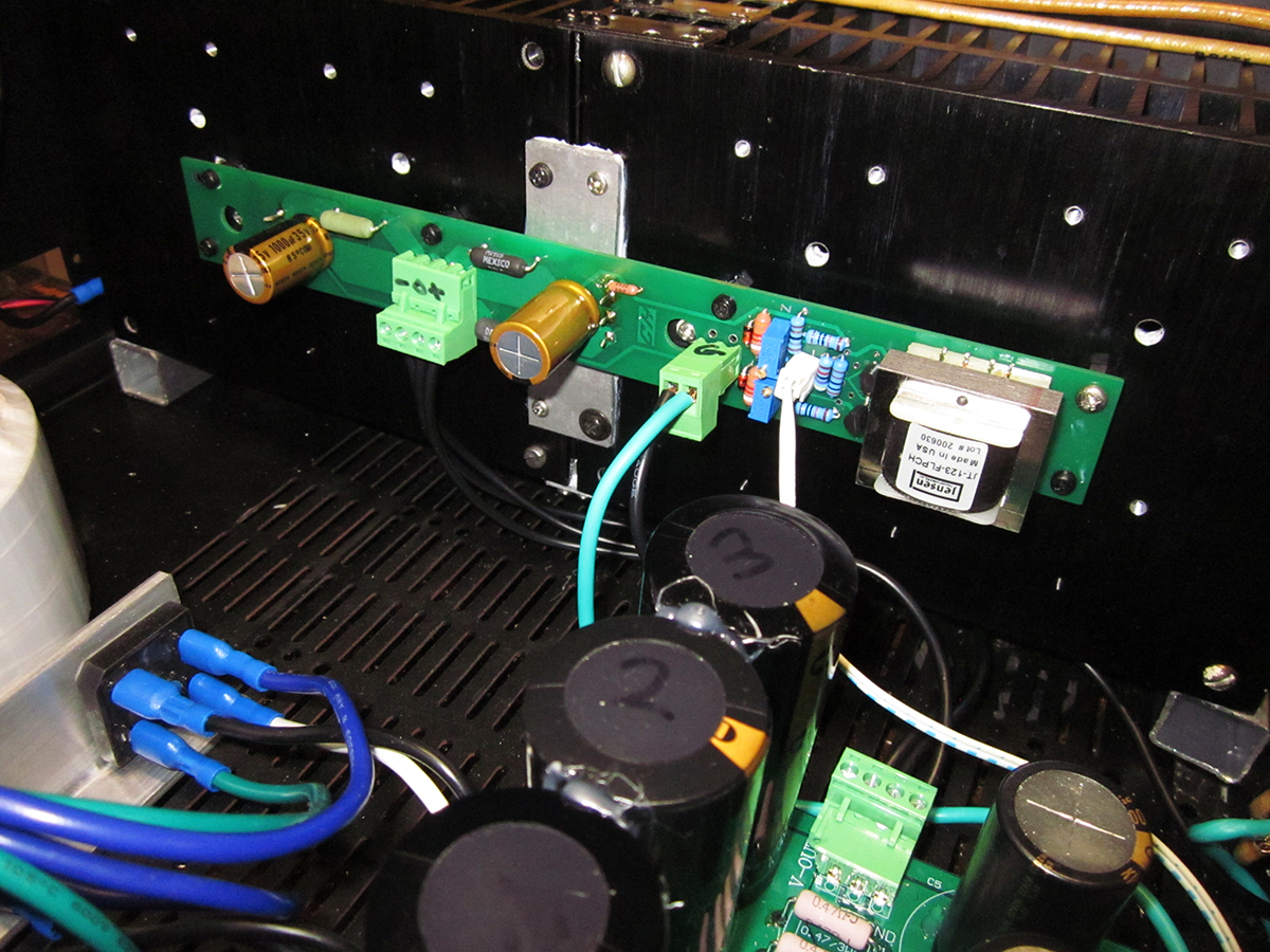

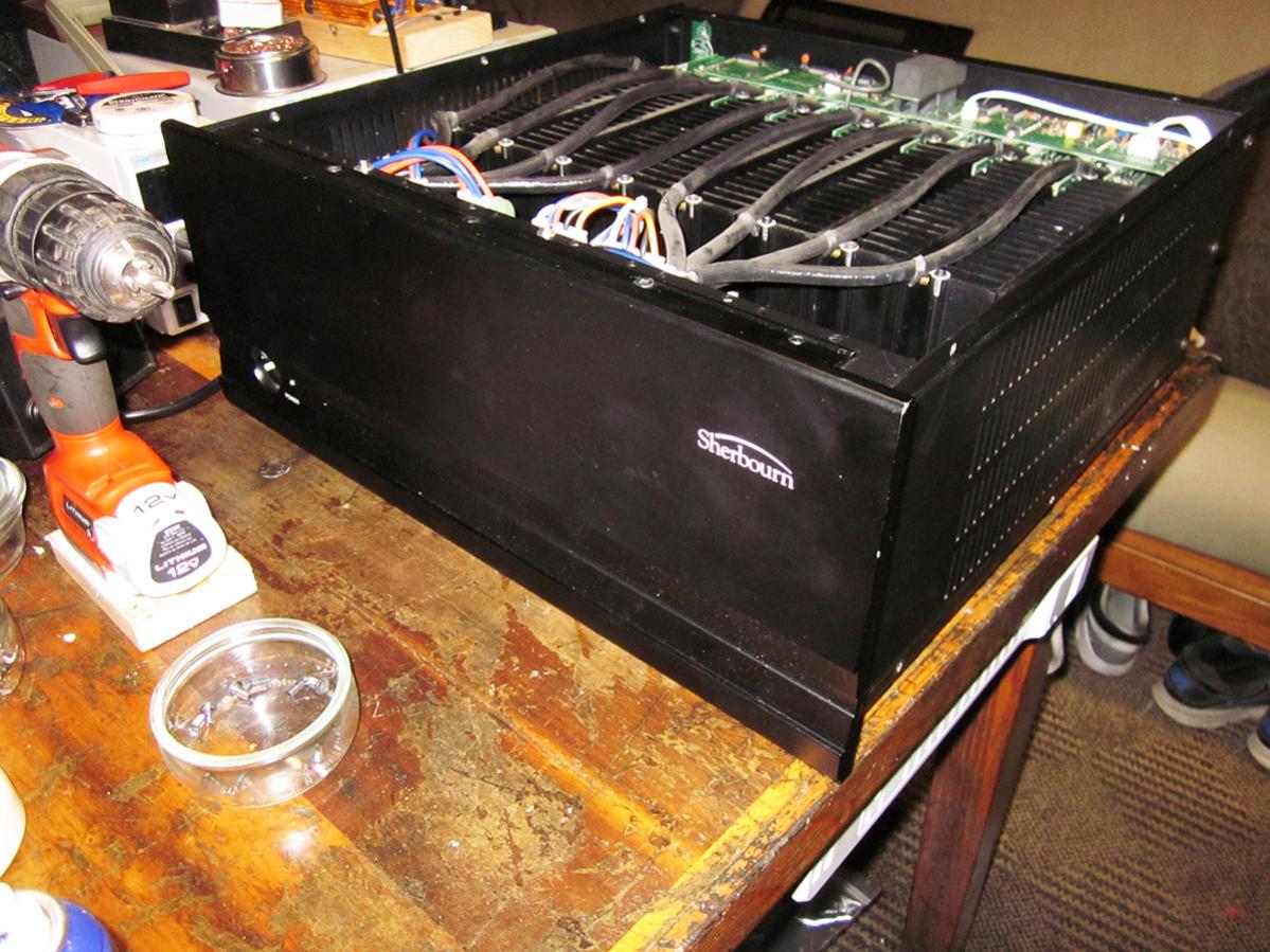

Repurposed a multichannel tank for a first watt build
I bought a broken sherbourn 16 channel amp ($35 craigslist) and repurposed it for a F6. I was able to reuse the heatsinks by bolting them together and coupling with bits of aluminum. It's very heavy duty. I downloaded the gerber files for the amp board from pcbway and had them made at JLC.
