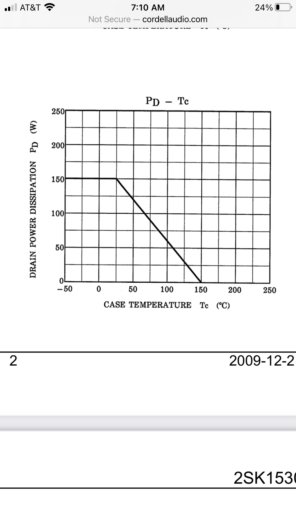

Today,I had time to change irfp240 to 2sk1530
with 0.22ohm.
Thanks picoDumbs instructions.
2sk1530 leg was easily snapped so I connected with copper wire.
Sound is more softer and I really like this sound.

Thank you.Tamra, watch your bias...temp on that zister is tough.
1.6A seems fine.

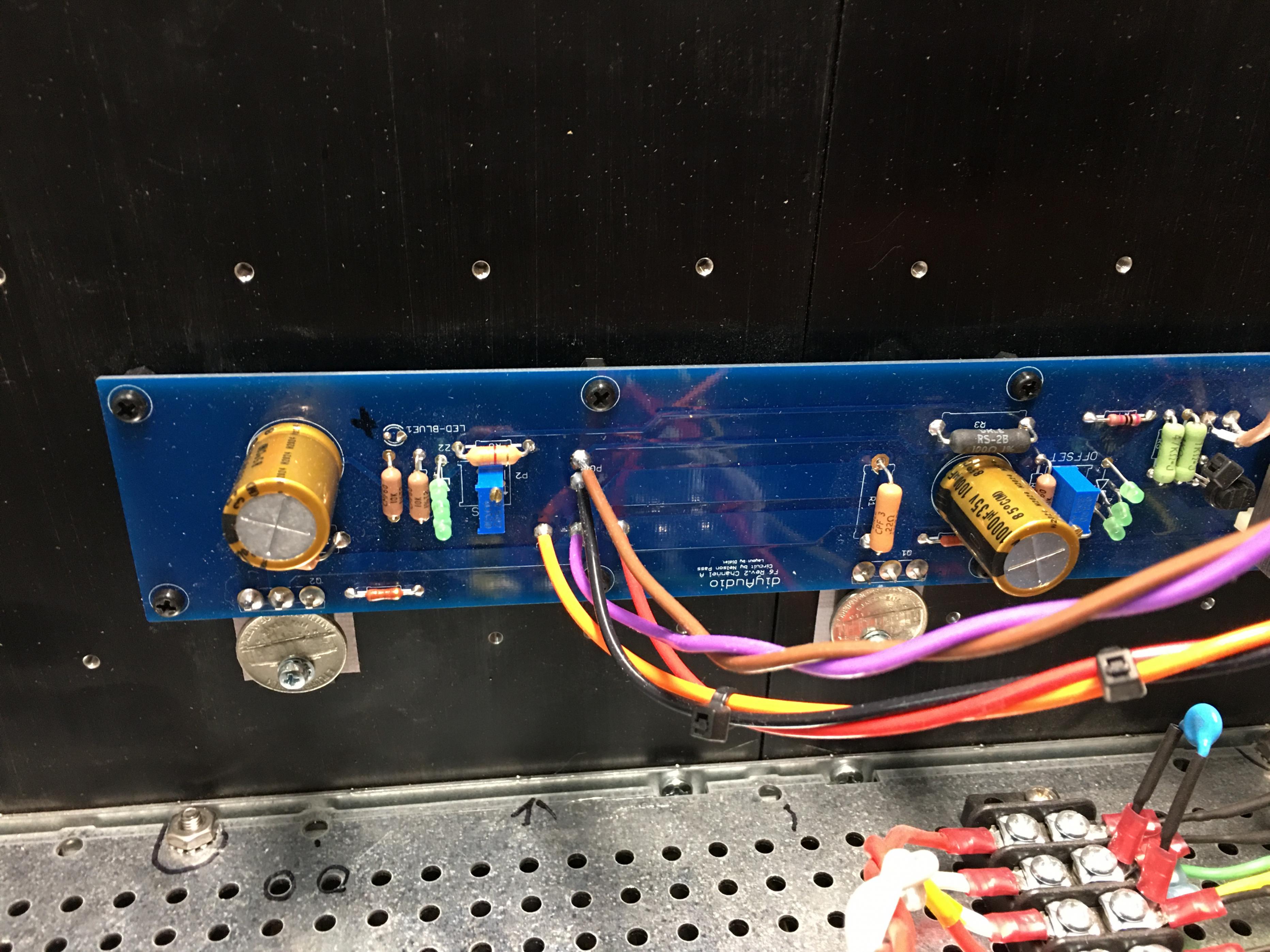

I built my F6 clone with Tea-Bag's Convertible F6 Clone PCBs and have 2 blue LEDs instead of the Zener diode.
2 x Blue LEDs would be like in the range of 6V - 6.4V?
So taking ZM's calculations into account, I should be using a 3K3 (or close) resistor instead of the 10K?
- 3K3 will let ~5.15 mA through from 23V - 6V
- 5K will bleed 1.2 mA across 6V
- That will leave (5.15-1.20)= 3.95 mA across the LEDs
Is this approach ok?
Btw, the amp is working fine and have it biased around 1.1A.
Don't use blue LEDs.
Use green or red LEDs.
Blue are far more noisier than green or red.
Anywhere between 3mA and 8mA does the job, however more current is better with regards to regulation.
2 picoDumbs,
Yes, I learned later that blue LEDs are noisier. However my understanding is that going to green or blue would be like using a lower value zener diode?
Here's the Tea-Bag board if you need a refresh:
F6 Clone Convertible PCB blog - diyAudio
On the noise issue, please humor me, saying I keep the blue LEDs in place, is it ok to change the resistor values?
Anything over 5.5V should be adequate to bias up the mosfets.
You can change the resistor values - anything between 3mA and 8mA will be certainly functional.
You will get better performance with higher currents though eg 7mA.
You will see I recommend using 3 green leds but you could also use 3 red leds
