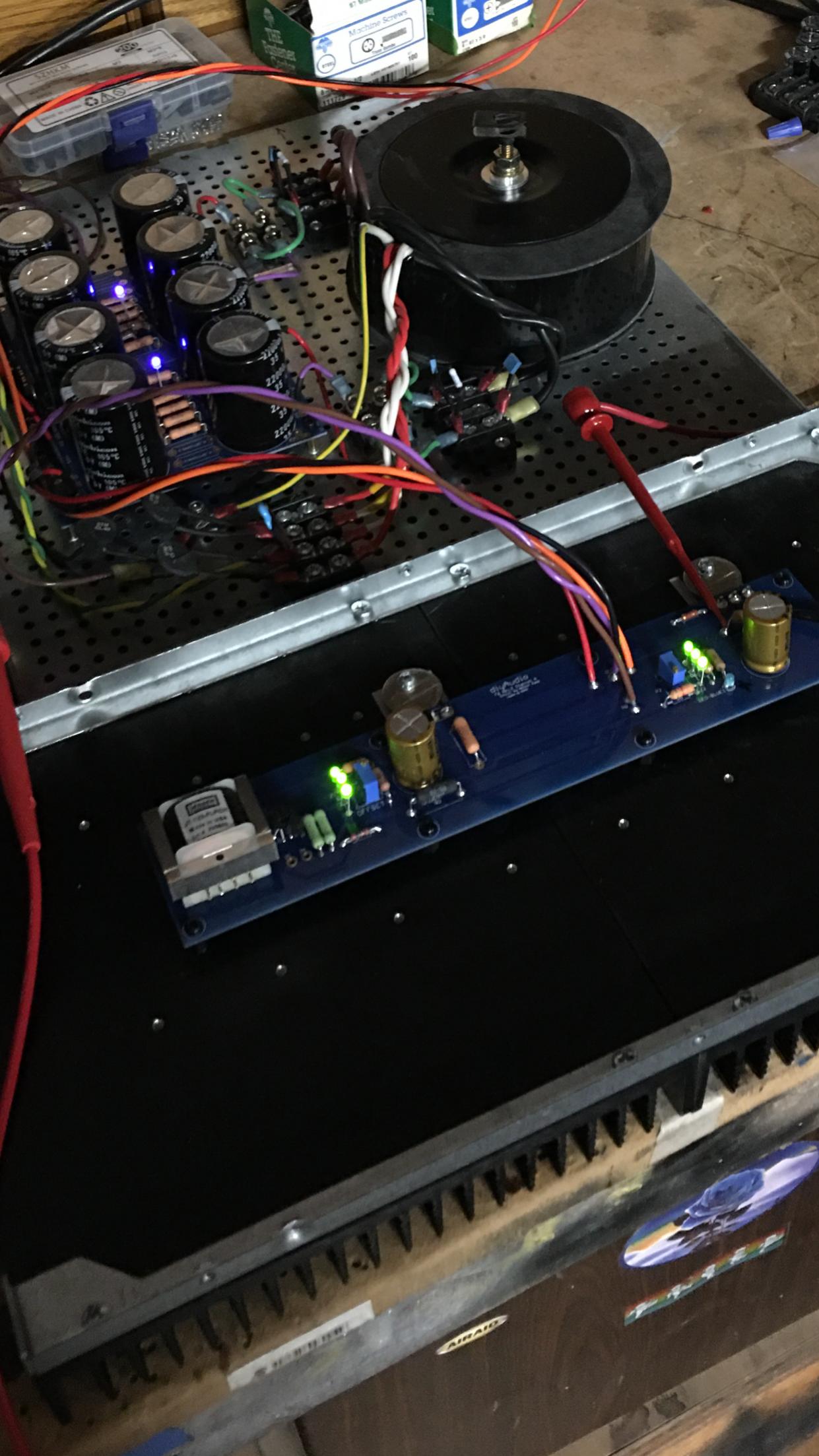

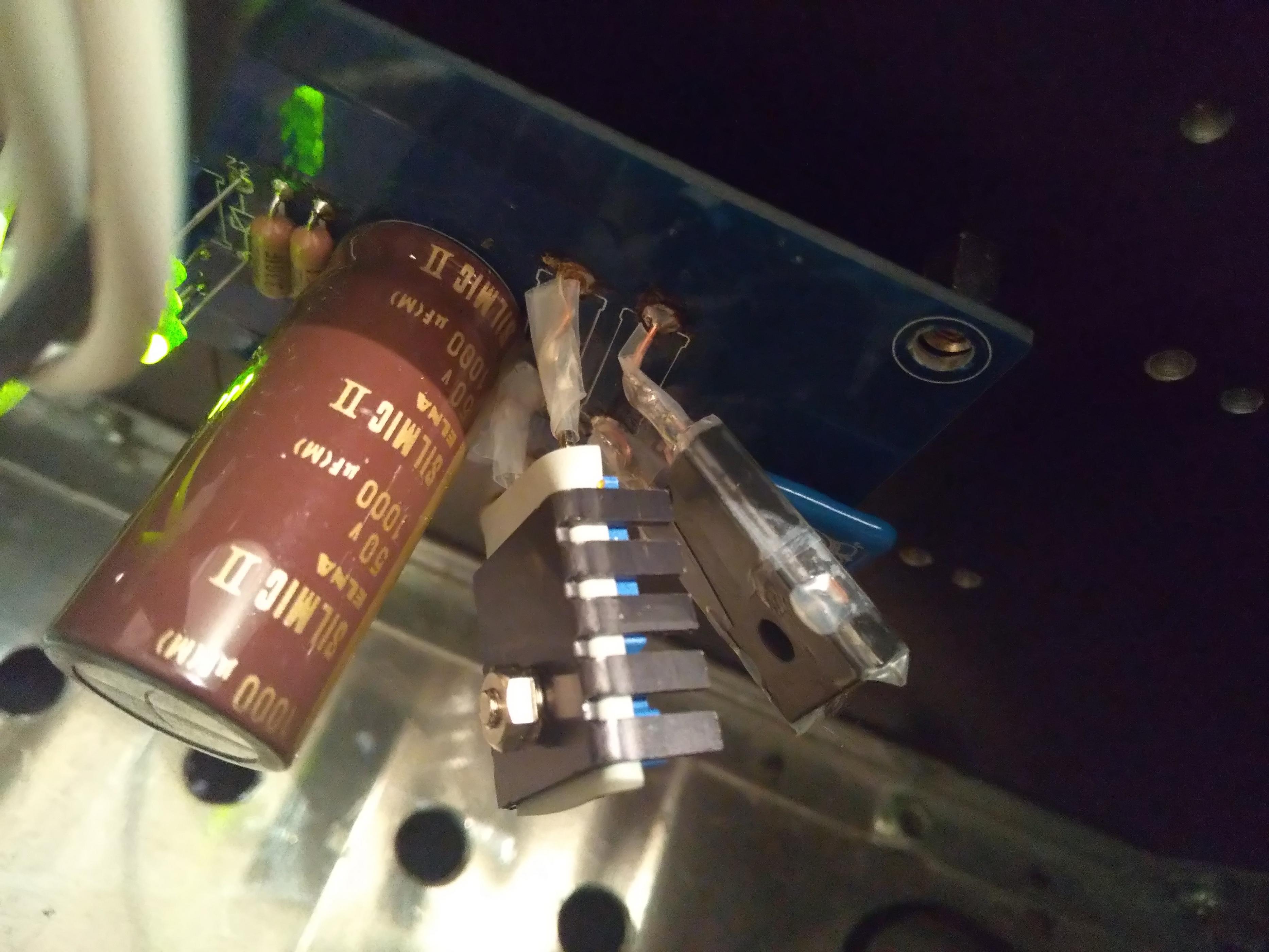

Finally put power to one amp... I installed the pico mod....relied on heat gun to set bias..ended up with .300mv with dc offset .001....was about 178F @ .500mv..148F @ .300mv. Heat measured was right on mosfet hold-down.
I must have installed blue led backwards as it did not light up.
Was that with heatsink laying flat down like in the picture?
The bias voltages are only meaningful if you state what resistors you have.
.22 in place of .47.
I figured 1.36A. .3V/.22ohm
Sound good?
Yep.
Measure it again when the heatsink is mounted on the chassis. It will most likely be cooler.

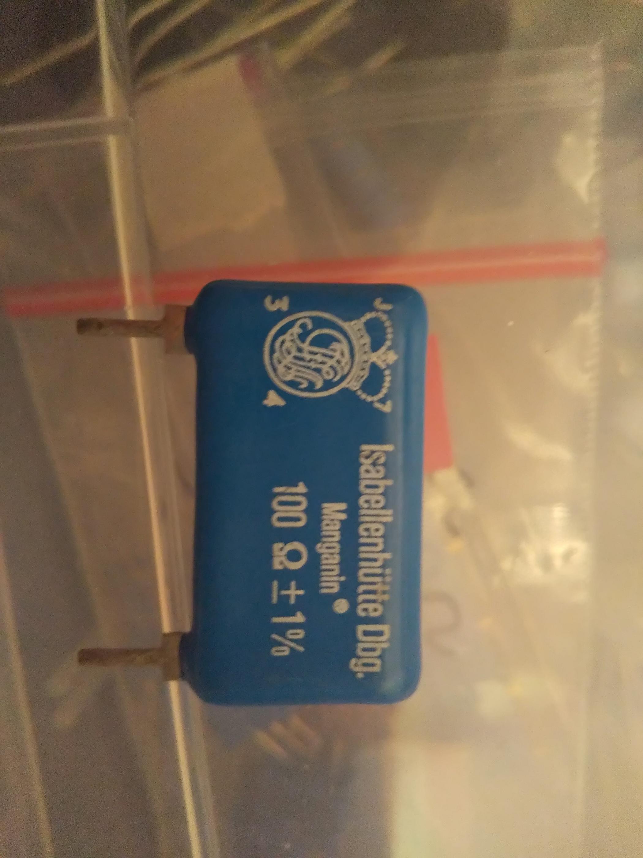

Finally I have got Isabellenhutte PBH 100R 3w from company called Burklin Germany.They didn't answer my email but could buy thru web/paypal.Tamra, I don't the 100R 3W Isab/h resistors are available anymore
For gate stopper,100R 1w was much cheap.
Source resistors are powertron.

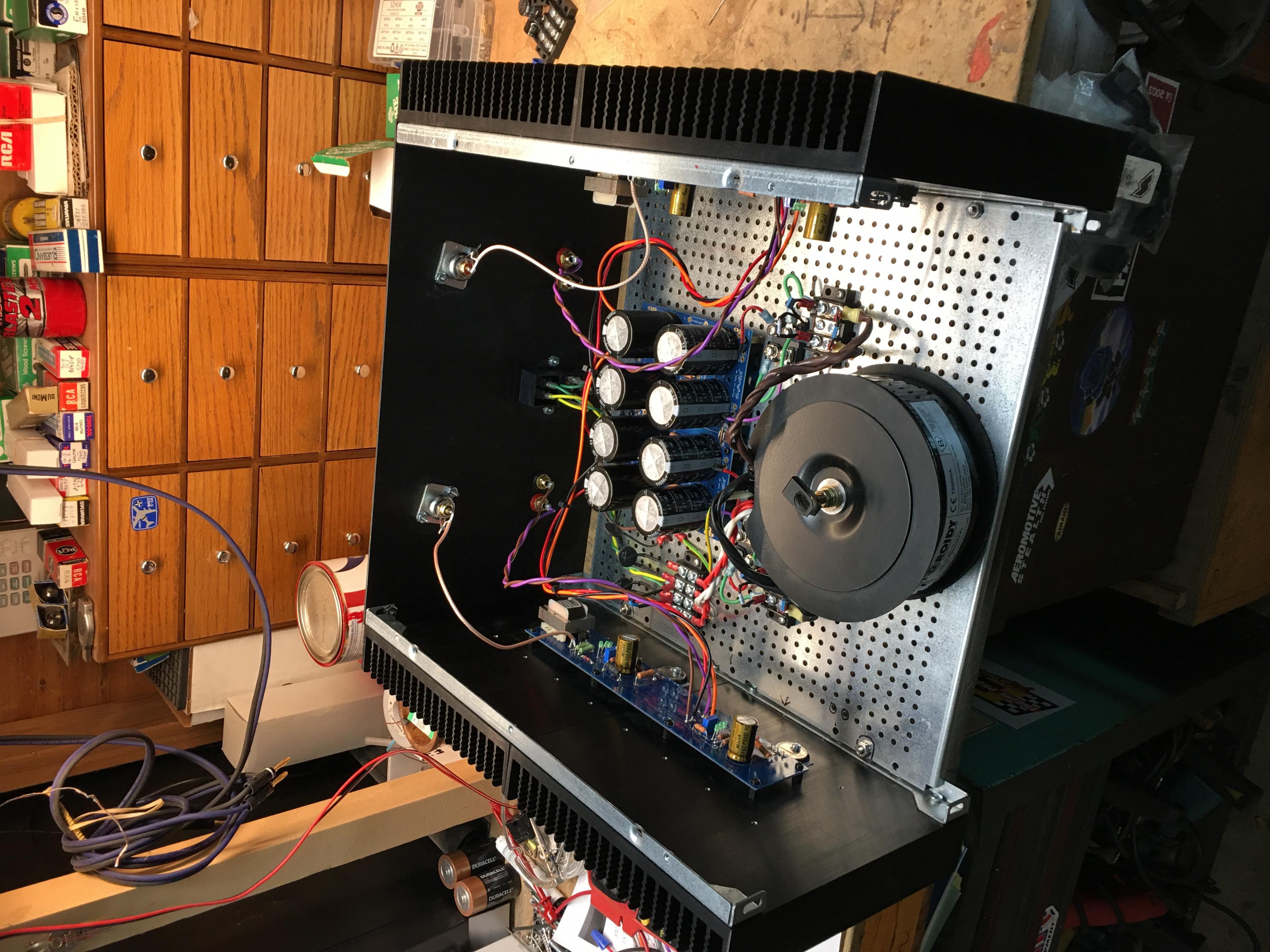

Ran for about 3 hours last night, ran freq sweep, very symmetrical wave on both channels. Outputs stayed right around 110 degrees. Offset remained stable. Only had bench speakers driven by my iPhone. Zero hum/hiss or any artifacts.
Will hook up a couple different preamps & speakers in the days to come & report back with thoughts. Indeed once the chassis is bolted together the heat dissipates more so I will let soak and turn up & synchronize both amps.
