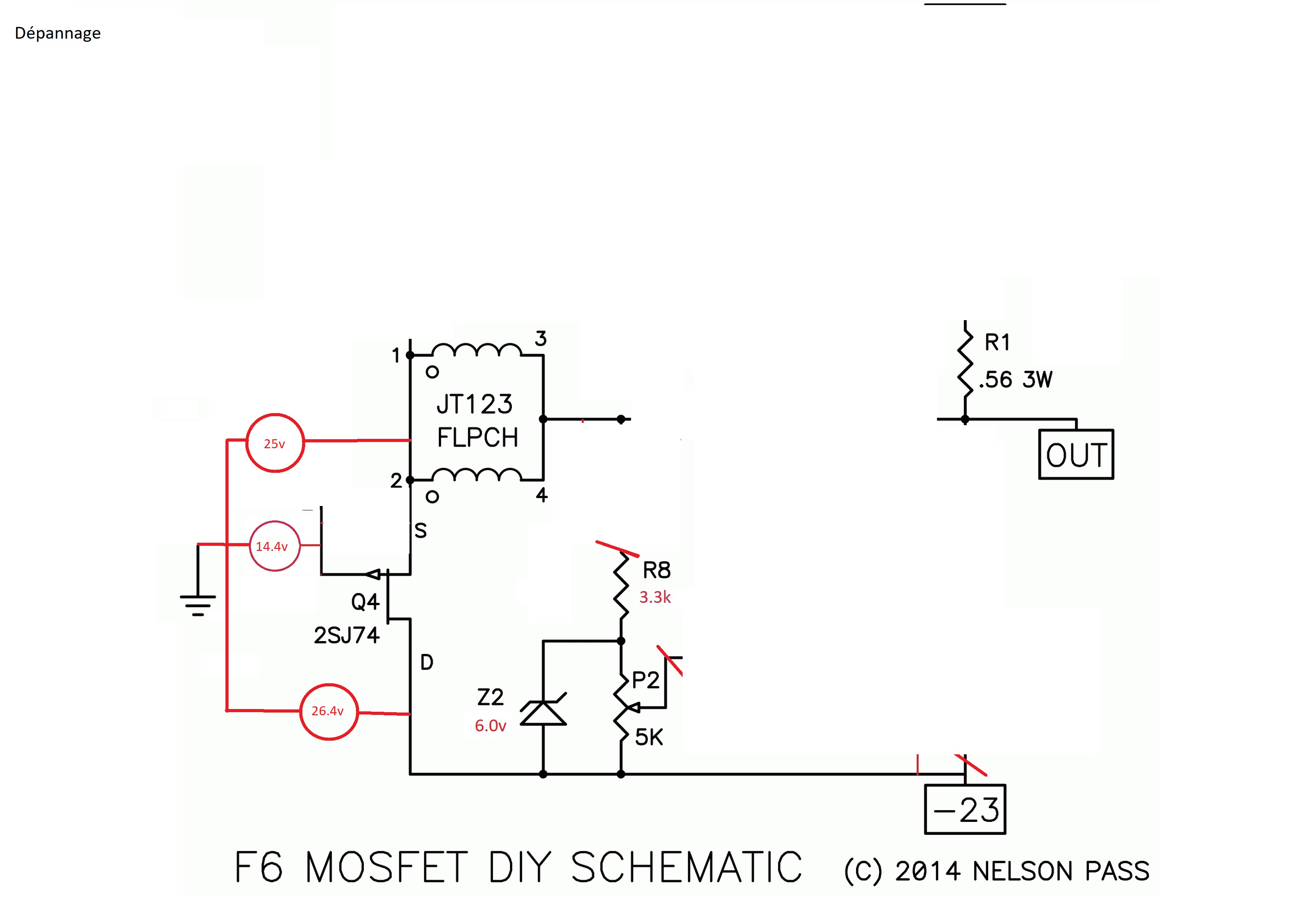

My problem is on the -23v channel, it's the second 2SJ74 that's burning.

I placed the JFETs on a universal tester, it only recognizes them by 2 resistors of 25 Ohms G / S and G / D.

I put the JFET back in place, it continues to smoke:
- G / S 2,7v
- G / D 2,7v
- D / S 6v
I always remain septic about my rail voltage, the JFETs are sensitive (according to Mr PASS) and the TOSHIBA are given for 25v.
And I don't think my JFETs are TOSHIBA.
I measured my JFETs again, I must be around 9mA under a voltage of 25v, so we are still far from the 0.4w dissipation.

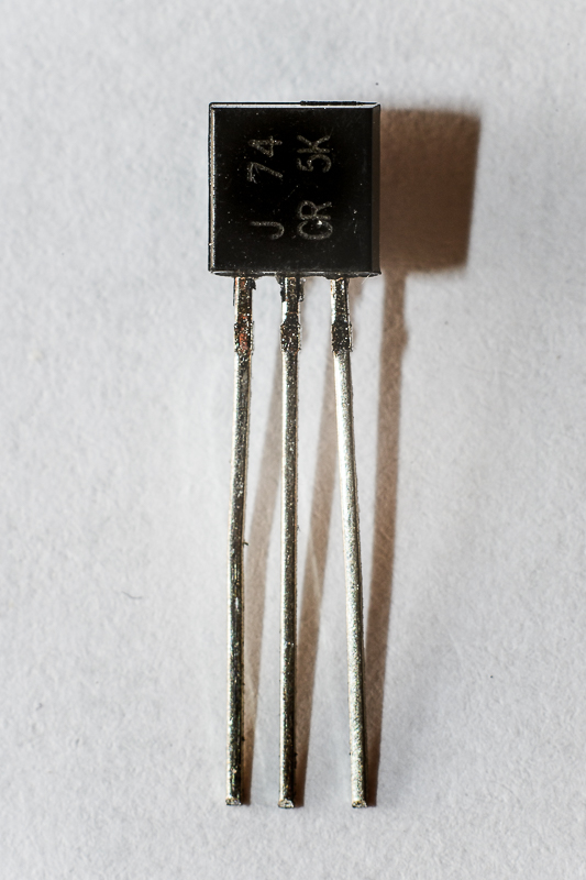

Out of curiosity, can you post a photo of the JFets? I vaguely recall that simple VGS is not enough but rather, the tests i've seen to confirm fakes is by charting the curves from varying voltages and current?
The Gate to Drain Measurement is bizarre
The Drain to source measurement is impossible, unless voltage at source is well above 0V potential.

here are the values measured on the PCB:
(I added the polarity, knowing that the negative of the voltmeter is placed on the Gate and the 0v.)
- G / S + 2,9v
- G / D - 2,9v
- 0v / S - 18,5v
- 0v / D - 24,5v
It is also useful to point out that the trimpots are at their lowest.
@ Super BQ: attached the photo of a JFET
On the photo it's GR, but I also have BL, the case is identical and the typography too.

I think, this JFETS are not "B" Grade.. and honestly, they don't look to be genuine..
I bought genuine Toshiba's from ebay seller punkydawgs (smbd here recommended this seller).

I eliminate step by step to see where this tension comes from.
I started by rectifying the DC voltage with the Trimpot OFFSET, then I separated the positive circuit by removing the 2SK170 first, then R4 and R1.

Continued my inspection, removed the IRFPs, removed all the links that could raise a voltage at the terminal of OUT, NOKAnglais
The JFET must be totally HS, disassemble the JFET, replace with another, I get:
0v / D -26.4v normal
0v / G -14.6v
0v / S -25v
Here is what remains of the circuit and always this tension.
