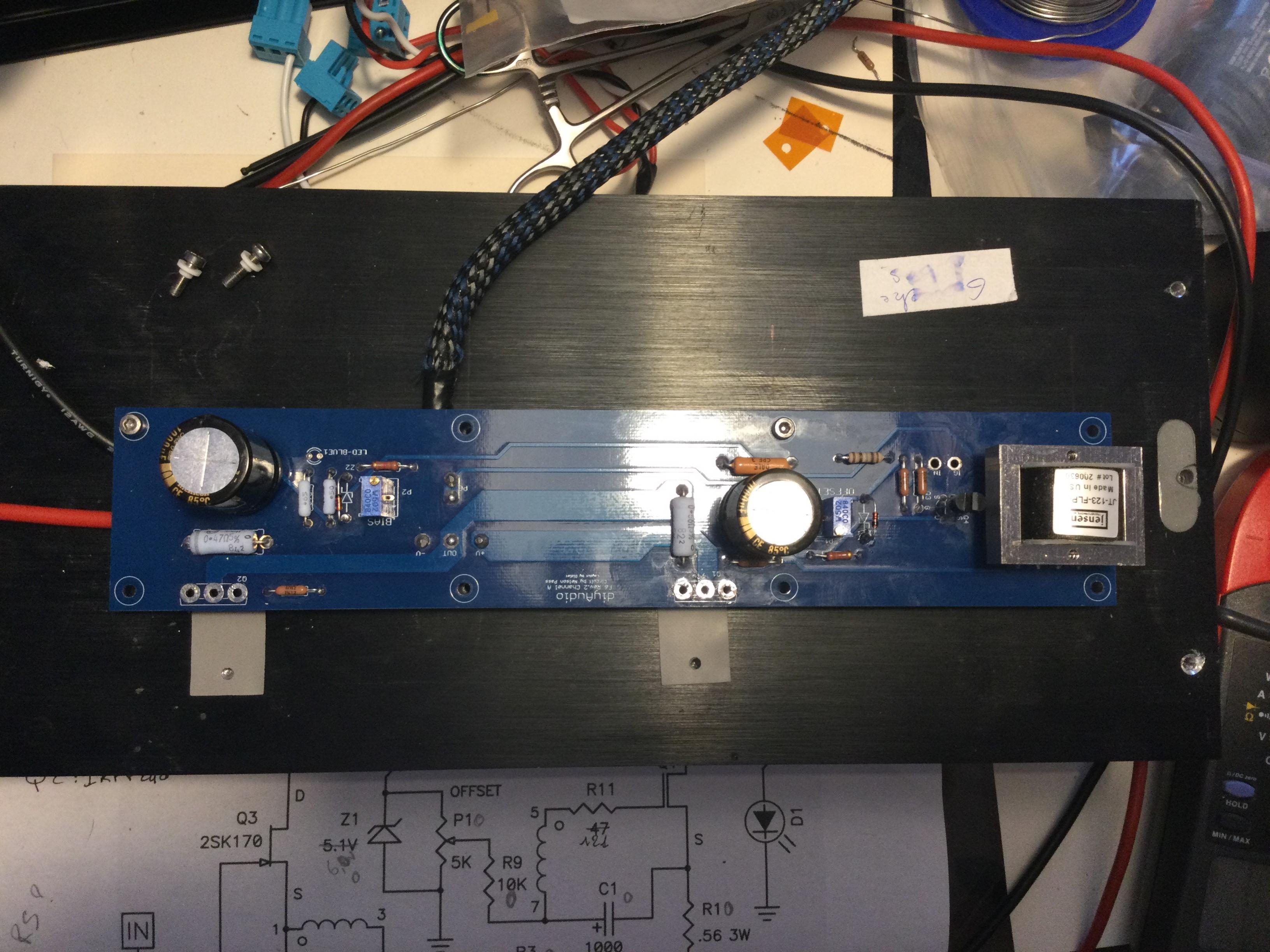

Kind of hard for me to get a grasp of the total picture of what has been done to fix the problem.
I don't like the untwisted secondary wires being so close to the Jensen transformers but maybe that has all been taken care of.
Just thinking out loud, but is it possible you helped the problem by removing the transformer from the case, but reintroduced it by running it (as in pic anyway) with the power supply no longer grounded through CL-60 to ground?
Maybe a wire (Zenmod don't forget my "24 hour wire" fiasco) from power supply ground to CL-60 to chassis ground? I haven't experimented with hum investigation via taking transformer out, but seems many I have seen do it here just temporarily removed it to check leaving power supply board mounted in chassis, with it's ground in tact.

Quick update, both channels buzz/hum have lowered by this change, I just snipped exaxtly as in picture. The right channel is fine, as only noticeable with ear in horn. The left channel still has a prominent buzz. Could it be because I still have the led reversed in that left channel? (still have not found the courage to dismantle😉)

I thought Id give the suggestion by 1543 a go. Removing the 'dirty end' 0v link on the PSU PCB tonight, sadly it didn't solve the hum issue...still the same.

Thanks 2 picoDumbs, I'm struggling as I've never had this in 20 years of building (rather If I did I found an issue and fixed it) I'm sure its an issue with the PSU as the bench PSU doesn't produce the hum, that said the bench PSU is regulated so will have nice PSRR.
Swapped out the transformer.
Swapped out the PSU. Checked all solder joints..
Checked all the wiring is correct and twisted real nice.
Good grounding via CL60 and tried without.
Sig ground is good
Sig shorted or not...
Still humming nicely.

Are your voltage references operating correctly?
Try measuring ripple across gate to source of each mosfet, see if they are all roughly the same value of ripple. Multimeter should be good enough.
If there is a problem there, then either the references are not doing there job, or there is a problem with the 1000uF caps.
Also, how much ripple do you have coming from each rail of the supply?
