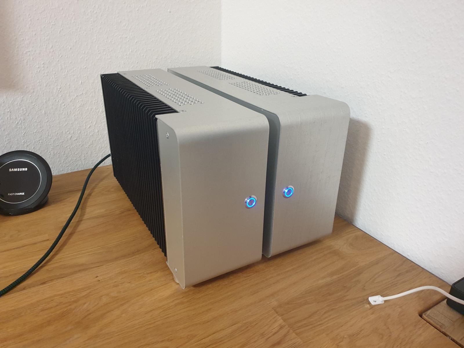

Hi guys,
it's been a while since my struggles with my F6 and your great help.
Just wanted to show you my final results.
I'm very very happy with my F6 and the outcome of my chassis.
Only thing that's a bit sad.... the guy who did the anodizing of my covers messed it up.:crying:
Thank you all very much 🙂
