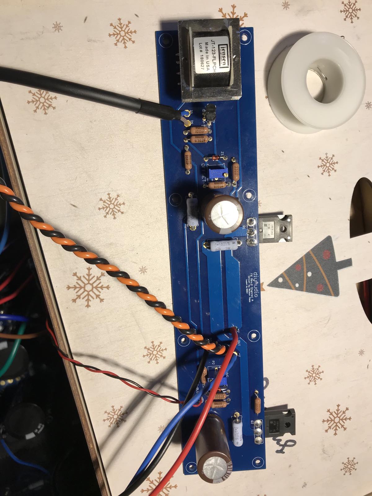

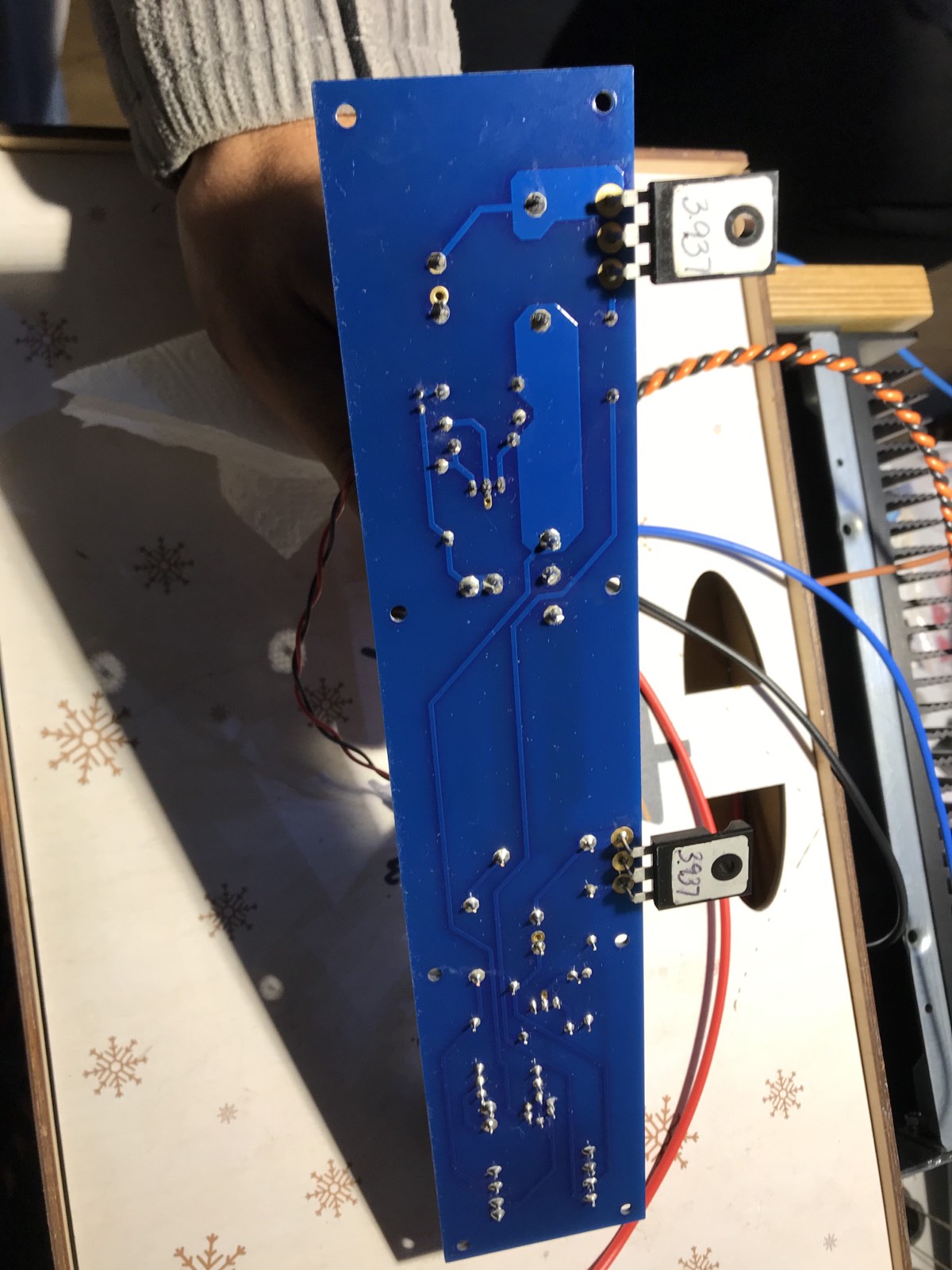

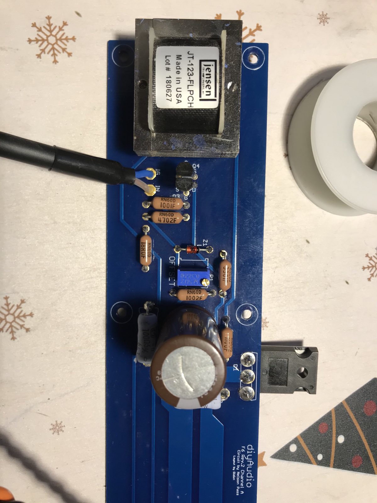

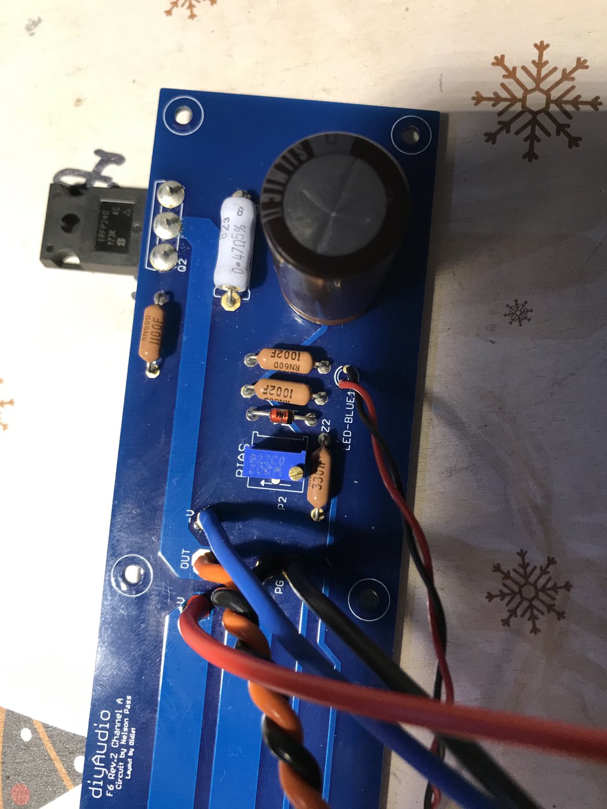

I just finished my F6 amp. One channel behave as it should – I easily adjusted BIAS to 0.5V across the 0.47Ohm resistor and OFFSET to 0V DC across the speaker terminals.
I have a trouble with second channel – BIAS volage is from 0 to 0.01V, MOSFETS are not warm at all (as they are off). JFETS are warm when I touch them, around 40 degrees Celsius.
Kindly suggest what can be reason of such a strange behavior.
All components are soldered as they should be. Picture of faulty boar are attached.
