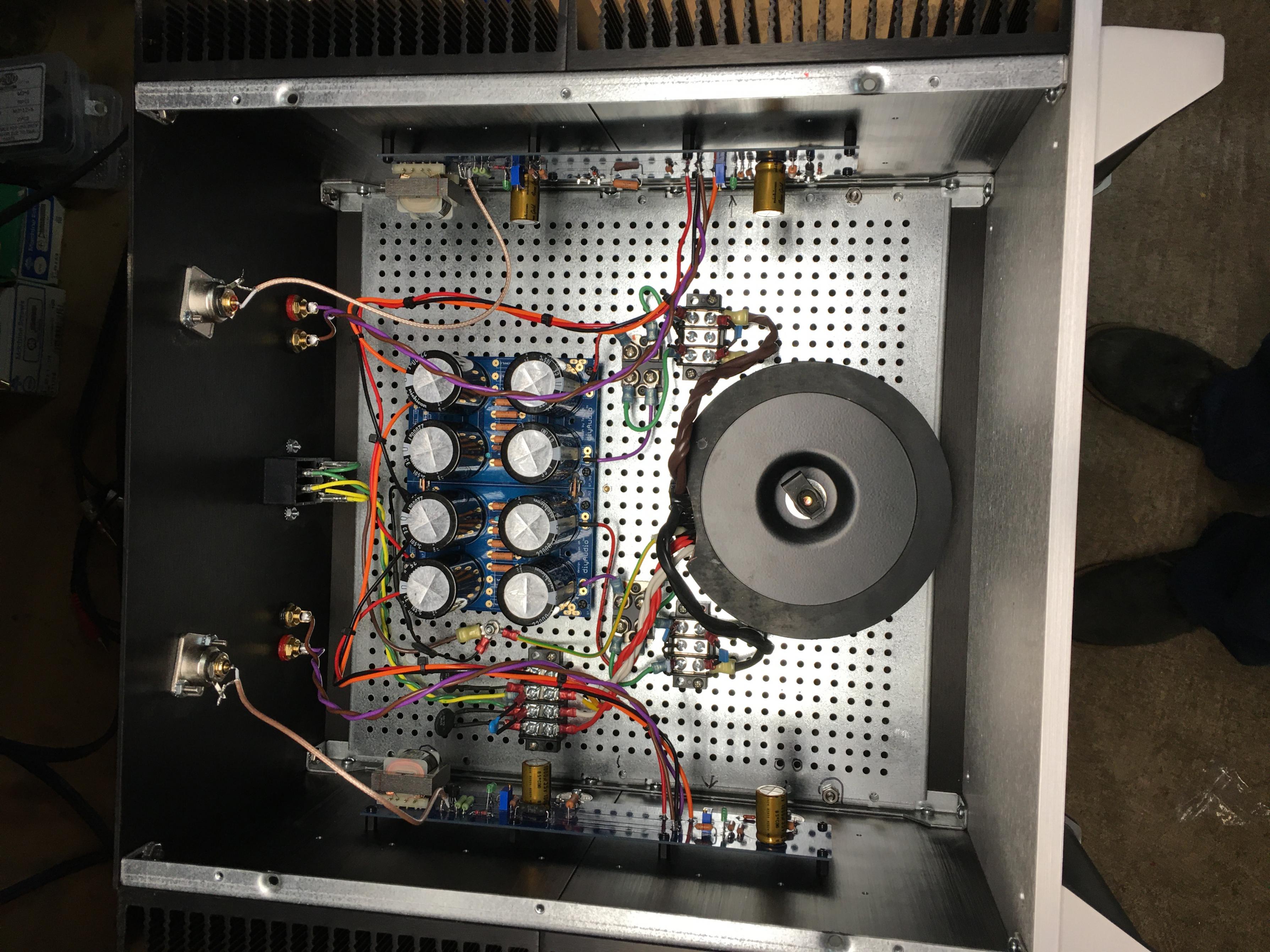

Got some time to listen. Took about 12 hours listening to all kinds of music. Settled on Nora Jones as baseline to audition a couple different cabinets. I made a Pair of clone JBL L-100’s....where I had a complete set of original transducers. Crossovers were per Dennis Murphy. The Vintage JBL West Coast Sound becomes the… | Audioholics Home Theater Forums
The amp was Very smooth, refined highs, good clear midrange, bass was sharp having clean edges to the strings (stand up bass). I did not find it harsh or fatiguing over time. The F6 drove these 94db speaks pretty well.
I set bias for first 6 hours at .323ma..the entire amp got no more than 102 degrees. The last 5 plus hours set at .350ma. (.35/.22= 1.59a)
I’m very impressed with the sound. It was a great project!

Monk55,
Congrats on getting you amp running.
Btw, looks like you built the amp with 2Pico-mods right away and did not try it out the "default" config?
Correct. After reading all the F6 blogs, (a lot of characters out there with much more experience than moi) I just went for it. PicoD inspired the outcome.
I usually build tube gear so this was a departure. I’ve got the Wayne 2018 pre in the que.

OK, thanks. I guess I can get a batch and go for it, and if problematic, get set up to measure. Seems like a few others are trying this here, so I will watch a while. First, to get some parts
Russellc
Did you just buy the outputs and use as were, or did you perform any kind of sorting, matching, measuring? Sounds like Pico has found these to be very close, so I was going to buy some and go for it.
If something becomes obviously wrong, I will get more samples and do what needs to be done.
russellc
No matching. From what I understood testing/matching would not be required to achieve good sound.. I had purchased several outputs to try but went with Mr PicoD as he’s far smarter than me & he liked the results.....besides there are already changes in sound depending on speakers, pre’s, etc etc. I need to listen to this configuration (my baseline) for awhile using different pre’s. I’m curious to see what my DHT X201 pre sounds like...fun stuff
The parts are basically different enough to get the desired result.
Measurements are not really necessary.
It doesn't hurt to measure them to know for yourself exactly what you have though, if you wanted to be certain.
We're not matching for the purpose of current sharing. We are doing the exact opposite (so it behaves more like a J2 circuit) so the level of precision required is not as great as matching paralleled parts etc.
