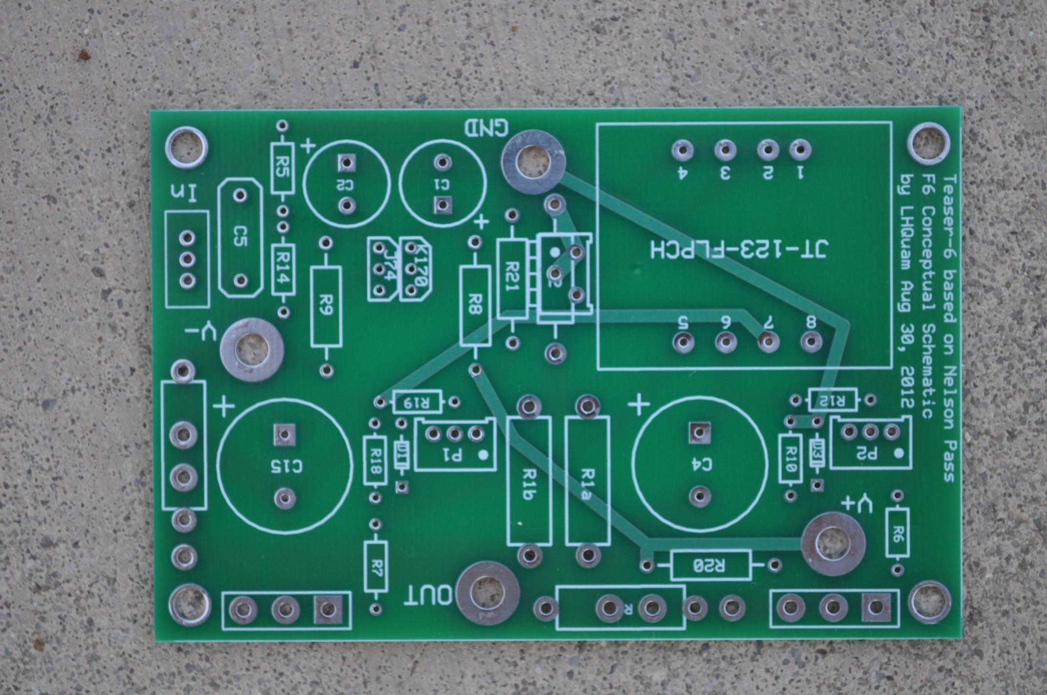

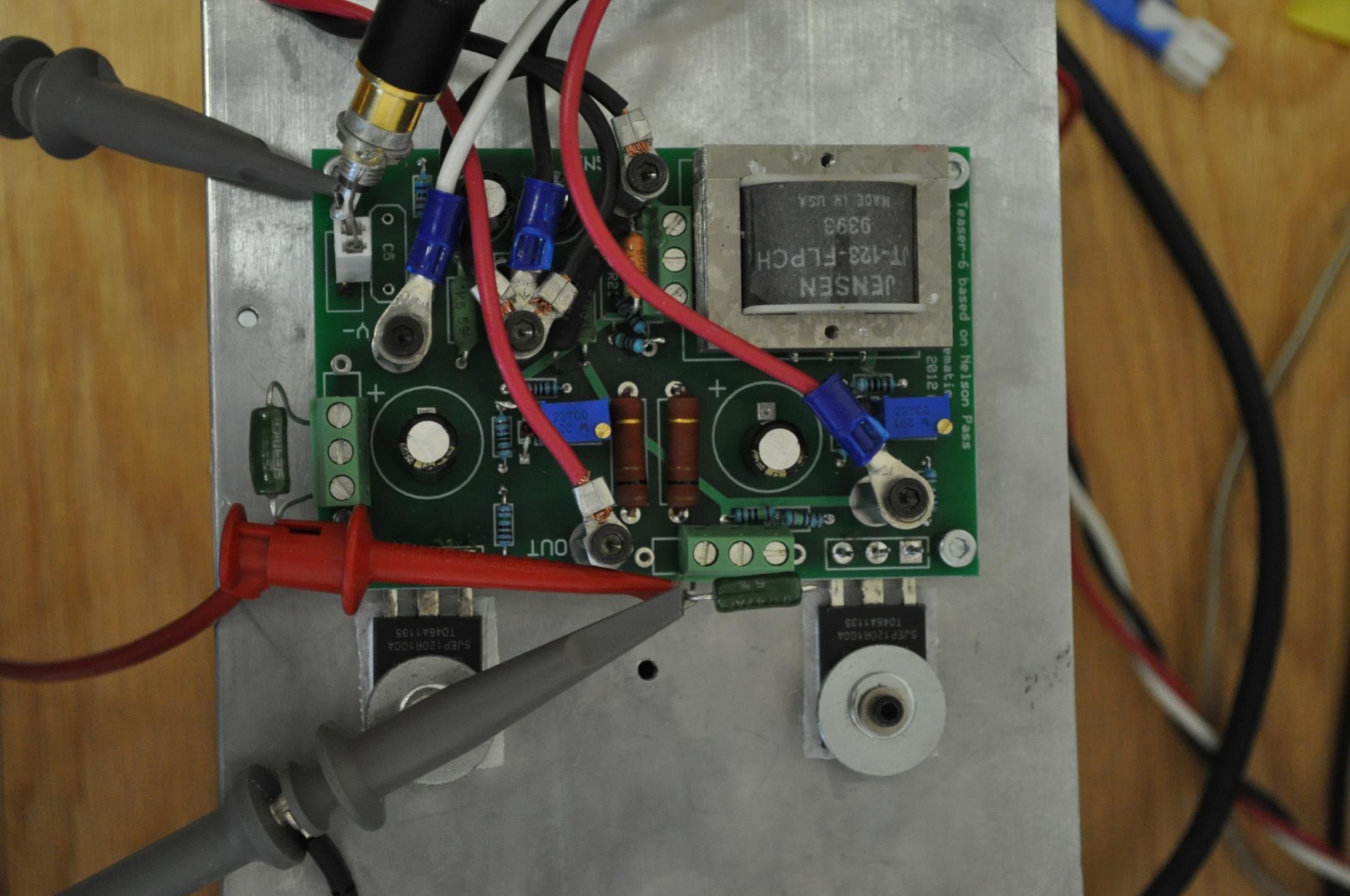

PC Boards arrived - first build
My PC boards arrived a day early! Great service from ExpressPCB.
Here are some images of the boards and a build which includes modifications for floating power supplies.

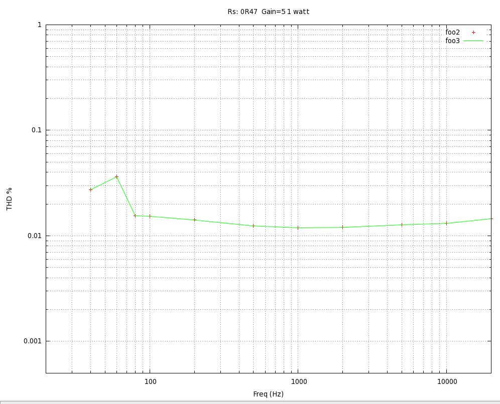

Also included is a THD vs Frequency sweep with 0R47 source resistors, 1 watt into 8 ohms, closed-loop gain 4.7. Amazing! Except for some issues below 80 Hz, which are to be investigated, the curve is perfectly flat. I do not know why I didn't see the same with my breadboard.

The statement about deriving the V2 voltages was premature. The existing RC filters were adequate. The average of the V1 voltages were fine for supplying the RC filters.

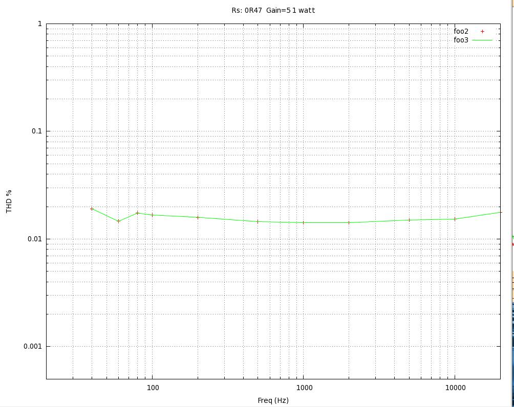

Update: The bench supplies were current-limiting in the previous THS vs Freq plot. Try this.
I do not understand why this circuit works this well.

I might believe you now about Spice and the transformer models. The measurements with my PCB do not conform to what my Spice models predicted. I am not sure why my breadboard was so much worse than the PCB. Perhaps it was a non-obvious layout issue.

btw. Spice is here pretty much useless , just because Spice doesn't know drek about exact xformer
Considering there isn't an official schematic that performance is impressive. I am very curious to see if what you have built is dead on, close or it's own derivative. How does it sound so far? Any way you can compare it to an F5?
