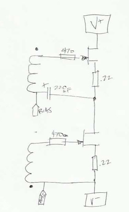

Dont have gate stopper on 2sk170 CCS feeding my output bias LED's. Could this be it. suspect crappy wiring job, but we will see.
moi suspect crappy mess ( even if it's always like that , even messier , with my ikebanas )
connect top of lower bias net (JfetCCS) to GND , instead to output
I can't see organization of GNDs on your pic , so it seems that you're on your own regarding that
be sure that repeaters aren't swallowing mains xformer field
Will its real absence cause buzz? lhquam's earlier circuits may have oscillated at low frequency with low values of these capacitors.Buzz,
Cap is missing across your bottom biasing circuit. ( second PDF)

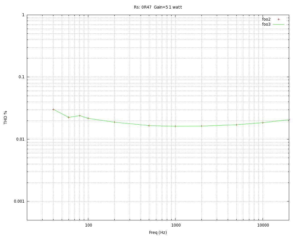

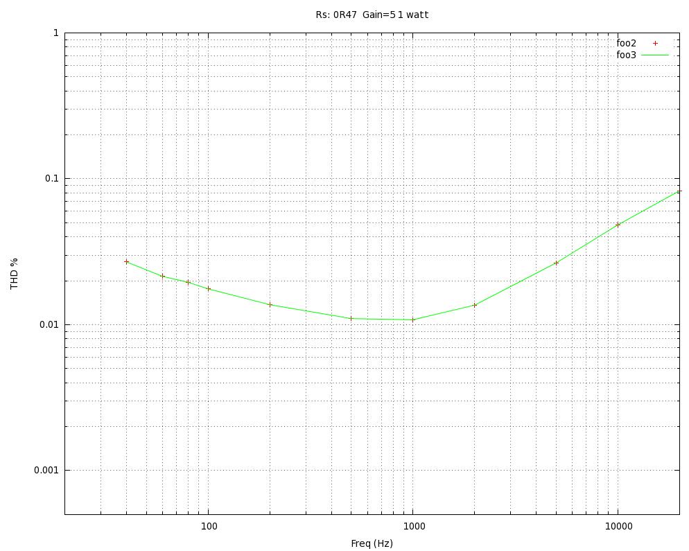

In my previous post http://www.diyaudio.com/forums/pass-labs/216616-f6-amplifier-147.html#post3156418 I show significant THD differences between 2 PC boards I built. Today, I swapped R100 output JFETs between boards (that was easier than swapping transformers). Here is THD vs Frequency of one of the boards, before and after the swap.
This indicates that there is considerable variability between the SemiSouth R100 JFETs. I do not know if it is input capacitance, transconductance, or something else.
...connect top of lower bias net (JfetCCS) to GND , instead to output...
not seen this one but yes.
Two mistakes in the shematic but may be not in the circuit.

but , if made as drawn , lower Jfet can't be biased
Cap is on bottom section as well. Lower Bias network is not attached to ground at top but output. Everything biases perfectly, but i suspect ZM is right, its the tangled mess. Thats what i figured from beginning, as it was thrown together. I will rebuild and retest.

At 20kHz 1watt, the RMS AC gate current is about 40uA. I would expect leakage currents to be much lower than that. I seem to recall measuring the gate current as about 2uA when biased for 1.3A drain current. I did that measurement for only one R100 JFET.probably different gate leakage
Yeah, I was thinking the same. I am trying to order some non-A R100s right now from Newark.Wondering if the R100A parts are showing their colors vs their non A counterparts.
