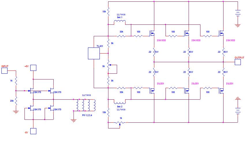

No, for now I just wanna try somthing like this:
draw it even more basic and you'll see that it will not work
edit: observe difference between your schm and DeHaan's
hm ....... I just woke up , and will continue to sleep soon , so forgive me for little fluffyness ..... it will work , but you need cap for bootstrapping of TL and - of course - that's entirely buffer amp , same as F4 ........ unless Lundahl isn't connected with some gain
too sleepy to search
edit edit : connected as 1:5,6
http://www.lundahl.se/pdf/7905.pdf
