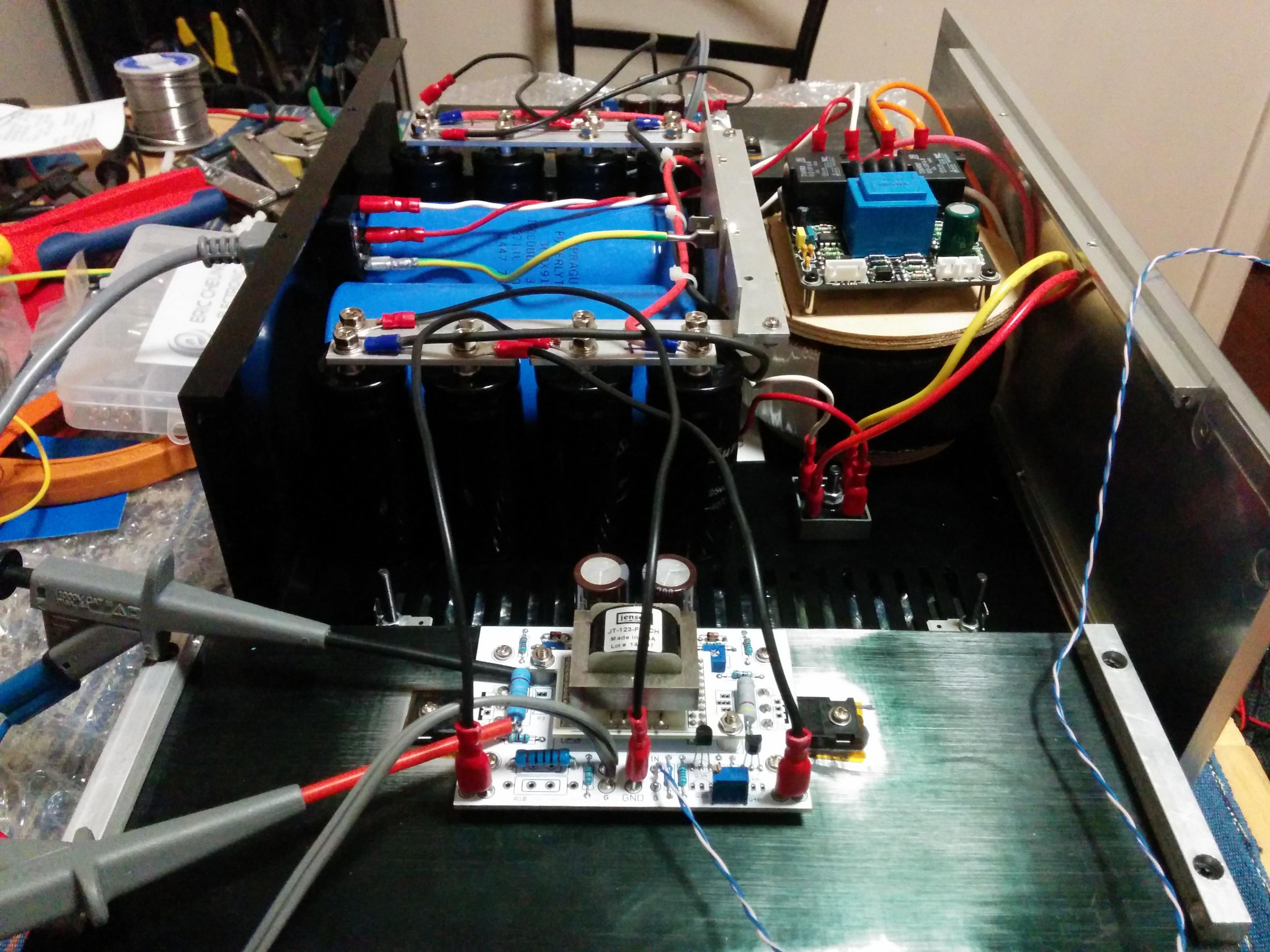

Nearly there - F6 using cree SiC fets
Nearly there, Just a bit of chassis work and testing to go.
Twitchy to set the bias/offset. Wish I'd used multi turn trimpots now! currently biased up to about 1.6A, and the heatsinks are apparently at about 55C
Once I have it roughly set up I'll try an run it through a basic pc THD test.

What ZM said is best, but what you suggest will work, start with one channel at a time (Disconnect PSU from one channel), have a meter across a source resistor and don't be surprised if you need to turn it down quickly.
Bit it also depends on the Vgs of your specific Mosfet and the Zener voltage... I used 5.1V in the beginning and couldn't get enough bias, and then replaced them with 9.1V zener, and had tons. YMMV.
