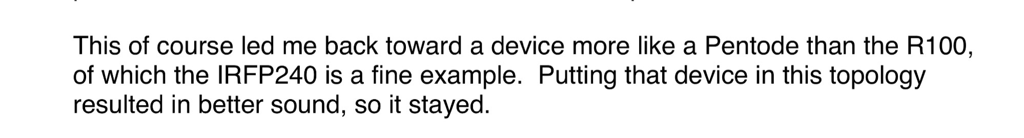

I guess the F6 he reviewed was the newer one with IRF MOSFETs?
We see he opened F6 new from box on video and i think you are right
yes this is First Watt amplifier with IRFP Mosfets new product.
Extract from F6 manual :

Just wanted to be sure the review was of the newest F6 version since it was also produced with Semisouth JFETs.
I avoid sending "pilot run" pieces to reviewers as it just creates trouble,
unless the production is the same, which it is occasionally.
