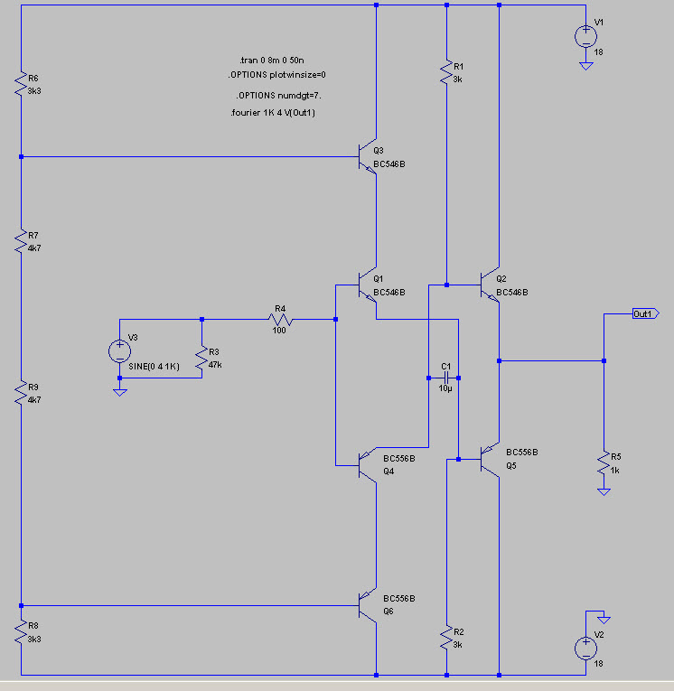

I just noticed after many months of use of my F6, that it has the tendency for the output to swing little bit on offset, making my full ranger to go back in terms of cone movement and then settle back. Is it normal for F6 to behave like this, or did my power supply alter it's behavior off-late. Don't know what it is because, I did not notice before.
Thanks in advance.
My problem continues in one channel only, where the output has a big swing before settling in. Could it be a problem with C1 or C2 (1000 mfd) caps? The power supply capacitor bank is common and does not seem to be the problem as the other channel is behaving well at startup.
There is absolutely no problem in sound reproduction, gain or any other matter.
Thanks in advance.
Cheers.

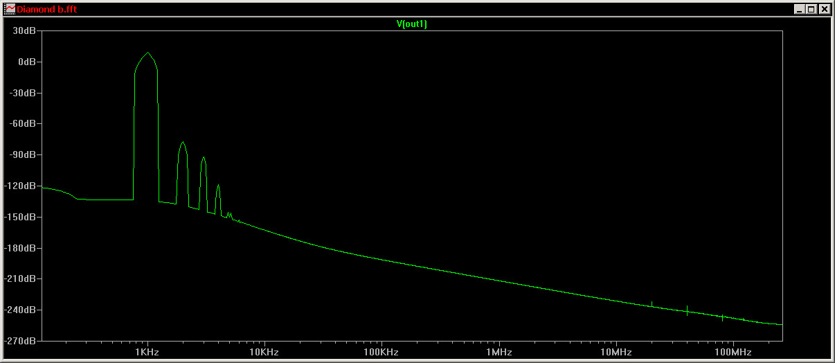

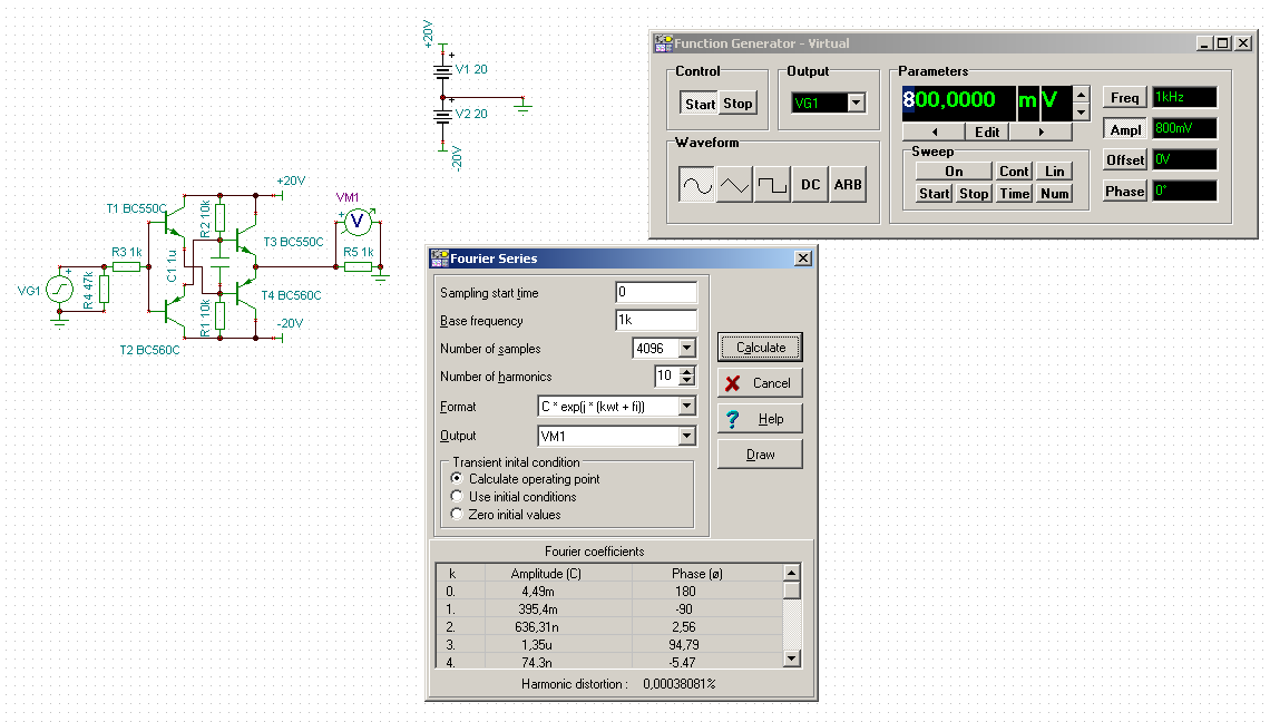

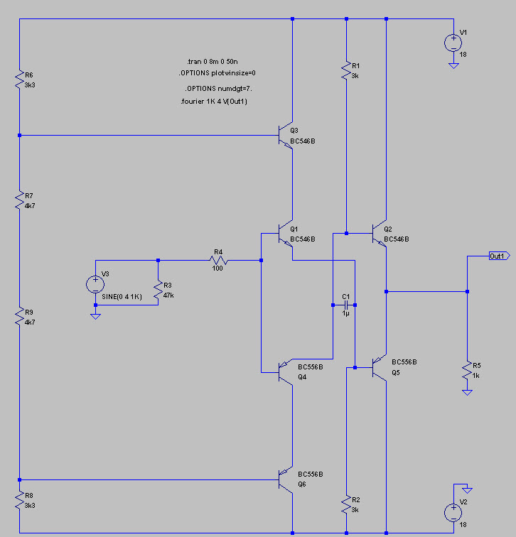

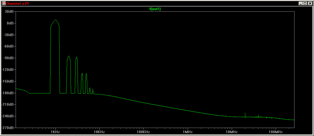

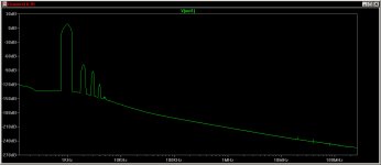

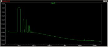

That's more nature of question.....
if tweaked , THD spectra is pretty close to JFet buffer one .......
aha
recollected some memory mist :clown:
more juice ( those 10K to 3k3 or even lower) and cascoded input critters
also - cascode modulation , but sadly possible only in balanced , due to needed (anti)phase
few more details , but I'm getting older and older 😀
something as this - not just spiced but also tried many moons ago ( while I was playing with Poor Serbian Man NEM AI-50)
I just made sim by memory , but that was it , I believe
THD spectra - 4M No, of data point samples , 7 points , Hamming , no compression
frankly , not exactly as sweet as JFet complementary buffer , but pretty decent ..... and there is iron for sweetening things 😉
I tried CCS-es instead of 3K thingies , but my ears are not in Generg's league ...... so I didn't heard positive step in that
:devily:
something as this...
another crumb from memory ( seeing 1uF on recent schematic mislead me )
C was 10u and upwards ... now different , mucho .....
in fact , I put there 470uF Elna (having them around always ) but 10uF was confirmed as minimum for pleasantness
cascode output ones or not , your call
