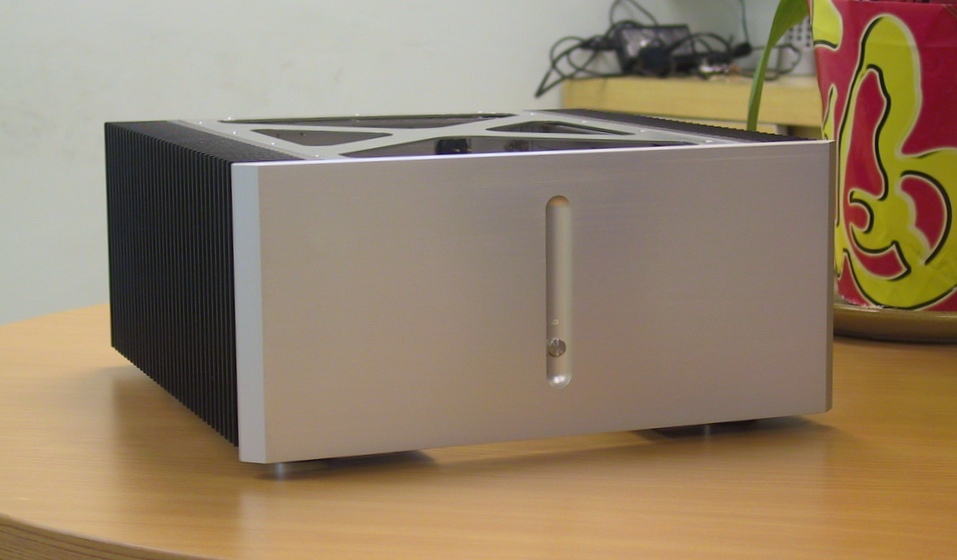

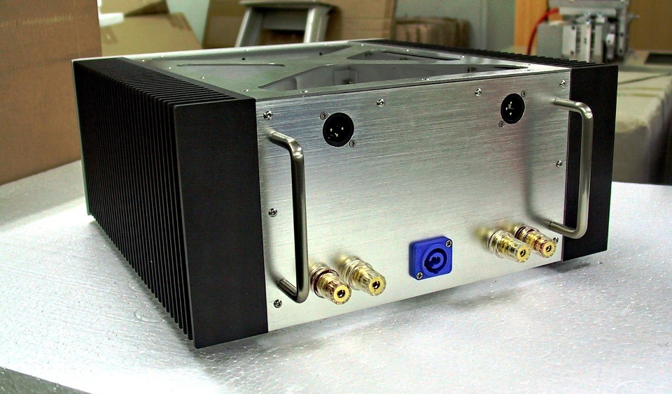

Here I release the first photos and details of the case. More to come later when I have time.
-- Overall dimensions are approximately 350 (W) x 370 (D) x 170mm (H).
-- 2 Conrad MF35-151 heatsinks.
-- 15mm thick AL6061 CNC milled front panel, with cut-outs on the rear surface for the protection PCB. Brushed and matt anodised.
-- 303 SST push button; 3mm dual colour (Red/Blue) LED.
-- the Proto now shows a 2mm SST top plate laser cut, with 0.8mm diameter wire mesh, 3mm grid, underneath (not yet shown); however we intend to replace this with 3mm thick aluminium 6063 with CNC drilled 3mm perforations to make the "X".
-- 96mm standard kitchen size SST handle (so that you can choose other ones to your taste).
-- Rear panel 3mm AL6063 (to be) matt anodised is detachable and NOT part of the structure, to allow customised engraved rear panels from Schaeffer, etc.
-- 303 SST feet
The other features (transformer vibration isolation from case) will be explained later together with the photos.
Hope it meets your expectations,
Patrick
PS The rear panel has a slight error in that one XLR is turned 90°. This will be corrected in volume production.

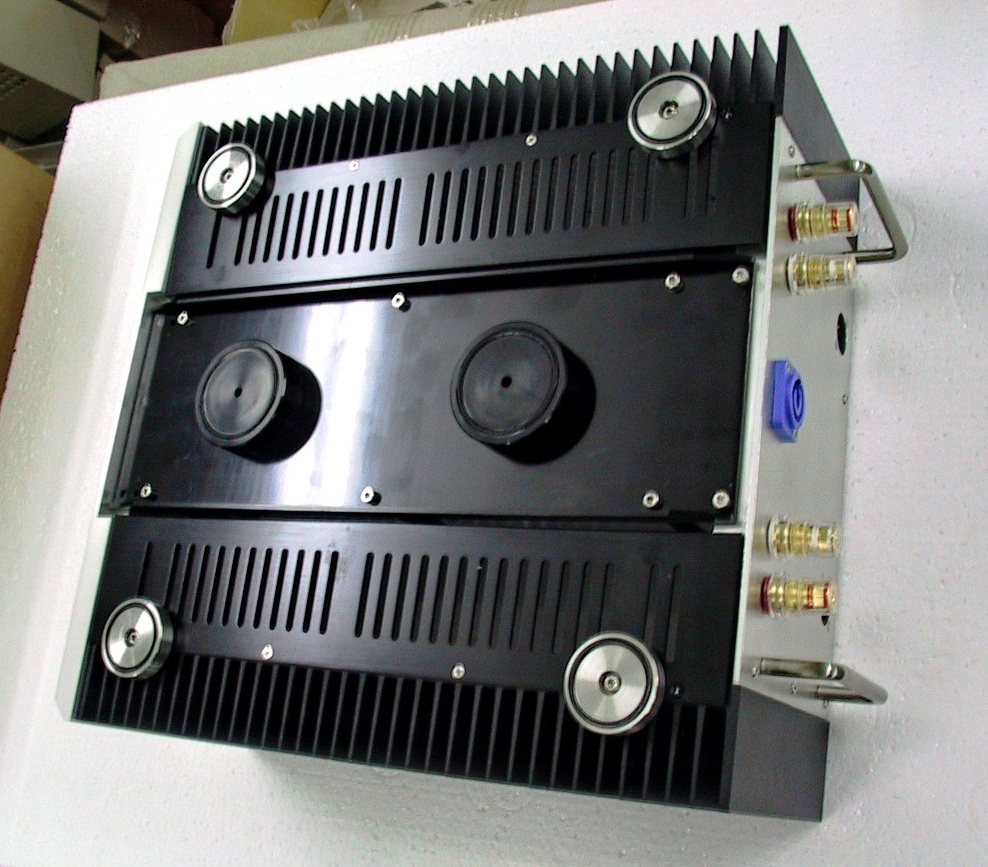

A couple more details :
One of the major concern at the beginning was plate vibration of the bottom plate. So initially the case was designed with a 8mm bottom plate in mind. This, however, is not only heavy (to ship) and expensive, but also still not rigid enough with 2 big masses (toroids) sitting in the middle.
So instead, they are now placed on a central cradle which is folded into a U-channel from 3mm AL 6063, and then machined to the required dimensions. Folding in a U gives it tremendously more stiffness, increasing the natural frequency significantly.
To improve the dynamical behaviour even further, two extra Aluminium feet are placed directly below the centre of the transformers to support their weights. This will also allow the transformer to be dynamically decoupled from the rest of the case. Details of how that might be done would be included in the assembly procedures of the case.
Similarly, the rear bracket (black, hidden behind the rear panel which is purely decorative) is also folded from 3mm 6063 AL into an open-top box . The only "thin" plate left in the case is the top plate, but this is unlikely to receive much acoustic excitation as it is near 50% perforated. Hence little pressure difference can exist between top & bottom surfaces.
The same also applies to the two bottom side covers. Their only function is to cover the case entirely for electrical safety.
Patrick

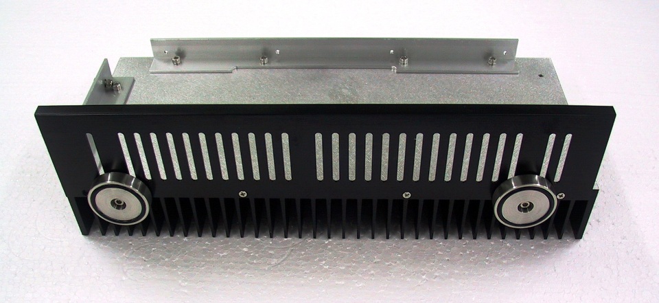

Each of the heat sinks has 2 SST feet, and the bottom side cover is directly bolted on using countersunk screws, so that the screw head is not visible from the side. This however puts extra demand on machining tolerances of all holes.
(I hate seeing screw heads sticking out from a case. It is only for cheap cases where they use long slots and button headed screws extensively to compensate for poor part tolerances.)
The PSU C-Reg-C has dual bridge and no common ground until they met at the star point right in the centre of the amplifier PCB. This allows the placement of the PSU capacitors to be as close to this high-bandwidth amplifier PCB as possible (near the "cool" ends of the heat sink).
So as such, each channel of the F5X can be finish assembled and tested on its own, with the PSU caps already in their final position, before it is finally wired up in the case.
Patrick
