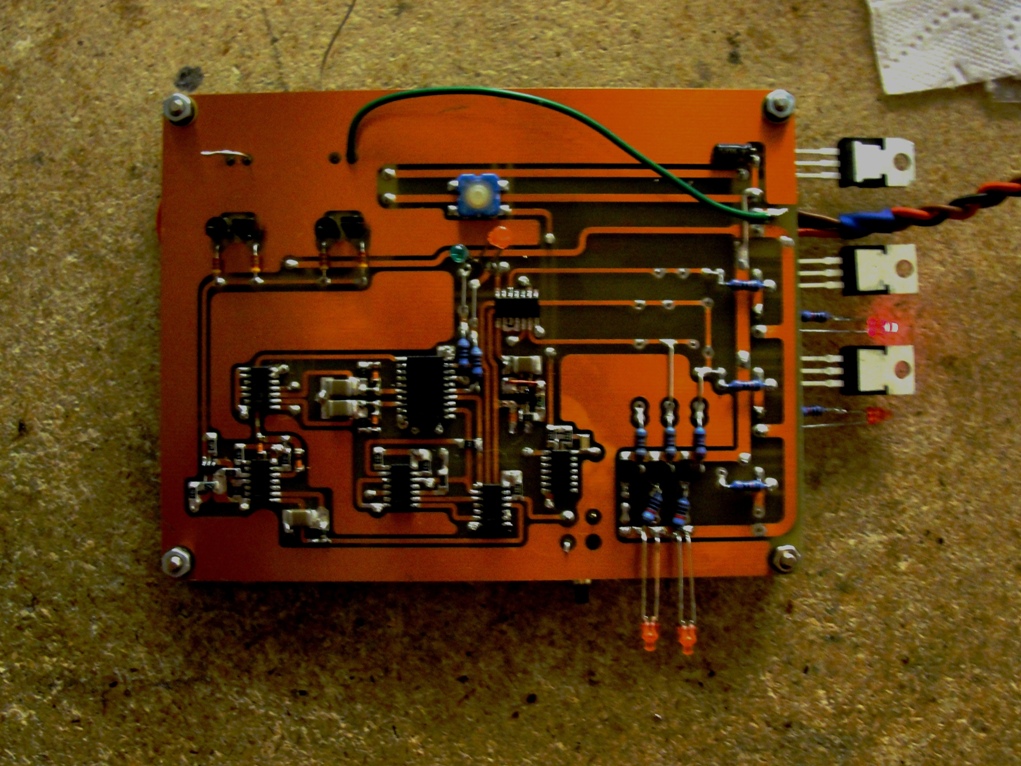

I had some time today and got the control & protection board working.
This is the start up state.
The mains relay to the 500VA transformer will turn on 2 seconds after power on switch. (as represented by the red LED top right).

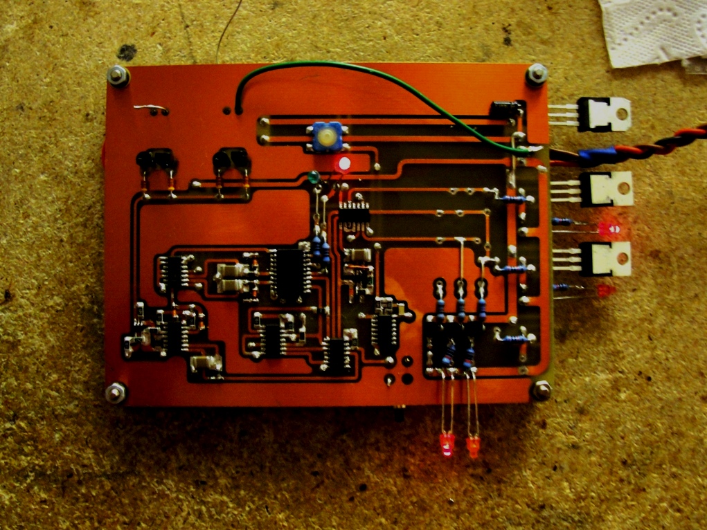

One press of the push button (blue) will put it to the standby state, where the regulators would be turned on (as indicated by the red LED bottom left), but the inputs are still shunted, and the outputs are disconnected (if you choose to use a series speaker protection relay).
The red LED on the front panel will also turn on (middle, below the push button).
