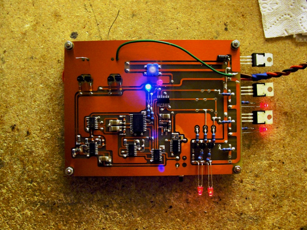

One more press of the push button will turn it to the operating state, with all relays on (to release input - red LED bottom right, connect output - red LED right lower). The operating state is indicated by the blue LED.
Another push of the push button will return it to start-up state.
Later on, the red/blue LED on the front panel will be replace by one bi-colour LED.
Also in the new PCB layout, the user has the choice to connect whichever relay to whichever operating state freely by jumpers.
The output DC protection (trigger at 2V, any of the two channels) is of course also tested functional.
But since it turns everything off, there is no picture to show.

Oh, BTW, all normal 5V logic.
No uP's, no MHz oscillators, etc.
The original DC detection circuit used 2SJ109's.
(This circuit has been around for 5 years now.)
I thought it would be a bit extravagant these days, so I changed them to BC560C's.
Patrick

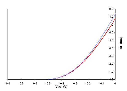

wise choice haha j109 for protection only is indeed extravagant, i have maybe 20 x j109 sitting here for special occasions, but i have a large bag of each 550 and 560 ready to throw at anything that moves. all looks and appears to work great Patrick. good work team!!
If you curve trace all your 109s, you will find about 30% to be not very well matched. (see attached)
Still in spec (3% Idss), bit otherwise poor match.
And only another 30% is matched to say 0.5% over range.
So the rejects go to protection boards.
But it's only for people who has 100's, like Jacco.
> good work team!
This is just a quick & dirty test board from me to keep Mark going on the proto while waiting for Alexis' much more professional layout.
Patrick
