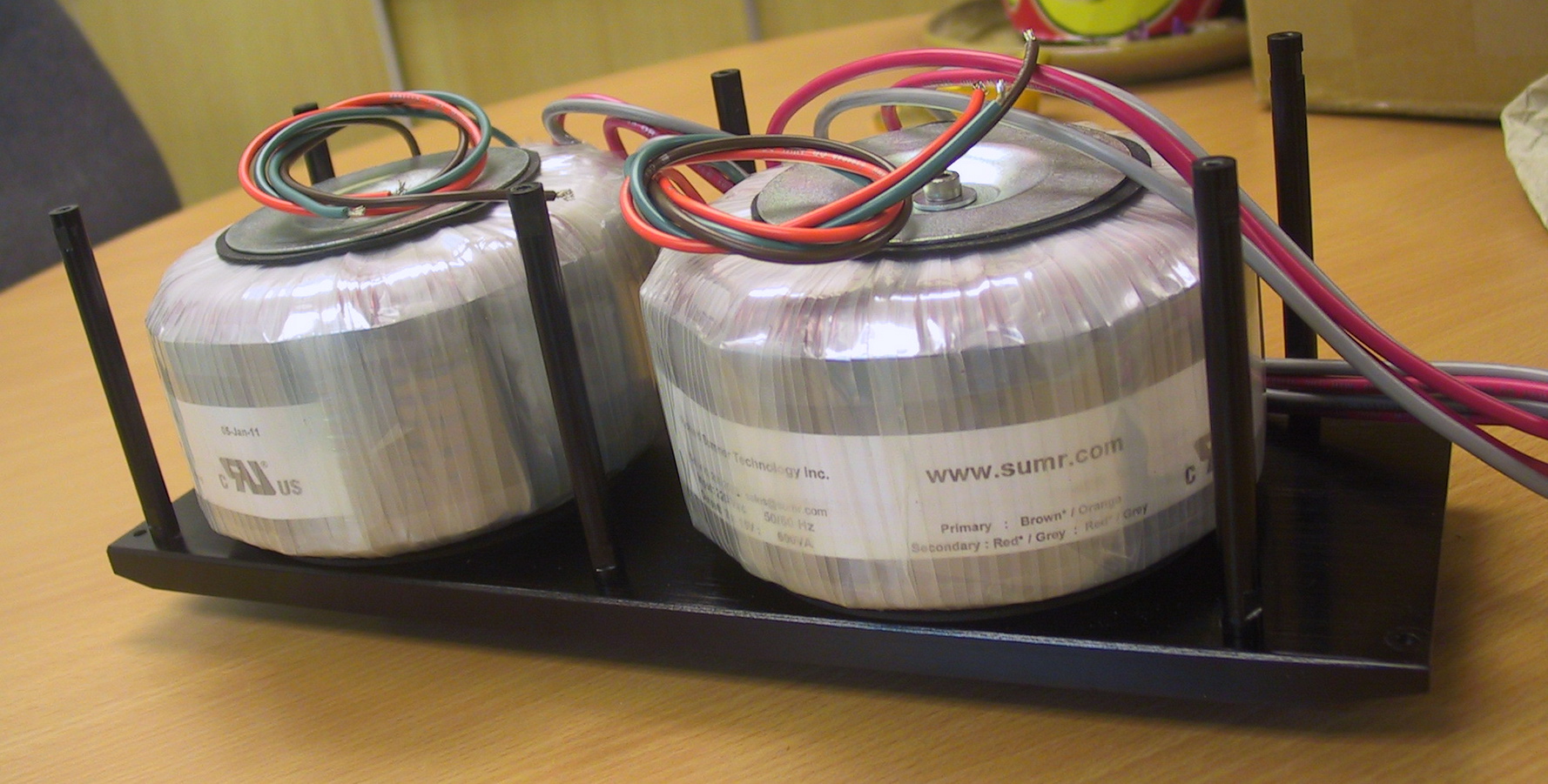

The SumR toroidal transformers mounted on the cradle with feet directly underneath.
Imagine a 3mm thin bottom plate instead.
Patrick
I have an arc welder that looks less robust than that! 😀
