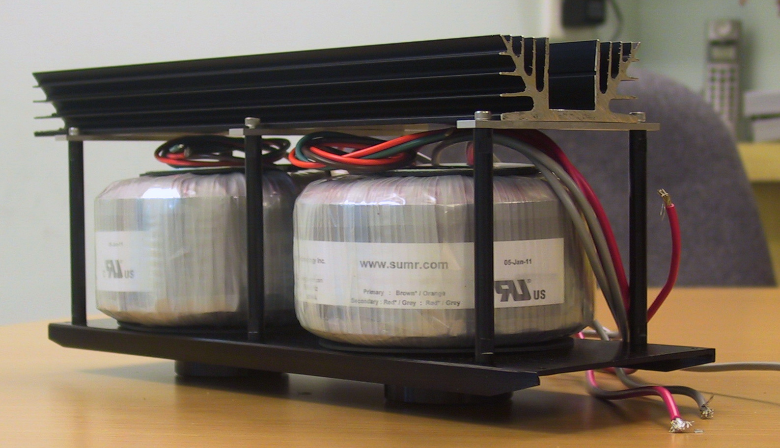

Another update -- Cradle with Transformer with the regulator heatsink.
This is only mock up for taking an early picture, as the sink has to be cut into 2 pieces with a 20mm gap in between, so that air can flow over a smaller length of the sink (factor of 8 less flow resistance).

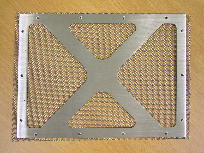

I know you probably can't do much now, but if people like the mesh I think I would make the X fatter. That is make the legs of the X fatter so they extend closer to the corners. Either way it looks great.

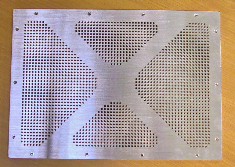

To enable trouble-free assembly for all, CNC drilled is standard :

The mesh is not easy to mount tight onto the frame without distorting.
They were sourced by Mark from a local hardware shop.
But you can get good ones from McMaster-Carr.
Not cheap though.

Gees--how much CNC time did it take on the machine to drill all those holes? 😛
