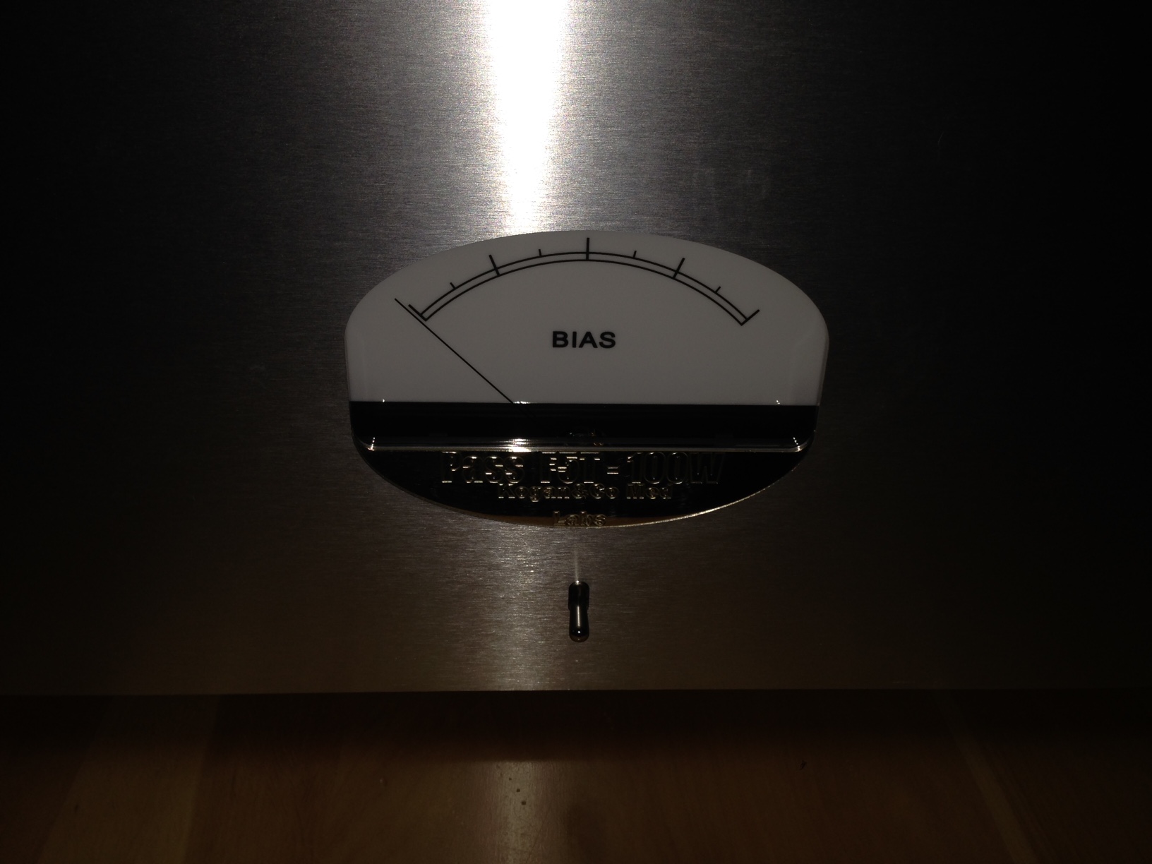

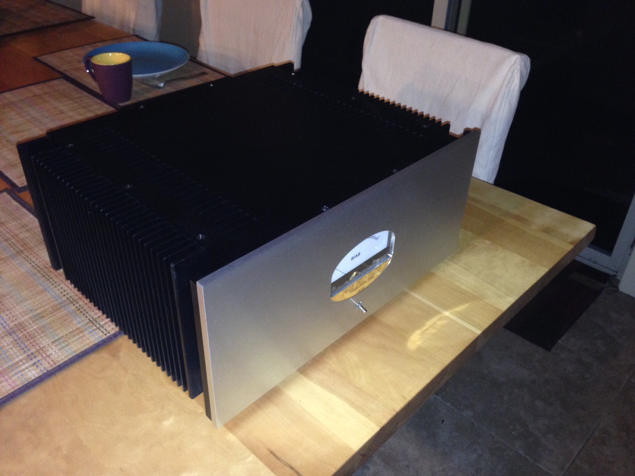

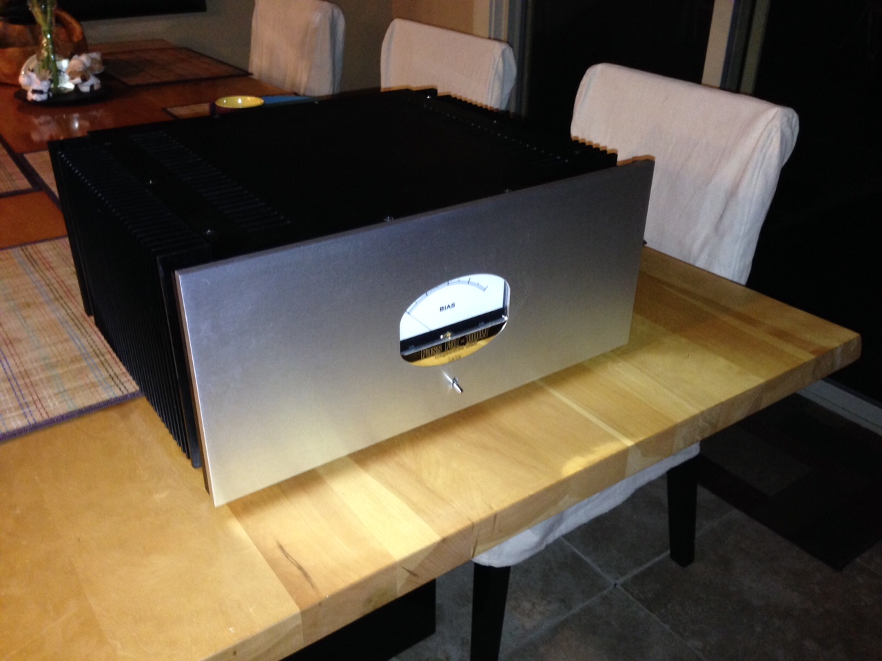

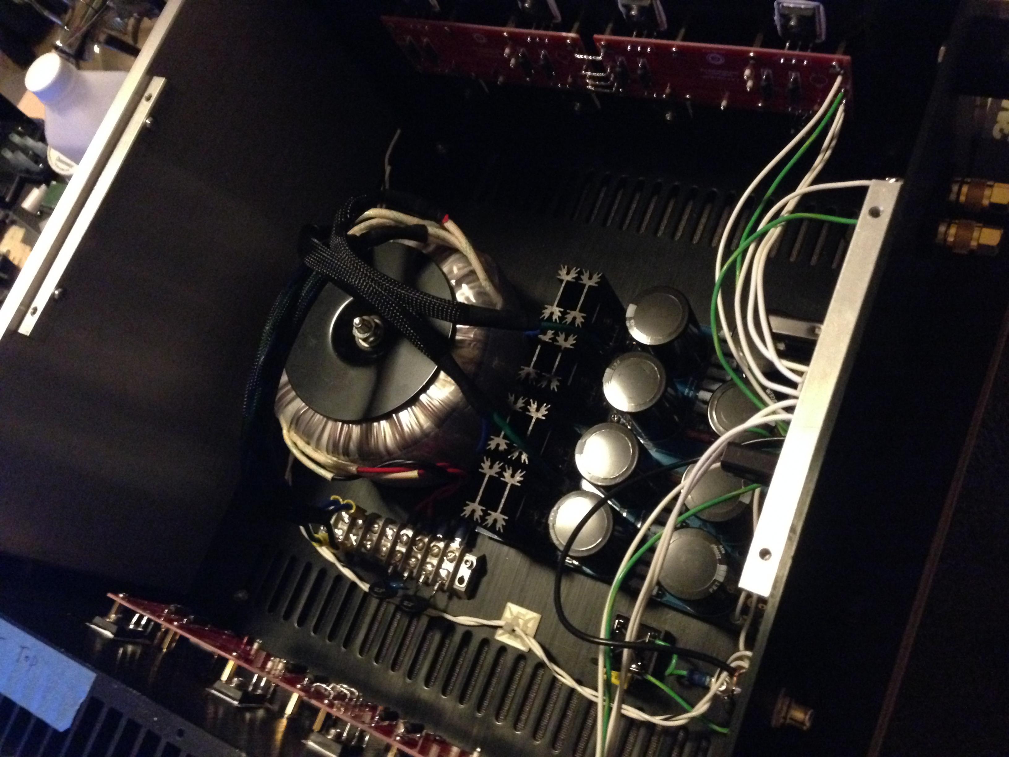

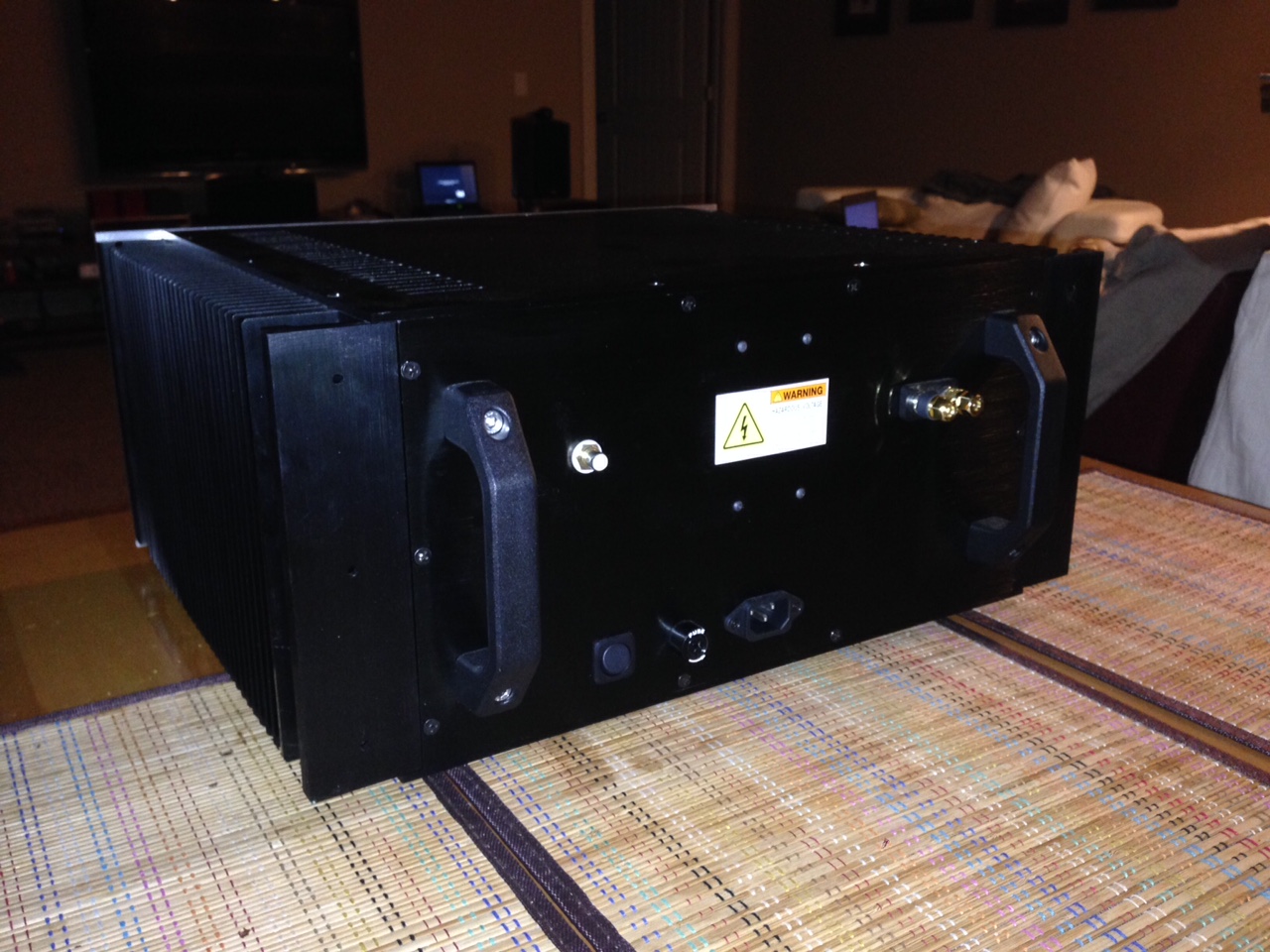

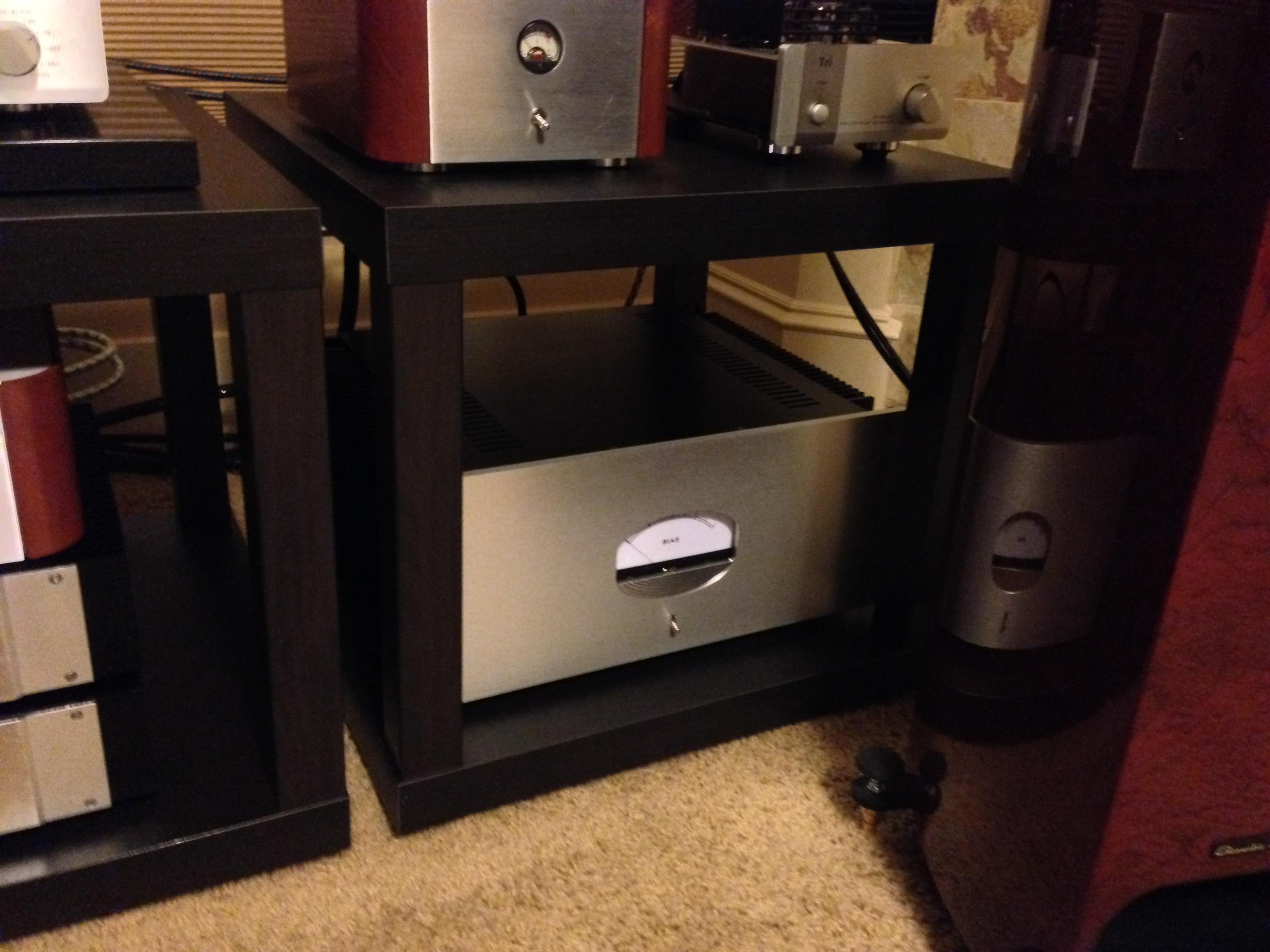

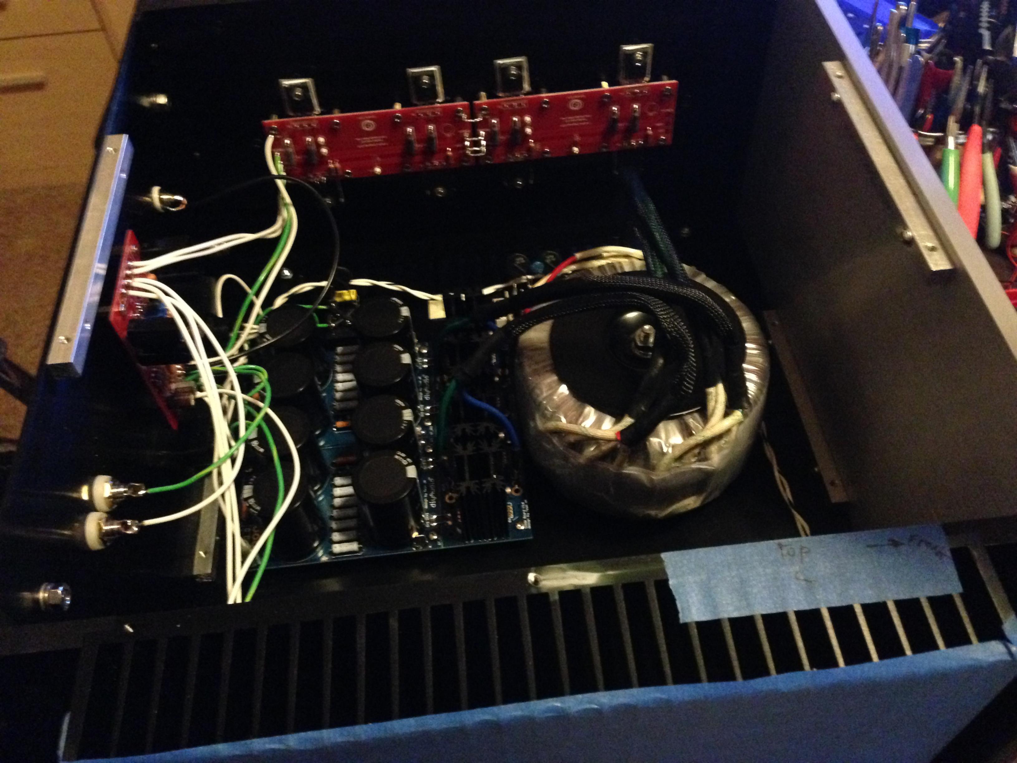

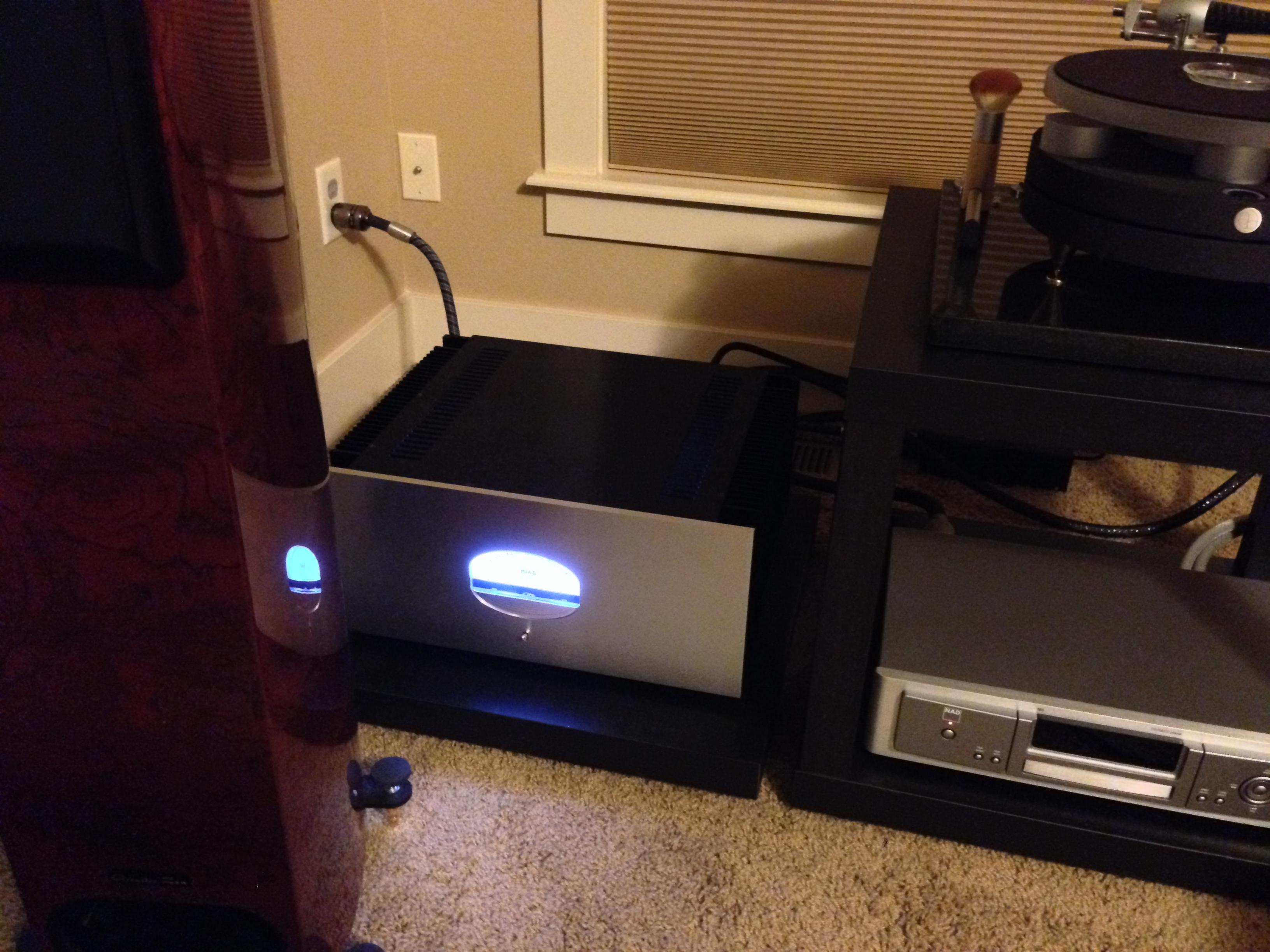

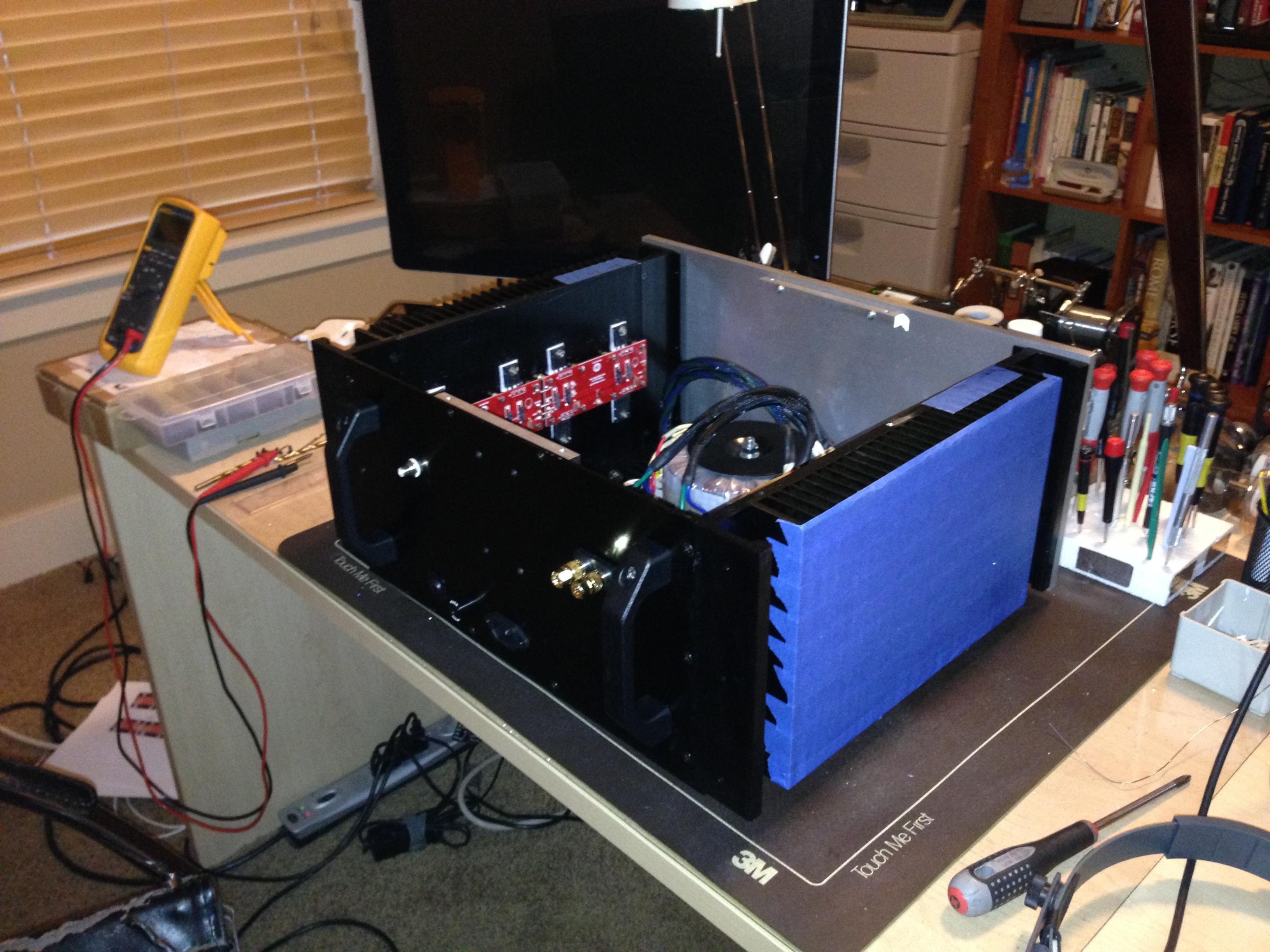

I finished my F5T. With 28V DC I have about 65W into 6 Ohm on my monoblocks. Please see attached pictures.
Great help from 6L6!!!! Thank you 6L6 a lot.
Still waiting for the front “half-moon shape” brass pieces, but it is cosmetics…
It is sounding very good to me. I tried to adjust P3 to min distortion and I used some local audio repair shop since I do not have distortion or spectrum analyzer.
My Bias is set to 1A (470mV) and MOSFETs are Toshiba 2SJ201 / 2SK1530.

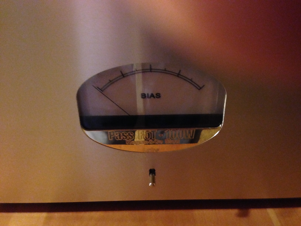

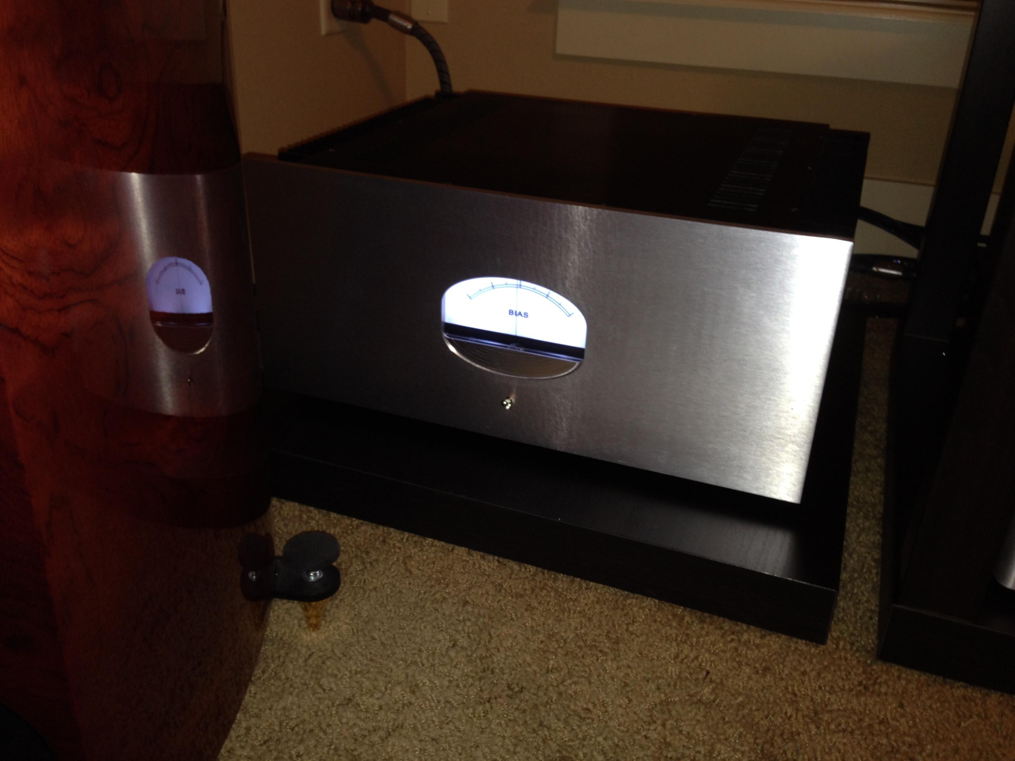

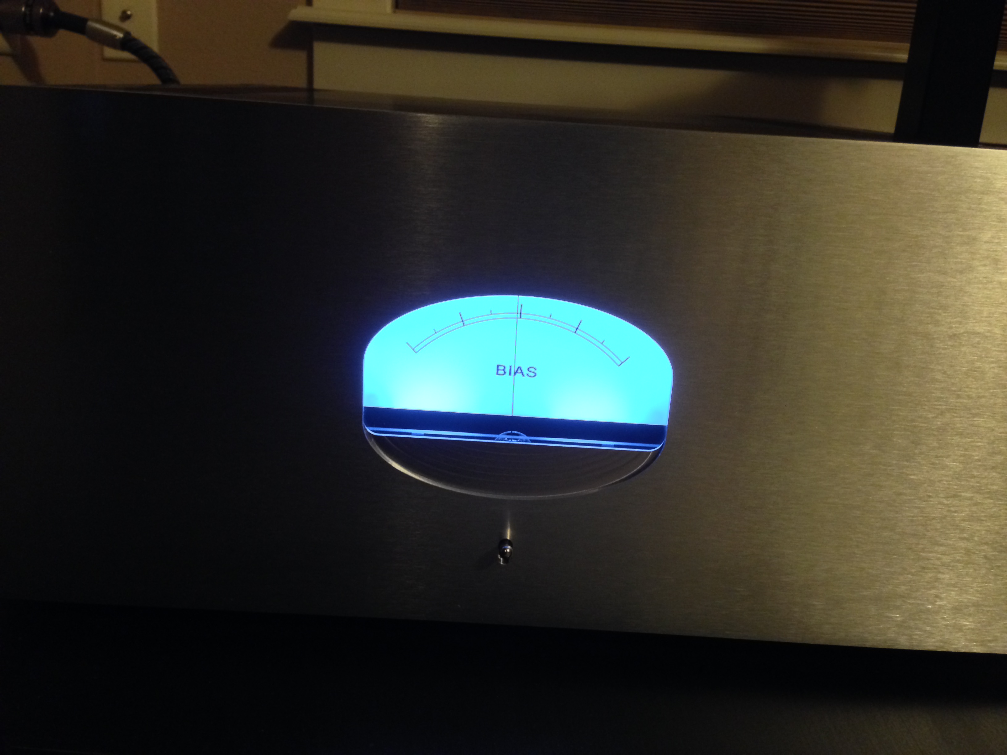

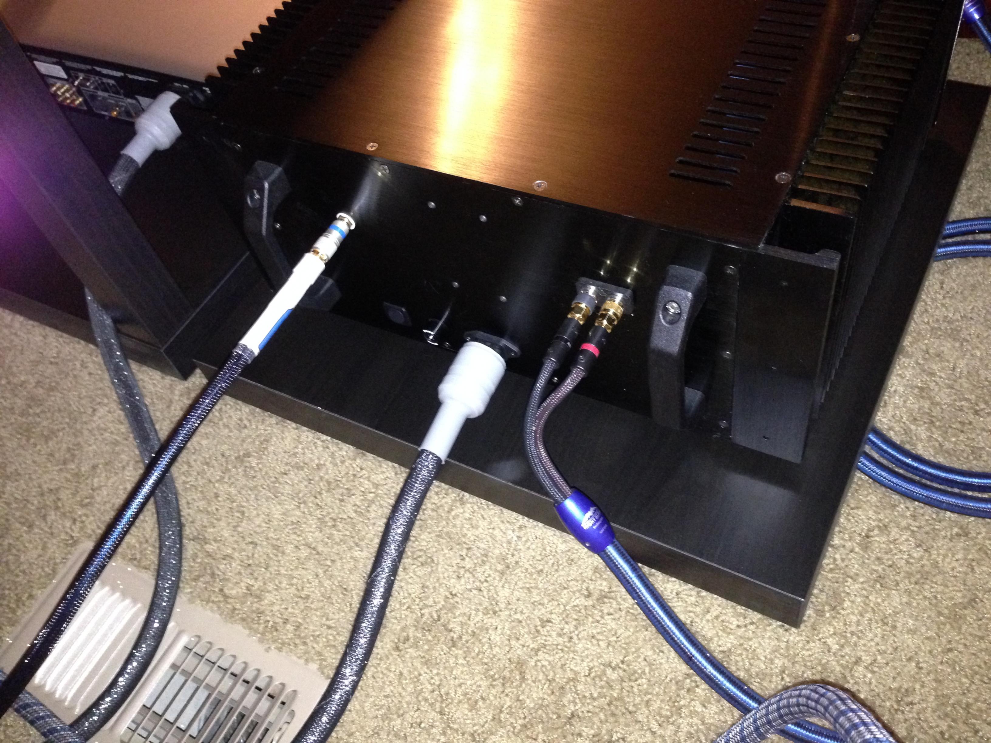

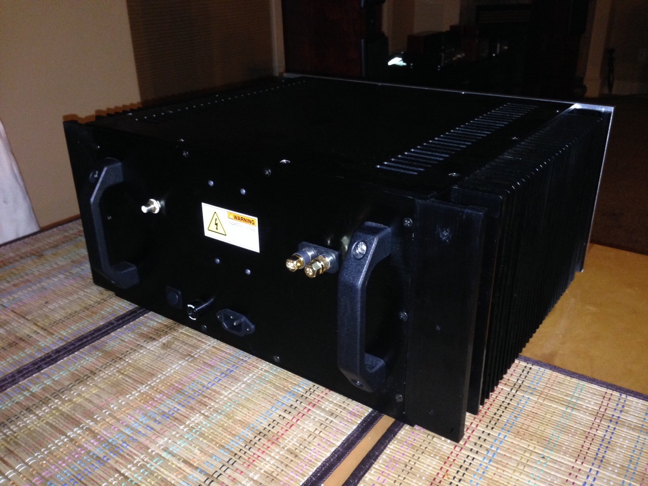

I'm done with my F5T final touches and P3 adjustment. It sounds fantastic now and it is hard to describe that in writing. I acquired HP 339A analyzer and with tremendous help from 6L6 got very nice/transparent/detailed/fresh/lifelike sound. Thank you a lot 6L6. Accomplishment with such project will be impossible without your knowledge and experience.
