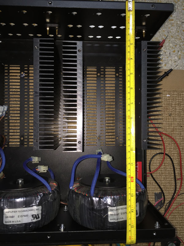

Transformer Question New Build
Hi All
I have 2 old 16 chl Crestron Amps, built by ATI, and as I have no use for such a beast, and it's not really that valuable anymore (Check ebay) I have decided to try and re-purpose them into something better.
All of the components and chassis are very nicely made, and seem well suited to become a F5T v2, or possibly even v3's. (Have a look at the re-configured chassis below) Although only 4U, they are a bit deeper than the chassis offered on the DIYaudio store, and the heat sinks configured in this way seem reasonable.
The only concern is the transformers, they have 4 center tapped secondaries, as the 2 transformers then had 8 secondaries combined, to power the 8 stereo pairs (= 16 channels) of the original amp.
According to the ATI website, these transformers are built in house, and I don't seem to be able to get much information on them, other than measuring them myself. The Secondaries are 32-0-32, and the original power supply (Measured from amp before gutting) produces +/- 40VDC.
The TOTAL VA rating of the transformer must certainly be capable of powering the F5T, certainly with 2 in the chassis, and I have room in there for 2 x DIYaudio PSU's, so would be a dual mono in one chassis.
....but to get the required VA from these transformers, I would like to connect the 4 secondaries in parallel, so that I'm using the total VA capabilities of the transformer.
Can I do that ?
Does anybody here have any experience with such a concept.
If I cannot do this I don't think these transformers would be suitable.

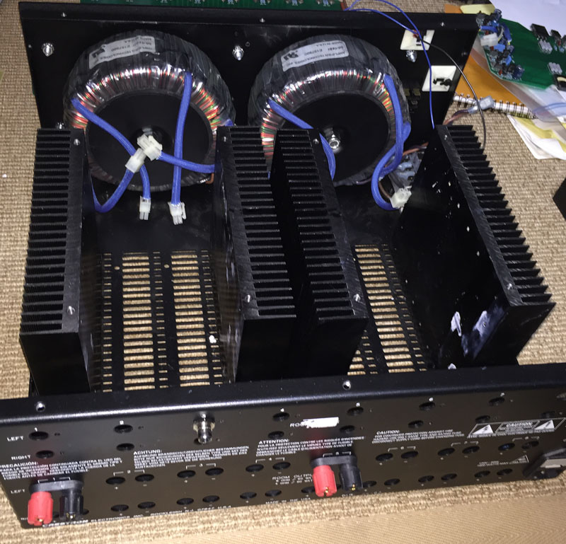

I have attached a pic of the chassis stripped out of the original components and ready for some new guts, re using these transformers would be prefferable, and VERY cost friendly.

Are there 3 or 4 connected wires in each plug at the end of the blue cables? Multiple CT present a problem.
Does the transformer have dual (universal) primaries?
Those heatsinks are small, you will likely need a fan. Probably something low-speed will be fine, but those inside the chassis will not be super efficient.
There are 4 connected wires on each plug, but I seem to remember that 2 are shorted together. I'll double check when I get home.

The chassis is 400 mm deep, each heat sink is approx 190mm, so for some quick research of the 4U and 5U chassis offered on the DIYaudio Store, I think the overall amount of surface and material is somewhere between the 4U and 5U, Yes the center 2 sinks would be less efficient, but I can drill some new holes to mount the sinks further apart, and try and create more space between them if this project seems fisable. I just used some existing holes to breadboard the concept.
I can also create openings in the top and bottom cover to allow more convection, as in my Madrigal Proceed 5 Chl Amp.
I would mount the FE board on the rear panel, next to the input RCA, and O/P Binding Post, and there is enough space between the transformers and the heat sinks for the DIAAudio PSU Diode boards, and space between the sinks for the PSU Cap Boards.

Also I will accurately measure the heatsink dimensions and weight, and can more accurately compare them to what others have used here on the forum.
Thank you very much for the guidance, re using these chassis (and a lot of nice components from the PSU's and Amp PCB's ) will allow me to build a couple of nice amps for a few hundred dollars worth of DIYaudio PCB's and some MosFets.

I think you have the makings of a very nice amp. Worst case is you need new transformers and a fan. Best case, everything works as-is.
Either way, it seems pretty good. 🙂

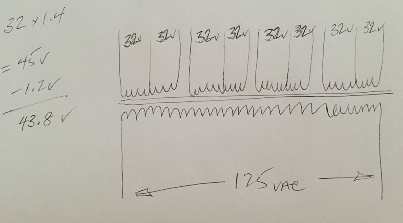

I have had a chance to measure the continuity of the secondary coils of the transformer.
The 4 wires coming from one lead are 2 independent loops.
This appears to be similiar to the Antek transformer <IMG_2282.jpg> in your post #192 on page one of this thread. http://origin.dastatic.com/forums/gallery/data/500/IMG_2282.jpg
On the PCB's of this donor amp, in the power supply section, two of the wires are are connected to the same point.
So looking at the build thread and, the PSU v3 boards, these transformers seem to be suitable, so the original question remains ...
Can I connect the 8 secondaries in Parallel, to use the entire VA capabilities of these transformers ?

connect each secondary to own dedicated Graetz bridge , then parallel what you intend
only in that way you can prevent current mess , which is result of (always existing) even slightest mismatch between secondaries
only bifilar (and more ... tri... etc.) windings are equal enough for paralleling

Hi Zen Mod
Apparently according to the manufacturer of the transformers they are Bifilar,
ATI Amplifier Technologies About
But I did also consider the possibility of rectifing first, then paralleling the DC, before the CRC filter. as mentioned in post # 153 above
