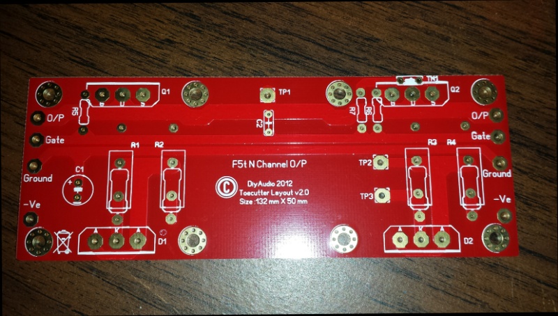

Link is used for balanced configurations. If you're building a single-ended amp, connect Link to Ground.
Your references to R5, R6 and R7 seem off to me. If you're referring to the resistors on the output boards (which are not designated R5, R6 or R7 on the v2.0 output boards), yes, the circuit calls for one 2.2k and a couple of 47R resistors per board (V2 only; for V3, use one 2.2k resistor per pair of output boards). However, you might want to use a higher value than 47R in the gatestopper position (100R to 120R seems to work well).
If you're referring to the front end board, R5 and R6 are 1k resistors. R7 is in parallel with R8 and both are 220R/3W for an effective resistance of 110R. I used a 110R/5W resistor across R7 and did not use R8.

Hi Scott,
The output board seem to be different. See pic.
So if bridging both FE boards would be "Linked".
Got it. Just jumper them...
Vince

Vince:
Scott
no, acctualy you should never use more then 1pc 2.2K pr amp half regardless of number of output boards. 1 for N ch side. and 1 for P ch side. never more. (well. you can put in the resistor on all locations if you want, as long as you don't connect the thermistor that's going in series with it.)
Joined 2004
Vince:
Mea culpa. It turns out I have the v3.0 F5T boards. Sorry for any confusion caused. But the advice remains the same: you need two 47R (or higher) gatestopper resistors per output board and one 2.2k resistor for each of the N and P sides of the circuit.
AudioSan:
I thought I had made the same point as you but, on reflection, your explanation is better because it is conceivable that someone would use more than 2 output boards per side in an F5T V3 build (e.g., when using 8 MOSFETs per side, one would need 4 N and 4 P output boards but still only one 2.2k resistor per side).
Scott
