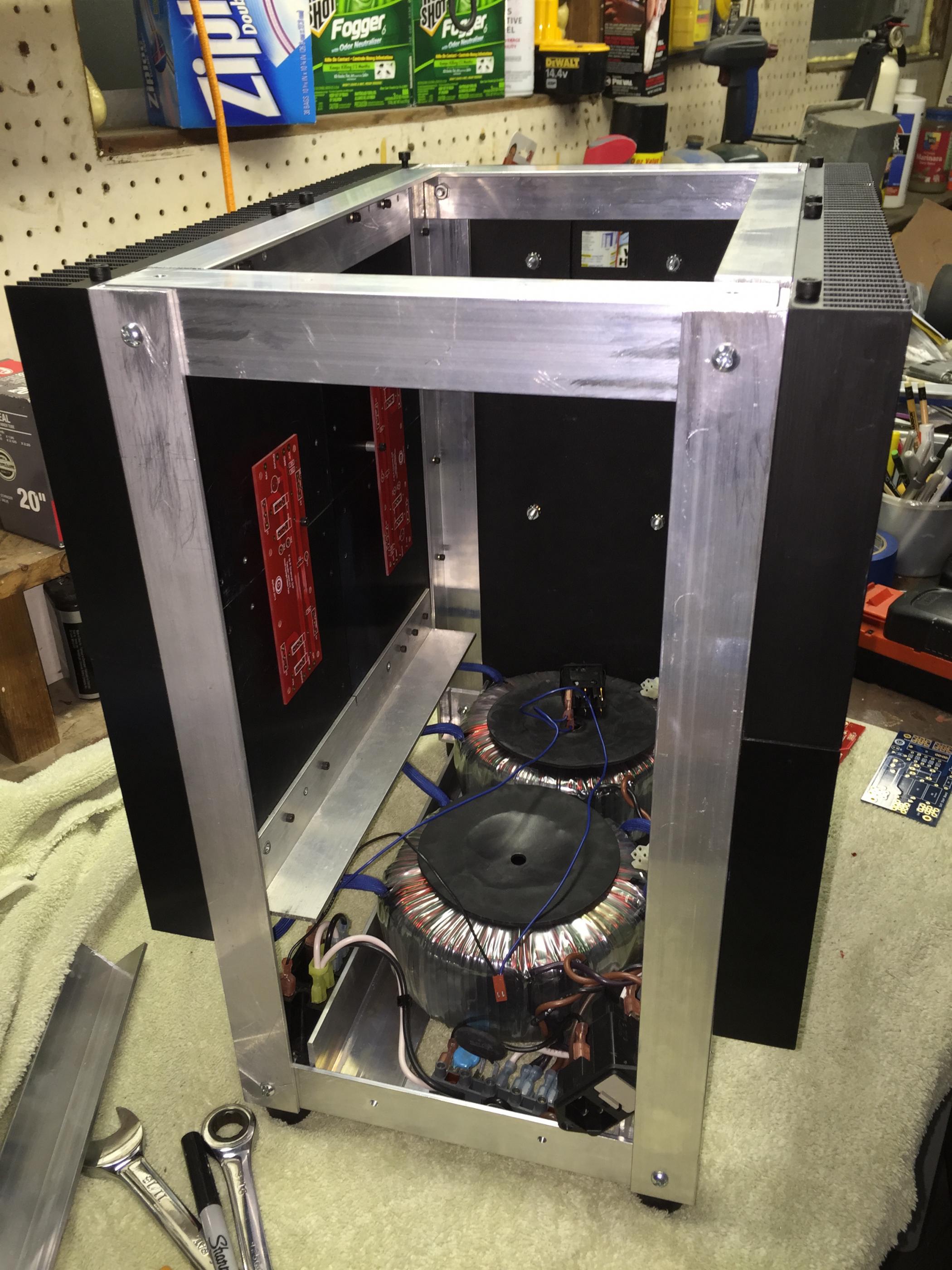

Unfortunatly the F4 PCB's are 250mm long, If I want to use these heat sinks in this chassis, the heat sinks must be mounted independantly, as shown in my previous post. And they are only 190mm long. http://www.diyaudio.com/forums/pass-labs/254056-f5turbo-illustrated-build-guide-16.html#post4438260
The F4 boards then just won't fit. The F5T allows me to mount the output boards, 1 per heatsink, with the FE board between, on the rear panel.
I can have a look and see if I can re-arrange the layout, but I'm still thinking that the F5T boards are a better physical match. It's just trying to determine if the transformers are also.

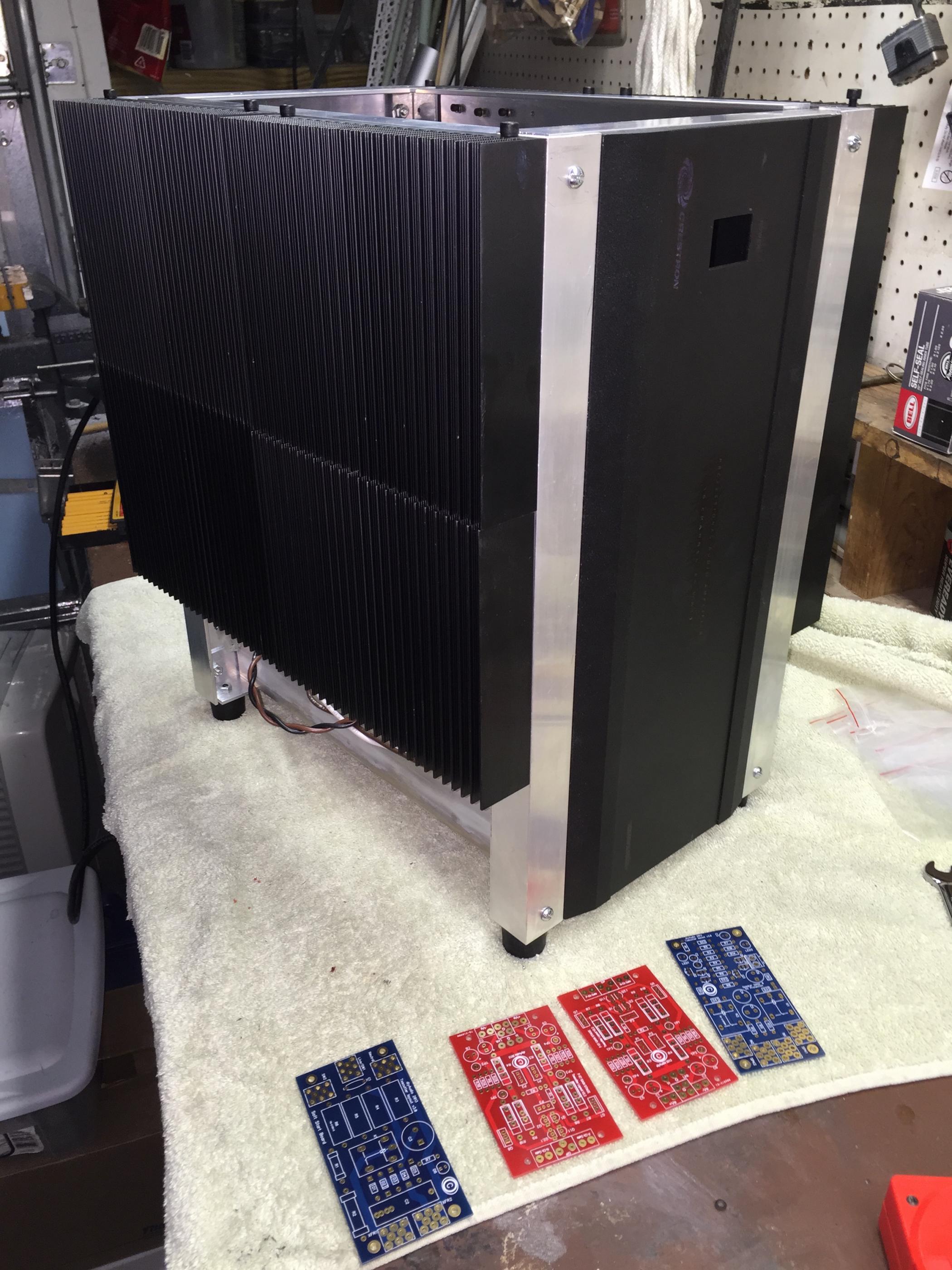

So I have measured the transformer secondaries a couple of weeks ago, and found 0.01VDC difference, so I'm going ahead. I ordered the F5T boards last week, and have just ordered the remaining components from Mouser.
Also, i'm going to use all 8 of the original heat sinks by framing the heatsink and faceplate with some angle aluminum. I'll flip the faceplate over in the final version so that the power switch is at the bottom.

EDIT: for some reason the image wouldn't show proper orientation
I'll post on the other appropriate threads from here on. Is there a recommended thread to post progress ?
OK, Got the image sorted out, here is the front.
I need to go back to the Aluminum distributor to get some plate for the back and top.
