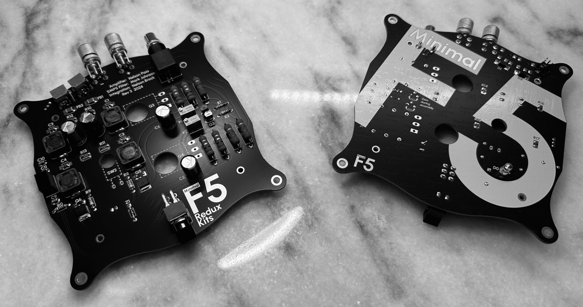

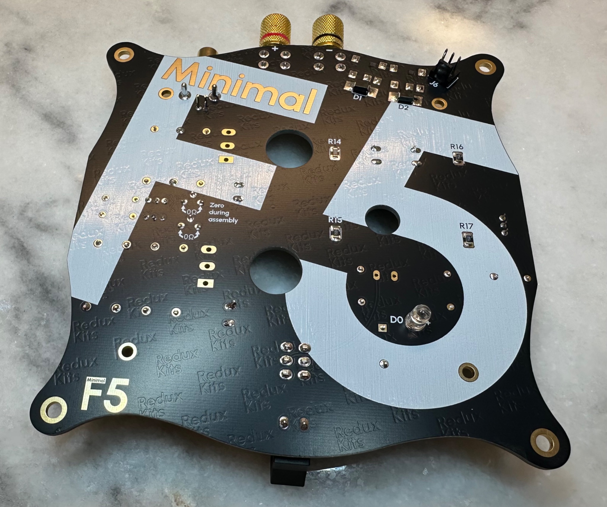

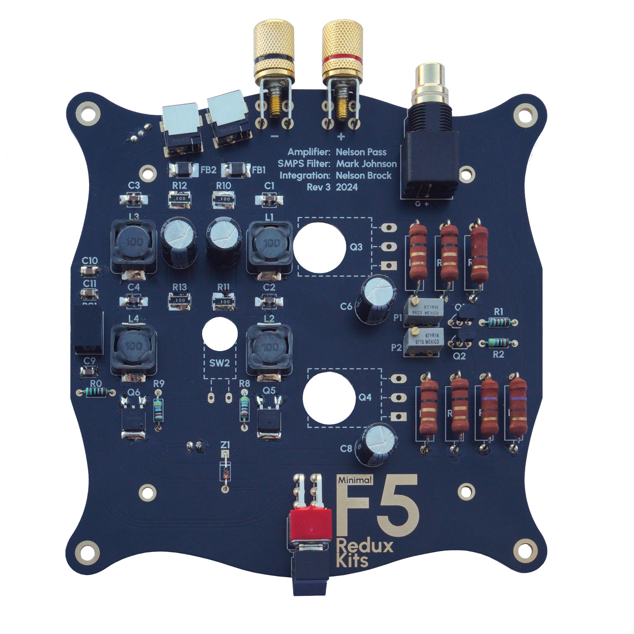

Exciting news all, the F5m Redux is now live at reduxkits.com!

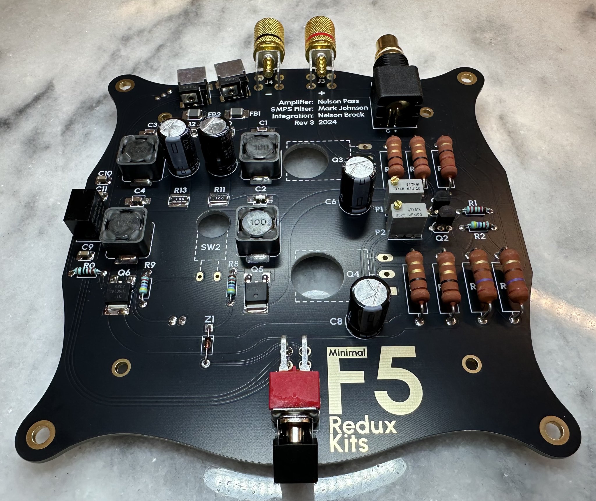

One part change for Rev 3: I swapped the 0.47 degeneration resistors for two 1 ohm resistors in parallel for cooler running and/or more class A bias. New graphics on board as well for a little extra eye candy.
The first post of this thread has been updated with the revised schematic and the kit contents. I am working to get better photos for the listing and upcoming build guide. Thanks to all for your support

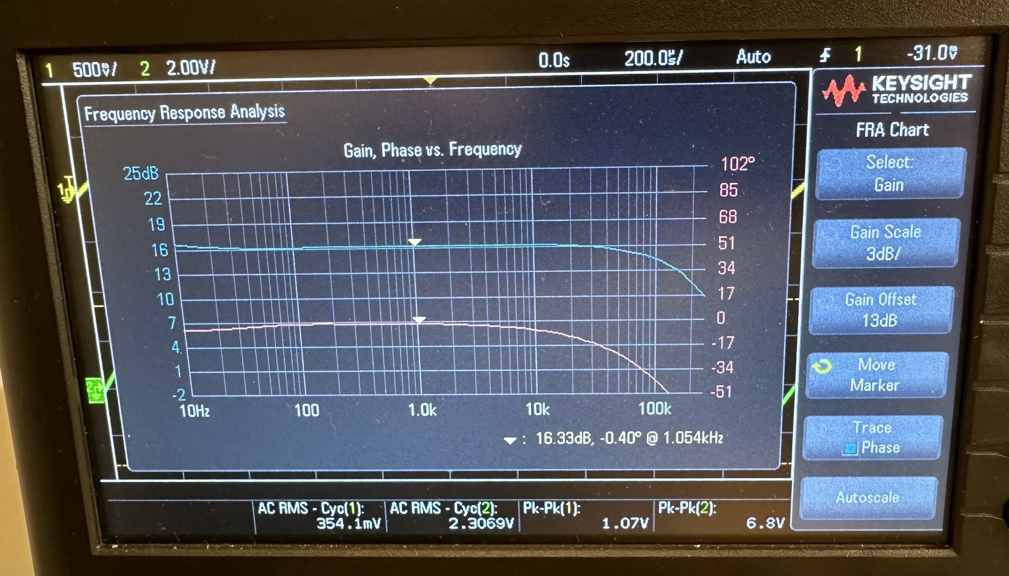

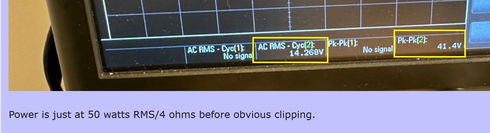

Measurements on scope:
Here is the frequency (blue) and phase (red) response measured at just under 1 watt RMS/8 ohms. Gain is nearly flat at 16.3 dB with a -3dB at around 150Khz. Phase is quite flat and only -17 degrees at 30khz.
Power is just at 50 watts RMS/4 ohms before obvious clipping.
And 28 watts RMS/8 ohms before obvious clipping.

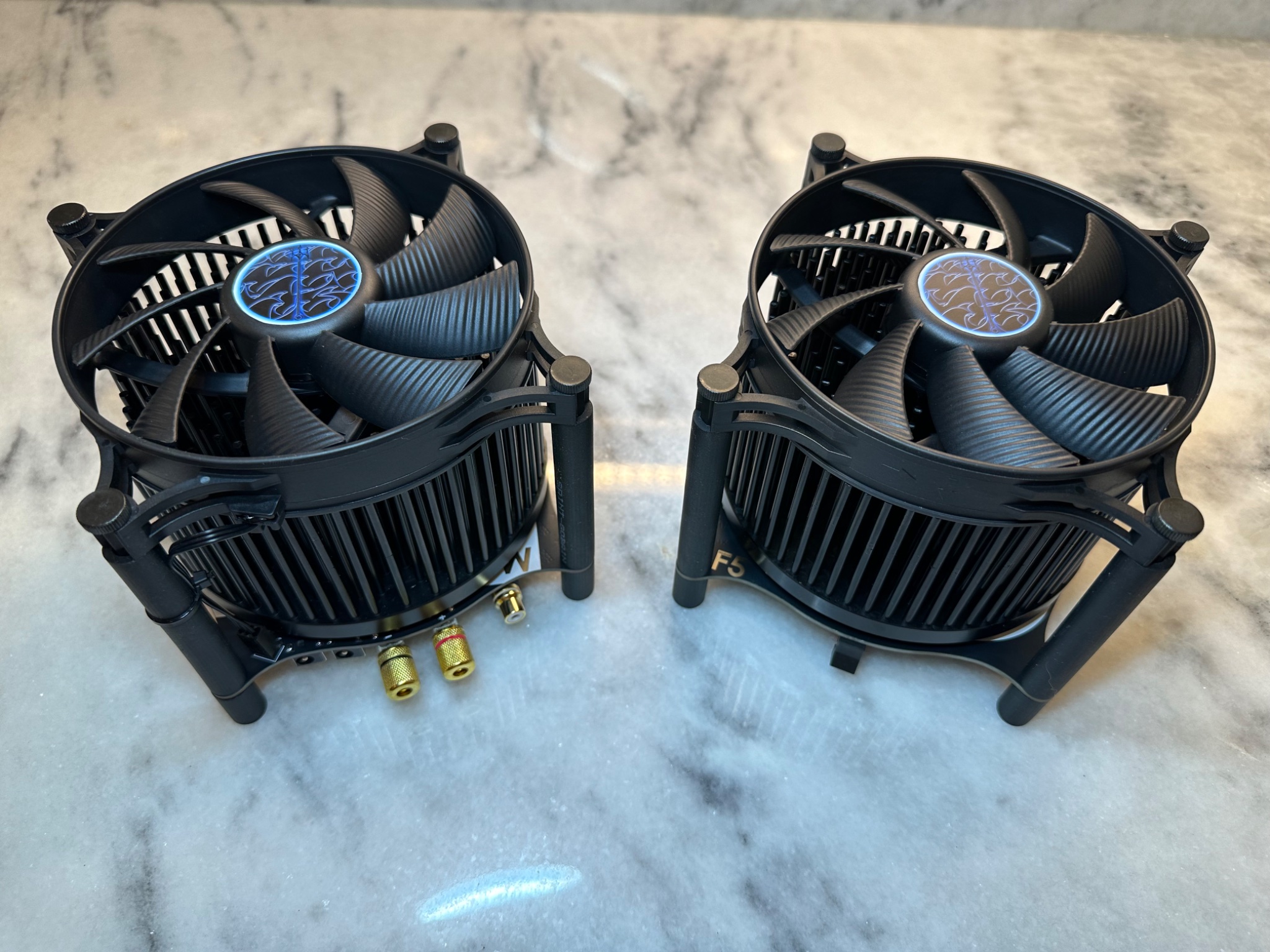

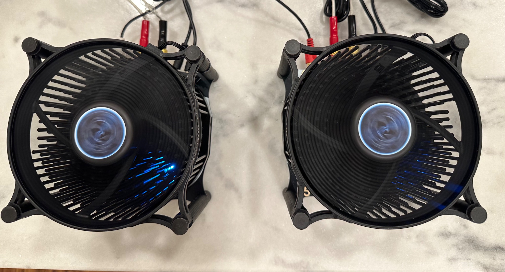

After 20 hrs of continuous play and using my Fluke IR thermometer, pin 2 of the output Mosfets Q3 and Q4 measure ~ 40 degrees C. The exposed parts of the heatsink are around 28-30 deg C.
If you live in the tropics, and want a Class A amp that runs cool, look no further!

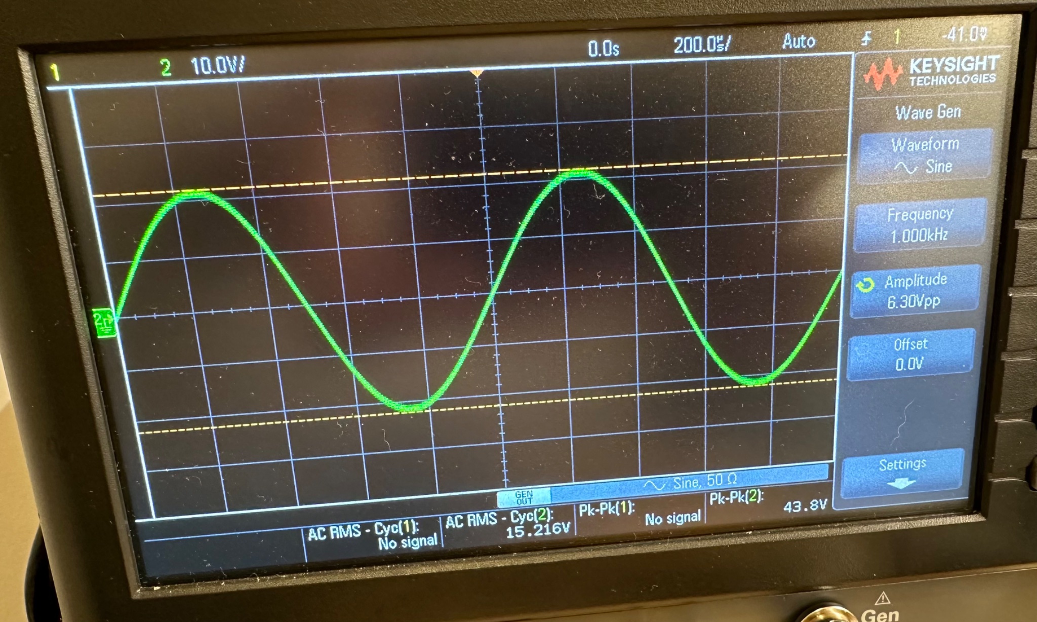

There's something perplexing about those numbers. If it's a pure sine wave then Pk-Pk would be exactly SQRT(8) times larger than RMS. But SQRT(8) * 14.268 equals 40.36V pk-pk, whereas the scope display says 41.4V pk-pk instead. About 2.6% too high.
Do you suppose the waveform is distorted and not a pure sine wave?
Do you suppose the software inside the scope, which performs RMS calculations, is imprecise? That's kind of odd because they display five significant digits for the RMS value.
It's a Hewlett Packard scope, not an off brand crudblob from a steamy sweatshop, so I'm perplexed.
