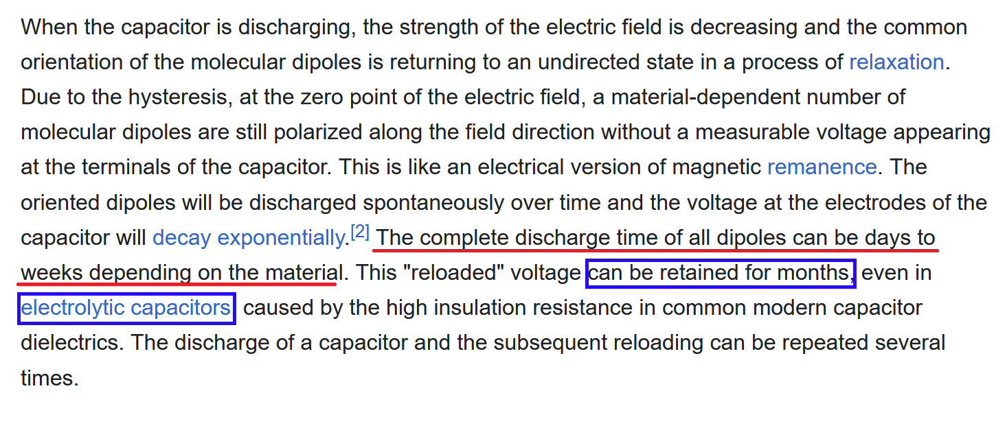

It's either dielectric absorption (Wikipedia article HERE) or else it's a perpetual motion machine.
To check whether it's a perpetual motion machine, connect a 2.2K "bleed" resistor across the output and measure the voltage every 15 minutes. Take eight measurements (over two hours). If the voltage is nonzero after two hours then someone or something is continuously heating up the resistance element [ Power = Voltage * Voltage / Resistance ] despite zero input power. It's perpetual motion!
Dielectric absorption is much clumsier. As the Wikipedia article states, electrolytic capacitors are the worst of all (greatest dielectric absorption) and they take months to fully relax. If that bothers you, calculate your own value of bleed resistor and solder it onto the AmyAlice board's pins. Don't put it at the load, put it at the electrolytic capacitor -- on AmyAlice.

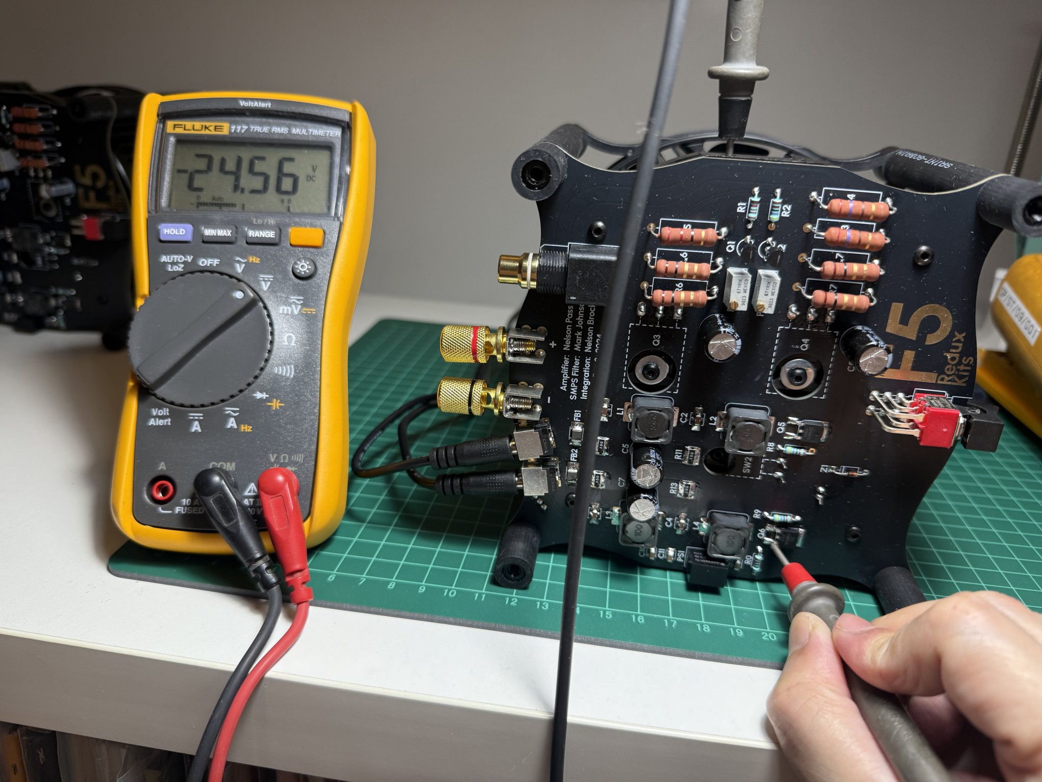

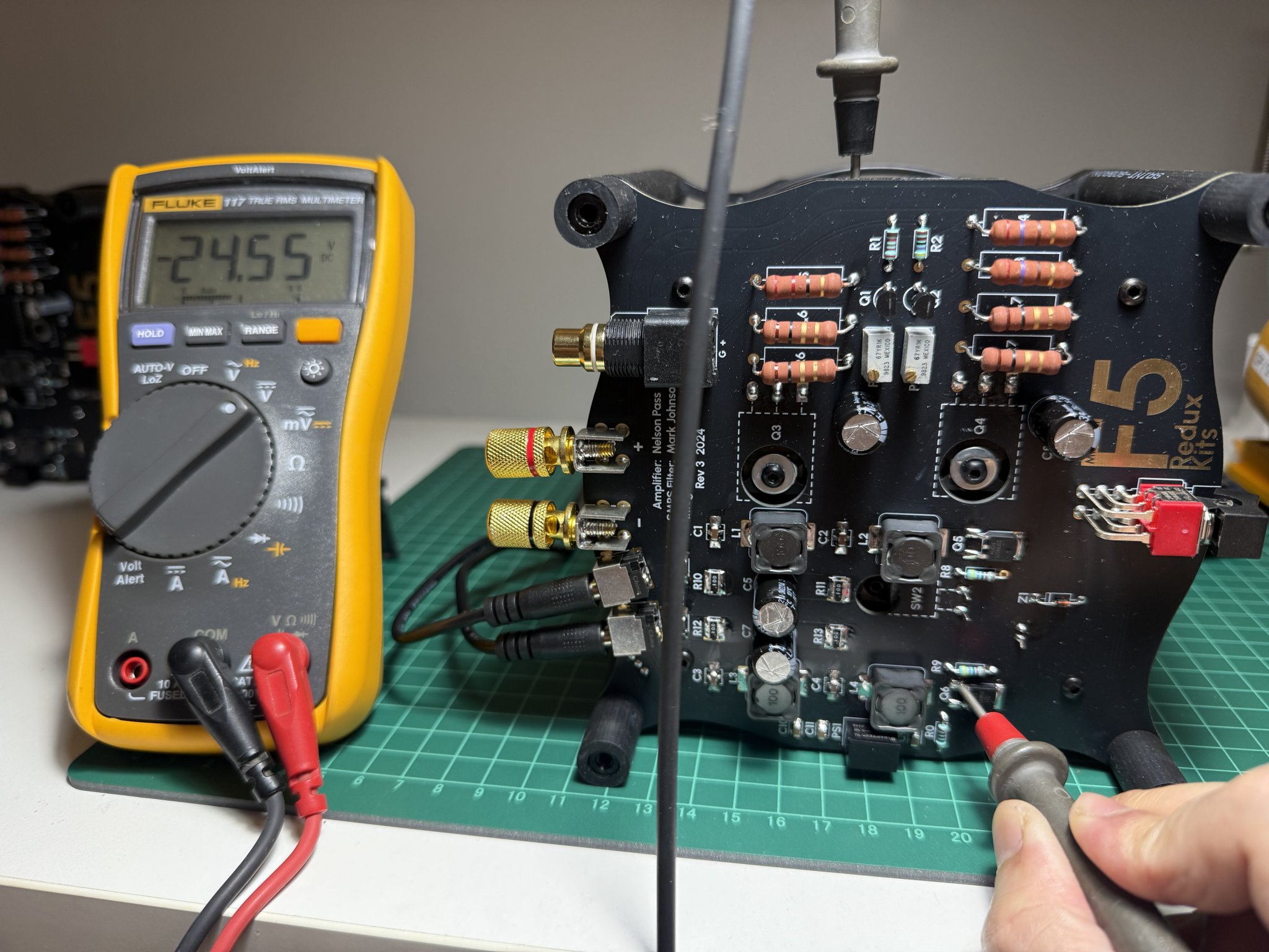

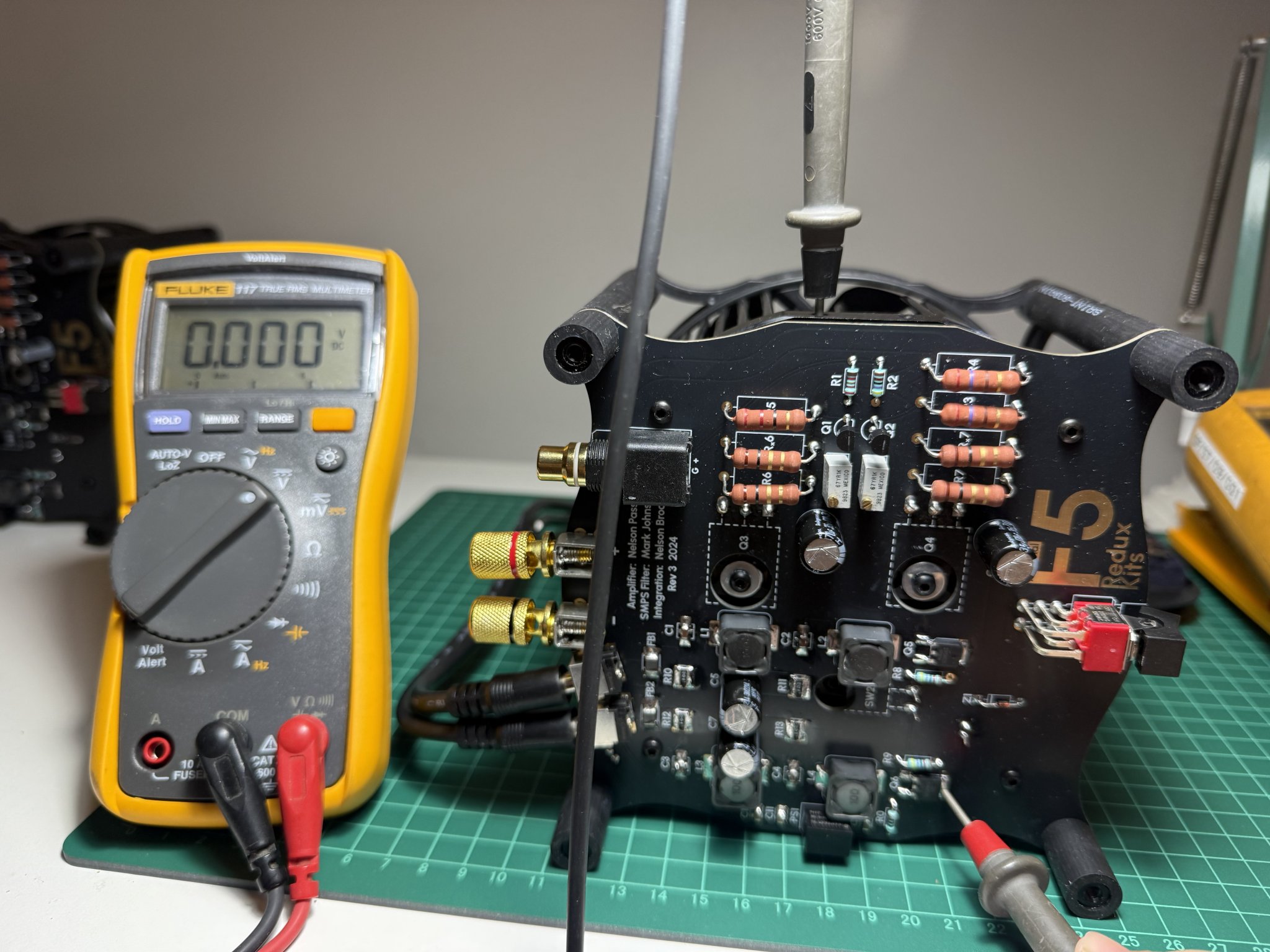

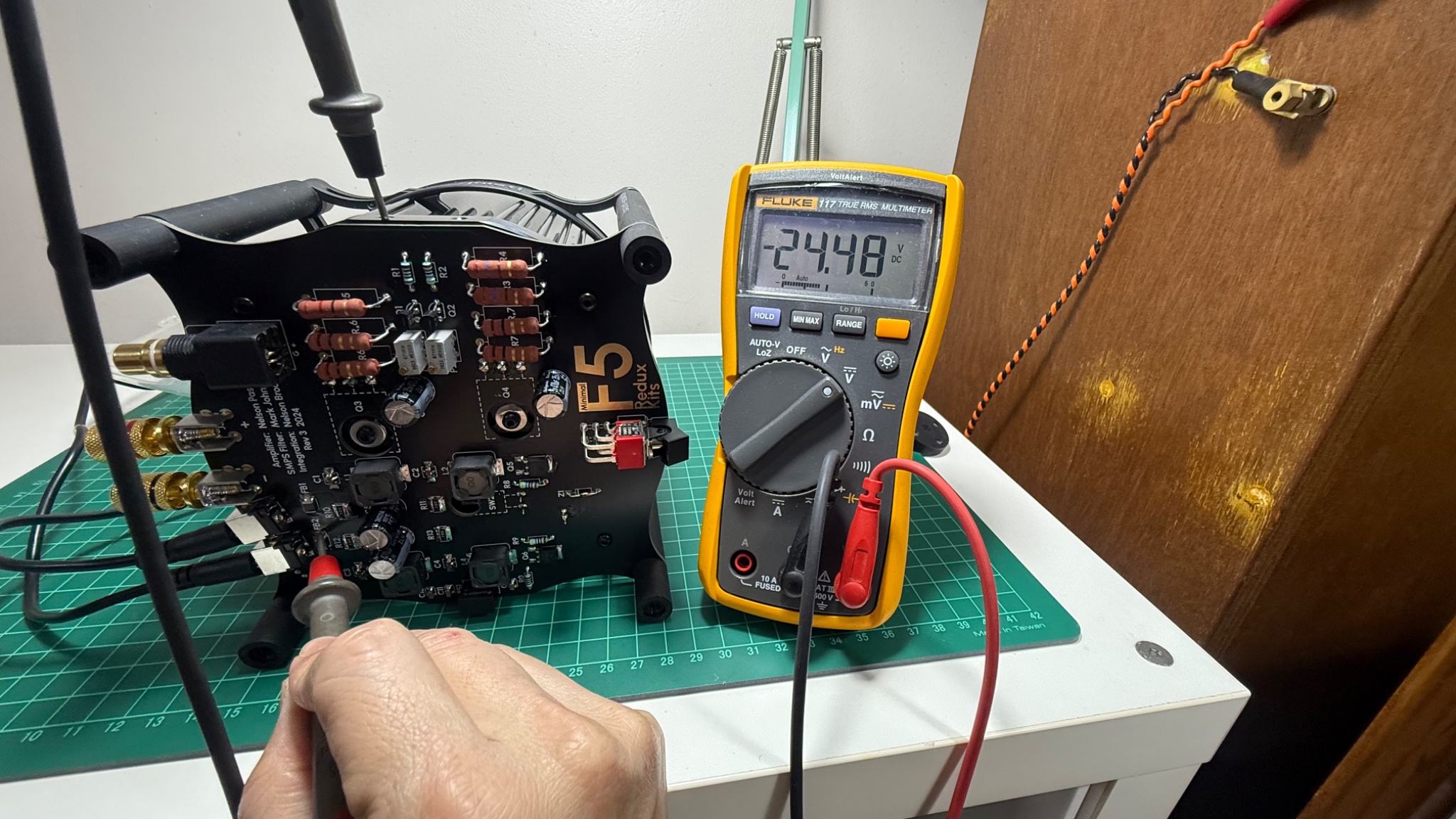

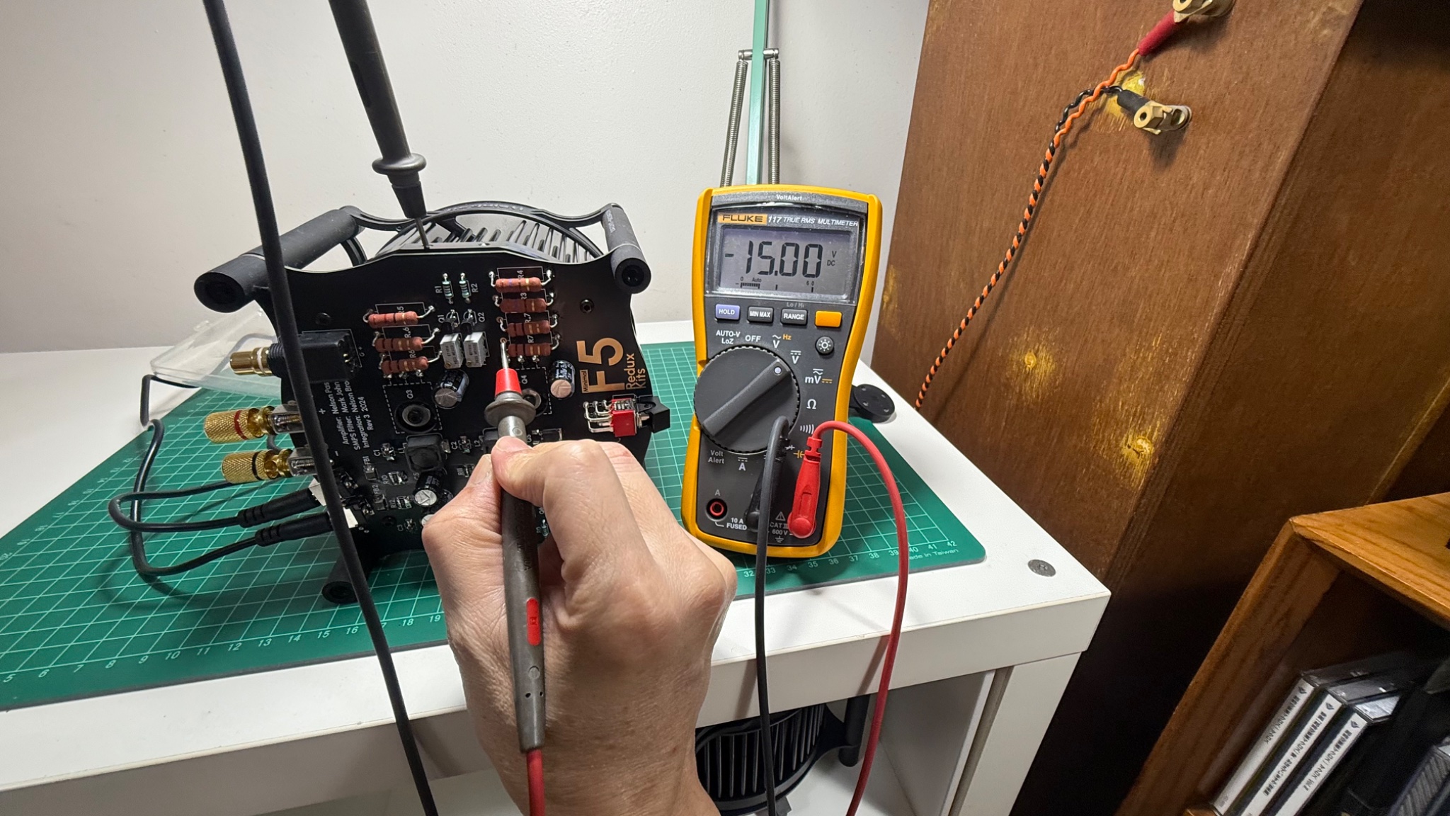

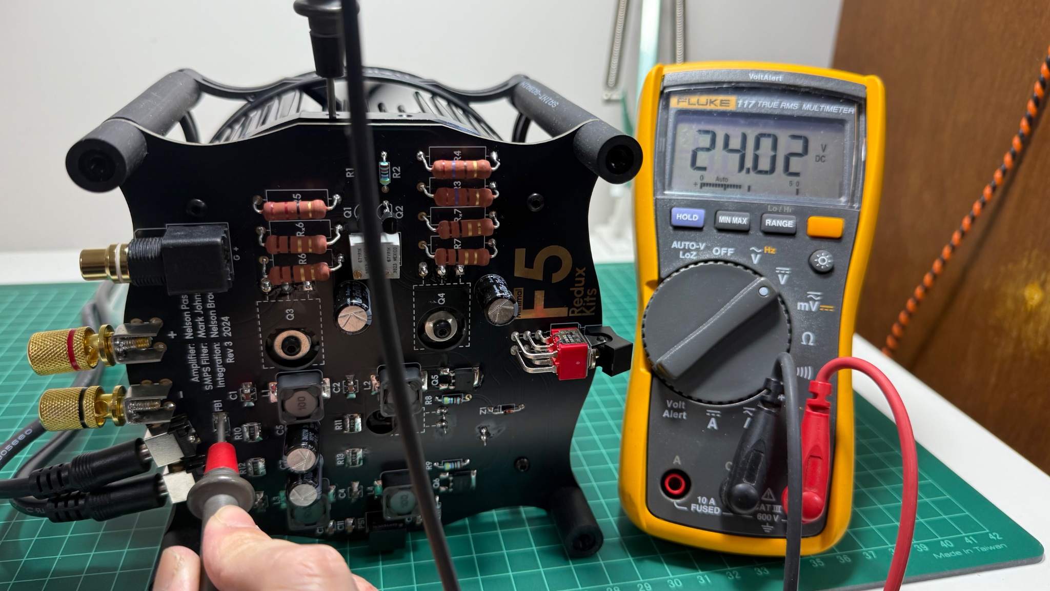

I recently got this kit and have them soldered and assembled.

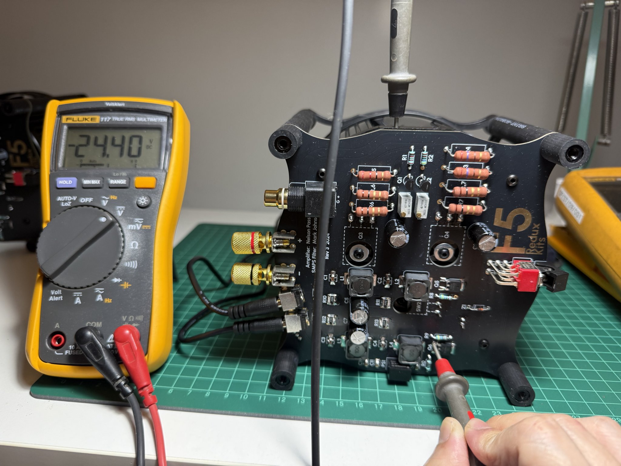

I thought this could be an easy one for me since i have built the B1K and ACA. I have done all the necessary test based on the fantastic video build guide, except that i have problem biasing them (both channels). No matter how many time i tried, the voltage across both R6 & R7 just refuse to go beyond 5mV both my multimeter. I thought I have checked all the solder joints and components orientation, but just couldn’t figure out what has went wrong.
I have done the quality control resistance and voltage (+/-24V) check, but when i measured the voltage at R7 reference to ground, I am seeing only -14v, where at R6 I am seeing a +24v. I wonder that could give some clue to what may have went wrong.

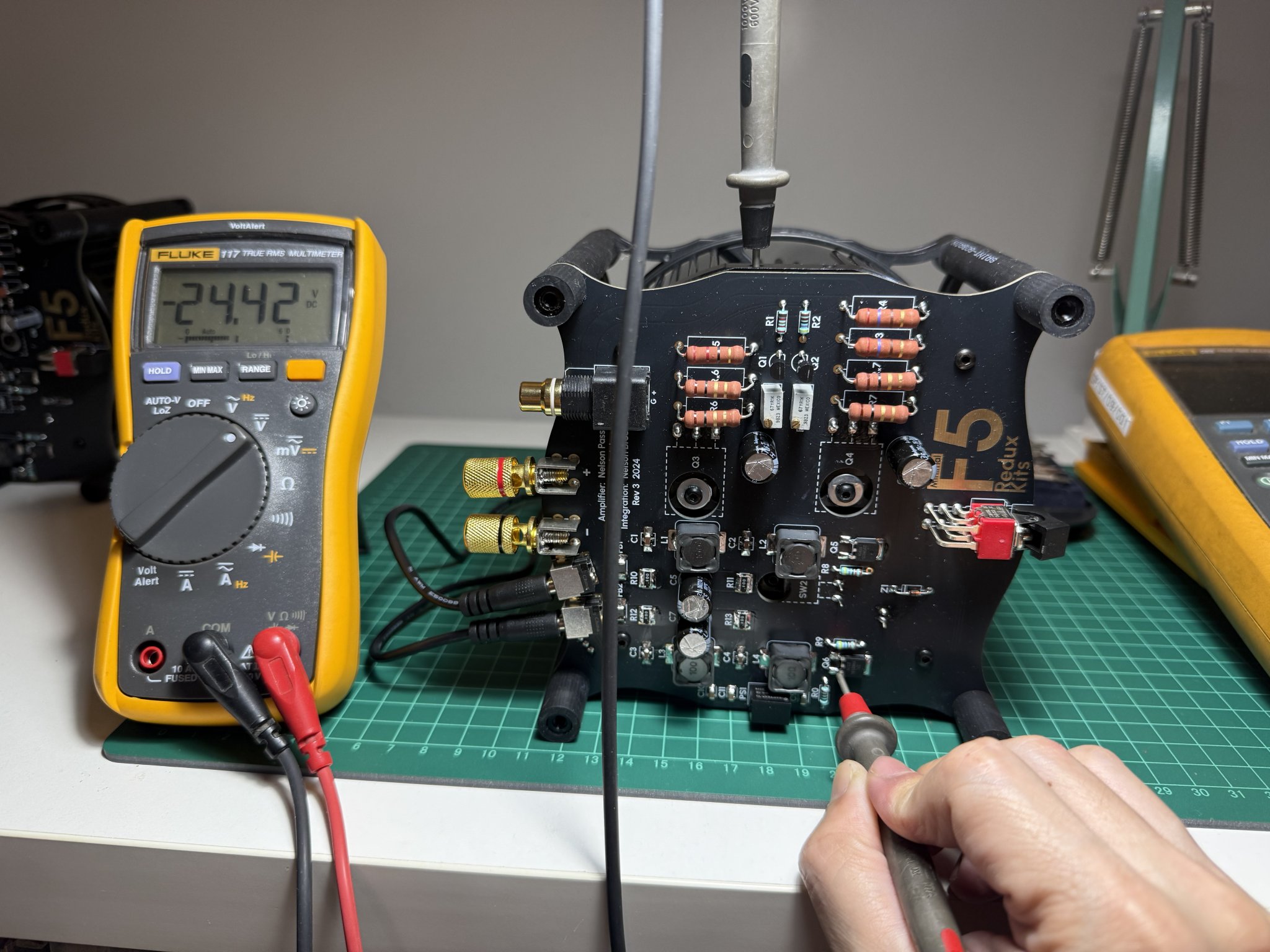

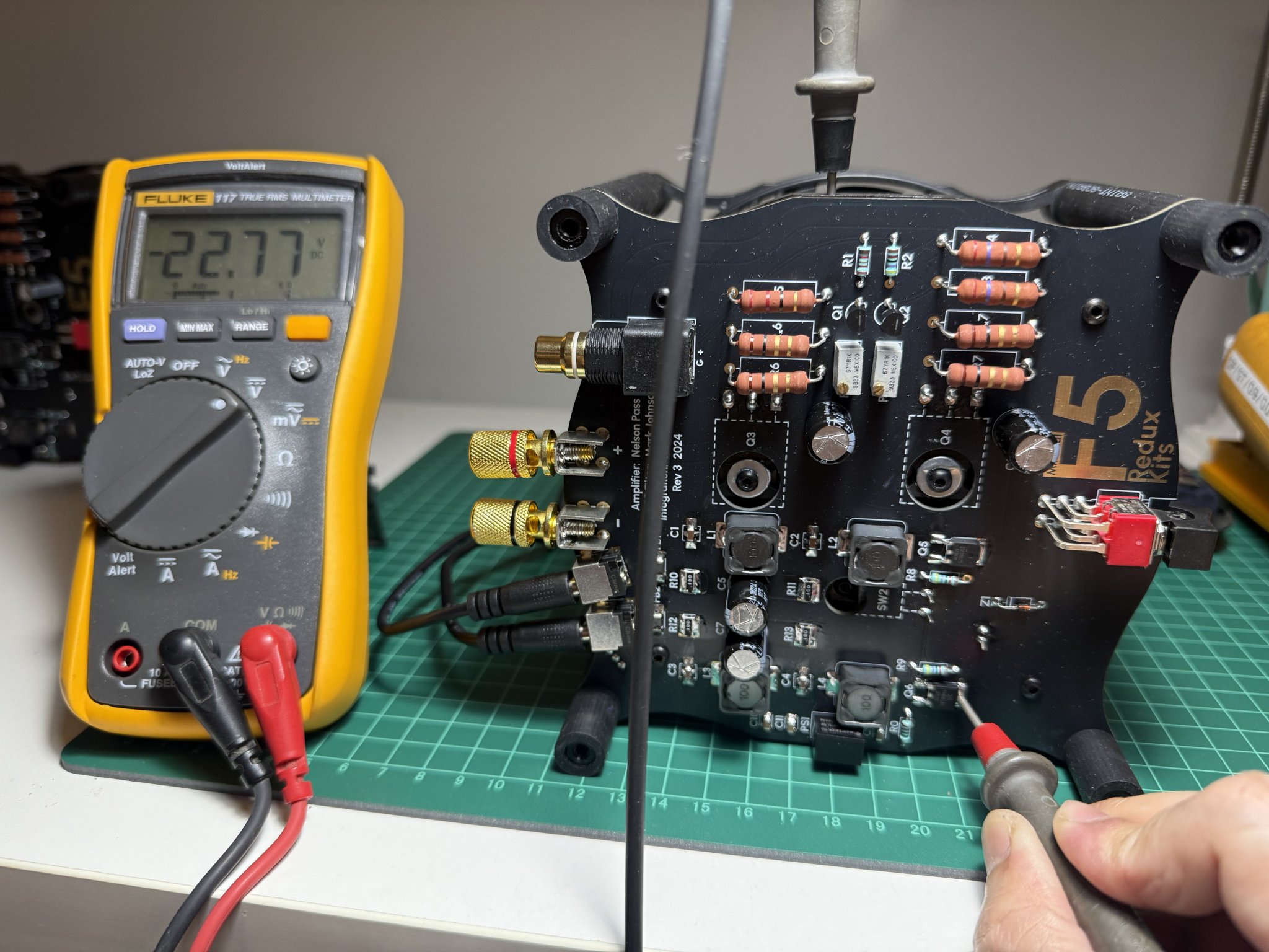

Hi Nelson,
Here are what I tried. Swapping out the pair of power supplies got the same measurement.
FB1 : 24Vdc
FB2 : -24Vdc
R6 : 24Vdc
R7 : -15Vdc
Rgds

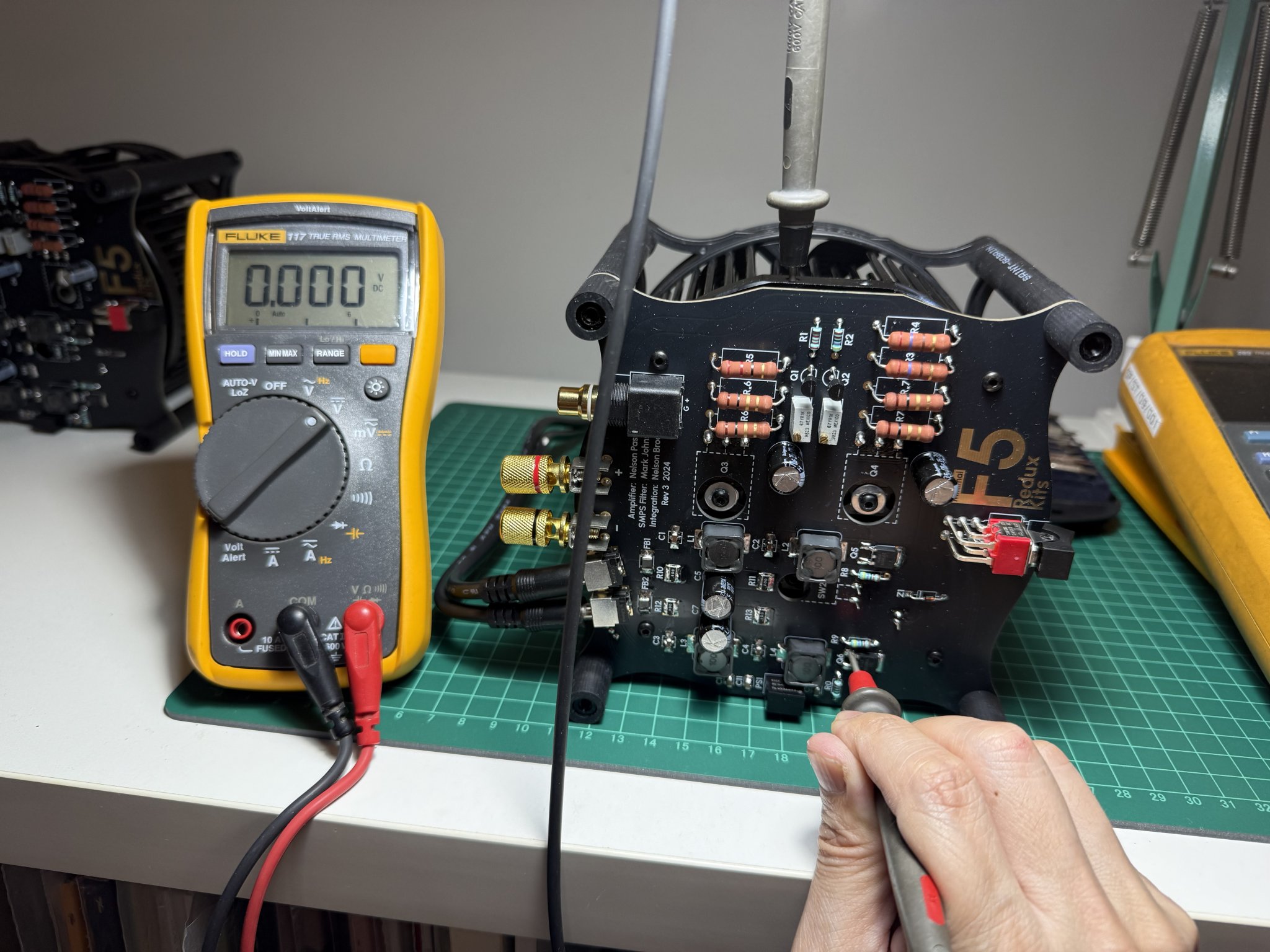

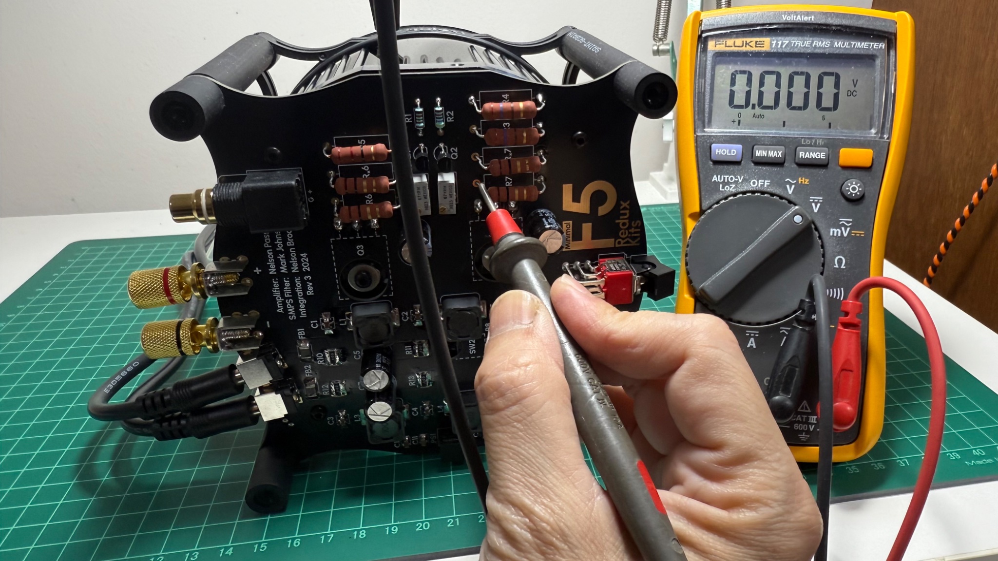

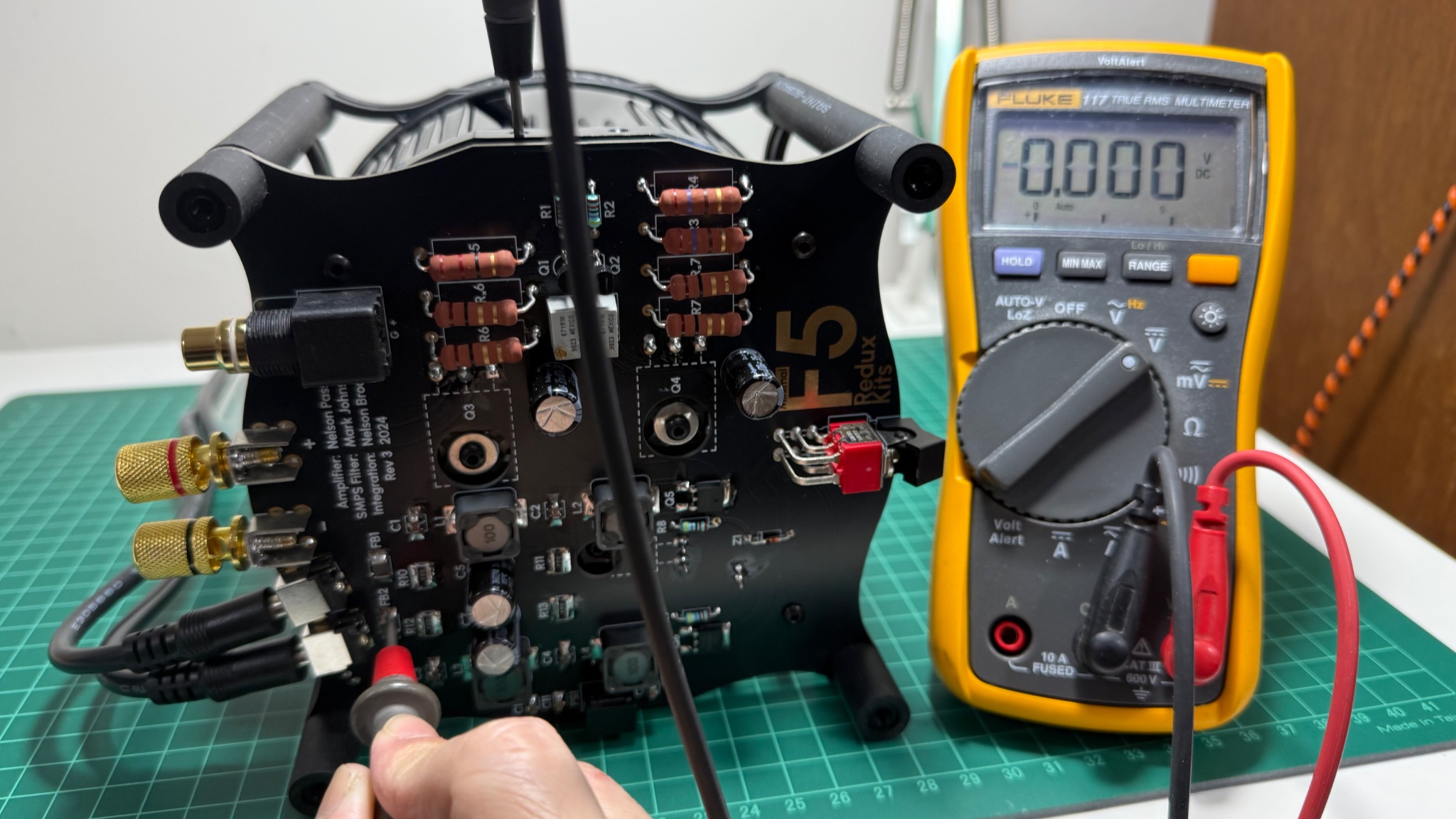

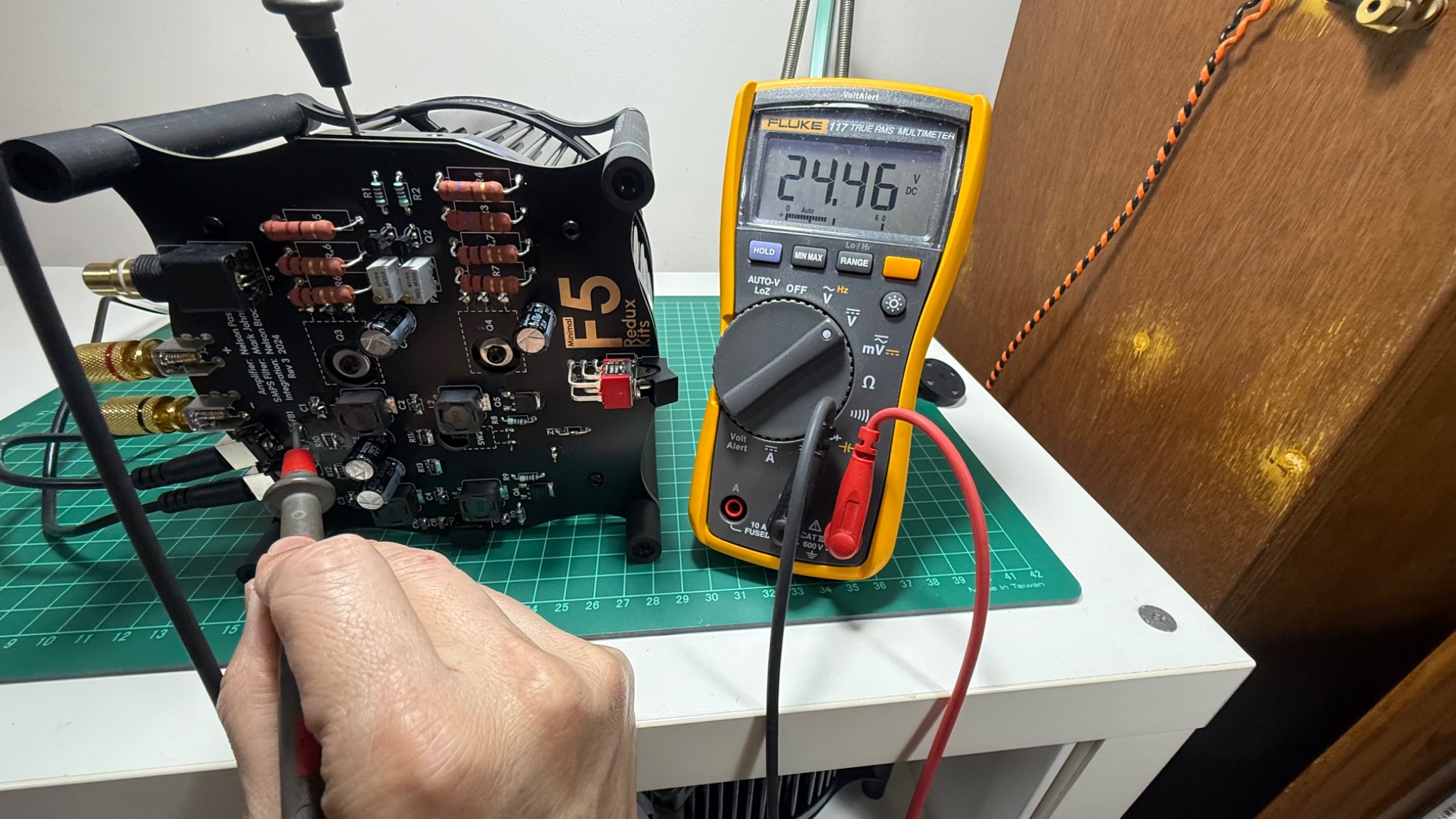

I tried swapping out your supplied smps with the aca (pair) meanwell smps from diyaudiostore. I observed a beeping sound when i connected them to the board. Measurement as follow before i switch it off.
FB1 : 24Vdc
FB2 : 0Vdc
R6 : 0Vdc
R7 : 0Vdc
Rgds

Can you measure voltages on each connection for Q6 with the switch on and with it off? It's the only thing I can think of that would drop voltage between FB2 and R7.
Your measurement with the meanwell supplies suggests a short or partial short to ground somewhere in the negative power rail filter. C3 or C4 are the most likely candidates, but I'd like to try narrowing it down before having you desolder parts. Please measure FB2 with the meanwell supply, again with the switch in both off and on position.

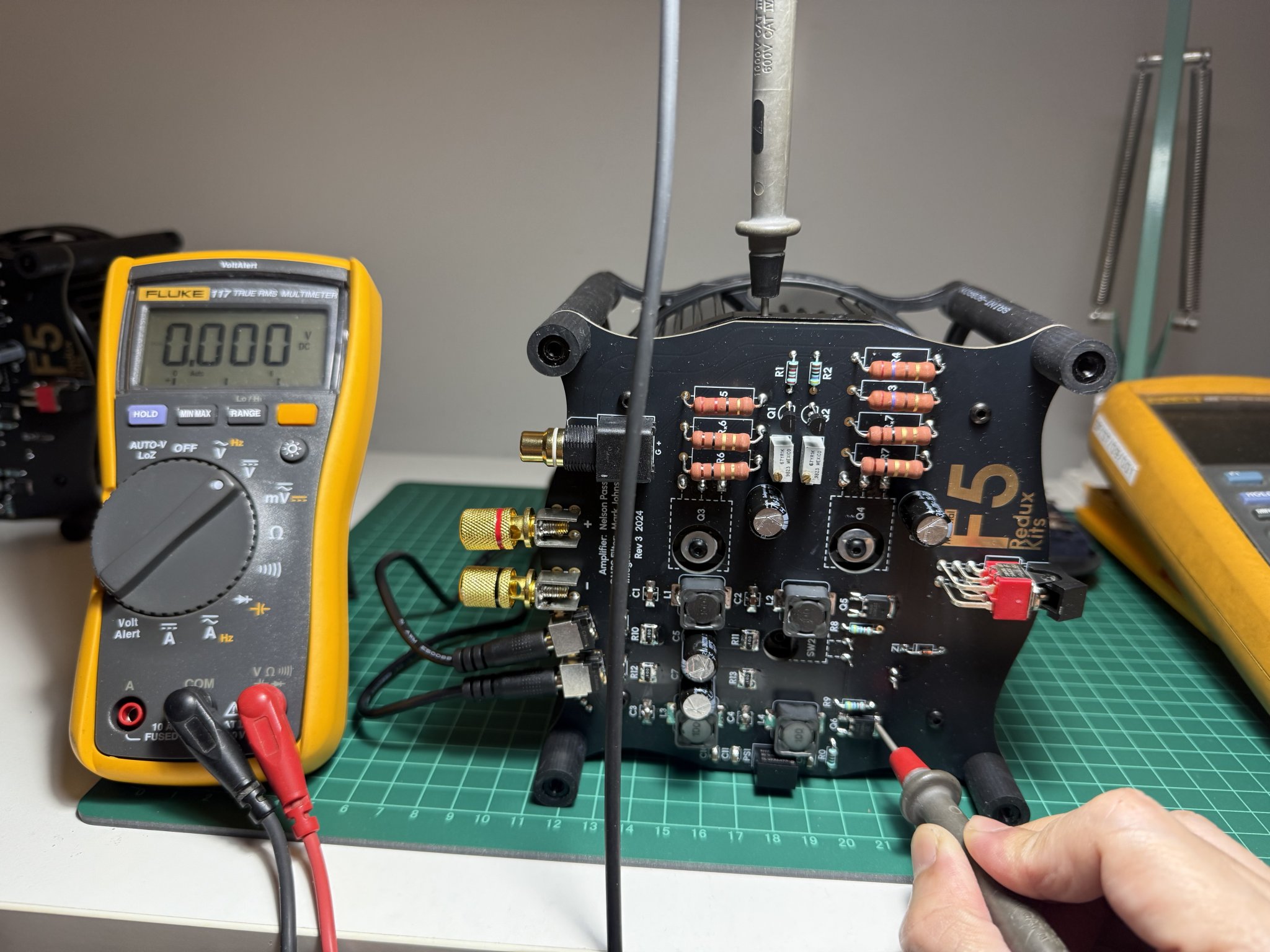

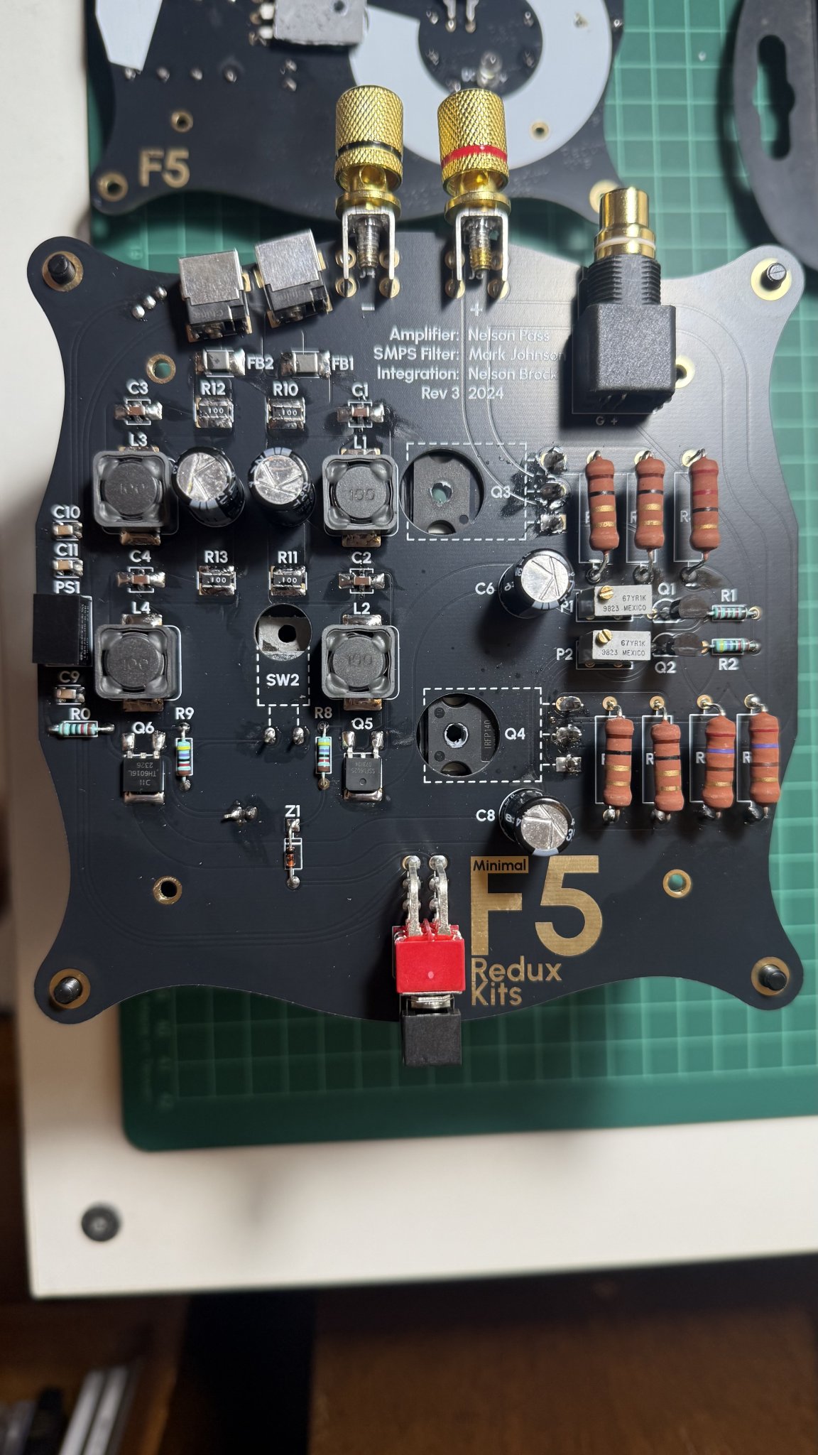

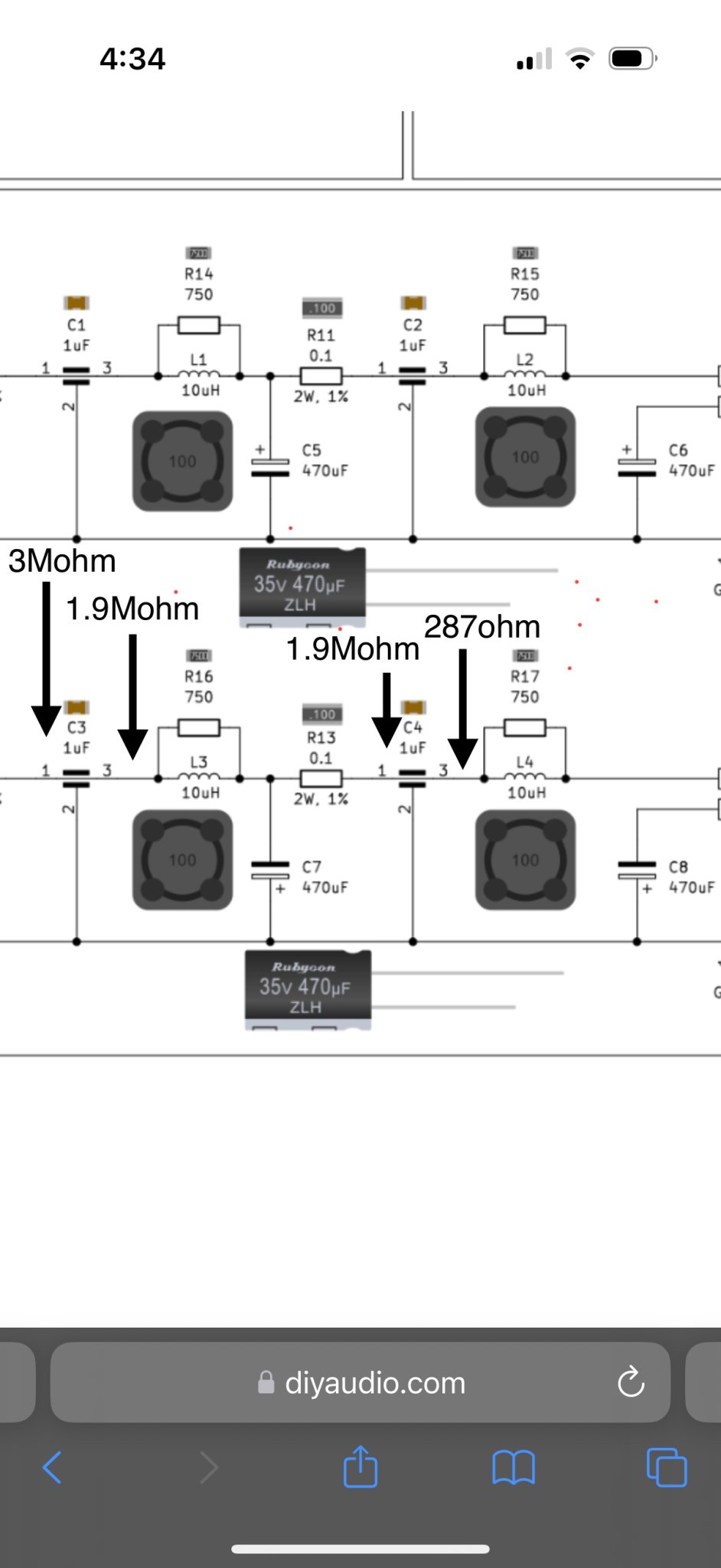

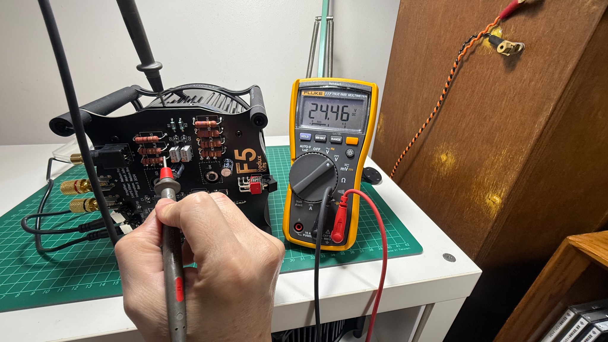

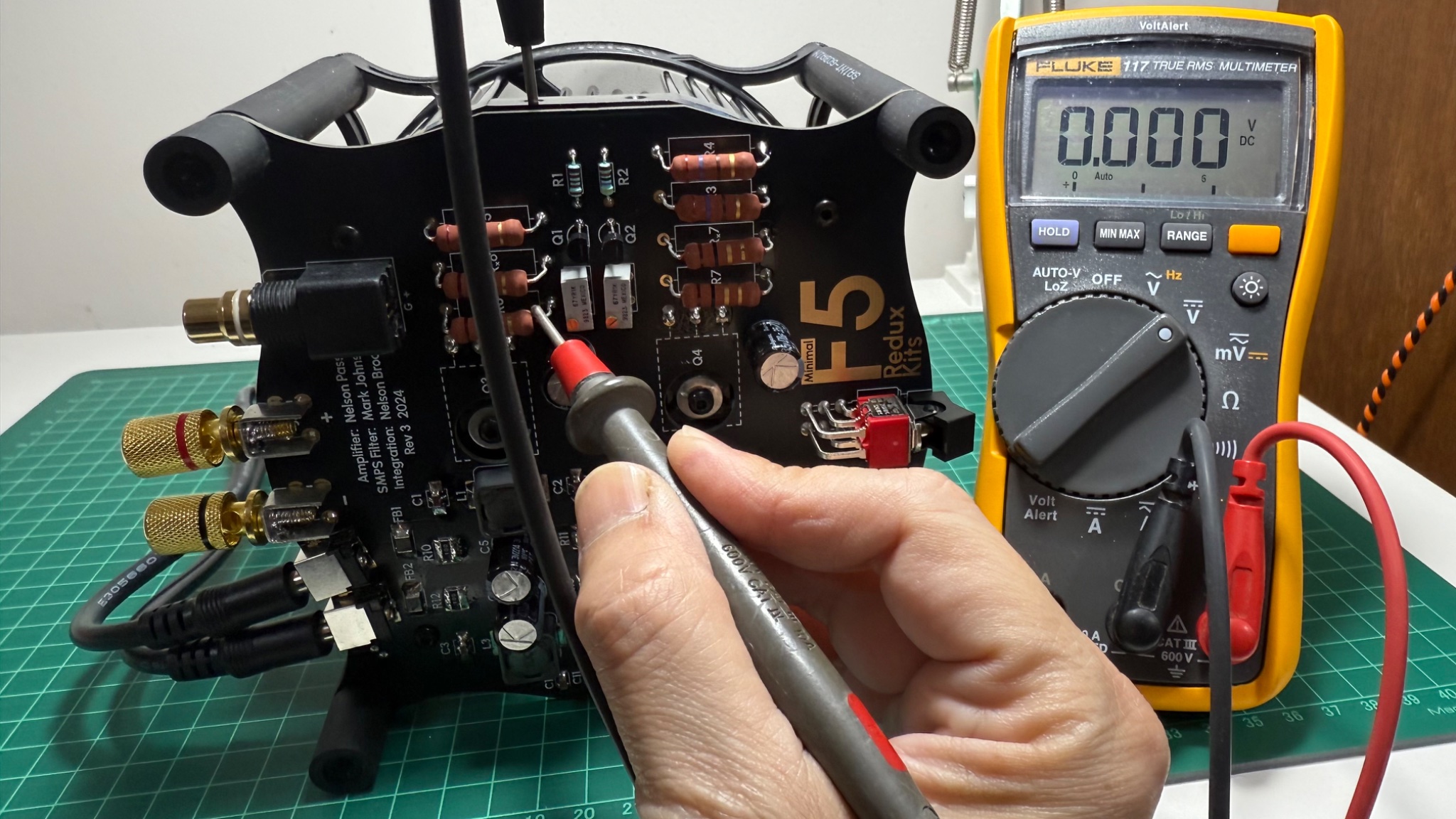

Manage to find some. Here are the measured value as requested.
Additionally i tried measured the resistance on the rail of c3 & c4 reference to ground as suggested by Birdbox photo. There are a few hundred ohms measured. Compared to c1 & c2 which have mega ohms measured.
Q6 (original smps)on condition
Q6 (original smps)off condition
Q6 (meanwell smps) same for both on/off condition
FB2 (meanwell smps) same for both on/off condition

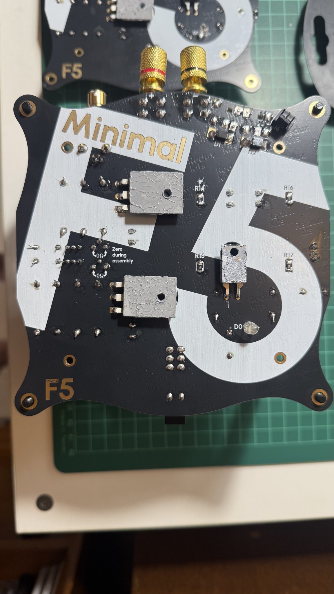

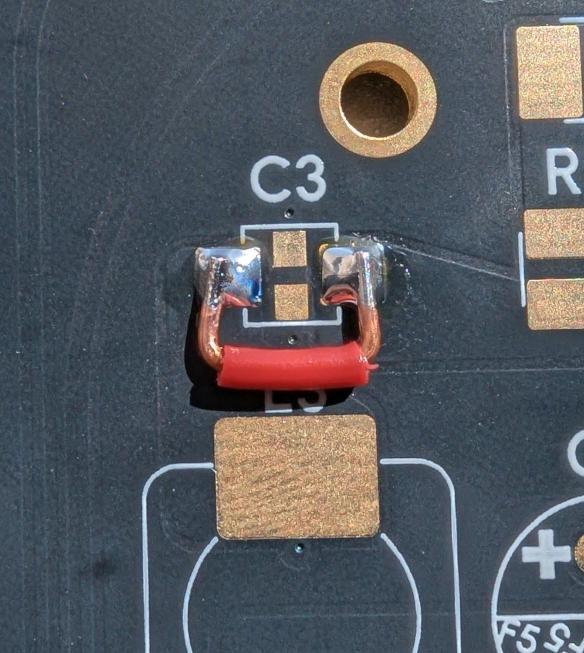

I would suggest removing C3 and C4 then measure ohms again from their larger pads to ground. If that gets rid of the short, then you can do a temporary fix by soldering a wire across the large pads for biasing and I can send replacement caps. Here's an example photo.
If you haven't already, turn your potentiometers back to zero before attempting to bias again

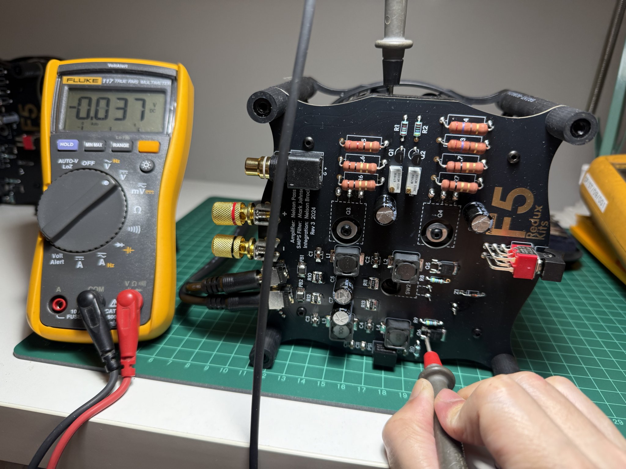

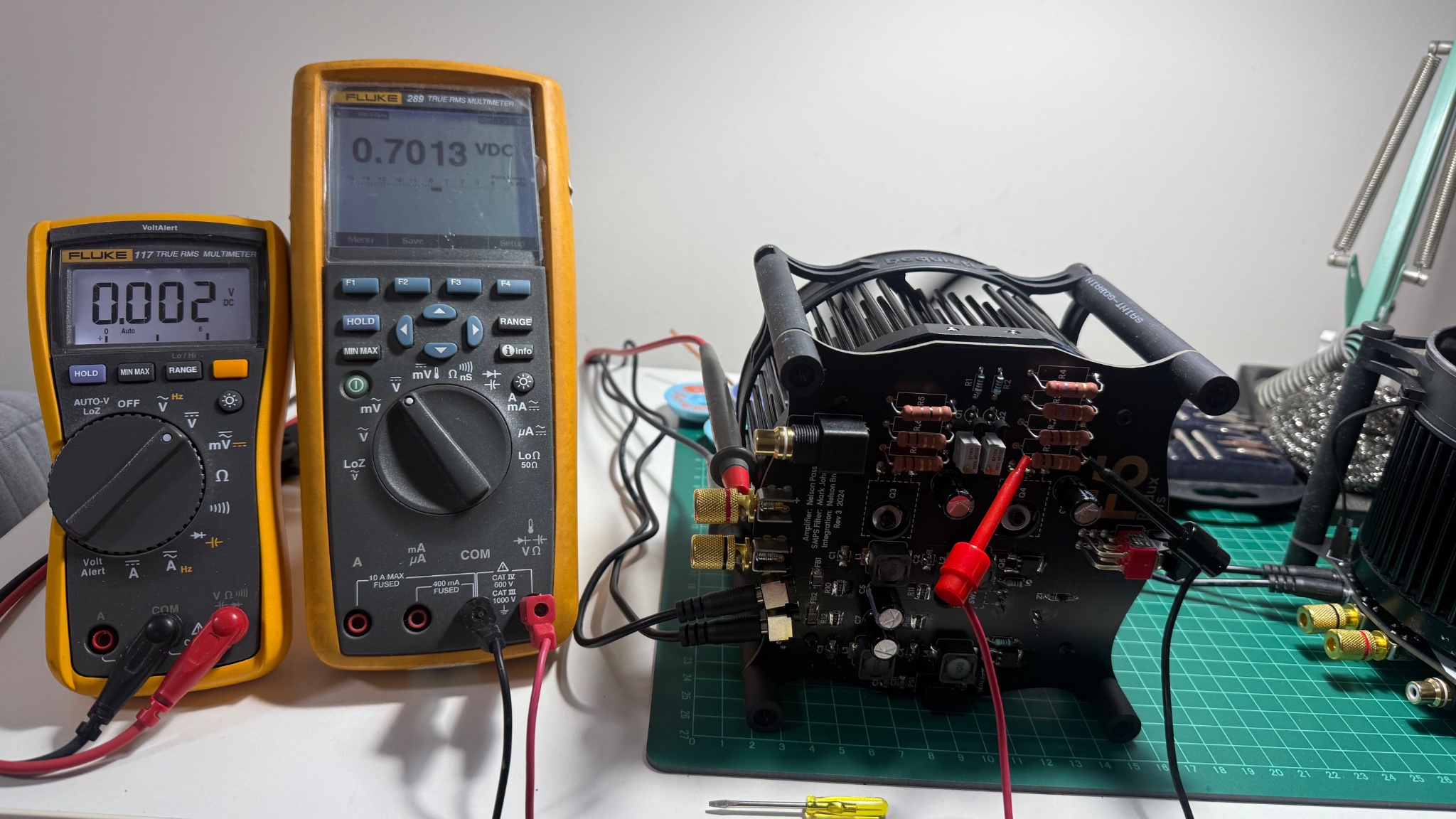

Removed r17 and I am still getting the same value as above.
Removed and measure Q6 resistance.
d to s - 232ohm
d to g - 272ohm
s to g - 48ohm shorted
Switch to diode mode to measure d to s of Q6 based on google ai.
0.19vdc measured with both probes orientation.
Special thanks to Nelson, I managed to replaced Q6 on both channels, measured the resistance to gnd (getting Mohm) and bias them. The biasing took a while, but nothing complicated, especially with the fantastic video guide.

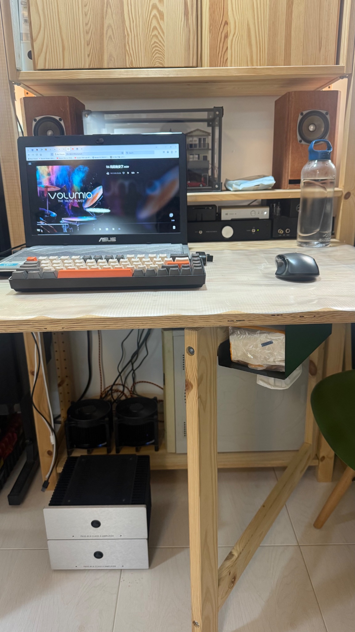

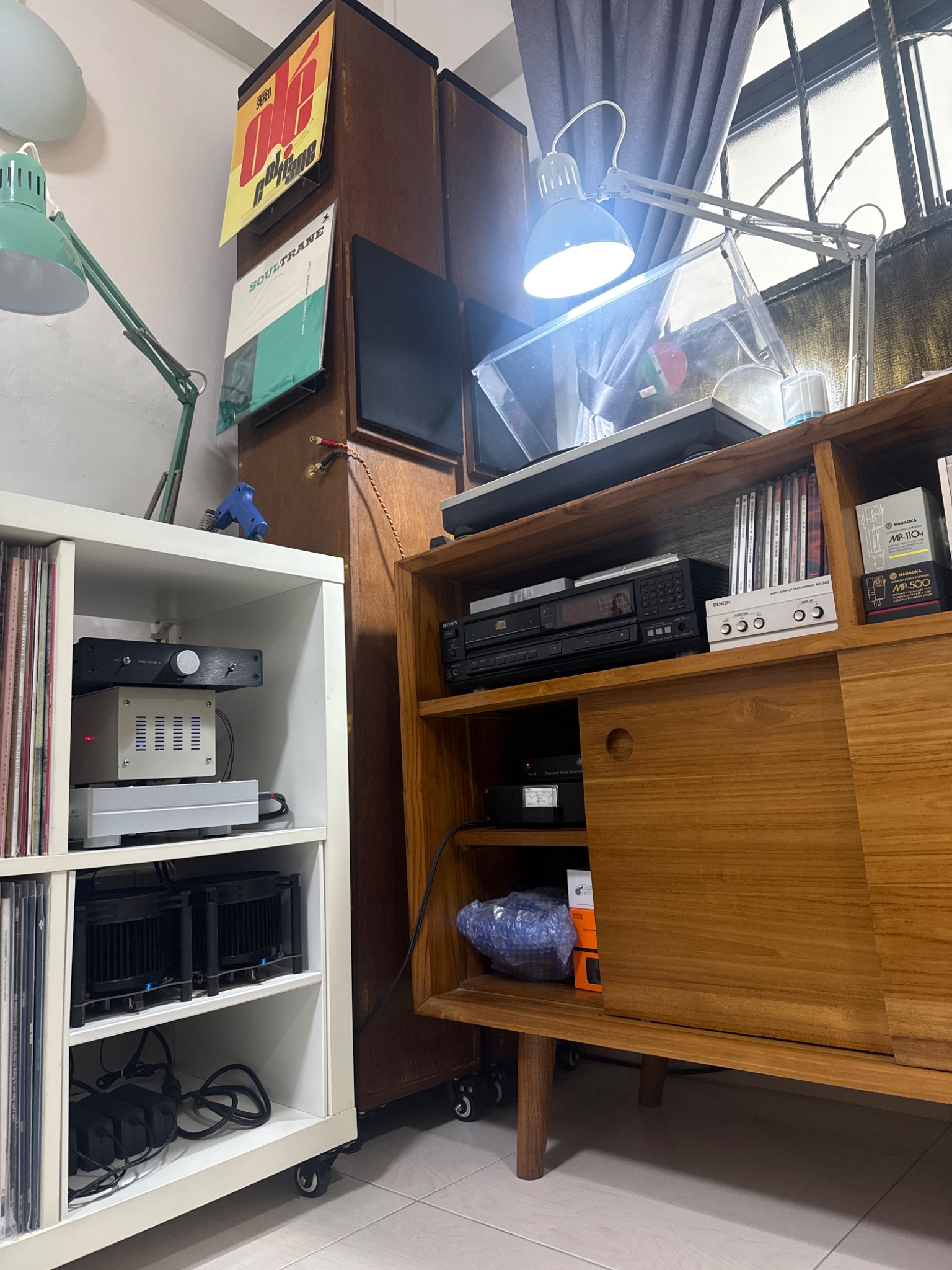

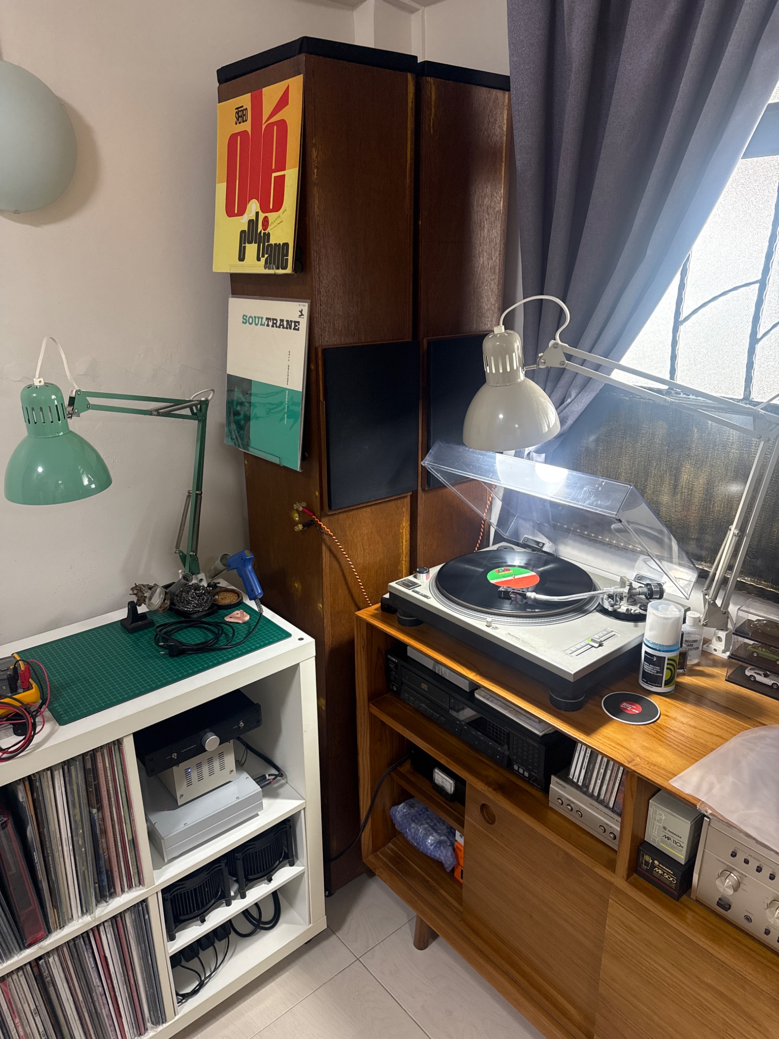

Just a follow up post showcase and share this wonderful F5M redux. I have shifted the B1K > F5M > BIB speaker as shown in attached photo. The combination is really great. I am using this setup mostly on Jazz and it exceeded my expectations. Thank you Nelson and the community once again.
Wil
