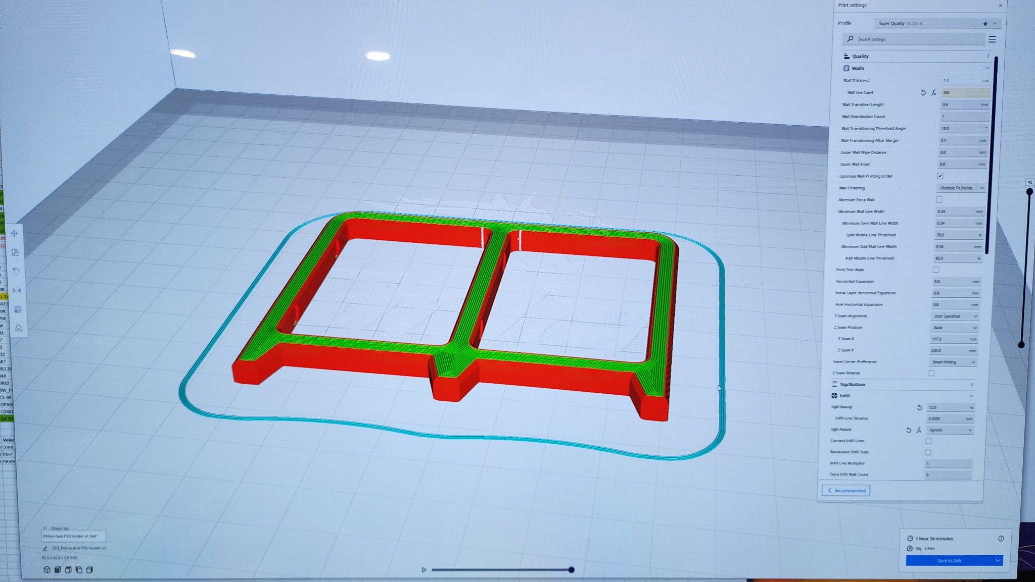

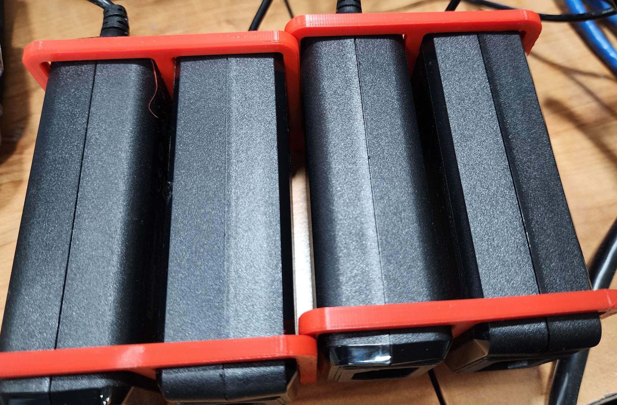

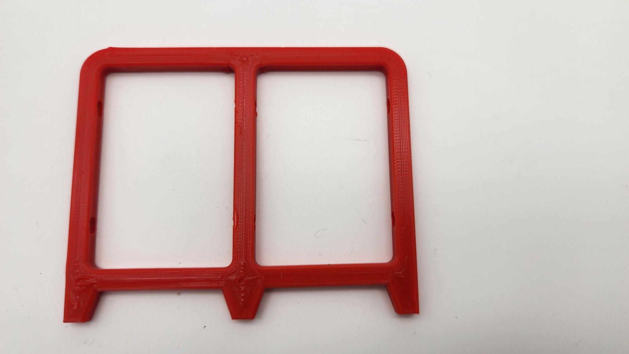

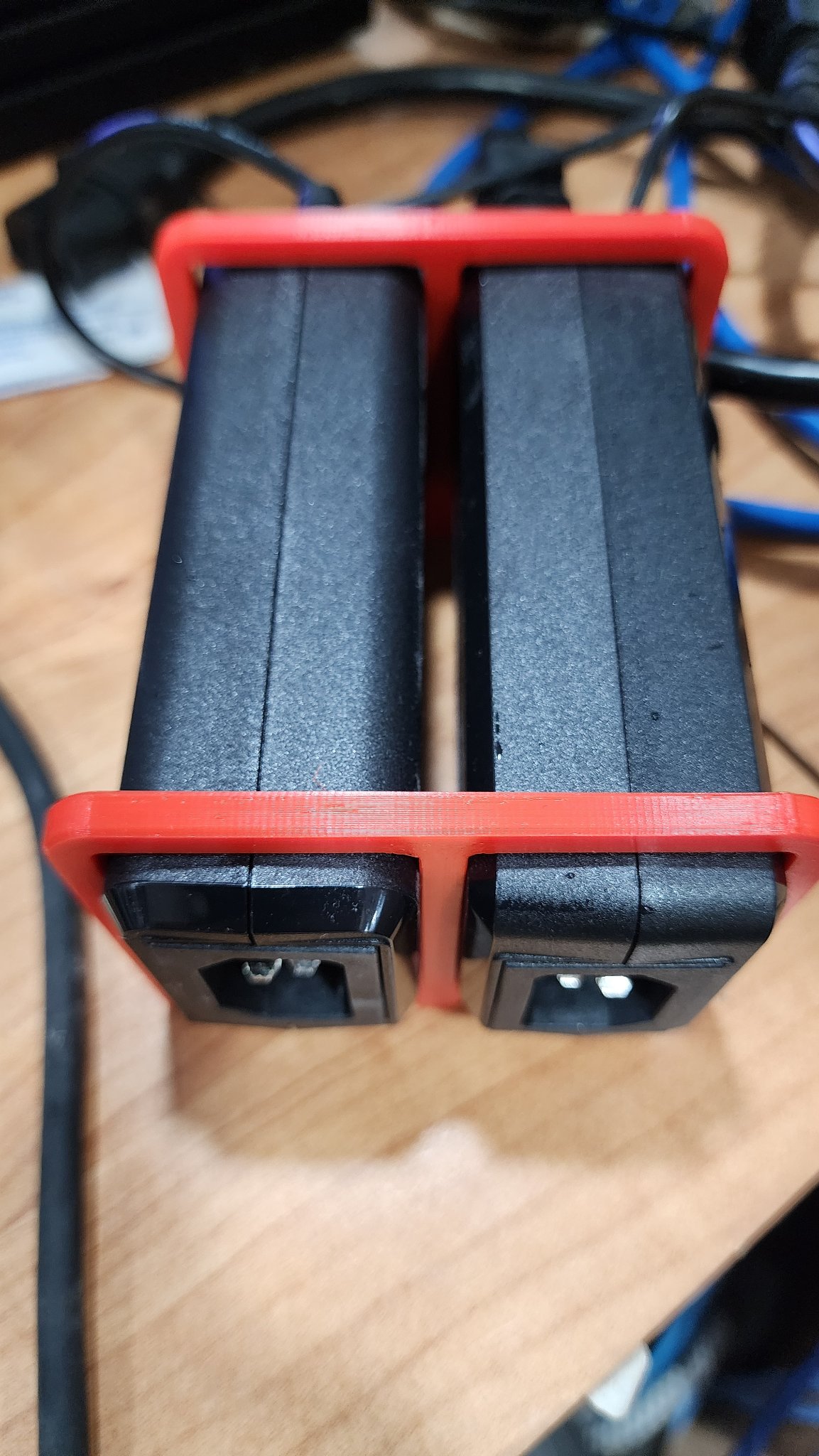

3D printed brackets hold two or four supplies side by side with a bit of air space around them (they don't get all that warm but it can't hurt). Pips on the bottom of each supply hold the brackets in place. Braided 1/4" sleeving and some heatshrink completes the package. Files suitable for printing or editing are attached here and on the first post.
I printed 4 of these for another member. They work so well that I'm going to print 4 more for myself 😎 Simple and effective! Thanks Nelson for sharing the design!
I let the F5m Redux play for a few hours last night and the SMPS bricks were just luke warm (38°C).
Also, the SMPS stands work fantastic!
Happy to print some for anyone interested. Costs 2x more to ship than fab them up for awareness (<$2 in material cost).
