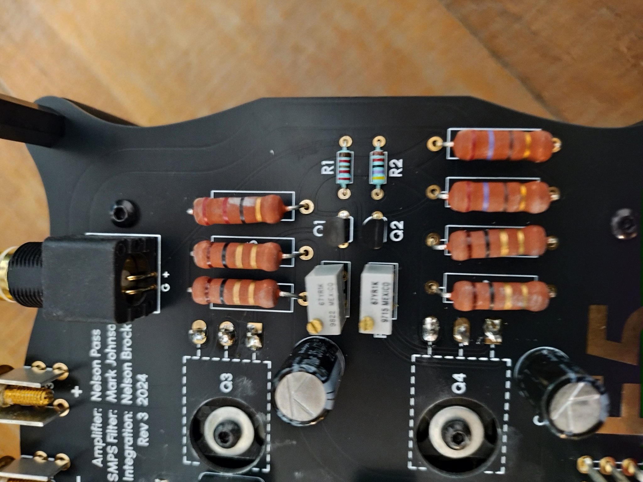

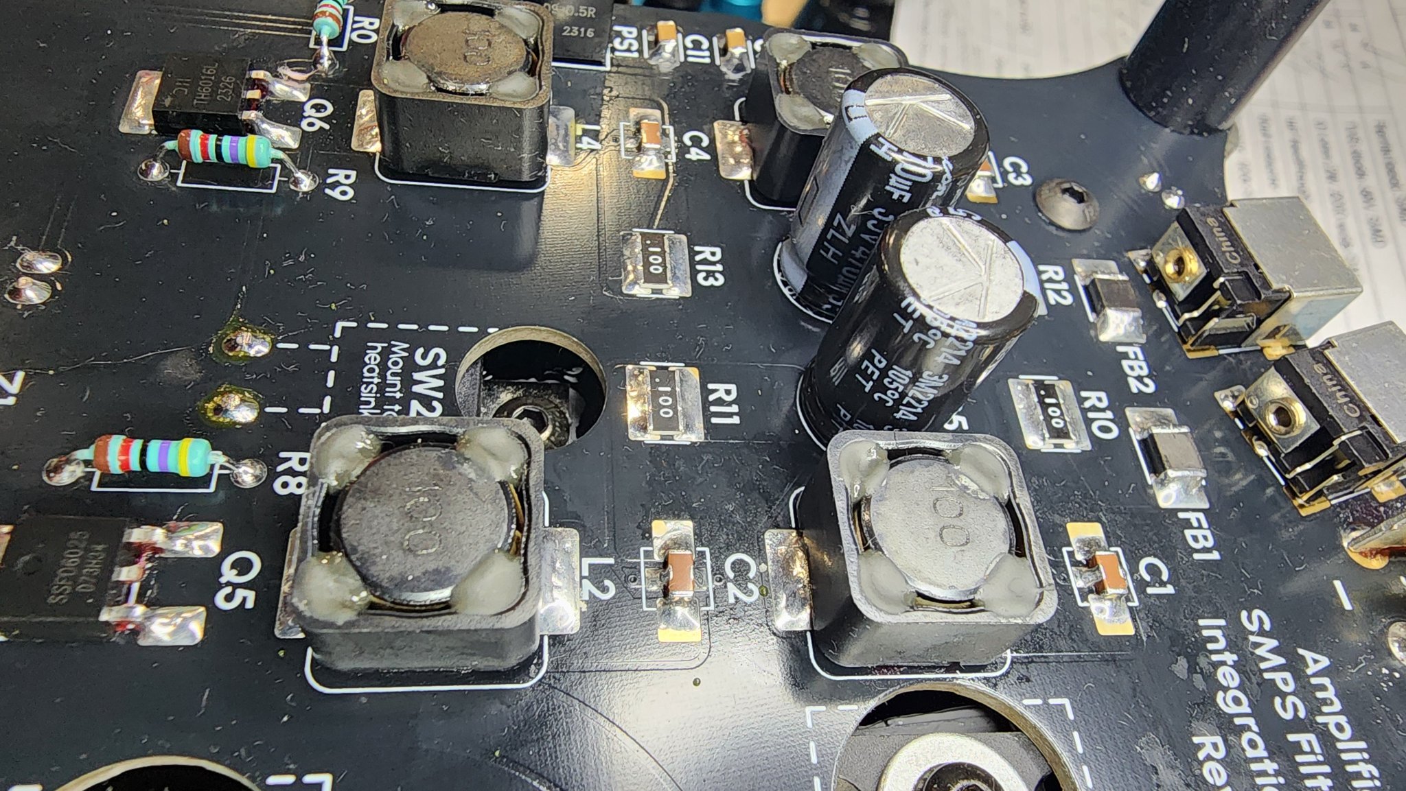

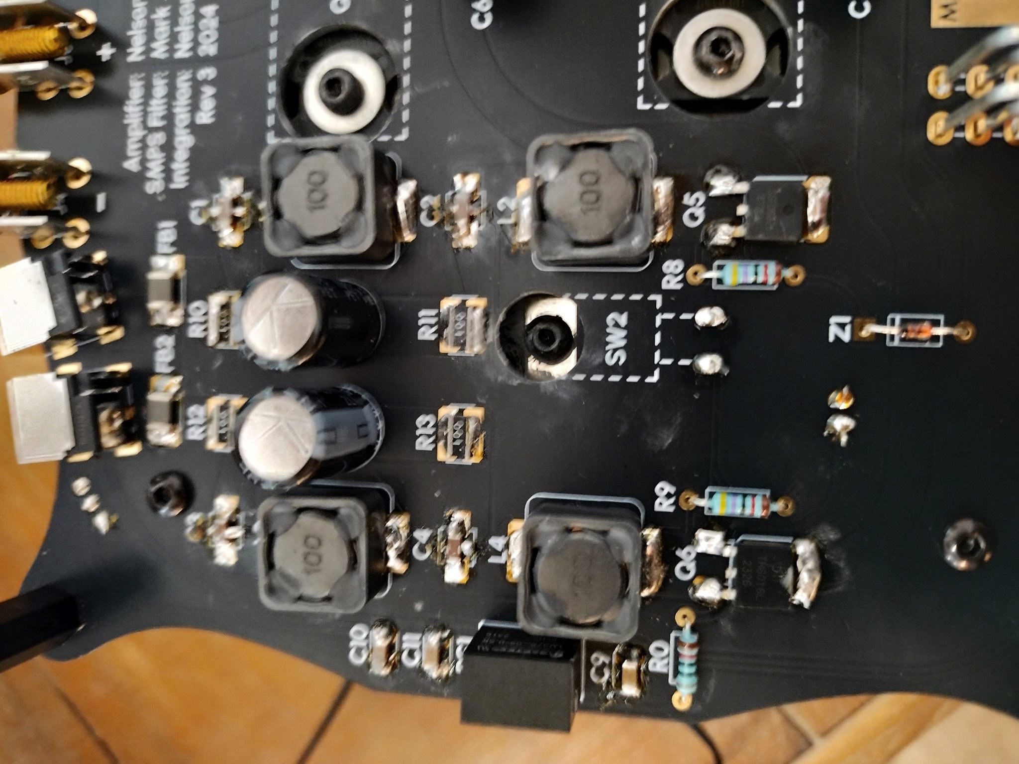

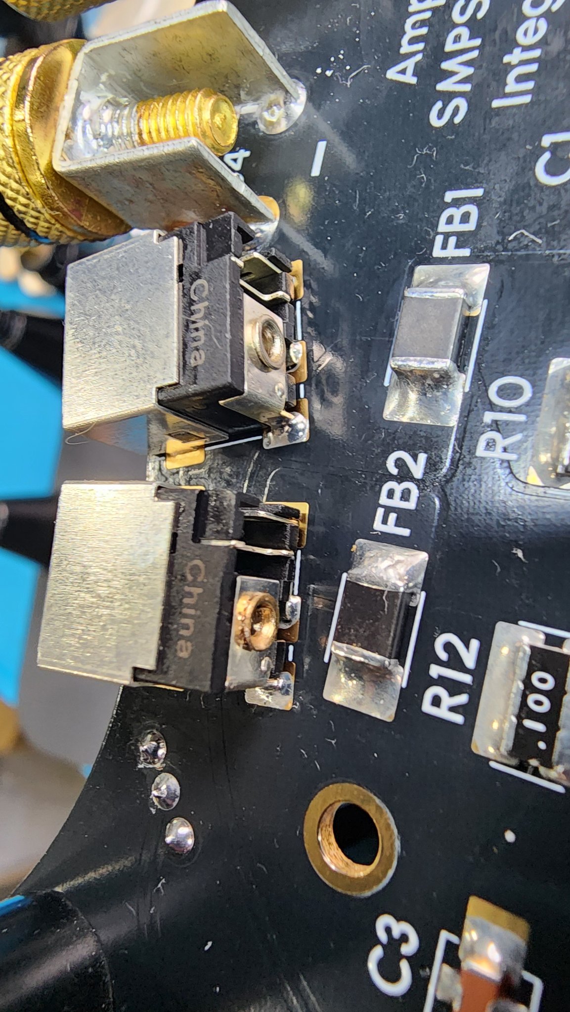

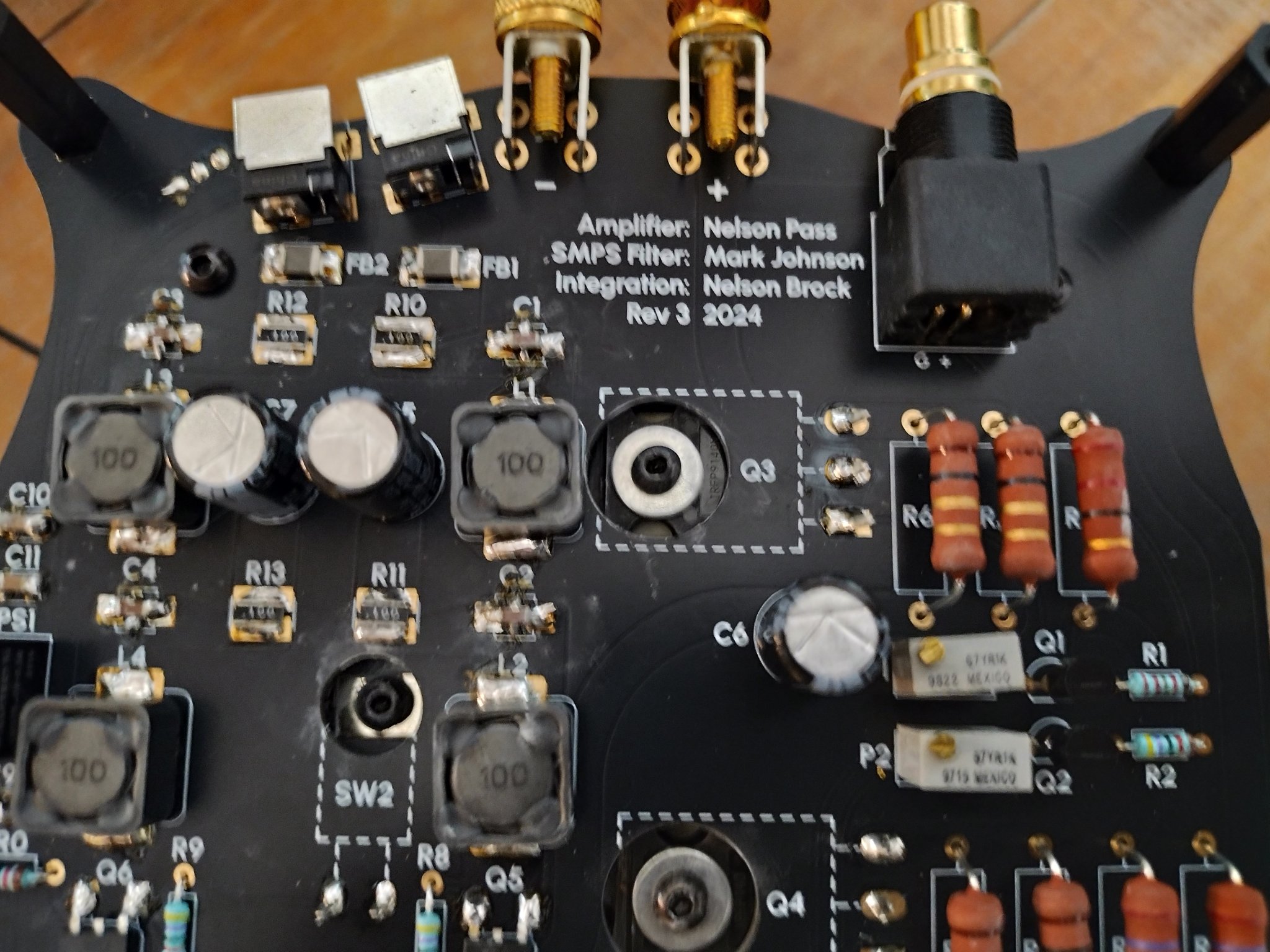

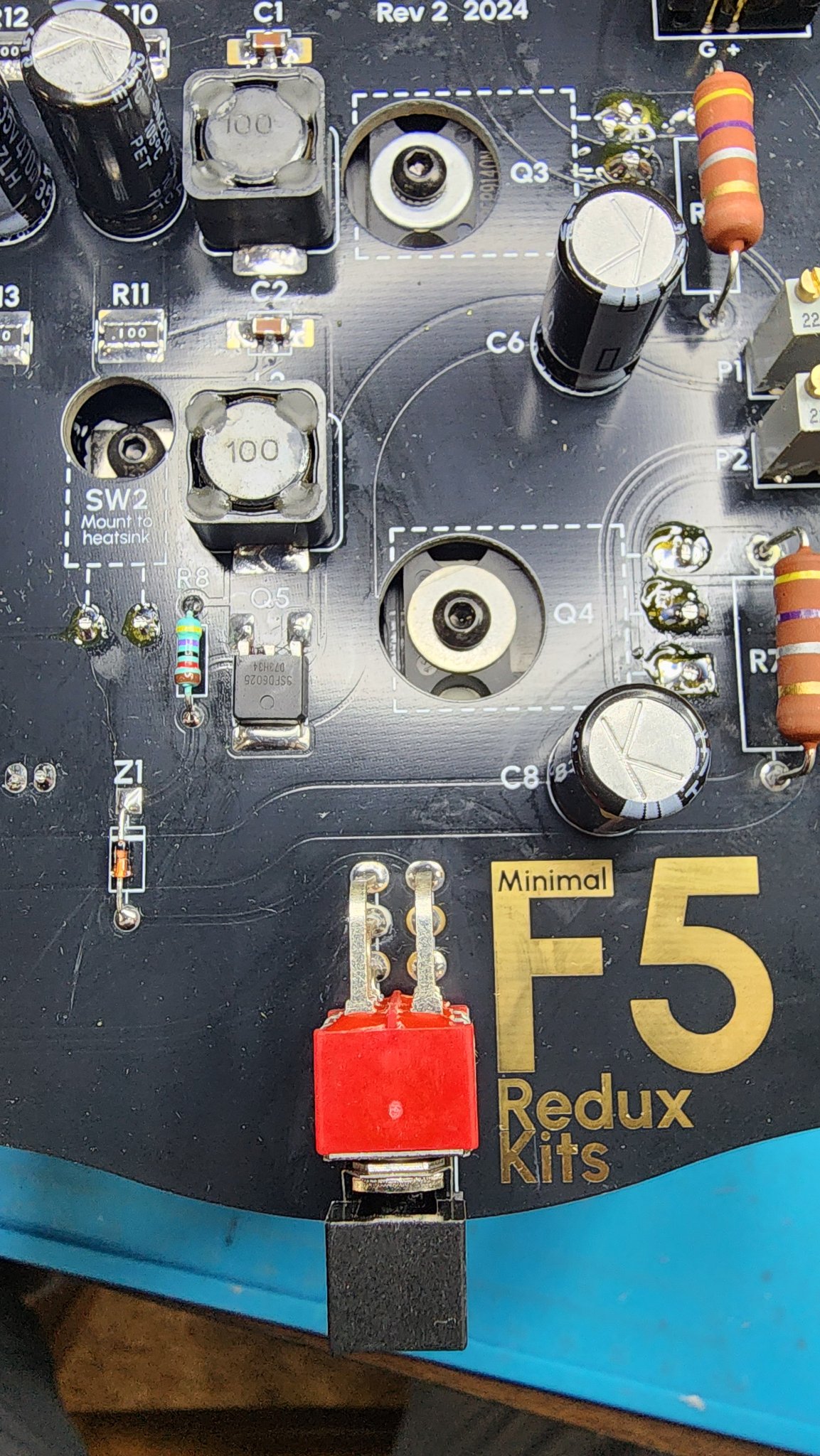

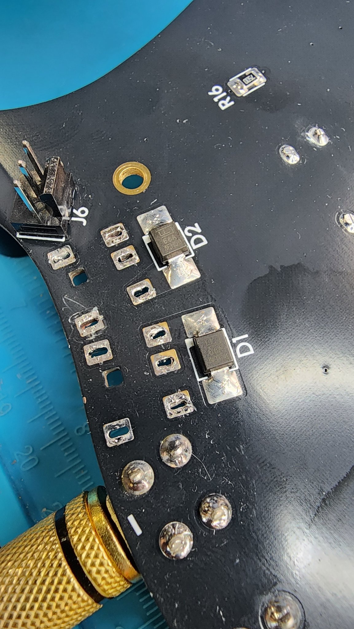

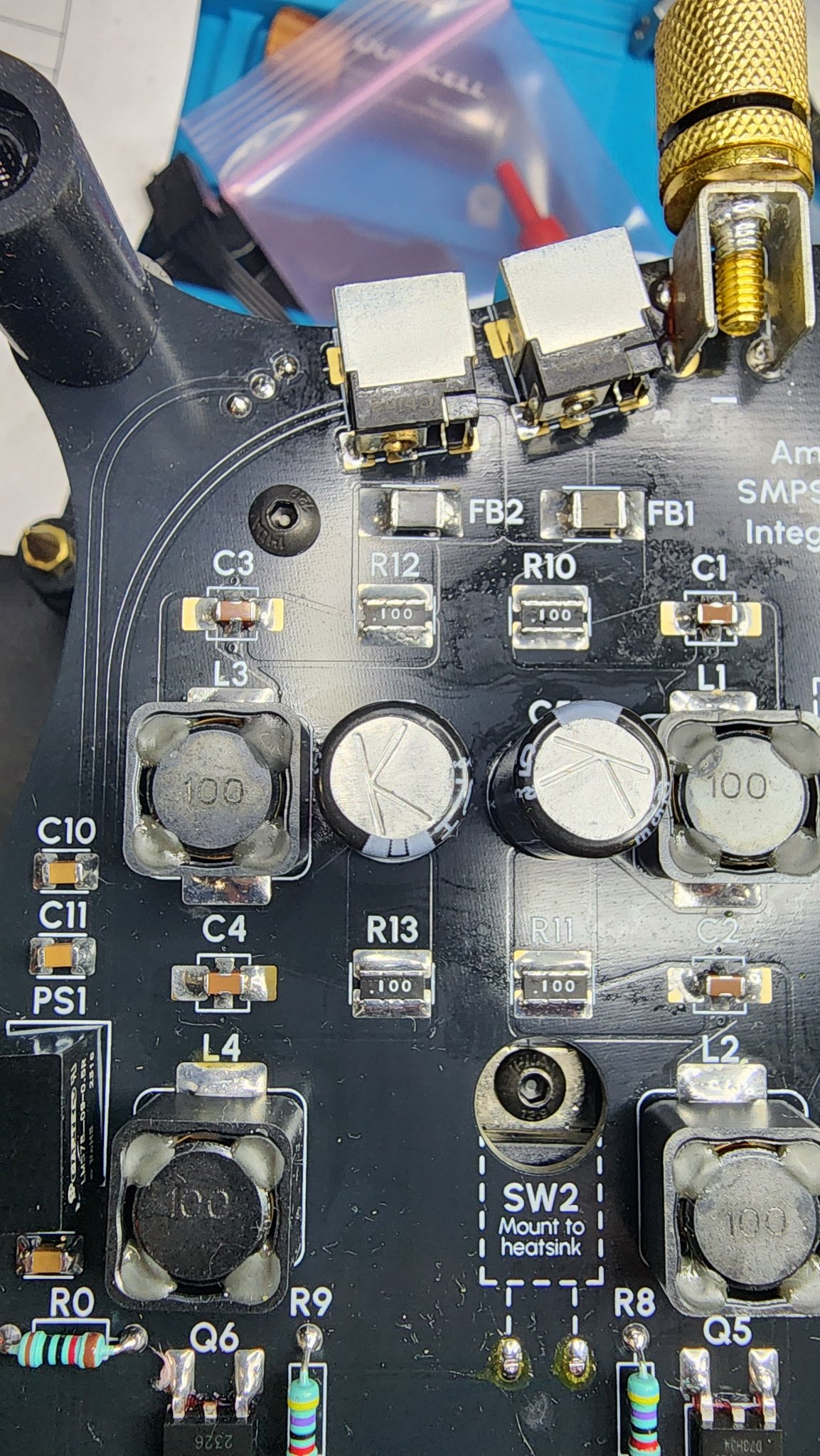

Here is some pics of the amplifier with the intermittent fan and flickering LED light. Let me know if you can see where the short is, or what to test for on the multimeter across the different components. Again, besides building the ACA Redux kit successfully, I have no kit-building or electrical engineering knowledge whatsoever.
Thanks for all the help.
You've got some touch up to do on those SMD components. I think you might need a higher temperature on your soldering iron to start and use a smaller tip if that's possible. However, my number one suggestion is to use liquid flux on all of those SMD joints. You have jagged/rugged looking solder joints there and you should have smooth even contours with a slight concave shape. Flux will help tremendously and so will more heat applied for a very short (2-3 second tops) duration. Smear flux all over the joint, touch for a couple seconds with a dry solder tip, and watch the solder flow smoothly into a nice concave and smooth shape. You don't need more solder, if anything you need a little less in my humble opinion.

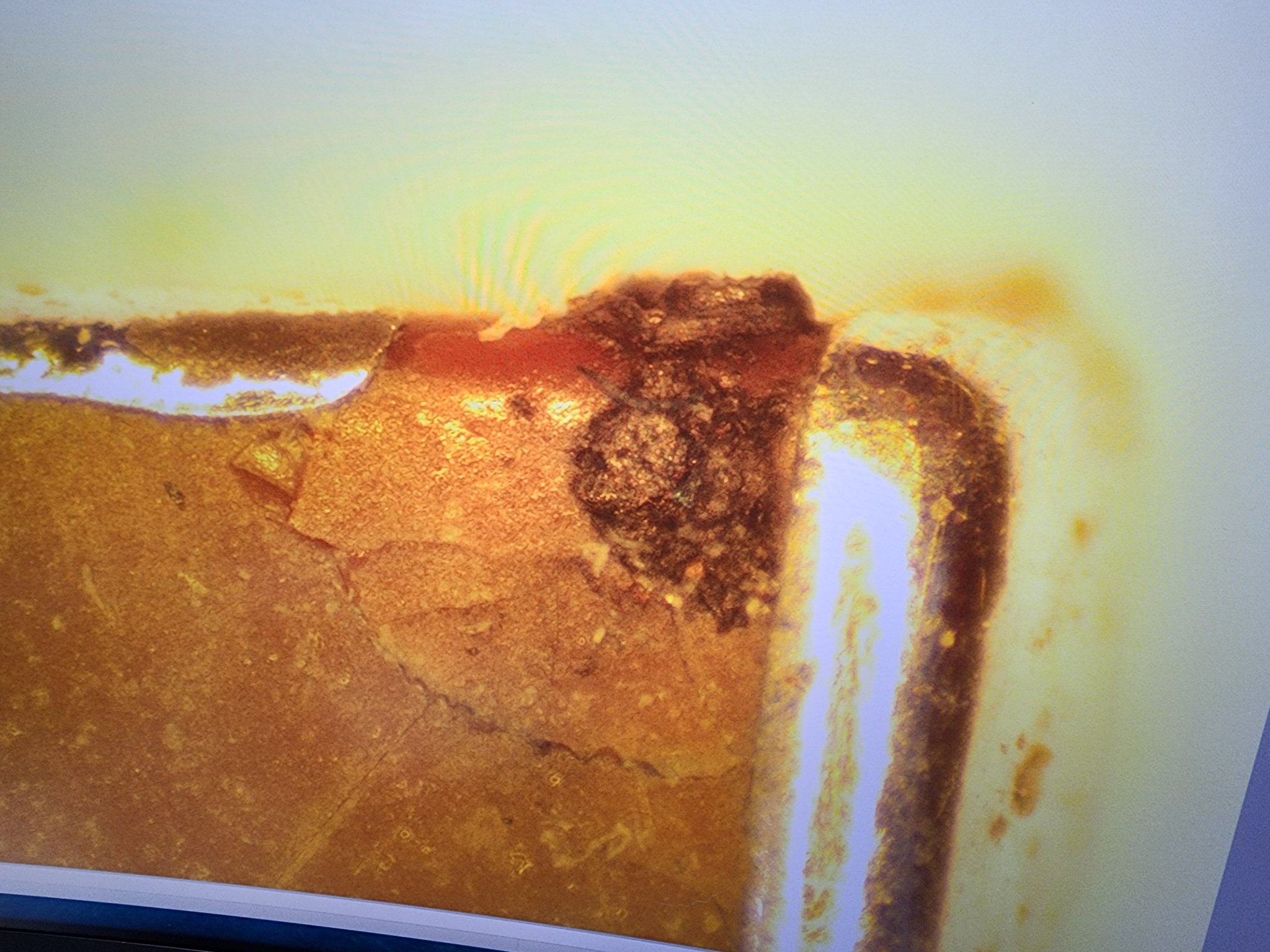

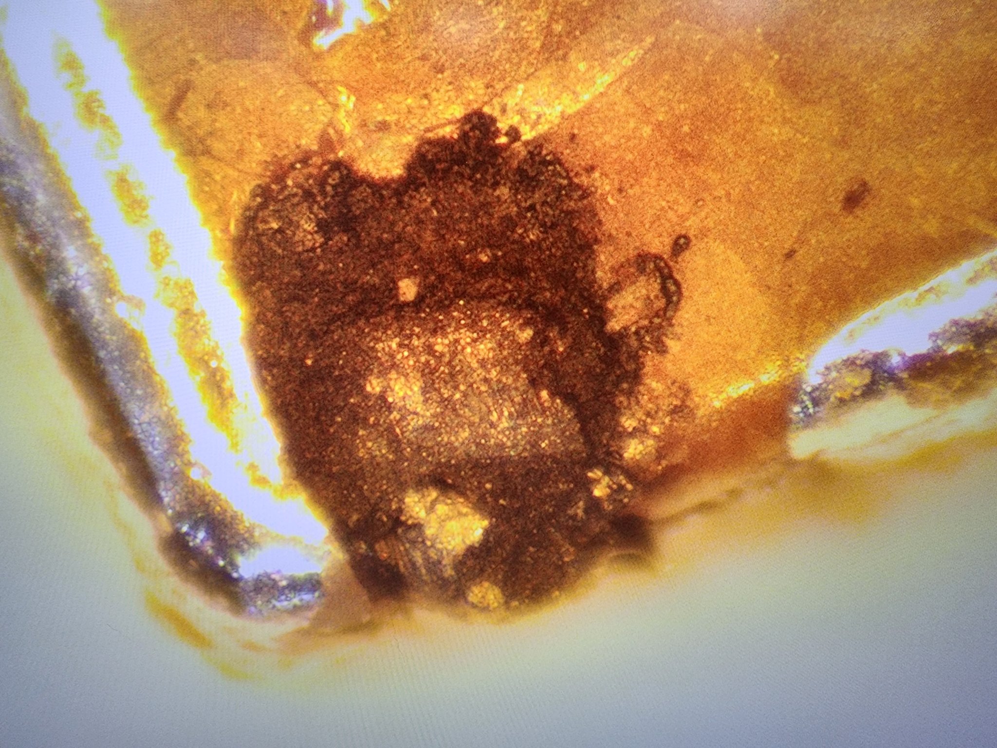

Before you "reflow the solder" I'd use your multimeter in ohms/resistance mode to see if the outer edges of your feedthru caps are high resistance to ground (good), or near zero resistance to ground (bad). The middle of the feedthrough caps should have a very high megaohm resistance to the outer edges of the feedthru as well. Again, I point there as that's where my issue was.

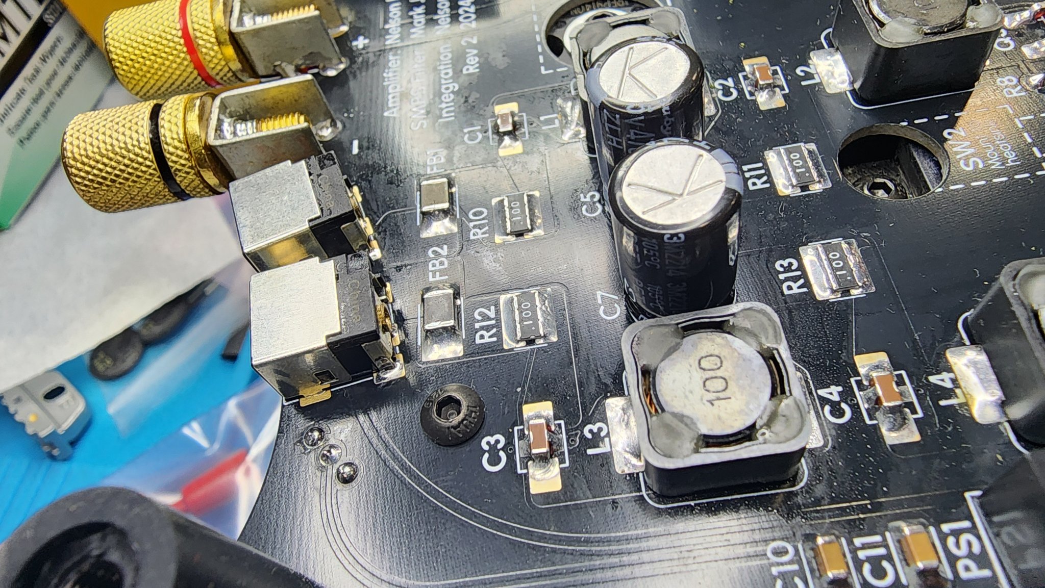

Here's some close up pics of my solder joints. I set my iron to 650°C and use a small tip (I use a bevel 1.5 to 2mm tip).

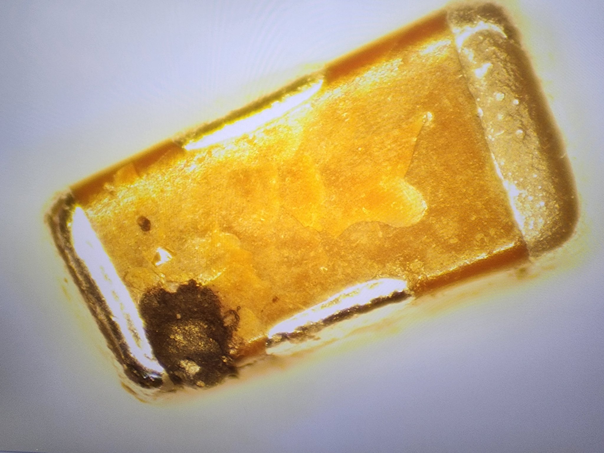

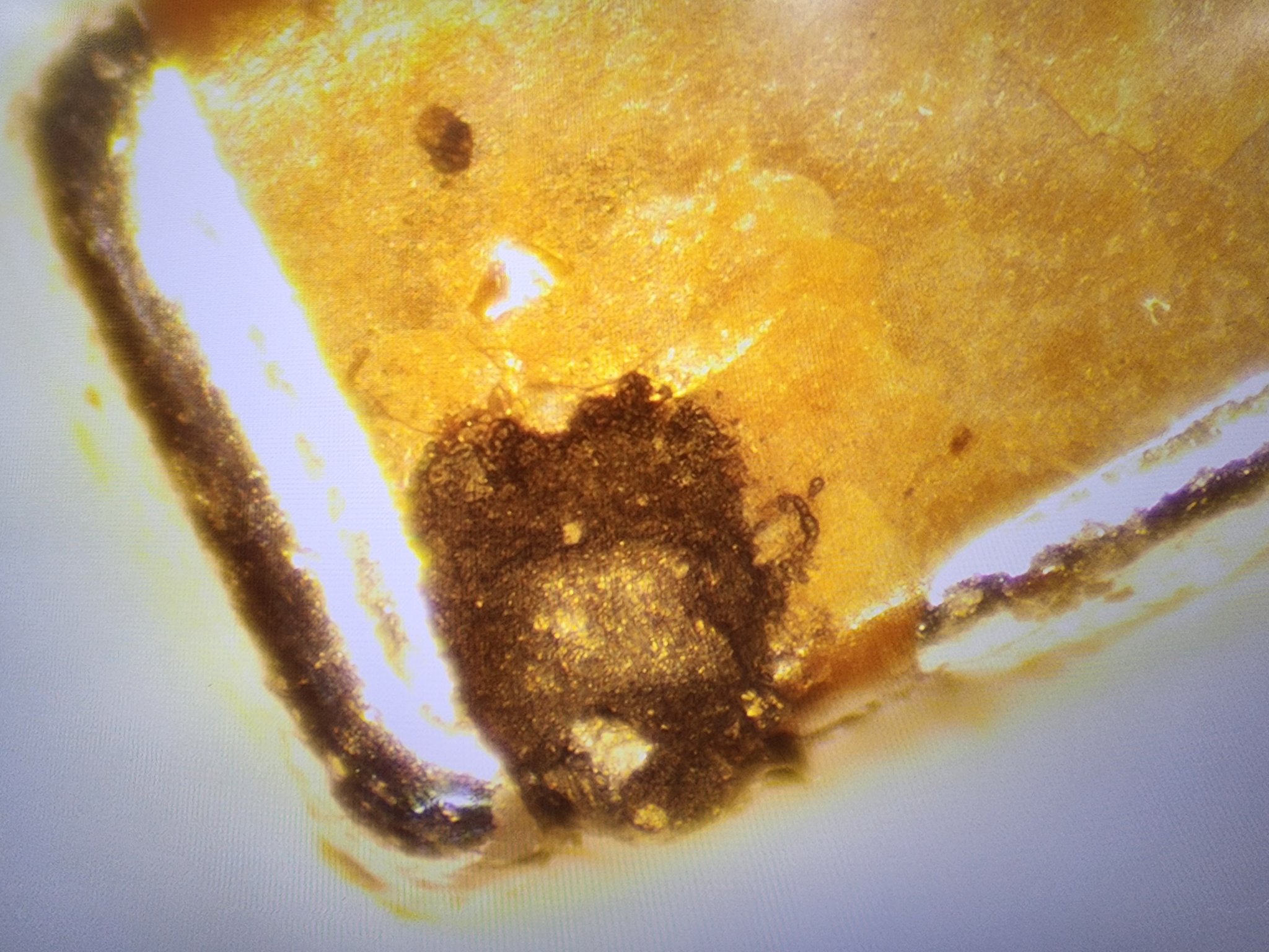

Here's some images under a stereo microscope of the failed thru-hole caps due to using too much solder and getting a short from the middle ground to edge under the cap (not visible from my QA check before power applied). I had smoke come put so it was obvious something was wrong.

Its a 60/40 lead-tin solder with a flux core. I hadn't used separate electrical flux paste. I didn't need it for the ACAs so I didn't buy any for this either. I was using the iron at 400 degrees C but maybe that needs to be higher?

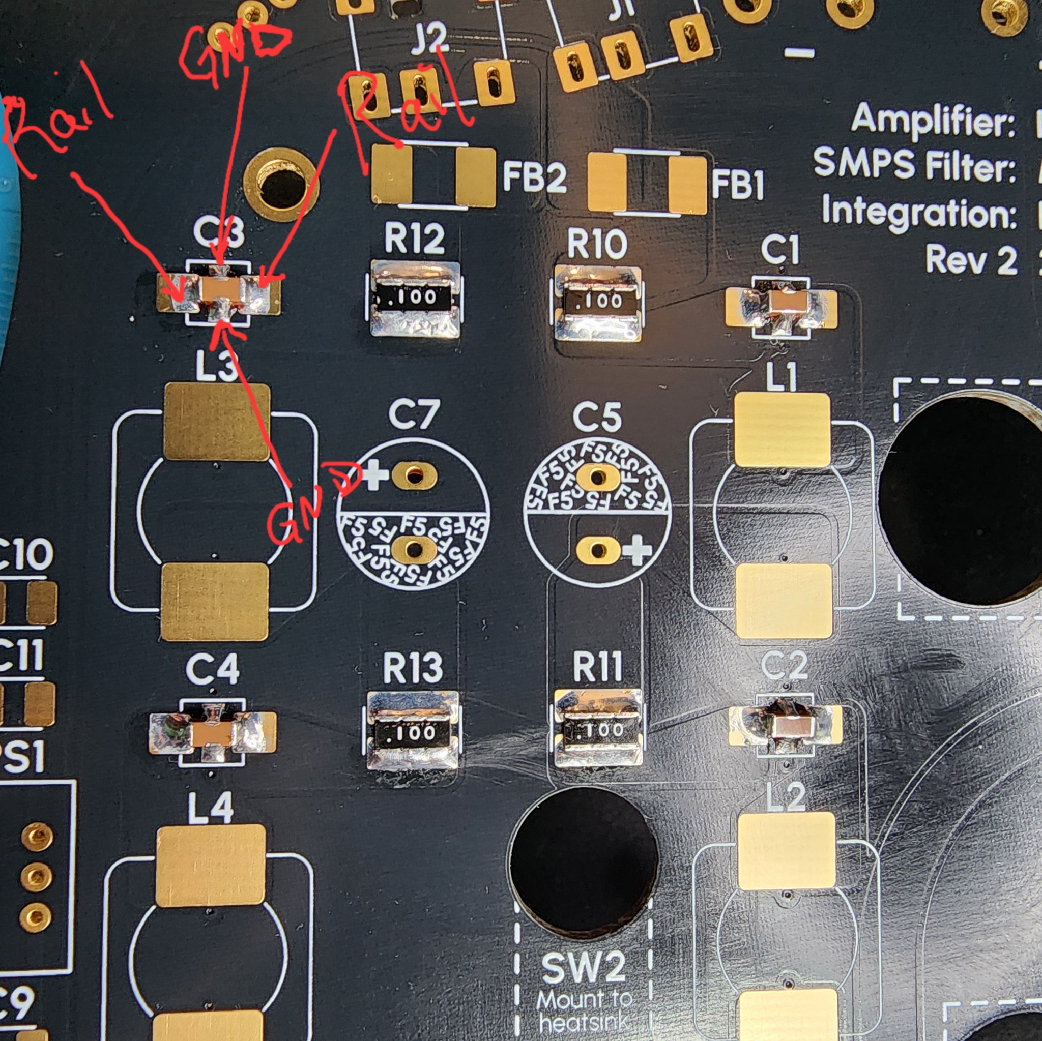

Well, 400°C is too hot. I use 650°F (343°C) on my Hakko with great success. Flux paste for SMD should help get smooth, clean, shiny joints. I don't use flux on thru hole soldering.
Use you DMM to check around for shorts to ground. Place one probe on a chassis ground point, then use the other probe to measure resistance. For component joints that are supposed to be connected to ground (like the middle of those feedthru caps) you should get near zero ohms. For component solder joints that are not supposed to be connected to ground you should get open or very high resistance (say megaohms, or hundreds of kiloohms).

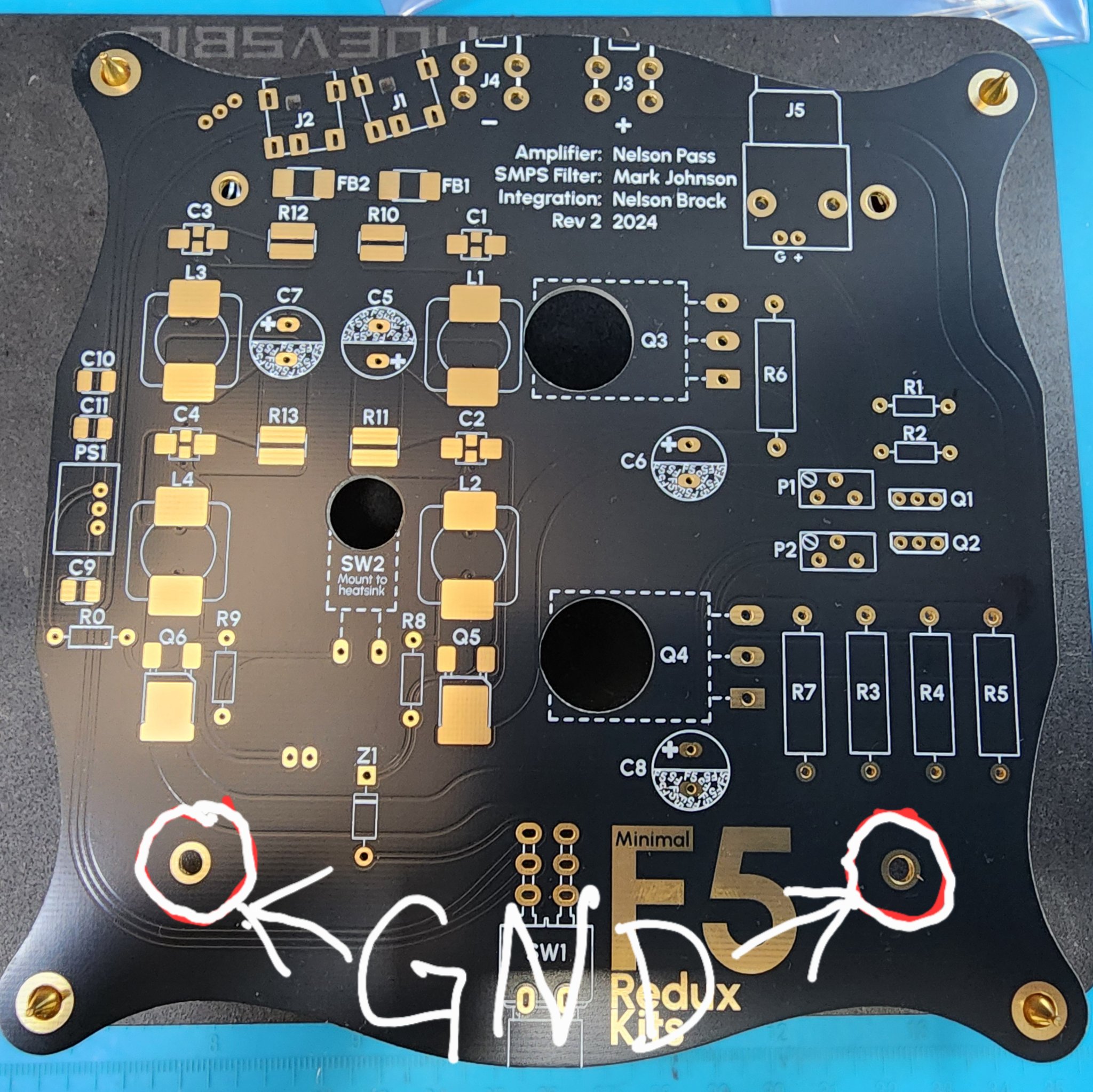

Note that Nelson has put together an amazing schematic with photos to help your brain convert symbols on a circuit diagram to the real world parts. Use that to see what should read grounded (zero ohms) vs what should not be grounded (very high resistance for the +/-24V rail voltage). I tried to get you started with the image below. Red circles are for rail voltage joints (high resistance or open) and black is for grounded joints. Note I didn't circle some joints for parts that have one joint on rail voltage, and one on ground. Those feedthru caps have 4 solder joint locations, middle two grounded, outside two on rails.

That's hotter than it should be, the flux is likely vaporizing (into smoke) before the solder wets out. Use somewhere in the 300-350°C range for 60/40 solder.
How can I check the individual caps, resistors, etc with the multimeter to see where my problem lies?

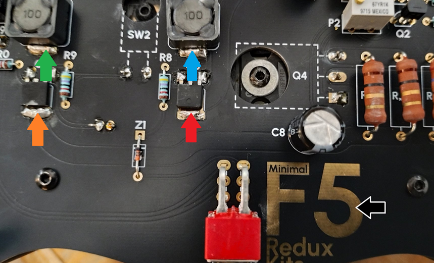

  1. Unplug the amp
  2. Short each of the marked locations in the pic to ground (black arrow) using a meal tool or wire for a few seconds to discharge capacitors
  3. Measure ohms from each location to ground and report back

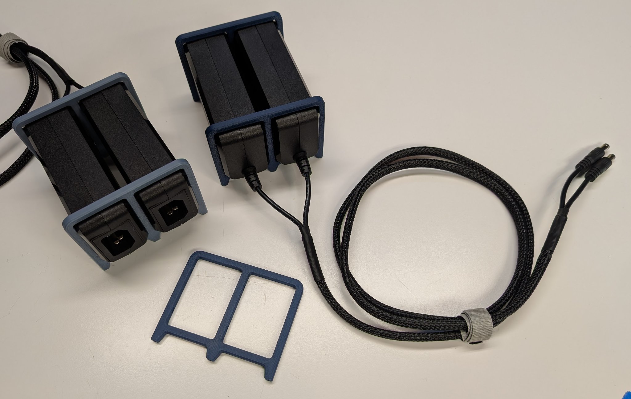

Prompted by @BeardyWan 's question about power supply cords, I took some time to tidy my setup.
3D printed brackets hold two or four supplies side by side with a bit of air space around them (they don't get all that warm but it can't hurt). Pips on the bottom of each supply hold the brackets in place. Braided 1/4" sleeving and some heatshrink completes the package. Files suitable for printing or editing are attached here and on the first post.

Hey, finally had time to work on these.
Green to ground is 406 ohms.
Orange to ground is 405 ohms.
Blue is super-high ohms (outside multimeter range)
Red is 0.5 ohms.
