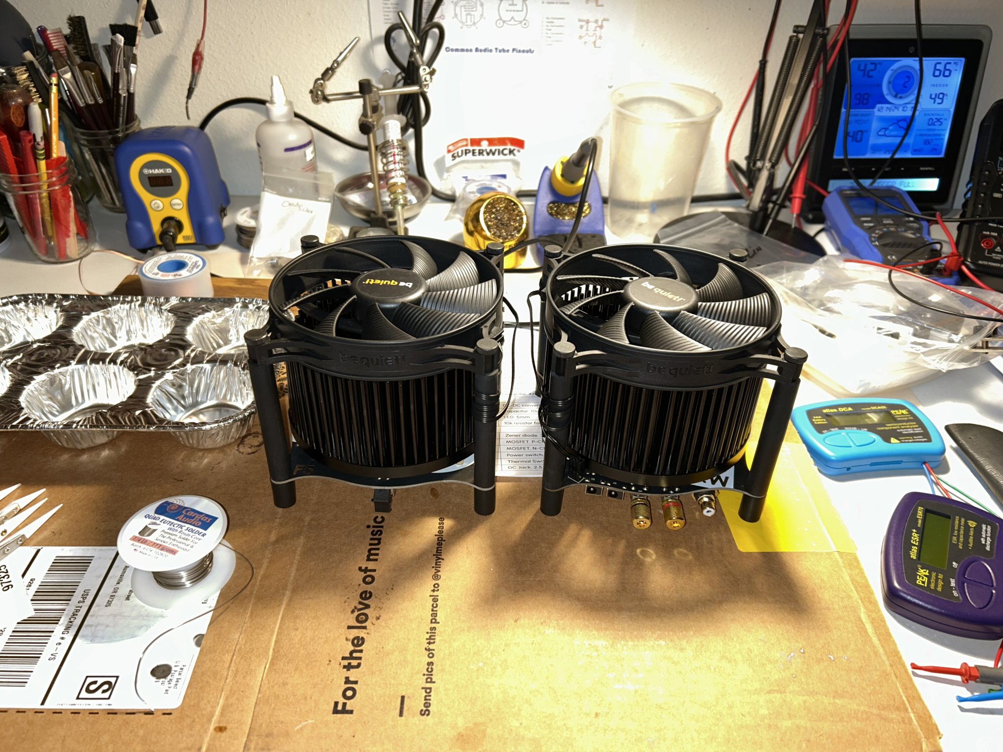

Another pair of F5m Redux getting ready to fire up! Hope to get time over the next few days to perform initial power up (already confirmed P/S rails are OK) and bias them up.
These will replace the ACA Redux in my bedroom system.

And... amp(s) update. The F5m Redux are all biased up and the offset trimmed. Settled in nicely at about the 30 minute mark. Now it is off to the listening room!
