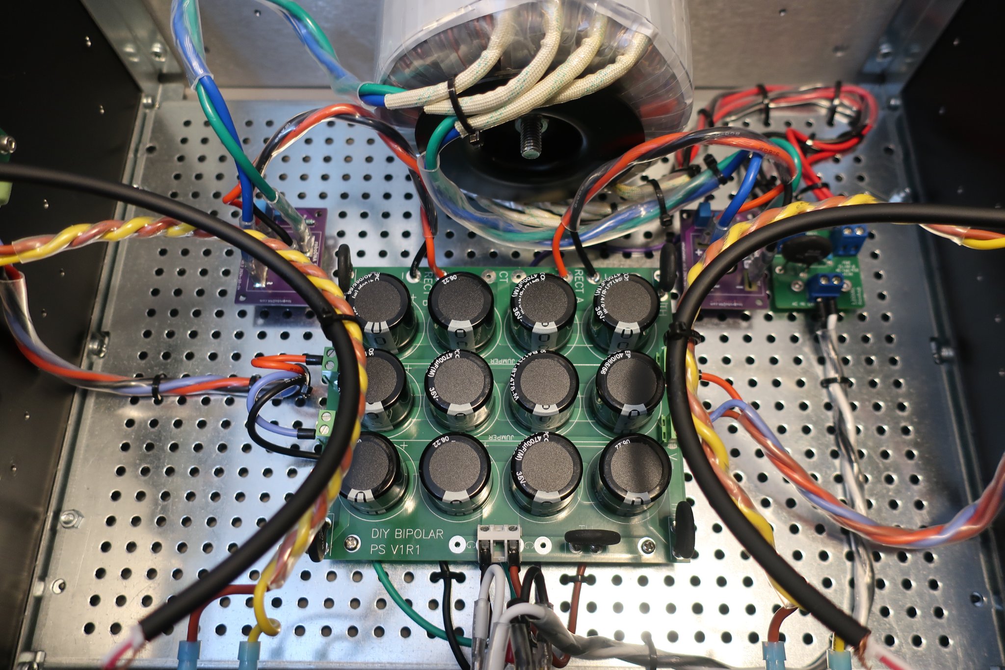

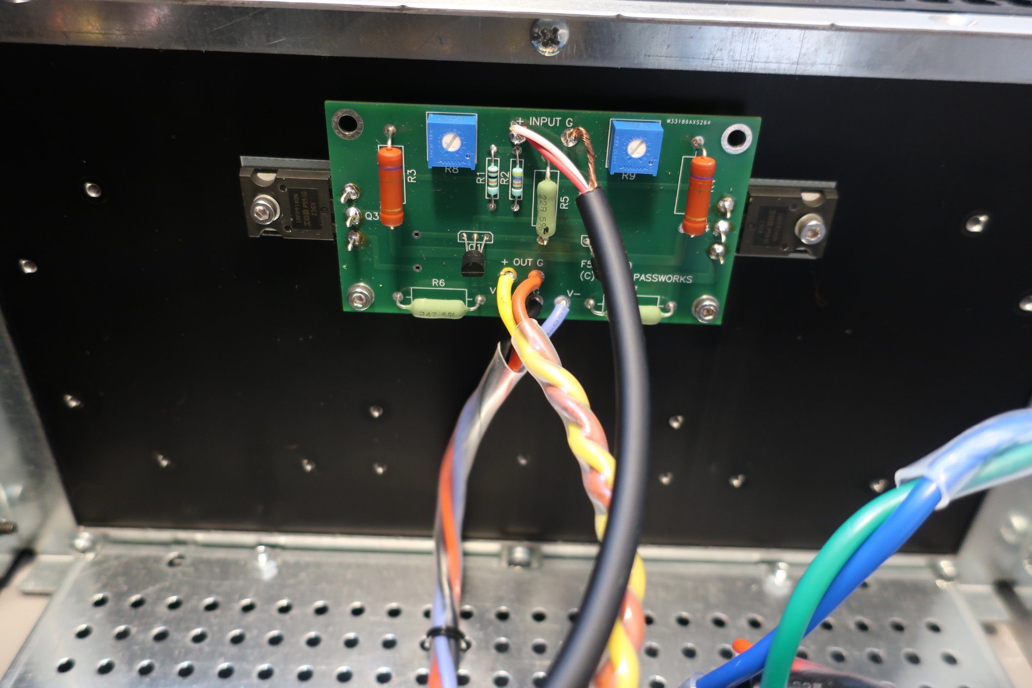

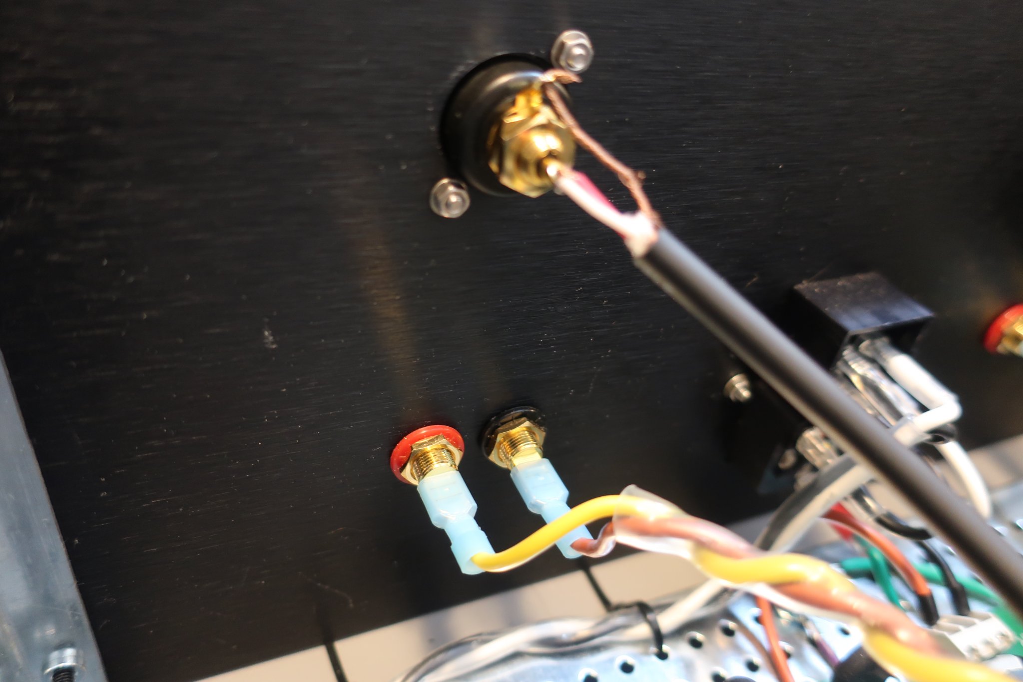

Thanks to everyone's help, suggestions, and putting up with my sass, I managed to finish my build! It's not perfect, for example, one channel still uses a black wire instead of a brown wire ( chose to leave the black wire for now ), and the black/red wires from the snubber board to the PSU board are swapped; black should go to + instead of -. ( next build, I'll have black as live all the way to the doughnut ) I added blue locktite to the earth ground screws. I also turned the trims counter clockwise when looking at the PCBs with trims at the top. ( what is this 'ticklin' the dragon' I read about? not sure... )
I still need to insert a 2.5A fuse on the PEM live ( hope that is the correct value ) and then test with a DM for shorts and other potential issues.
Thanks again to everyone for the help and Nelson Pass for making this design available. I would not have been able to get this amazing amp otherwise!! ( hope it powers up too )

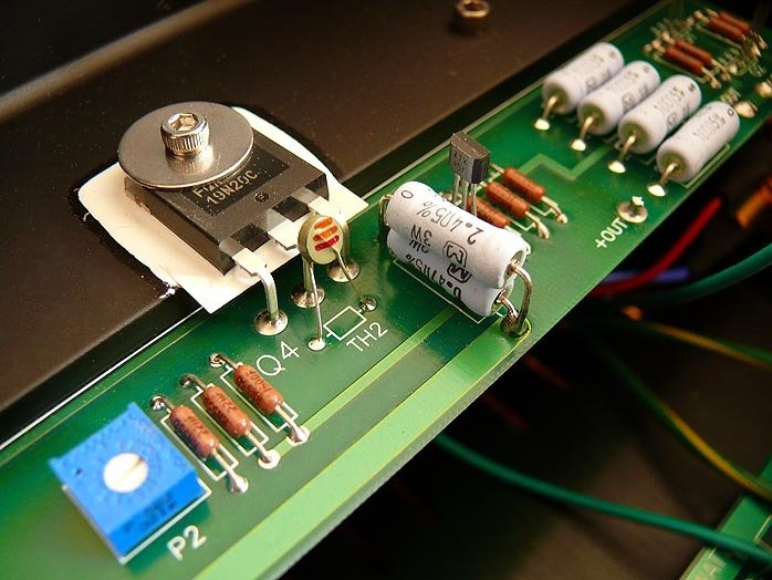

roboDNA - One way you could improve your MOSFET mounting there is to use fender washers to spread out the load (I use Hillman 3/4" washers). I attached a picture of a factory amp as an example. You'll also want a split washer under the screw head. Thermal cycling will tend to loosen this connection over time if you skip the lock washers.

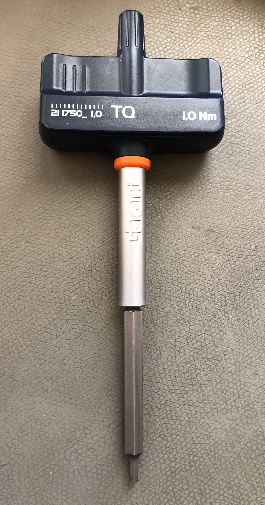

How much torque do I apply to the screws that go into the heatsinks? I manually torqued them just a bit snug but not tight, as I usually would with threaded aluminum. I want to avoid damaging the thread and at the same time prevent self-unthreading. Using a lock washer would increase the torque I apply. Should I get a torque wrench or do it manually? Did I see 11nm ( correction: 1.1Nm ) of torque somewhere? I don't want to go over the heatsink's threshold and strip the thread. I guess the length of the screw also needs to be considered for 'minimum thread engagement'.
...Using a lock washer would increase the torque I apply... I guess the length of the screw also needs to be considered for 'minimum thread engagement'.
I use M3 curved spring washers. You tighten the M3 screw until the washer flattens. It's not coming out until you take it out. I don't bother with fender washers because the heatsink is what's dissipating the heat.
