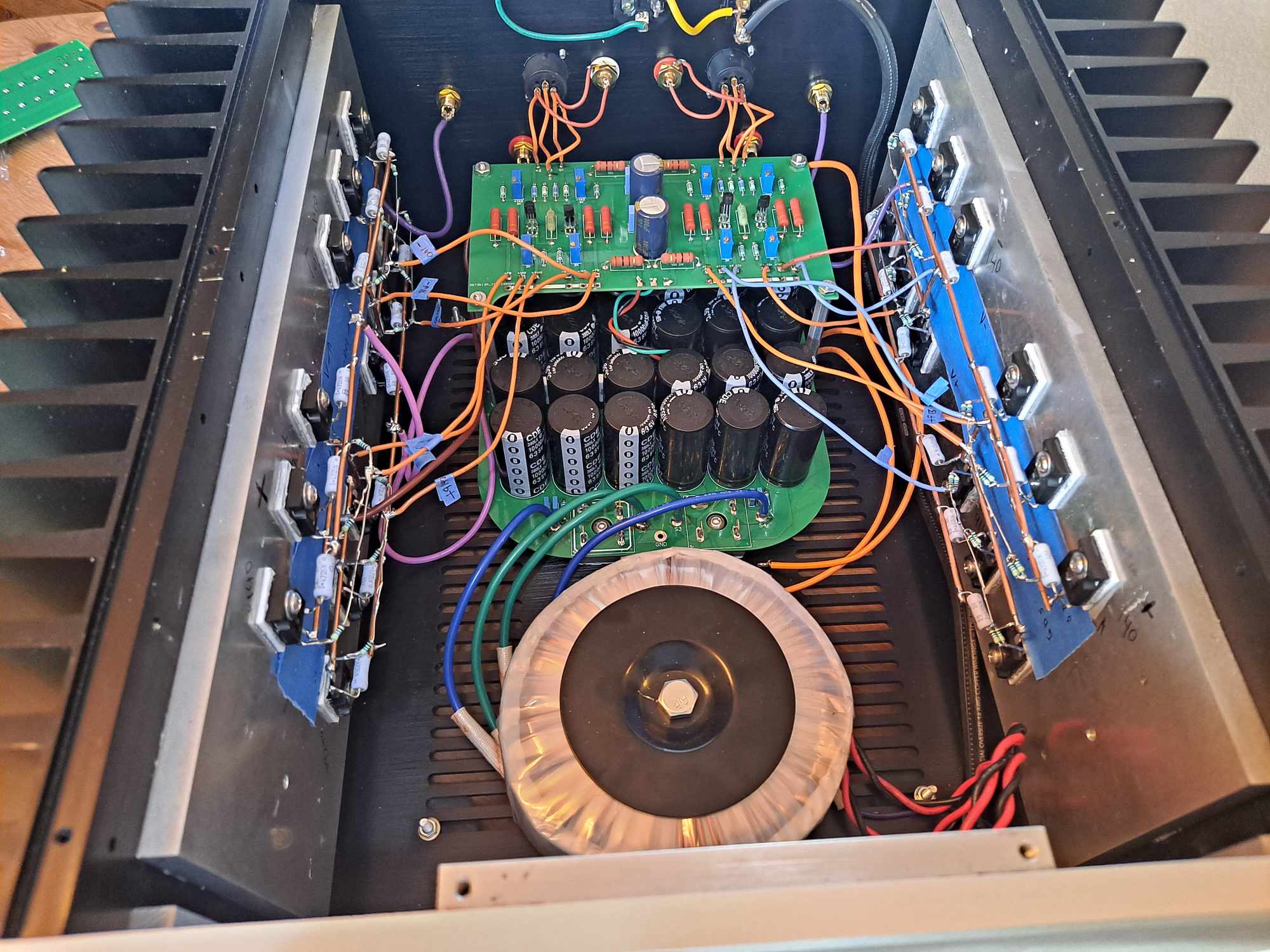

I have been playing with this F5m Circuit. I designed a bridged PCB front end for it and have been testing different arrangements in the output stage. I smoked a quad of 140/9240 mosfets.... Well, actually, I blew the source resistors and decided to toss the mosfets... Oh well. So I am playing with different amounts of IRFP240/9240. I have plenty of those... Haven't blown any of those yet... 🙄 Those are the ones that I should have started with...
Only thing different from the original F5m is that I am trying different IDSS pair JFETs. Also, due to having mosfets in parallel, I am running gate resistors.
So far I like the sound with 6 pairs of output devices per channel pushing around 50 watts. 200mV per device/0.47R. At the moment I am using a 18vac 400va transformer (it is working pretty hard). I just ordered a 800va 22vac transformer which should wake this thing up quite a bit! The extra mosfets darkened and beefed up the soundstage and added the macro texture it was missing which is great. I think it needed it. I had started with 4 pairs of mosfets and the sound was a bit dry being balanced and distortion canceling... Also a bit thin and maybe a bit much on the highs.
Right now at around 50w of bias, I am sitting at 43 degrees on the heatsinks with a mosfet case temperature of around 48C so there is a lot of room for more power.
So after I do some more playing with things then I will eventually draw up some boards for the output stage and finish her up. It sounds really nice so far. I am hoping with the JFETs IDSS being different from N to P, that I am getting the amp to lean towards 2nd harmonic distortion. I may add a P3 type of thing later on.
The power supply is 240,000uF with a gentle CRC filter and a 70uF solen Film on each rail. Both channels share the PS.
The sound is beefy, nice soundstage with airy voices cutting through the mix. If the mix has depth, the sound has depth. I like it quite a bit. I may alter the feedback a bit to see what a different damping factor will do. Also, maybe try different amounts of bias on the JFETs to see what that does.
The attached pic is how the amp sits.

Just looking at your numbers, the bias was 200mV/0.47R = 426mA per device. Dissipation = 2 x 22V x 0.426A = 18.7W per Mosfet pair. So total dissipation = 6 x 18.7W = 112W per channel.
Reading Nelson's F5M writeup, his measurements were based on 1A bias. Your bias of 0.43A per Mosfet pair would probably be a factor in the difference in sound.

Yes, Mr Pass worked those mosfets pretty hard in the F5m which was great with the IRFP140/9140. If I understand correctly, they are effectively 2x240/0240. I think that was a great combination for the F5m. Especially with how he was able to get the 2nd harmonic distortion.
Yes, with the 24vdc rails, it probably has the potential to put out around 90-100 watts into class B. The higher rails will increase that a bit. I don't exactly need that but I have noticed that a little extra rail voltage seems to wake things up a bit.

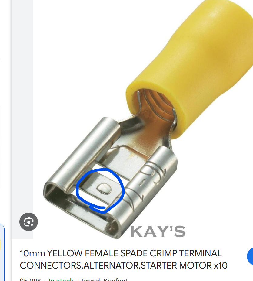

Soldering the bridge rectifier to the snubber board reduces the length of the rectifier leads to the point where they cannot be securely connected. I'll have to figure out a way to keep those spade connectors on, maybe I'll solder them if it can be a risk to speakers.

I'll agree, you need a little slack in the wiring. roboDNA might need to use a wire stretcher... (I'm joking). Maybe something could be relocated (or re-done) just a little to gain some slack / strain relief?
I used pliers to tighten the spade connectors and it seems to have helped. I may have added too much solder to the spade connectors ( belt and suspenders ) to prevent them from being fully inserted. I have shrink tubing around the spade so I don't think it could have shorted anything when it came lose, and if there is no risk for damage to the amp or speakers by them coming lose than I won't belt and suspender them to the rectifier for now.
There is enough wire length already and I added a zip tie around all 4 wires just above the rectifier, but not sure that will help. I think they are on solid enough and should not come loose again.
Or solder the female spade to the terminal? 😮 I think Jim's suggestion will work just fine. There should be a button type of thing on the spade that engages with the terminal on the rectifier. When you take the connector off, push this in so it more firmly engages with the hole on the terminal. That should hopefully keep it from popping off as easily.
