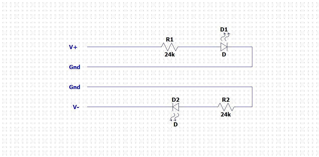

Take it from its output, the filtered and rectified DC, easiest from the positive half.
One series resistor per channel before the LED, going to the positive of the LED, the negative goes to ground.
If you look at the schematics of the PSU in the file, the resistor(s) in series with the LED go in parallel with V+ and GND.
Or you can follow Ben's suggestion, as he was quicker than me.🙂
Reactions: Stefano and brimax
You can connect one LED to the power supply output V+ and Ground, and the second LED to power supply output V- and Ground.
Hi ... another question after I did a simple calculation: if I consider a diode of about 2-3 volt ... with R=24k the resulting current is less than 1mmA. Is it enough to turning on the leds? Or is it better using a resistor in the range of 4-6 kohm?
thx
