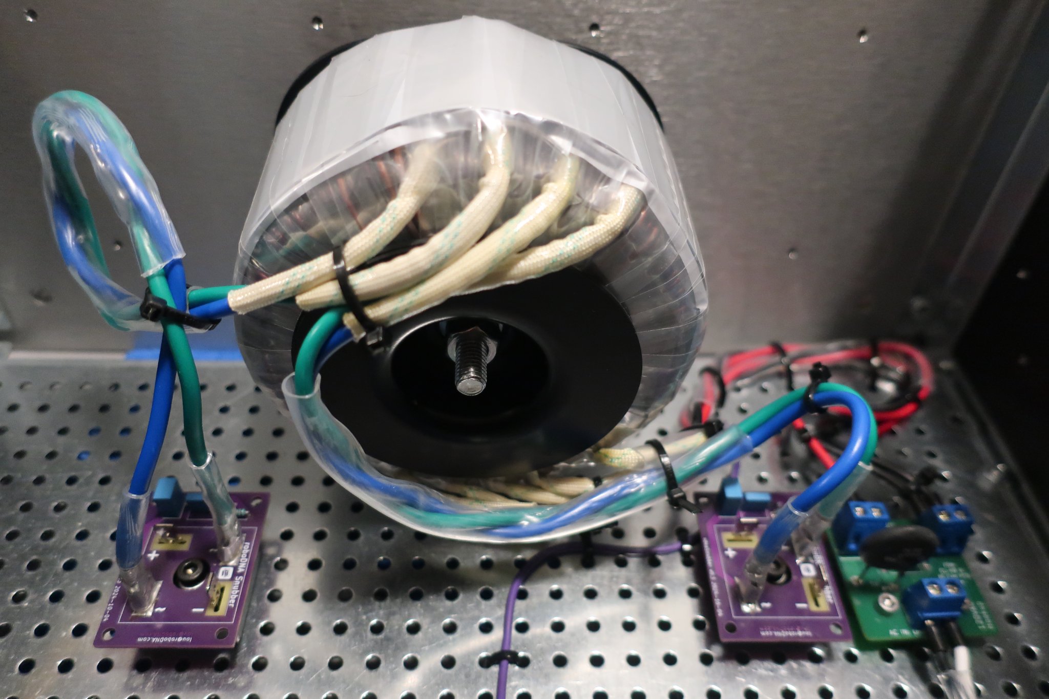

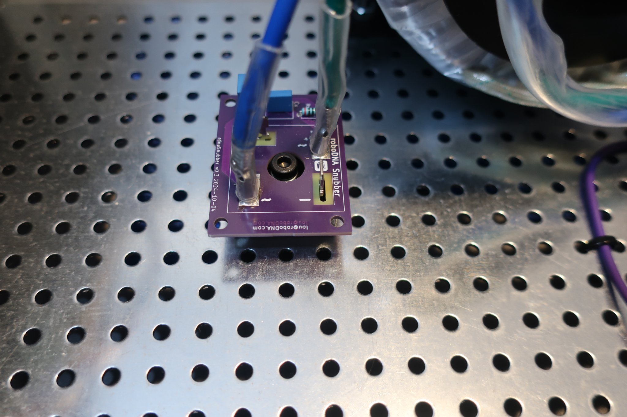

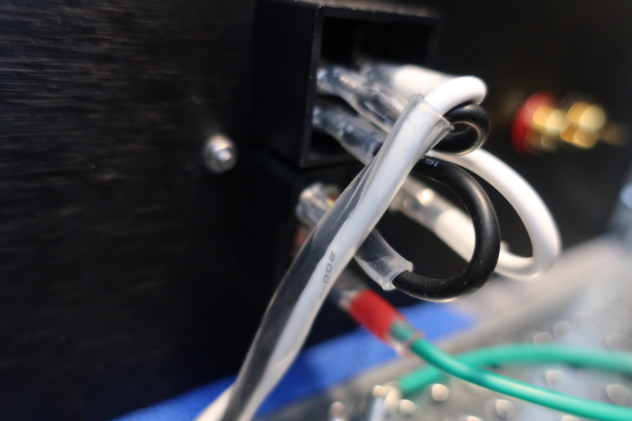

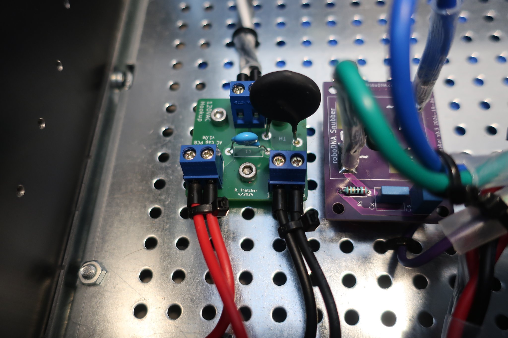

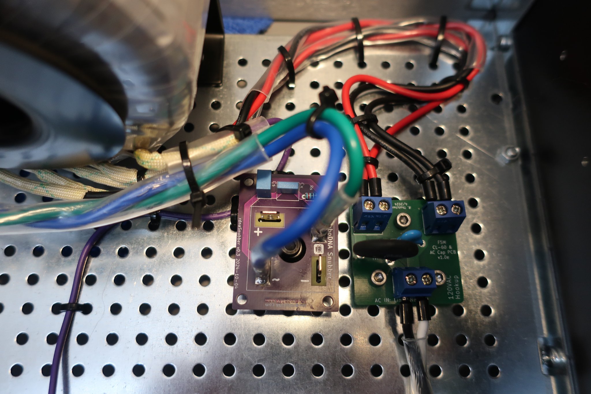

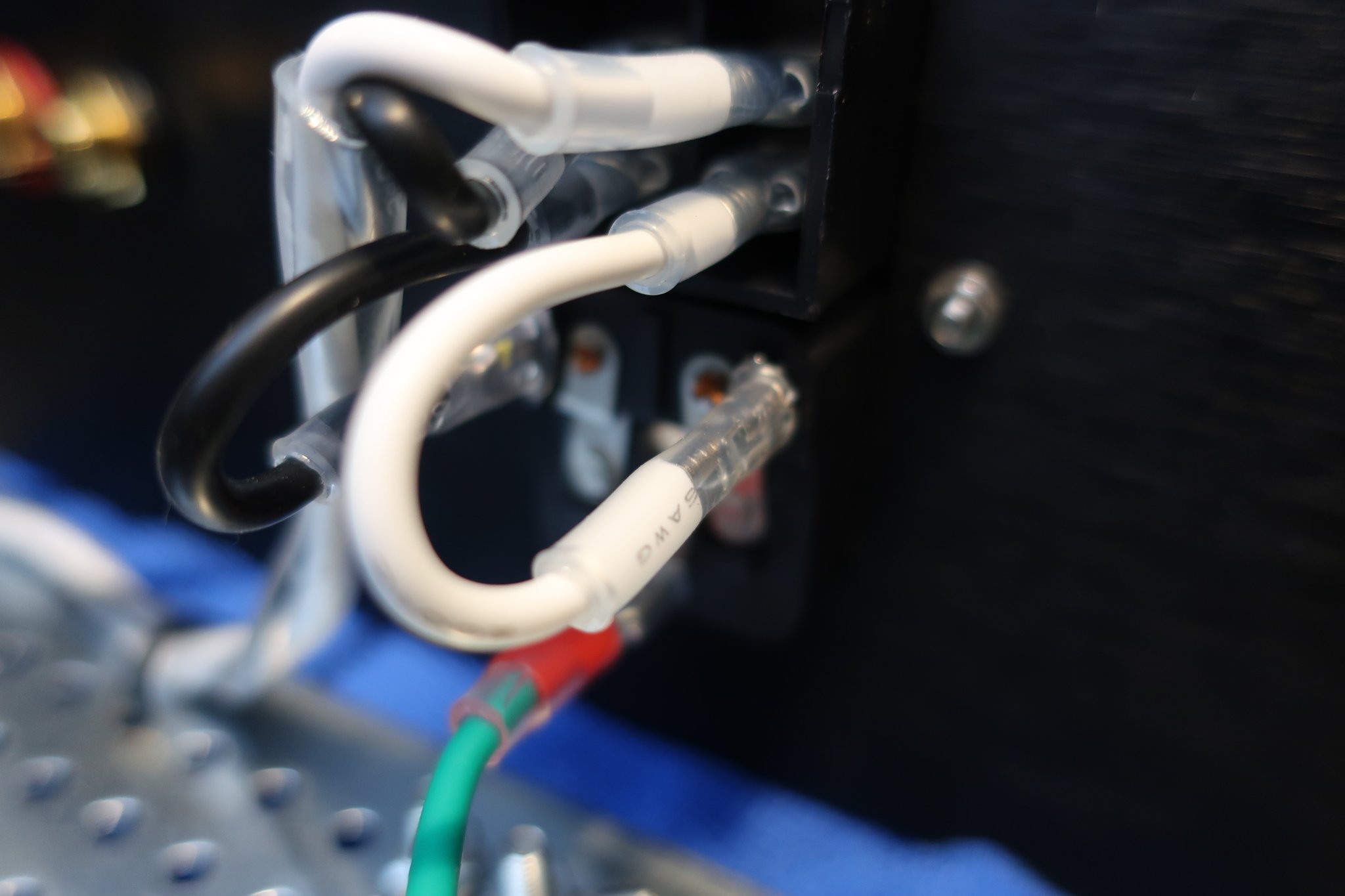

I received the CL-200 bracket from Antek and was able to finally get the wiring done. ( had to re-do connectors to add belt and suspenders ). Should be connecting to DBT in the next couple of days. Since it's my first build ( fingers crossed ), here are the pics to make sure all looks good:
^ Nothing that I'd necessarily suggest changing, but a few comments.

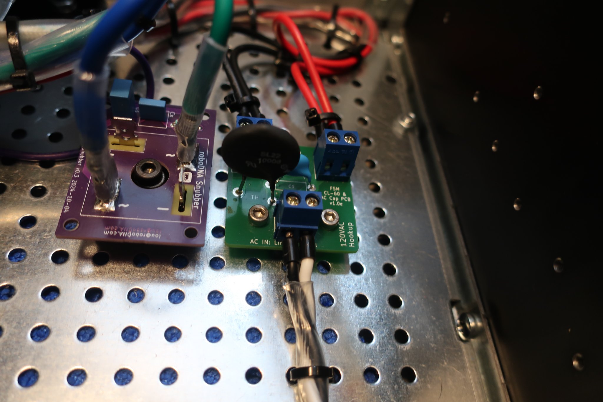

I'm not sure what PSU you're running, but a single (don't know if it's an actual CL-60) thermistor in your "soft start / cap module" may get quite toasty and/or be out of its league on 120V mains UNLESS you are running it with the "F5m" PSU that uses the thermistors as both inrush limiting and for the "R" in the CRC. Typically you'd see one across the 'hot' and one across the 'neutral' leads for 120VAC mains.
I'll leave that (potential) concern to others b/c I'm only about 60% sure it's even relevant or accurate, but I wanted to bring it up... just in case... and to learn a bit myself.
- Looks very clean. Attention to detail. 🙂

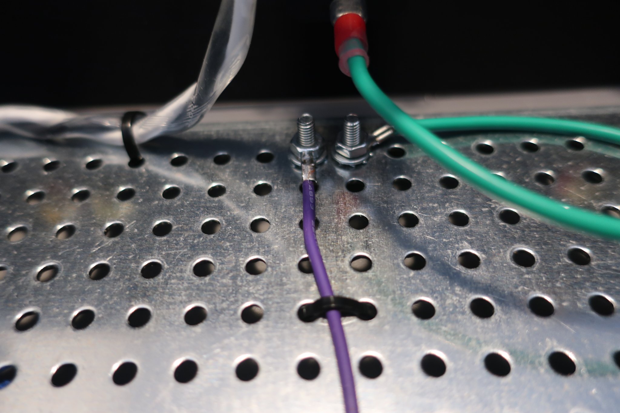

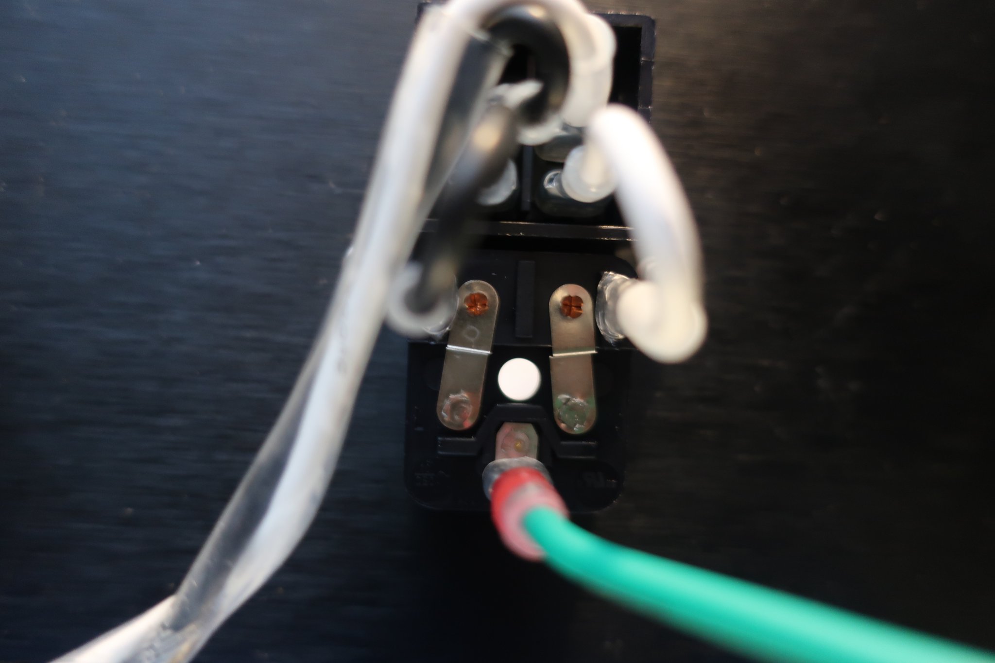

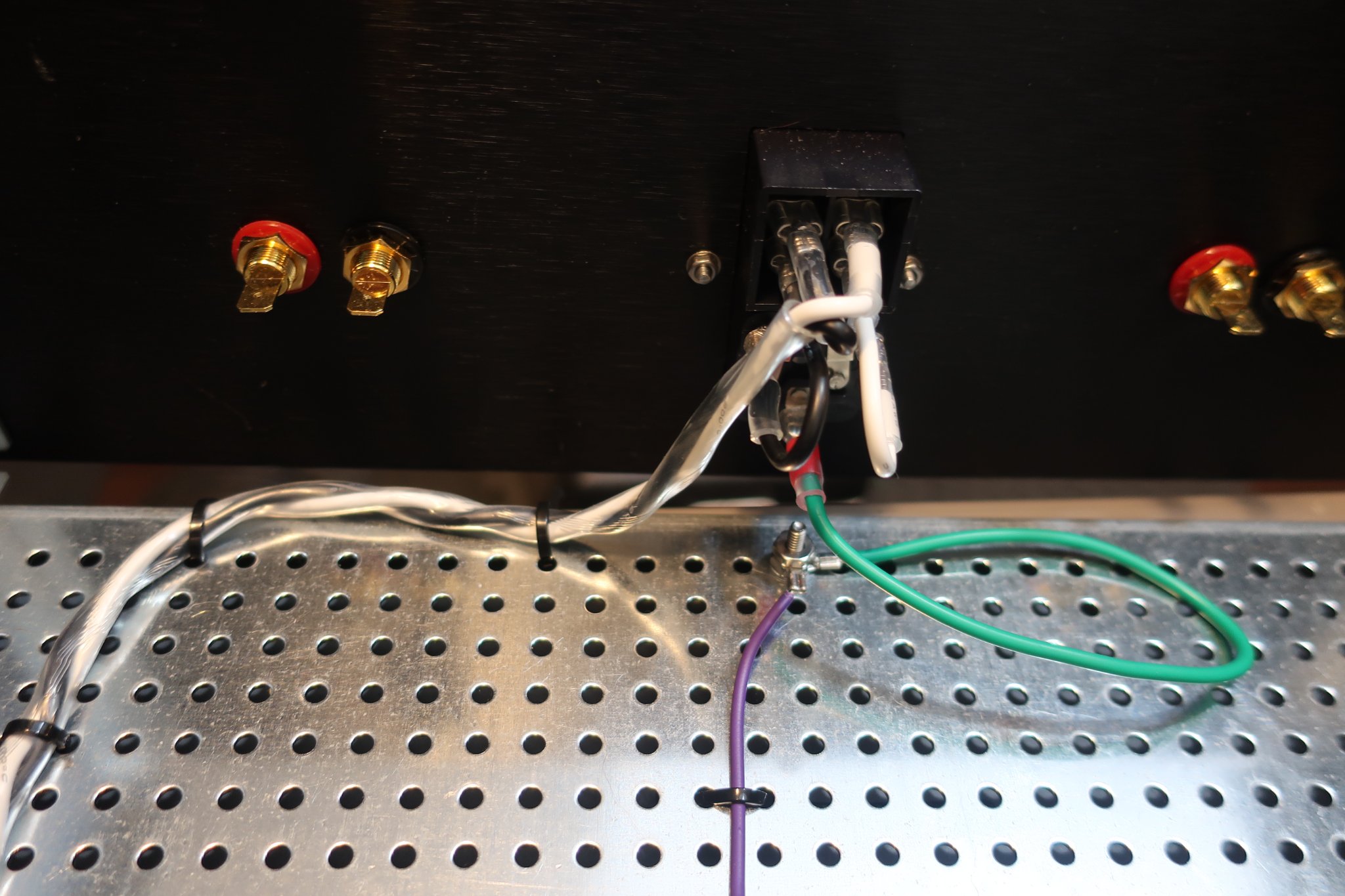

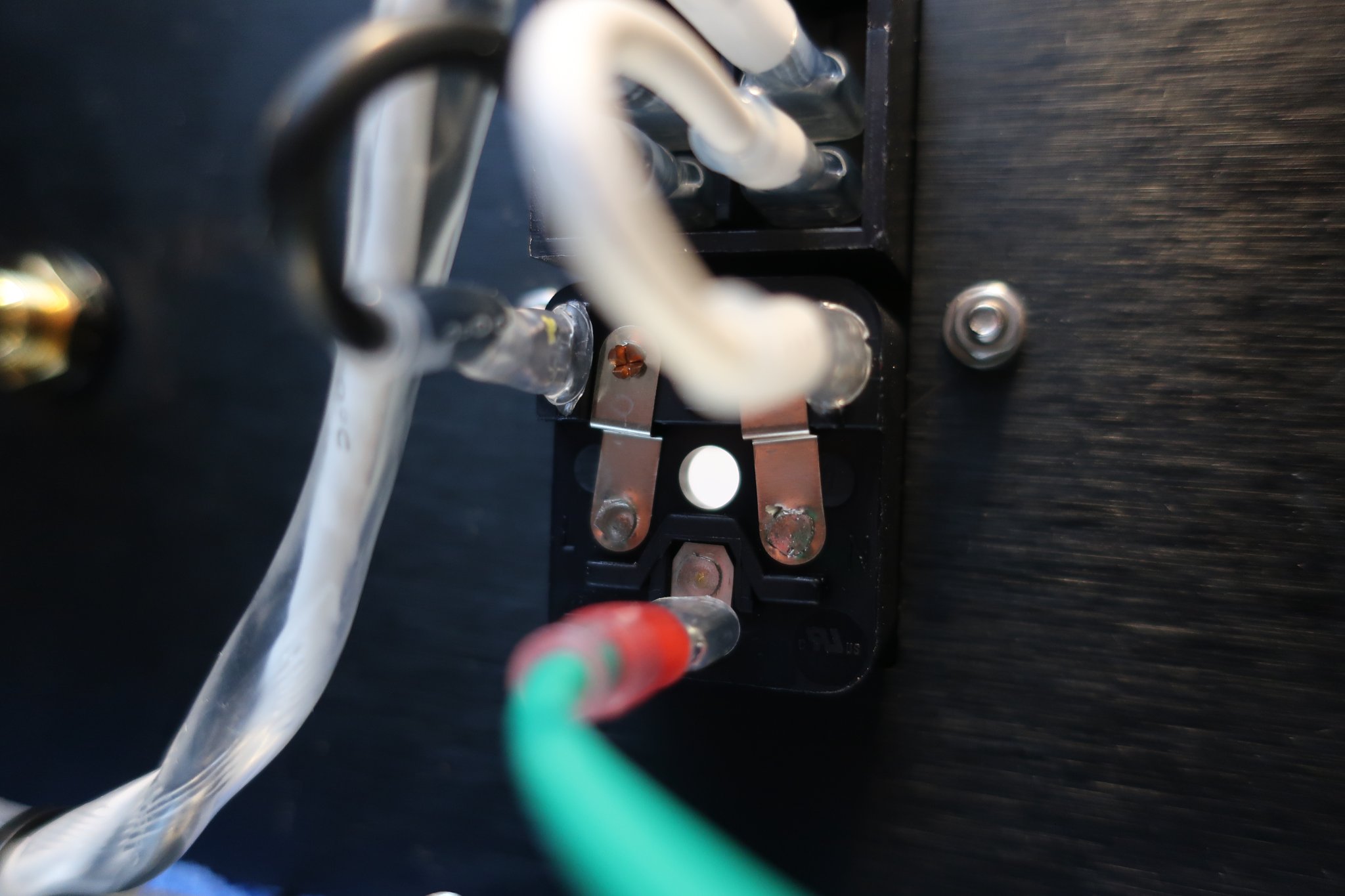

- As a best practice, the mains earth connection from the PEM should not share any connection to chassis ground. The shield wire from your donut could be shorter and connected to the perforated base plate closer to the donut.
- I like to keep black as hot / white as neutral then follow the black wire through to the primaries with Antek transformers. It's just the way I do it. That isn't even a "best" practice, but I always know that black is hot on the mains AC side of things.
I'm in 120VAC-land and I've had pretty good success using a single CL60 in builds for inrush control. My typical PS uses a 300VA transformer in a CRC configuration with about 170000uF capacitance in total. The fuse is 2.5A slow blow (following the 'VA rating/AC voltage' rule of thumb) and I fortunately have not had any fuse blowing from startup inrush.
The single CL60 does get toasty though.

As I'm in 240 land and I'm using the F5M supply (500VA with a planned 120000uF) I'm assuming a single CL-60 (or SL22 as in the kit) is fine in my case? Would that change if I were to swap out the supply for one without all the additional thermistors? Or am I generally in the clear as I'm higher voltage lower current?
As an aside/suggestion for future board revisions if any are planned, spacing for terminal blocks on the amp boards and pads for faston headers on the power supply boards would be a nice thing to have. I appreciate the aim of the kit is keeping things simple, but I feel like connection options are good. It's not like you can't just solder wire directly anyway if that's your preference.
So, common advice I see (not specific to this build or even this website) is to configure a star ground and connect everything's that is ground to the one point on the chassis, and then connect that point directly to the PEM mains earth. The way I'm reading your comment suggests I should not be doing that? Or am I misunderstanding? Is it an electrical thing, or a mechanical security of the PEM earth connection to the chassis (i.e. if that connection is its own thing, it's less likely to be accidentally loosened)? The only thing I was ever told was preferred was making sure the earth wire had significantly more slack than live and neutral, so that if the PEM got yanked from the chassis somehow, mains earth would be the last to disconnect.
Also re: the shield wire being shorter, what's the reasoning behind that and how important would you say it is? I ask because my gut feeling is to leave all the transformer wires at their manufactured length (about 20cm) if possible, to avoid stitching myself up if I need to reorient the transformer, or if I need to reuse it in a different build. Cutting it short will also affect the possibility of a star ground arrangement, as it's not close to anything else that needs ground. I'll do it if there's good reason of course. 🙂

Calling all "real" experts to double/triple check below... I'll repeat what I've 'learned', but for the sake of safety, it's best if someone with an actual understanding reviews. We all learn, and I'll take a go, since I was quoted. @twofires - I'm no "expert" in this area. So, wait for someone else to confirm. I got a lot of my information from Rod Elliott's site.
tl;dr - chassis ground will not (always) be at the same potential as "audio ground".
I truly can't / shouldn't specifically comment on the length of the safety earth wire between the PEM and the chassis and any reasoning behind it. That's way out of my league.
Cheers!
A star "ground" is simply connecting a lot of common wires / traces that go back to various boards at the same spot. It is most commonly used for the "Audio" GND.So, common advice I see (not specific to this build or even this website) is to configure a star ground
If chassis ground = audio ground, which in some cases is true - that could be the situation. There are some people that do not use "ground lifts". However, most of the builds you'll see around here (unless they are modified / changed by true experts) will use a ground lift.and connect everything's that is ground to the one point on the chassis,
One thing that holds true is that mains earth "safety" ground MUST be at the same potential as the chassis or very, very close. Any conductive external chassis part that a human can touch MUST have a low impedance path to mains earth. It should be a highly reliable connection. So, it is very commonly recommended (and it may be code in some parts of the world) that the safety earth must not share any other physical connection with the chassis.and then connect that point directly to the PEM mains earth.
I'm only mentioning that the shield wire (ideally) would not share the same physical connection to the chassis as the mains earth connection b/c it is a generally accepted practice. The shield wire needs to be connected to "chassis ground", which is for all practical purposes "mains earth". However, it (ideally) would not share the same physical connection (nut / bolt etc).The way I'm reading your comment suggests I should not be doing that? Or am I misunderstanding? Is it an electrical thing, or a mechanical security of the PEM earth connection to the chassis (i.e. if that connection is its own thing, it's less likely to be accidentally loosened)? The only thing I was ever told was preferred was making sure the earth wire had significantly more slack than live and neutral, so that if the PEM got yanked from the chassis somehow, mains earth would be the last to disconnect.
Cheers!
The only thing I would add i, IF you have a PEM that has metal flanges with holes intended to support screws that hold the PEM in place (ie, NOT a snap-in Mount) then you should use a multimeter to check if the ground pin on the AC entry is connected to the metal flange with what should measure as a short. If so, and ONLY if so, then you already have a ground connection when mounting the OEM with screws. You may, at your discretion, omit the chassis bonding wire to a dedicated chassis ground. But there is no harm, and some may arguably assert that it is safer to always use a separate chassis grounding wire (and I would not disagree).
In you choose to omit the wire to dedicated chassis ground, then use star washers and split washers (or equivalent) to mount the PEM securely to the chassis. A thread locking compound would also be desirable.
This is, as I understand, legal in US. Others who live in other countries must verify their country and local electrical requirements.
Thanks for that folks. For the record I'm absolutely pedantic about Earth pin having a wire to the chassis and all panels measuring 0 ohms back to it, so no dramas there. Not a fan of the 'just torque it and hope for the best' method of panel continuity.
I get what you're saying about that wire having it's own bolt, although I'll have to take a look at how these audio ground lifts are done. I understand that it's to keep ground noise out of the signal, but I'm not sure on how it's usually achieved. Time for me to do some reading. 🙂

@Zamjazz27 Here is a closeup of the PEM module. Posting here in case anyone else needs to see how to connect it:
