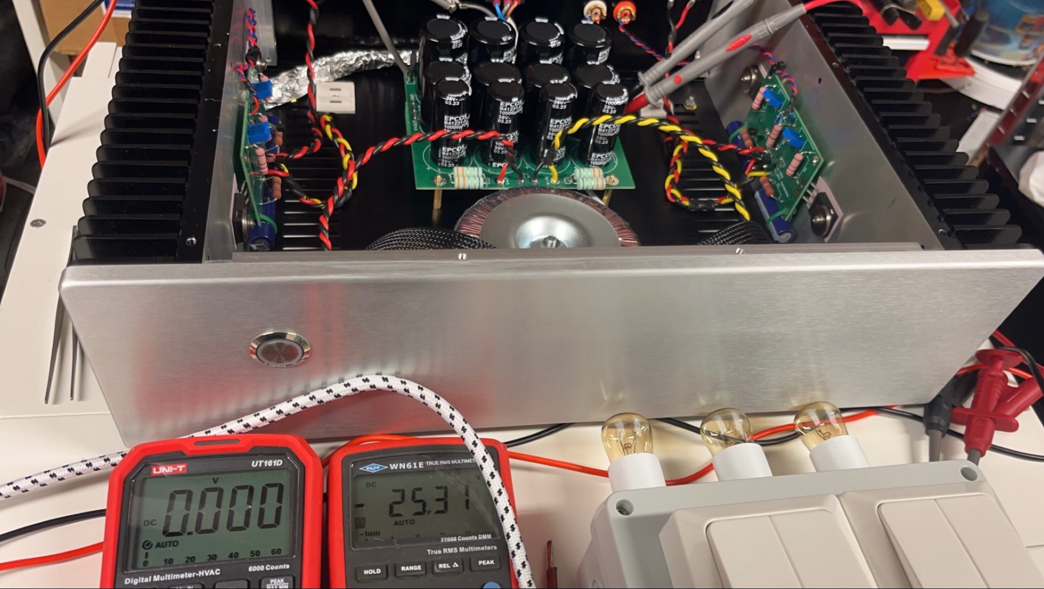

Thanks for all the info. I'll build a DBT. Should I get a 100W bulb or 25W? I don't yet see the benefit of having three 25W bulbs in 'parallel' since any issue would be found when only 1 bulb is turned on? I'm also envisioning the three bulbs in series and not in parallel....

The reason I’m using three bulbs is not just to make it overly complex. Hehe. I can’t buy a high wattage incandescent bulb where I live so I opted for three 25W bulbs which when connected in parallel would be about the same as one 75W bulb. The bulbs are connected in series with the tested device as the normal DBT just in parallel to each other. I opted to add switches so I could vary the amount of power the DUT would be allowed to draw, because if I wanted to test a pre amp or some other low power device, a 75W or 100W bulb would probably allow more than enough current to flow to ruin my day if I had done some stupid mistake. I also have a switch to bypass the bulbs altogether so I don’t have to shut down and disconnect it to continue with biasing or whatever.

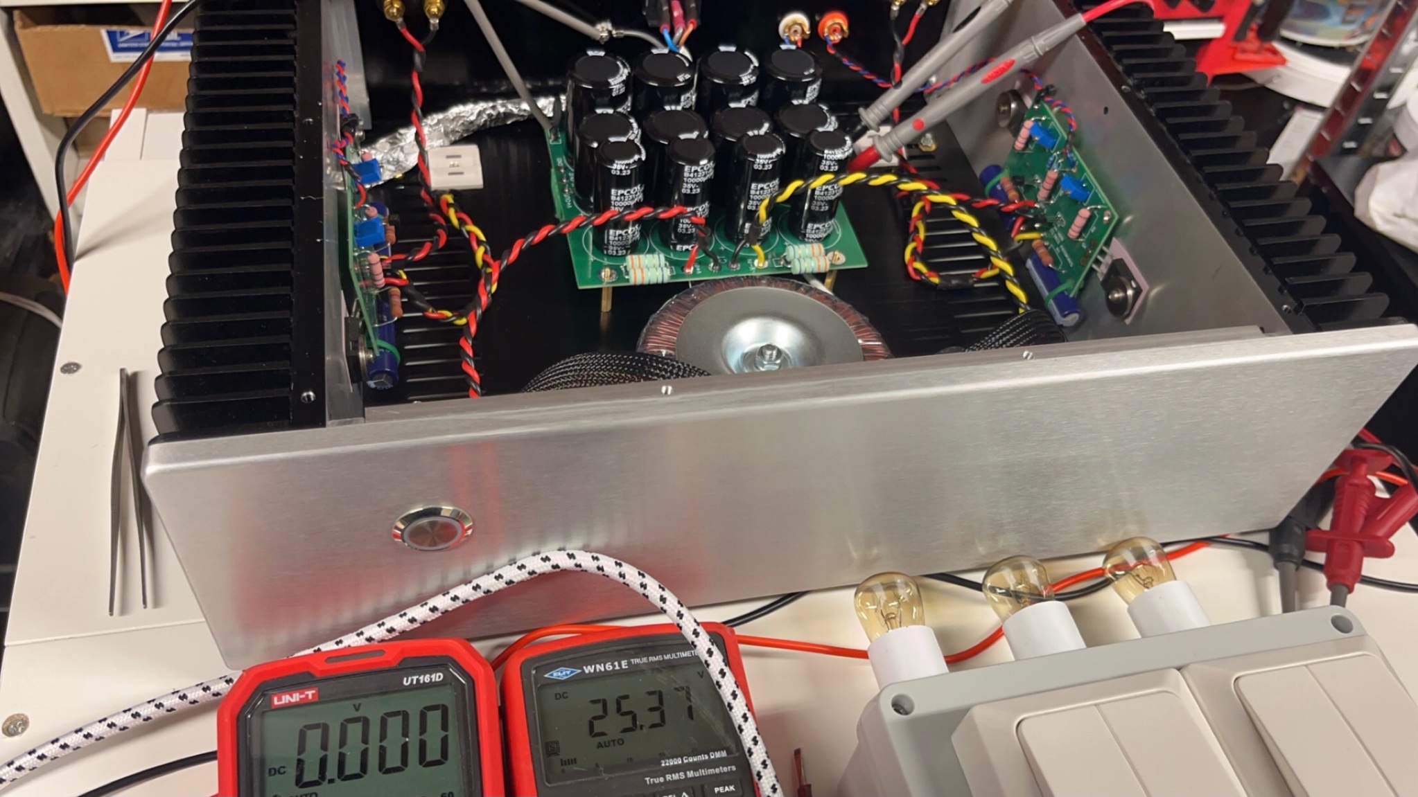

I tested the power supply on my F5m build today, and opted for just one 25W bulb in series and the bulb stayed bright for a surprisingly long time. I was just about to shut it down when it started to dim and went dark. I guess I went a little overboard with the caps. 232000uF total for both rails stores quite a bit of energy.
The left dmm is connected across the thermistor to ground and the right one shows the rails.
