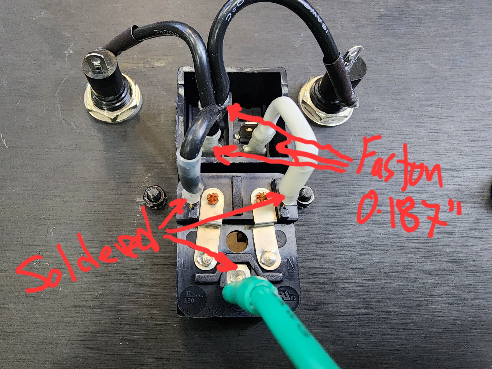

The small ones for the switch on the PEM are 0.187". I solder wires direct to the ground, hot, neutral for the 0.25" with heat shrink as @Ben Mah described.
I do use 0.25" for the rectifiers and other areas where I choose to use faston spades for a quick disconnect.
Ah, ok, thanks @birdbox that makes sense now. I thought the suggestion was to solder all the wires and not use any spade connectors at all. I see the fastons for the 4 top leads which are the ones I butchered trying to solder. The other 3 pins could easily be soldered as I did the earth ground.

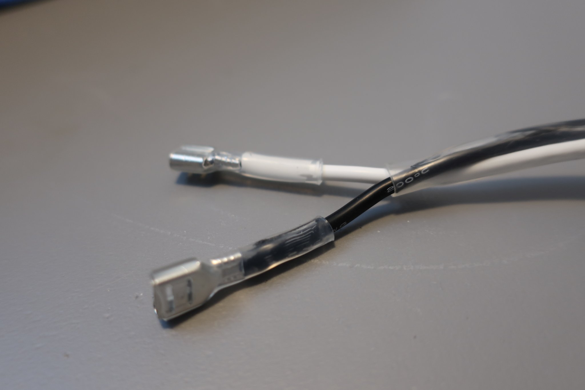

I used the faston connector with insulation removed, crimped and soldered ( belt and suspenders folks ) and the transparent 1/4" 3:1 shrink tubing recommended by @birbox and the result is VERY GOOD. It clips onto the lead with just the right amount of force and can be removed without the faston crimp failing. The transparent shrink tubing ads additional peace of mind by allowing the builder ( me ) to see a good crimp and solder and will prevent a short if it comes loose.
Also, for anyone else having trouble attaching the terminals to the PEM, the switch CAN BE POPPED OUT! Thanks again @birdbox for pointing this out to me.

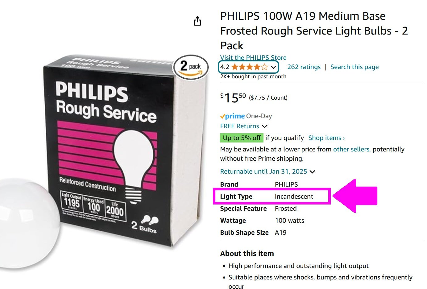

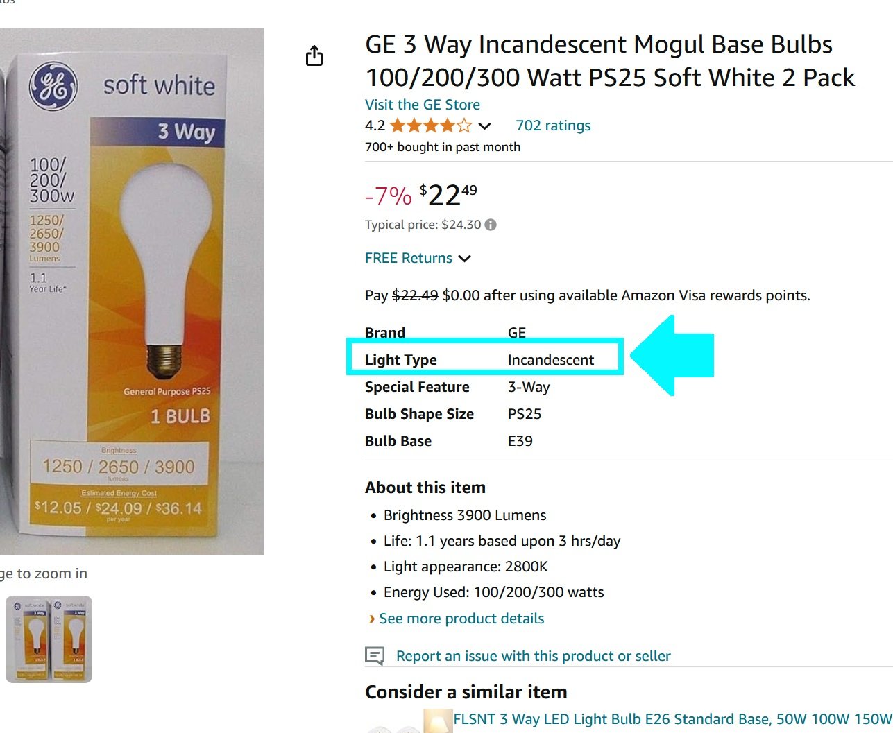

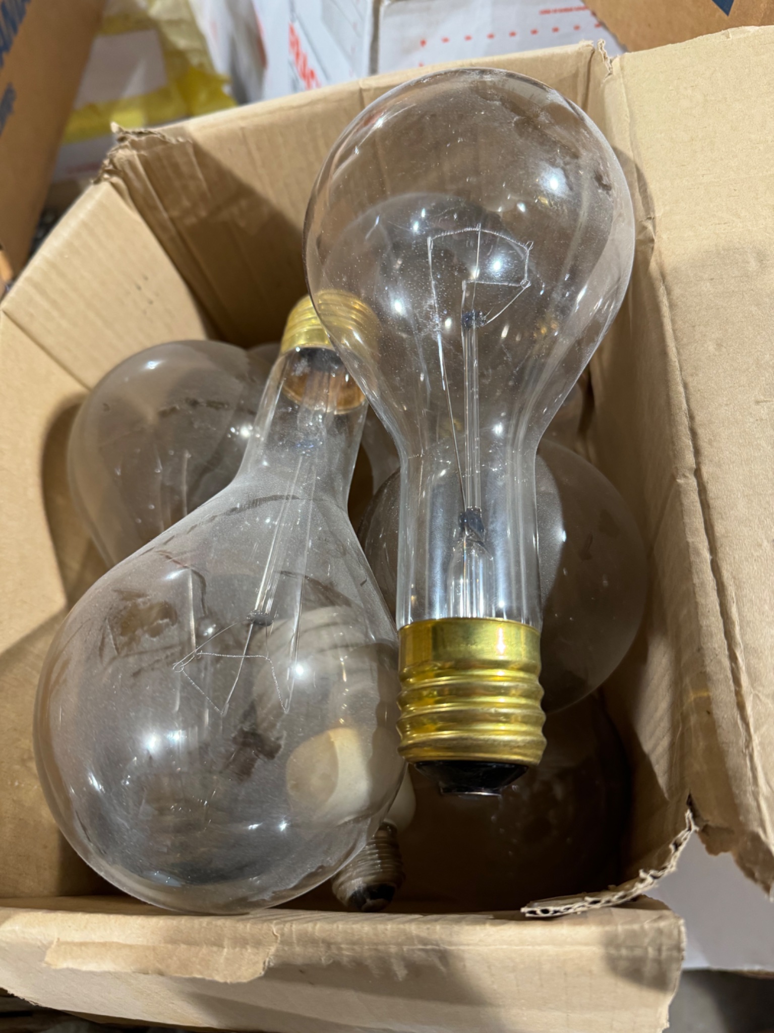

I have a dim bulb tester and I can purchase the Tungsten filament bulbs I need, from Amazon.com . The "trick" is to realize that it remains legal to sell incandescent bulbs for a few niche applications, such as appliances (refrigerators), and hard-to-access outdoor installations, so-called "Rough Duty" bulbs. Take a look. Amazon is happy to ship both of these to ultra-woke, ultra-environmentally-conscious San Francisco.
They are available. They are not cheap.

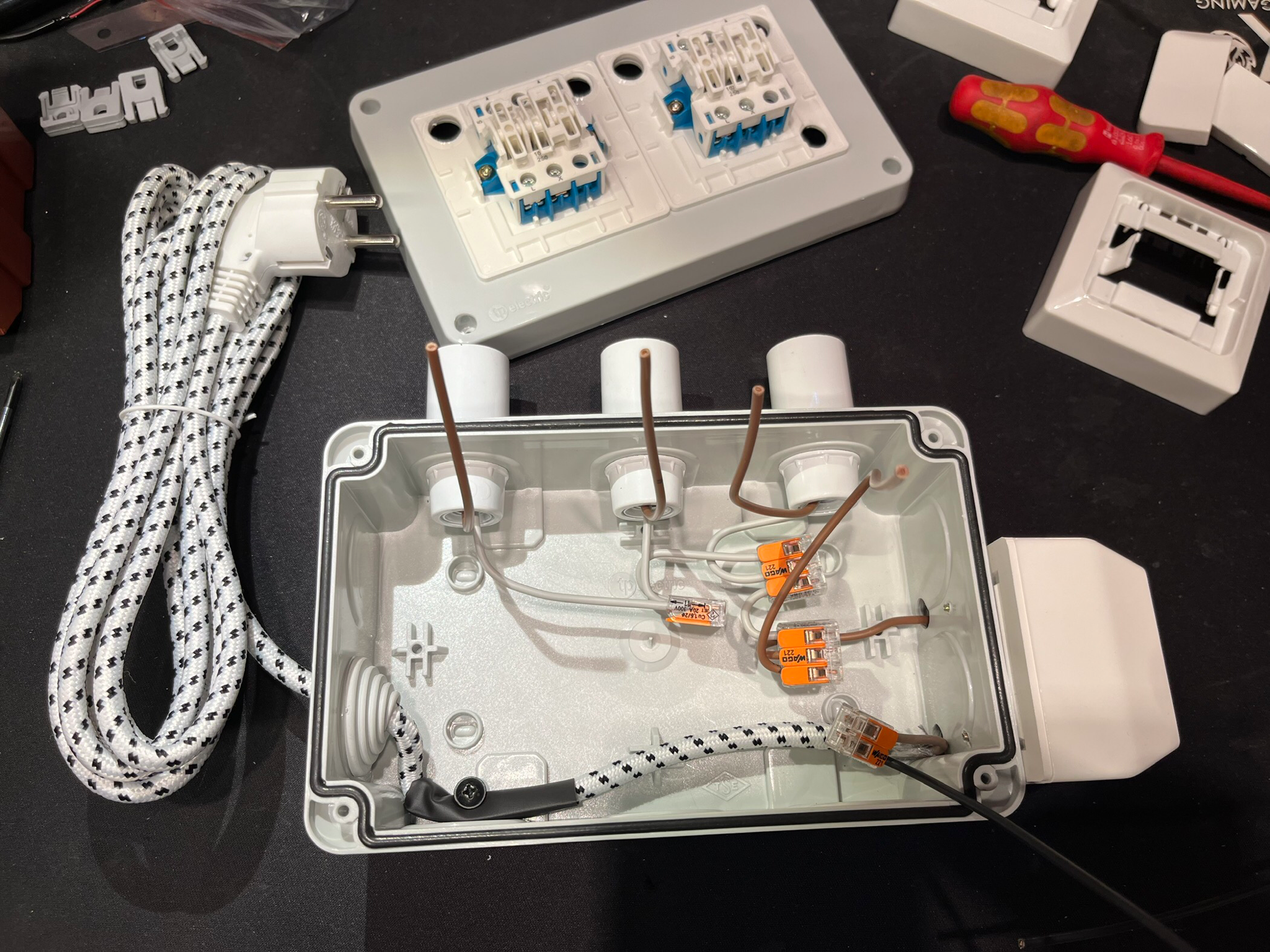

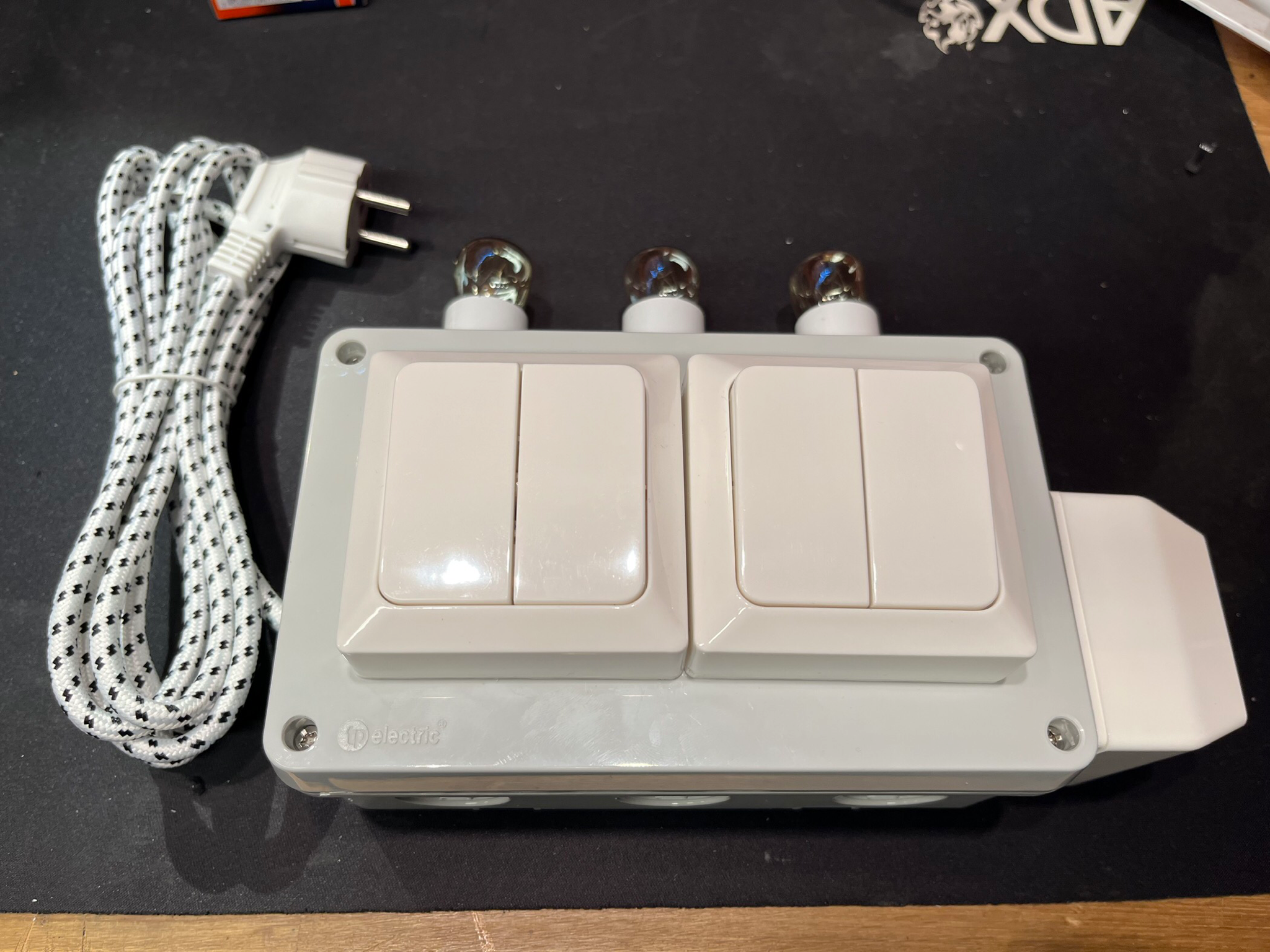

Low wattage incandescent bulb are still legal here in Norway. Used for example in kitchen stoves as I guess led’s won’t like the heat. So I made an overly complex DBT using three 25W bulbs paralleled via independent switches so I can vary the load. A fourth switch bypasses the bulbs and sends full power through to the DUT.
