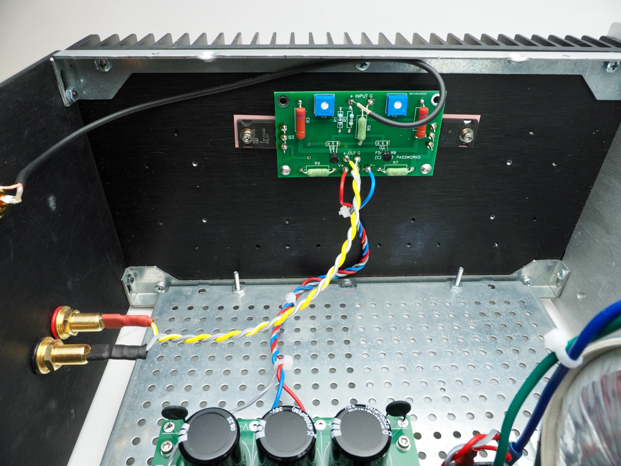

I should have mentioned I'm not installing balanced XLR inputs for now, only RCA. My understanding is that since I will be using an XLR to RCA adapter ( unbalanced ), I'll just connect 1 wire from the post to the amp board's input, and the shield from the post to the board's ground. If I ever install XLR balanced inputs, I'll connect the balanced pair of wires to the amp board's input and the sheild to the board's ground. ( not sure about directionality though and if the ground should be left floating on the amp side )
XLR should be grounded on both sides. The negative and positive signals are both sharing that ground reference. I don't think you want to leave one side floating. I could be wrong though, but when I connect balanced, I connect 3 conductors at both ends, no floating conductors.....unless you have 4 conductors I suppose....then you have an extra 🙂
The cable you posted has two conductors and a shield. For an unbalanced (single ended) signal + ground connection, I would use the two wires for signal and ground, connected at both ends, and use the shield as a shield. I think somebody already pointed out that the ground reference of both the source output and of the amplifier input and the chassis ground on either side can very well be two different things, with a DC resistance and possibly also a frequency dependent impedance between them.I should have mentioned I'm not installing balanced XLR inputs for now, only RCA. My understanding is that since I will be using an XLR to RCA adapter ( unbalanced ), I'll just connect 1 wire from the post to the amp board's input, and the shield from the post to the board's ground. If I ever install XLR balanced inputs, I'll connect the balanced pair of wires to the amp board's input and the shield to the board's ground. ( not sure about directionality though and if the ground should be left floating on the amp side )

For the inputs, I'm looking to use "Contour 3224 audio cable". I plan on using my Soundcraft mixer as a pre-amp. It has XLR and TS 1/4" outputs: Outputs: 150Ω (balanced), 75Ω (unbalanced)
Will this cable be ok?
No. You may need to provide a bit more detail re: what input configuration works for you, but the F5m is (as designed) SE only. If you want balanced in the future, then you'll need to make modifications. Me, I'd leave it alone.( Do I need to worry if I end up using unbalanced input? )
It's just wire. You can strip out the conductors and use it for... well... anything you'd use wire for. It's (IMO) better for SE than balanced, but I've used it for balanced. It's just... wire. The existing twisted pairs, the fact that it's abundant, and it's essentially free to me are my motivating factors.I read somewhere using CAT6 twisted pair is ok but not for unbalanced. ( not sure why )
It depends on the adapter. Can you send a link, please. Either way, your RCA input wiring should stay the same on the F5m, IMO.I should have mentioned I'm not installing balanced XLR inputs for now, only RCA. My understanding is that since I will be using an XLR to RCA adapter ( unbalanced ), I'll just connect 1 wire from the post to the amp board's input, and the shield from the post to the board's ground.
You can install XLR jacks, but unless you modify the amplifier, you will not install balanced inputs. I hope that's clear. The way you're describing (if I understand you correctly) will not work properly. If you want to take (just for convenience) an XLR output from a pre-amp carrying a balanced signal and plug it into your F5m and get music, the easiest way to do it (IMO) is just to use the adapters you have.If I ever install XLR balanced inputs, I'll connect the balanced pair of wires to the amp board's input and the sheild to the board's ground. ( not sure about directionality though and if the ground should be left floating on the amp side )

Summary of what I think I understand.
You have a pre-amp or source that is balanced and will output a differential / balanced signal from the XLR outputs. It does not have RCA outputs or you don't have a proper RCA cable, or you just like XLR cables. So, you will use an XLR to RCA adapter between the pre-amp / source and the F5m. The adapters typically short the negative signal (Pin 3) to GND (Pin 1).
If so...
You only need two wires / conductors inside the amp, but you have three in the cable you want to use.... so...
For RCA inputs on the F5m - What I would do with your cable is:
Red wire - connect it the (+) pad (near the word input) on the amp board and the center pin of the RCA input
White wire - connect it to (G) pad (near the word input) on the amp board and the lug / tab on the RCA input.
Shield - Unconnected (others may have a strong opinion differing and good reasons... so ... YMMV).
Again... that's what I'd do if I only had that cable to use. I would not show that as an example in the guide you're creating. I'd use a simple two conductor arrangement for the guide, but ... that's me.

@ItsAllInMyHead thanks for the detailed info. My mixer has unbalanced output as well so I'll use a 1/4" TS cable for each channel, and add a 1/4"TS->RCA adapter at the end. ( keep it simple ) I see what you mean about the amp being SE. I guess the F5m would need a differential amplifier instead of the SE for balanced and there would be 2 inputs on the amp board for each channel instead of 1. I was originally planning on having my mixer about 20' from the amp so figured balanced would be better but I don't think it would have been a huge improvement over unbalanced anyways. I can also move the mixer closer to the F5m if I am concerned. I don't plan on doing a balanced mod since I'm very happy with the SE amp.
I'm still not 100% sure on how shielding between the 2 devices would work but I'll just get 1/4"TS->RCA adapters and worry about it if I get a hum. I can see why there are so many opinions on earth ground shielding to avoid 2 devices to fight over earth ground. It makes sense to me to leave shield disconnected on 1 end if both devices are earth grounded, and connected if 1 device is not earth grounded. ( bit of a rabbit hole )
I think I'm all set now and can finish the wiring.
