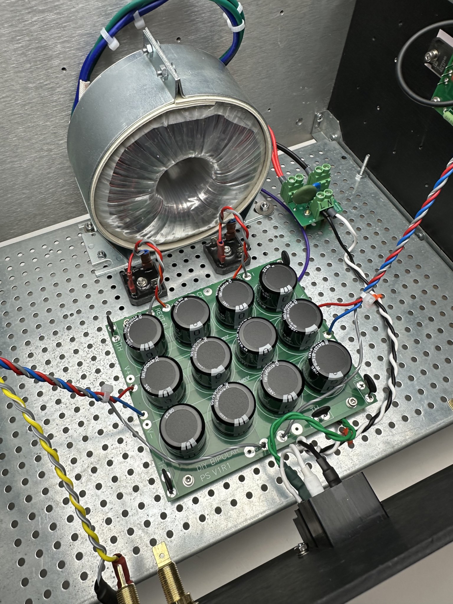

I'm looking for a good way to connect the 2 line and 2 neutral wires from the transformer to the screw header on the small 'Randy A/C splitter' board. I tried inserting 2 red wires from the antek transformer into the grey 16awg end terminal connector and could not fit them, and also noticed the connector does not fit into the screw header. I could tin the 2 wires together and just insert those into the screw header but should I use the terminal connector? ( I see pictures from another build appears to use the grey 16awg connector with 2 wires inserted into it, and then into the screw header )
I've had good success purchasing a (ferrule kit) and then inserting the two wires into the female side of an appropriate ferrule. Crimp with the death grip of a thousand demons from hell, and presto: it's strong, tidy, and electrically excellent.

I did purchase one of those kits at your recommendation I think... I now realize once I apply demon level pressure using the ratchet tool, the the grey 'ferrule' tip will then fit into the screw header. The 'ferrule' is too large before the crimping so I was stumped. I'll need to use some force to get those 2 wires to fit into the female end of the 'ferrule' though.I've had good success purchasing a (ferrule kit) and then inserting the two wires into the female side of an appropriate ferrule. Crimp with the death grip of a thousand demons from hell, and presto: it's strong, tidy, and electrically excellent.
I liked my ferrule kit so well that I commanded Amazon.com to send another one of those kits to moderator @6L6 and he loves them too.
UPDATE: I was able to fit the 2 wires into the ferrule however after crimping, it still does not fit in the screw header 🙁 I'll try a smaller ferrule but the wire insulation will not fit into the collar of the ferrule for 2 wires. Funny that I see another build using the grey ferrule and it fits. Perhaps they used a screw header with larger holes.
Perhaps insulation should not be inserted into the ferrule collar? Only the stripped conductor wire? I’m not sure if the collar provides strain relief. I’ve also cut off the insulation of the collar of Fastons, and then used a screwdriver to enlarged the diameter of the collar to allow wires to fit in before soldering or crimping. Then apply colored heat shrink,
You are correct, I did get the 2 wires into 1 grey 16awg ferrule. For some reason, the tip of the connector does not fit into any of the screw headers I have, and the ones I see on mouser all seem to have the same size hole. They all seem to have a range of 12-24awg. If I need to force it into the screw connector, I may try to find a different way.
Maybe I can splice the 2 wires together before the ferrule, add some shrink tubing, and then only have 1 wire going into the blue/smaller ferrule and then into the screw header.
I'm also considering just soldering wires directly to the splitter board, ( removing the screw headers ) and using 4 pin molex connectors like a PC power supply. ( I checked and PC power supplies have the molex connector wires soldered directly to the board )
My preferred choice so far is the screw terminal like the ones I show in this picture but I may need to spin up a new board. I'll check to see if the footprint will work.

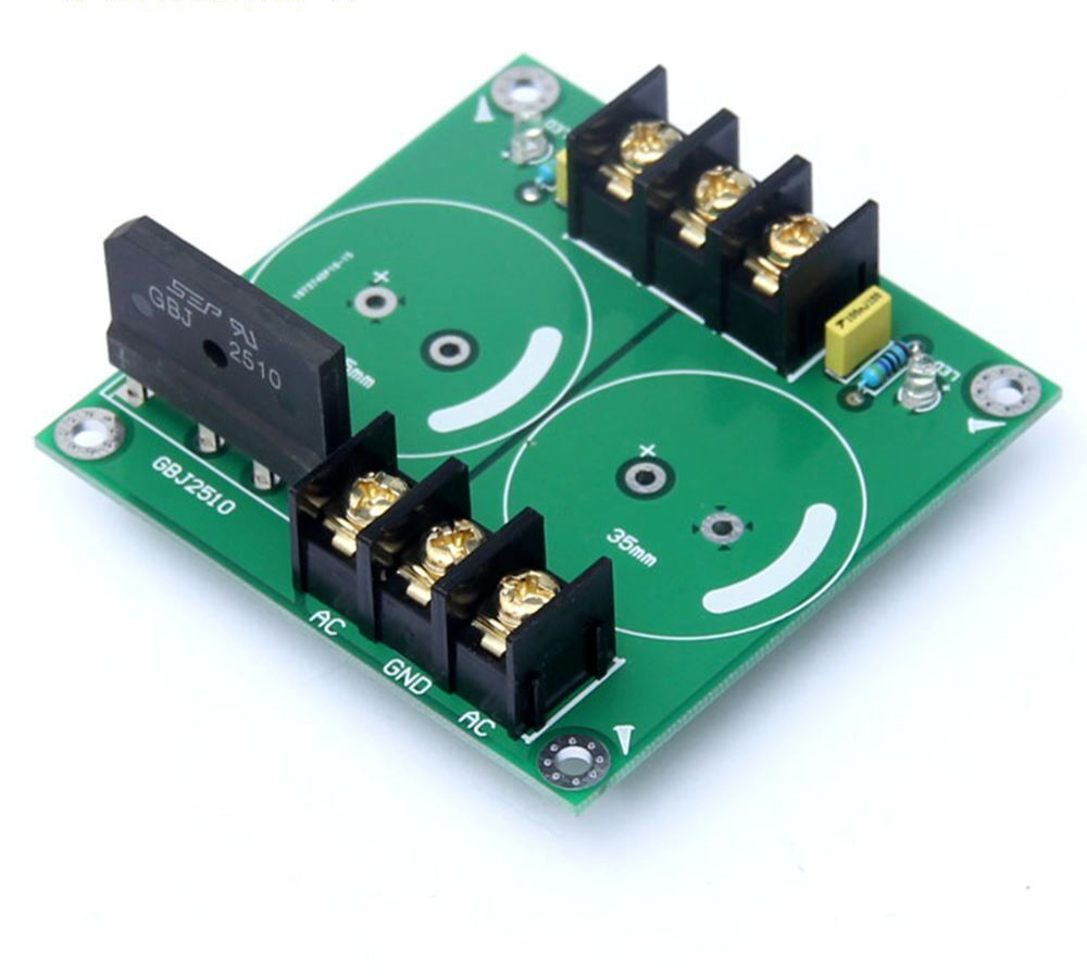

Well, problem solved. I looked at the PCB and sure enough, I don't need to stuff 2 wires into 1 connector. I went on a bit of a goose chase after seeing the following image and seeing 2 red wires stuffed into 1 grey connector, and same with the 2 black wires. One of the the board's input show N/C so I figured not connected. I just 'assumed' I had to do the same for some reason, but now see the randy splitter board allows each wire to be connected into their own screw hole. my bad. I can now proceed.
Update: I used the black 16awg ferrules on the end of each of the 4 wires and they fit perfectly into the screw headers. Seems solid to me. I wonder if the screw in the screw header header loosens up over time... Maybe I can add blue loctite or use the larger black barrier terminals with new boards.
