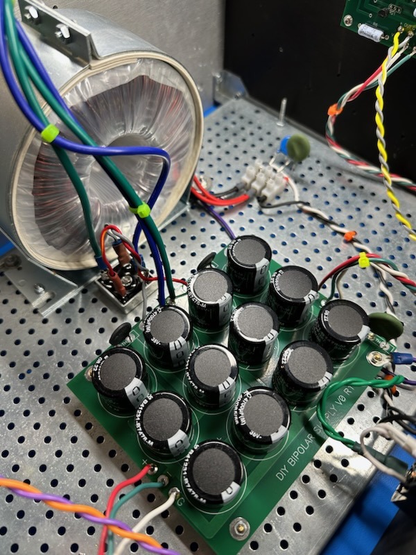

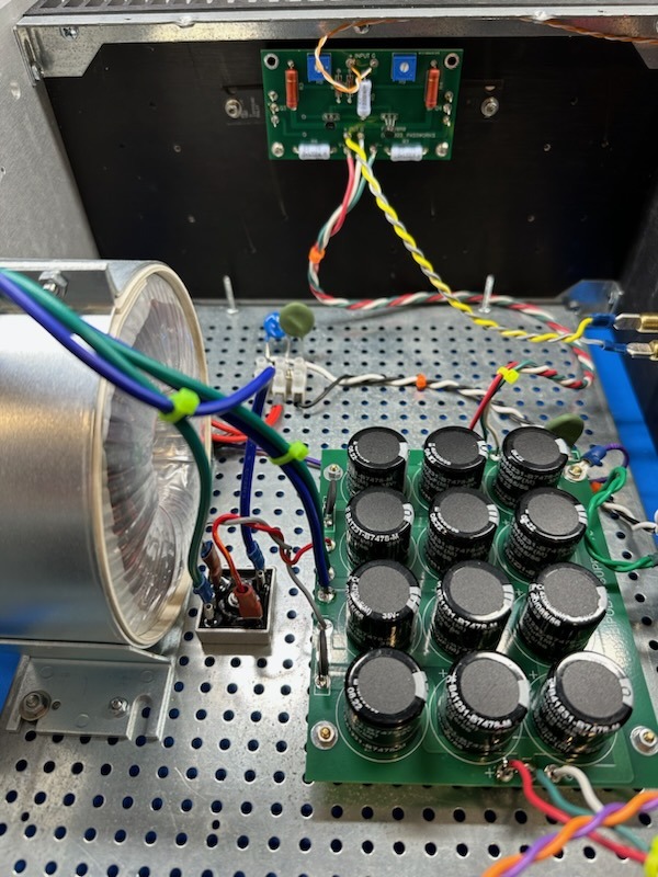

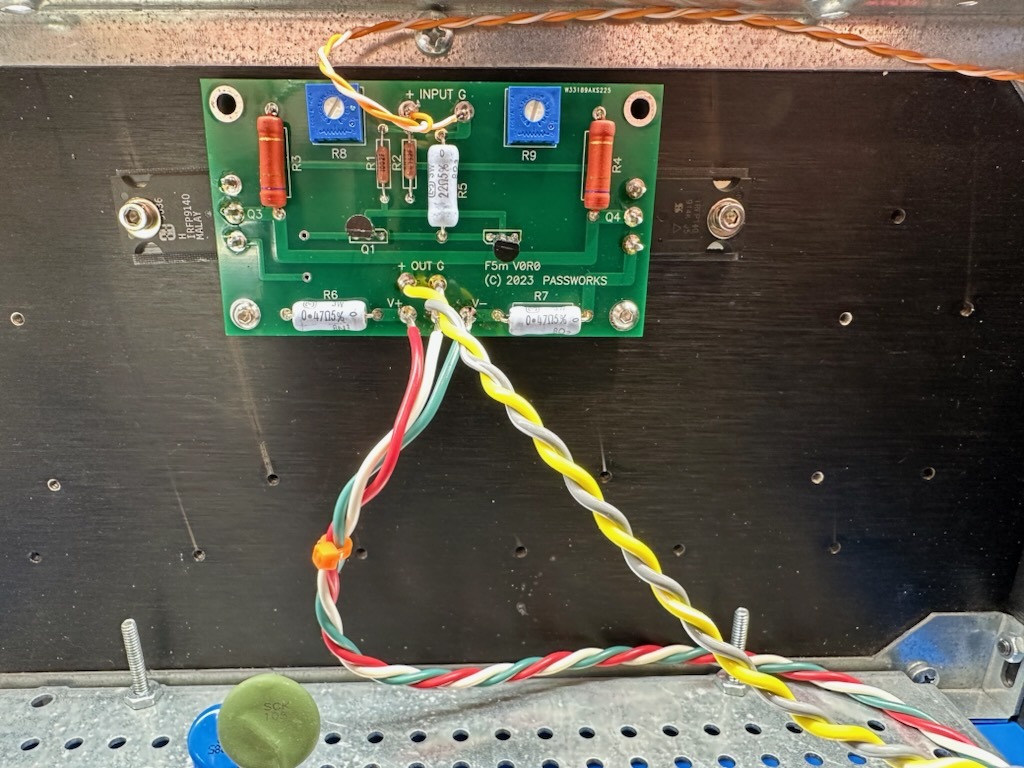

Not-quite-the-build-guide configuration, but pretty close. This isn't the final PSU board, (there was a rev needed) and I need to re-code the wiring colors instead of use what I can dig out of my drawers, get everything squared up and dressed a little prettier.
It works great and sounds beguiling, this is going to be a popular build.
(And for those interested, it's an Omega bracket from Toroid of Maryland. https://toroid.com/omega-bracket-vertical-mount/ )
[Edited] I'm very interested to understand why only one secondary is rectified. I'm probably the only one scratching my head as I'm still pretty much a noob here......(edit) hand to face...center tapped per article.
Nice 6L6!
Especially the trafo bracket 😉

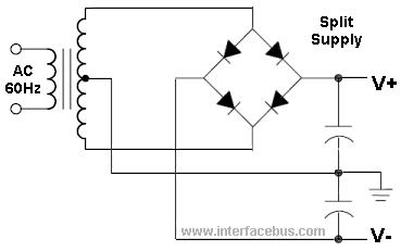

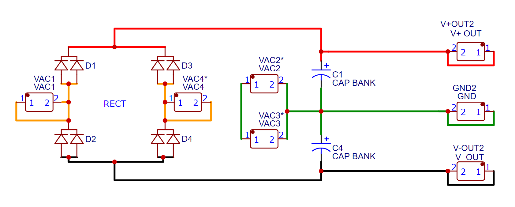

It’s not one secondary, the dual secondaries are configured as full wave bridge Center Tap. You only need one rectifier block.
Nelson talks about it in the F5m article and I’ll make sure to cover it in the guide.
I believe this is what is going on (very simplified version) Only instead of discrete diodes, it is a bridge rectifier. Another awesome way of simplifying an already super simple design. This does bring the question, why did the DIYaudio power supply boards in the store opt to use 8 diodes as opposed to 4 on the diode section? Is there a performance advantage.center tapped per article.
With the center tap at ground, you only need one bridge to get a bipolar (+/-) supply.
You could use one bridge per secondary of course, this has the advantage of being simple and inexpensive.
