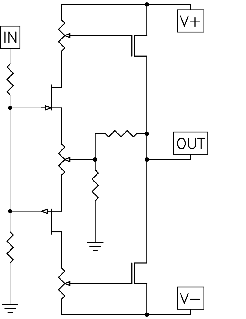

This corresponds roughly to my own impressions. The F5m input stage has more push-pull square law cancellationThe 5m sounds better. The pace is more relaxed. It's more forgiving as-well. I think the og F5 has maybe a little more bass control.
and operates with a higher impedance feedback network. Less feedback, less damping, more 2nd harmonic,
less nervous energy...
Just the sound for me at my advanced age....
Damn! I guessed right!This corresponds roughly to my own impressions. The F5m input stage has more push-pull square law cancellation

The F5m input stage has more push-pull square law cancellation and operates with a higher impedance feedback network. Less feedback, less damping, more 2nd harmonic,
Like the original Selectronics ProFet.

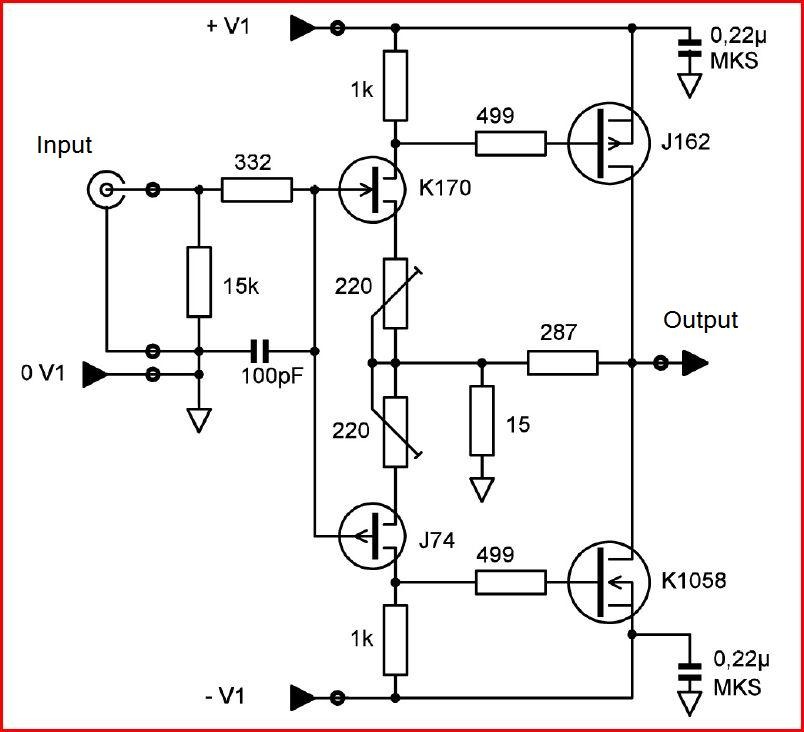

Without any source degeneration of the JFETs
Only possible with VFETs, not with laterals.
Else too little gain for the frontend.
Patrick
Me too.
The laterals used in the ProFet don't need source resistors.
Their Vgs is much lower at around 1V.
If you run the JFETs at Idss, the drain resistor is only about 130R.
That will only give a gain of ~4.
VFET + Resource will be about 5V.
Factor of 5 more gain.
Patrick
