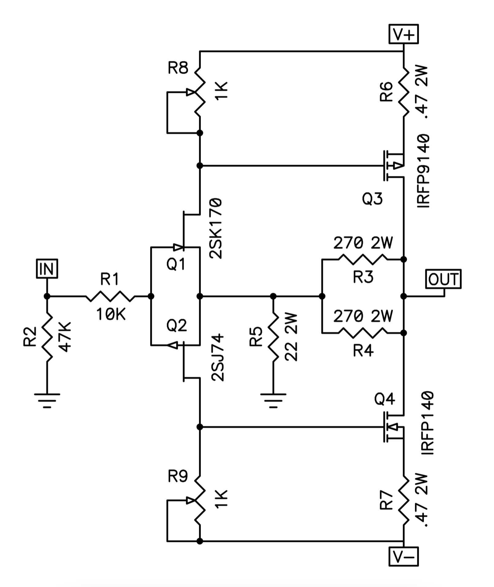

I have a technical question following Gary s question about the harmonic content.
Since the only ajustements on the F5m is R8 and R9, which ajust the bias and he offset at the same time, how is the harmonic content controlled/defined without something like the trimpot between the jfets of the original F5. Is it with the matching or slight mismatching of the front end jfets? With the output devices choice?

It is significant that the F5m uses IRFP140 and 9140 Mosfets rather than the 240 versions of the original F5. It is also of note that the IRFP9140 in the F5m kit are Harris manufacture, as supplied by Pa, rather than the current production Vishay. That will be one sonic signature to try.
There are other N-type and P-type pairings that might be worth trying as well. I may have a go at those, just because. But Pa's signature is to be found in the kit.

He basically sums it up on the first page in the F5m PDF
"There are a couple performance differences between the F5 and the F5m, one being that I have
allowed some negative phase 2nd harmonic into the sonic signature which has tended to be
popular in FW amplifiers, a little more gain and variations in the output stage bias current
depending on the supply voltage and heat sink size. The larger the heat sink, the higher the
bias current and the lower the distortion."
