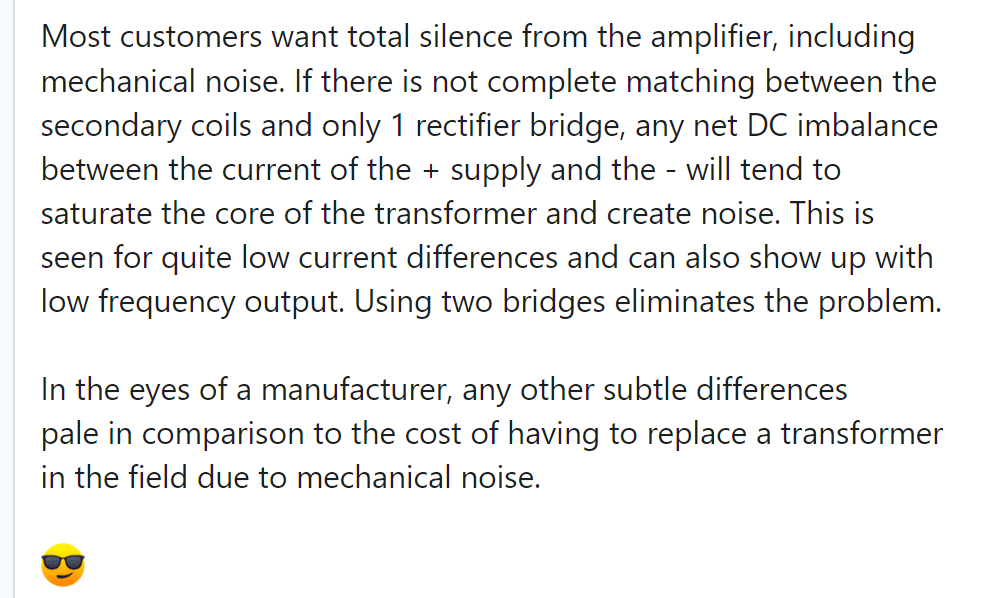

Is there a performance advantage.
Papa gave a practical reason here (post #143):

Little to none. The build guide will be using an AS-3220, for what it’s worth….Curious what if any sonic advantage one might hear using the 300 va vs 200 va transformers?
