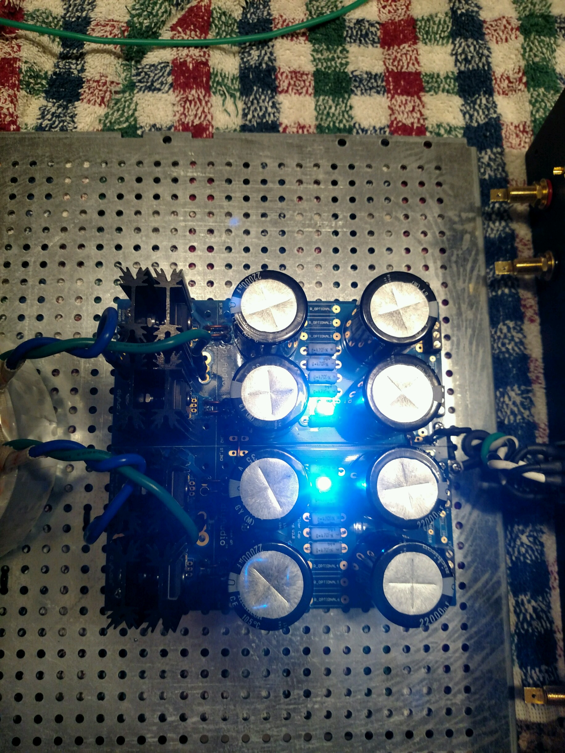

Does the ground coming from the IEC to star ground need to be a twisted pair?
Anyway, my plan is to have it completely wired up and ready to get dialed in this weekend.
Got to put together a light bulb tester too, damn, these AMP builds are as arduous as a speaker build
F5 BUILD
pic didn't stick.
