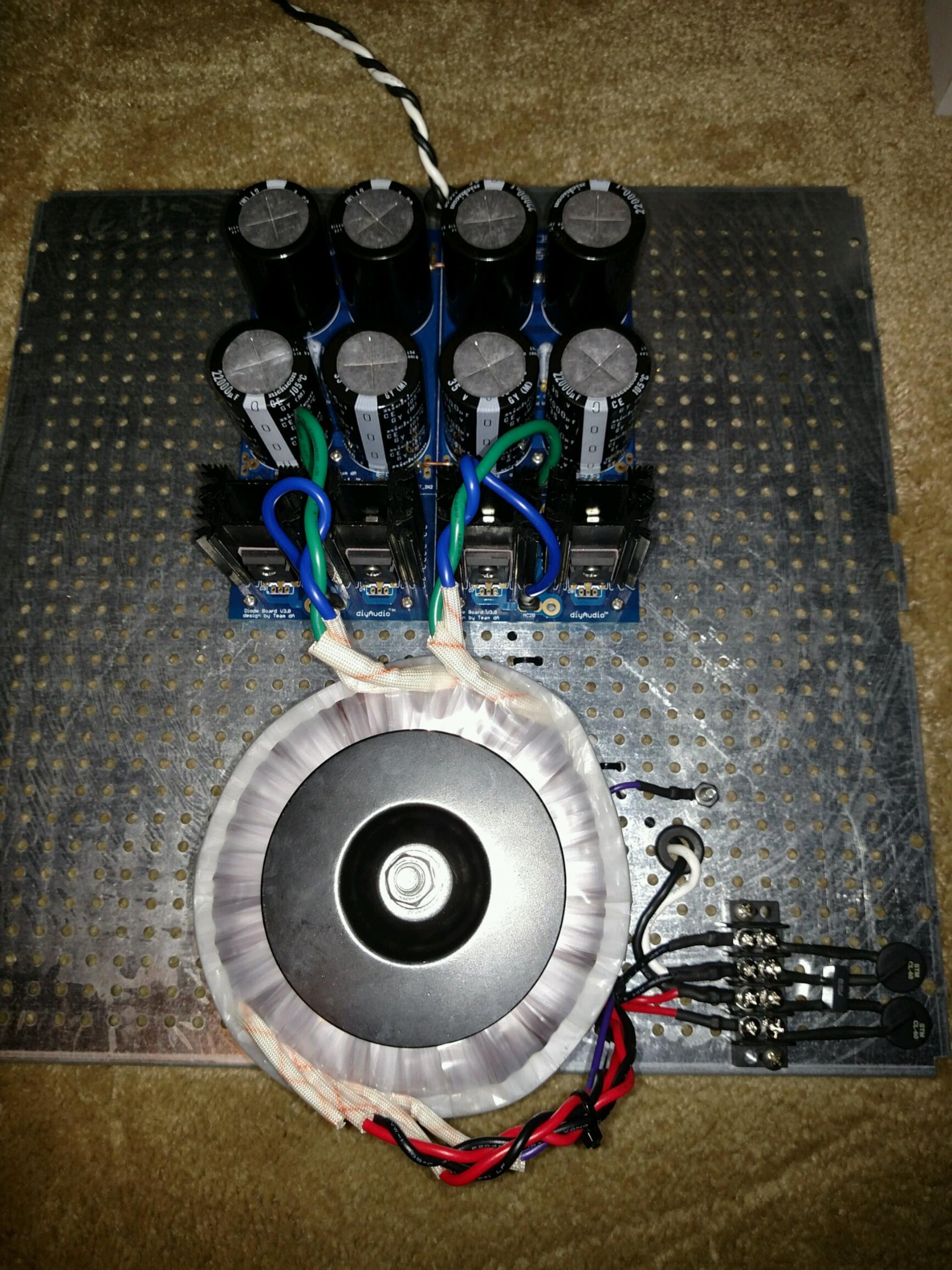

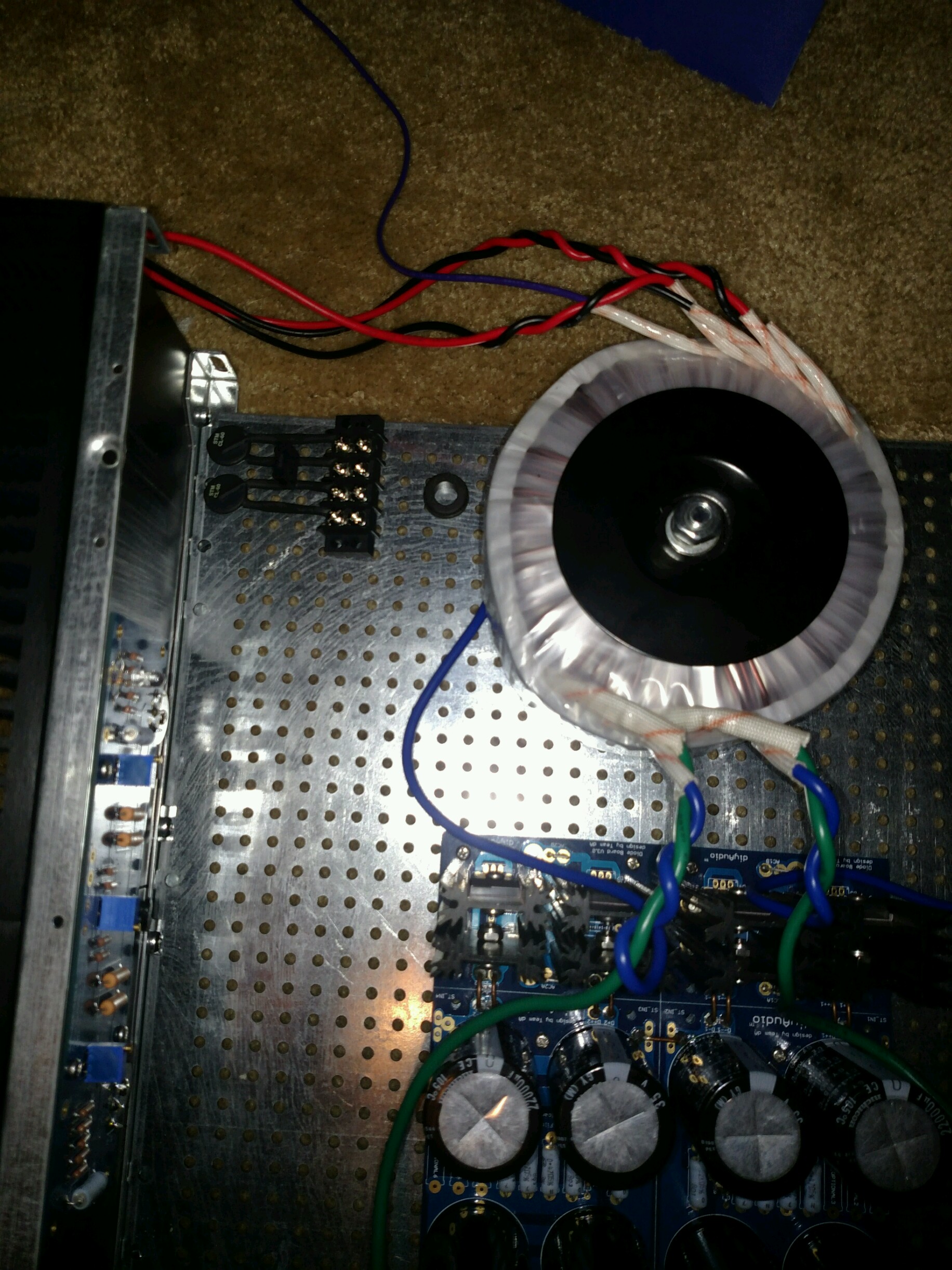

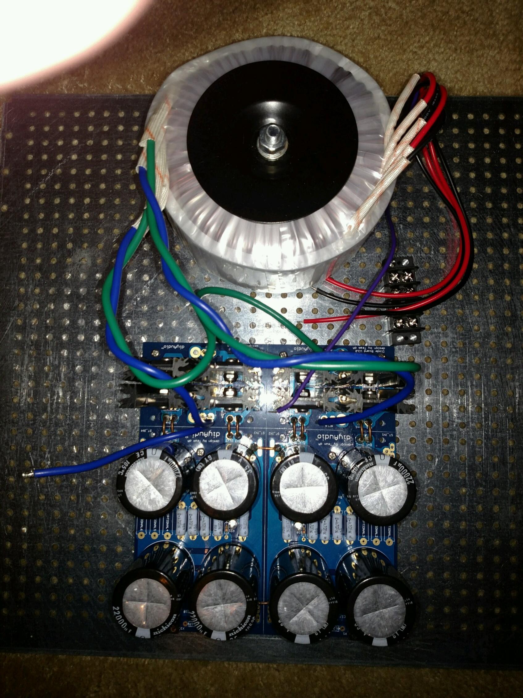

My plan is to drop the 120 input from the back of the IEC down under the mounting plate, under the PSU and then bring it up between the doughnut and PSU over to the terminal block.

rotate the Donut so secondaries are ditto to pcb , shorten sec. wires that much so you can rotate Donut later for 30deg left or right , if needed
I usually don't need to chase humbucking position , if everything is done correctly
move primary connection block near front edge of base plate (left or right side of Donut), to keep those primary wires short as possible

Regardless of your purist instincts (a compliment—takes one to know one)—I found it super helpful to run all the power wires (V+, GND, V-) either straight up off the boards and then towards the back of the case, or I've seen them run in from the back of the PCB, provided I suppose that you have enough room with your standoffs.
Just a thought. I got to redo 1/2 my F5 wiring trying to sort out hum/buzz—and when I redid the power wires across the top I didn't run them perpendicular to the PCB and out towards the middle of the chassis the second time. Made getting in there for biasing much easier.

Pfarrell: in the photo in your post #92, it appears there is a red and a black wire running close to your inrush CL60’s, maybe too close?
The in, to the terminal block from the IEC?
It’s per 6L6 spec.
Also that was my old needed to be ZenModed super loud wiring layout.
The new layout is almost blackness in comparison. Block is at the front, power under the chassis and more.
Oh, the ground wire for the Antek.
I have read somewhere in the past to keep this"short as possible".
Will it be ok to drop this back with the AC in and back to star ground?
Will have to splice it and lengthen it to do so if I have my star ground toward the back of the PSU.
From the Aleph thread-->post #2698:
Aleph J illustrated build guide
But the Boyz like to keep them short and grounded as close as possible.
I mounted my F5 transformer vertically. Aleph J transfo I mounted flat, and was able to rotate it "live" to attenuate the buzz in the speakers... cut it in half with optimal position... So leave some slack in the shielding wire when you cut it. ZM said up to 30 degrees in either direction.

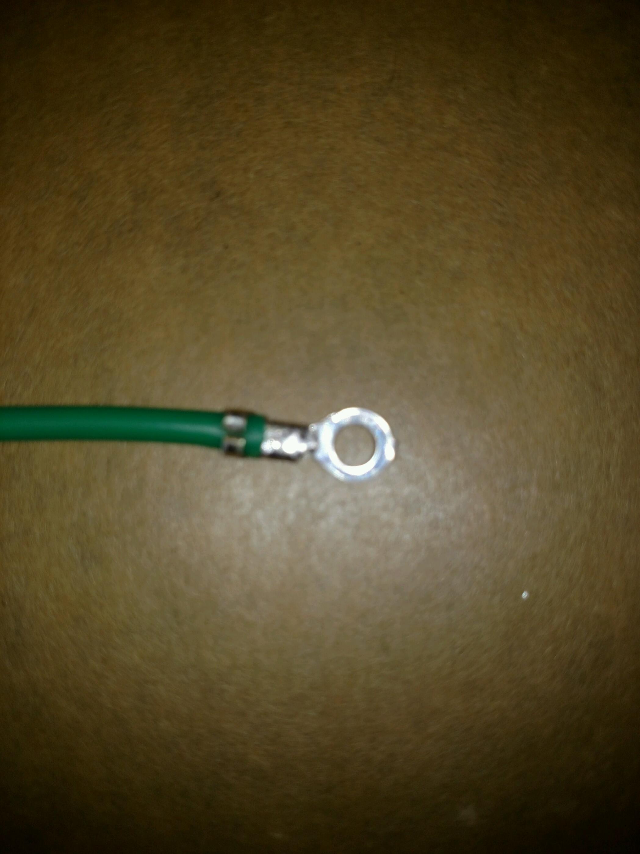

Lowes, home depot, ace and menards all have crimp terminals, a frequent time saver in my world.
I think I get blue and yellow crimp terminals every time I’m at Home Depot. IIRC, Home Depot has the female bulk packs while Lowe’s has the male / female combo packs. Menard’s didn’t have what I wanted when i checked.
I once ordered a bulk pack on amazon but they were cheap junk. The metal was too thin, and it didn’t bite and hold on the wire. Plastic was garbage.
