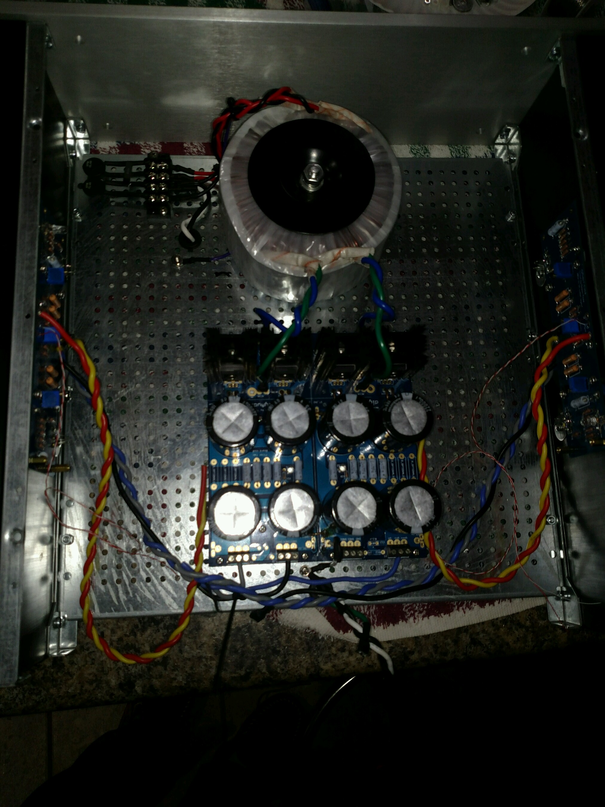

Just read through this whole thread and Flamethrowers journey (Any updates?).. I'm about to embark as well. I've got most of the parts on order. I'm looking forward to it. Previously, I've built the ACA and a ST-120 from Tubes4Hifi. (tubes4hifi amplifier KITs page)

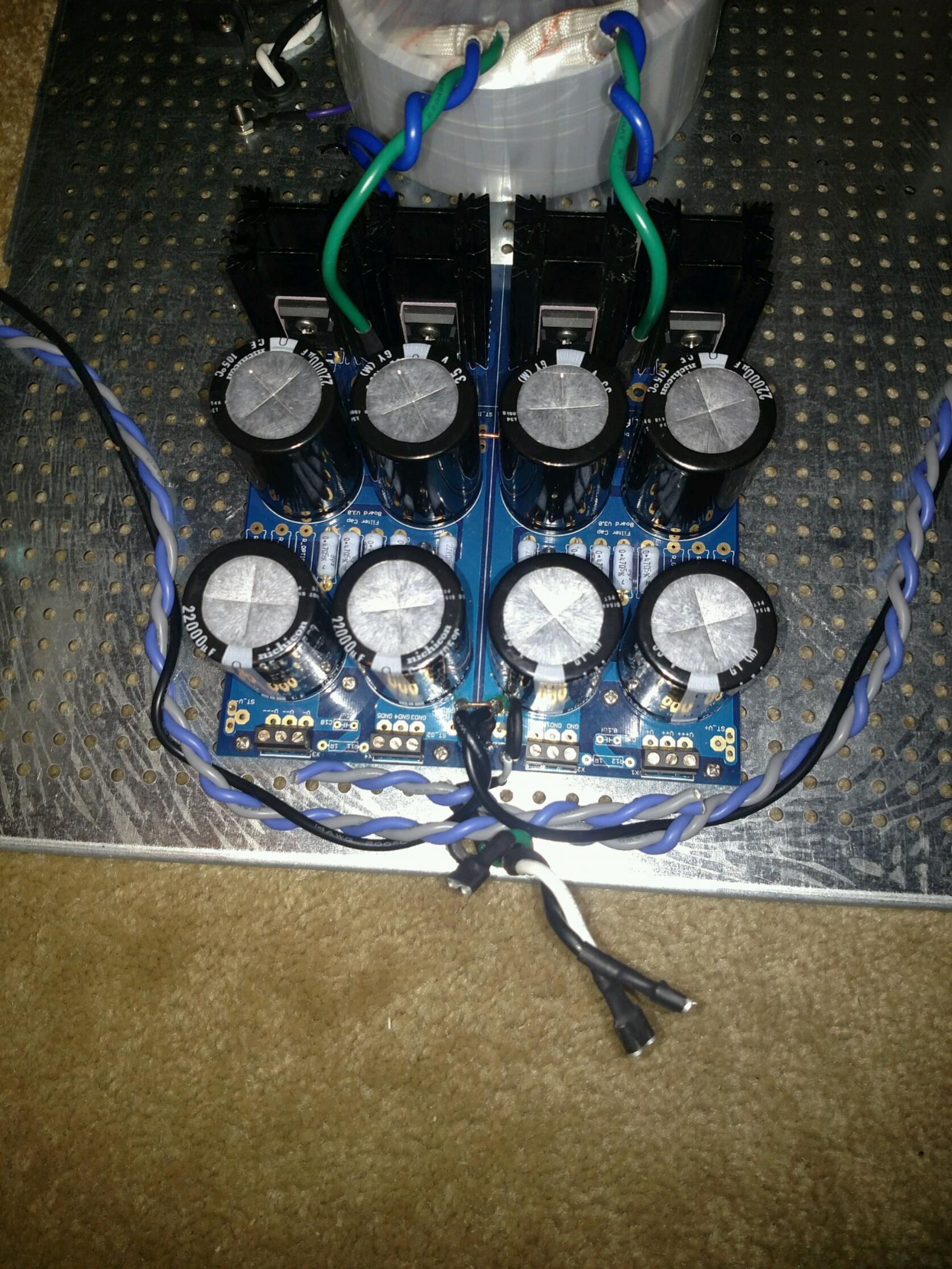

I think I'm going to return my 18,000uF caps and get 22,000uF. I have cap envy.
Also I missed that the 4U deluxe is only 300mm deep and the 5U is 400mm.. Might have gone with the 5U if I realized.
Is there really no difference (other than cost) between using the diode section on the universal power supply or a monolithic bridge? The heat sinks alone are more than the monolithic piece.
What's a good way of deciding which transformer to buy? The 400VA antek seems like the one to pick, but just curious what kind of math I could do to come to that conclusion on my own.
Thanks!
-Jesse

I am building mine with a 3U chassis 400mm deep, I would go for the deeper depth which ever chassis you use.
Just my mileage I guess
This is a great plan—I stole this idea from flamethrower after doing the math (more sink than shallow 4U) —idea originating from AudioSan back in post #80, and blessed by 6L6 (for AJ). My AJ def runs cooler than some as far as I understand—and I got to drill and tap some holes. My F5 I built in the 4U x 300mm with an L bracket for the transformer—it was nice to have the mounting spec pre-drilled sinks on my first build... there was enough going on, but the L bracket was required if using the DIY stores diode bridge and leaving all the PSU boards attached....

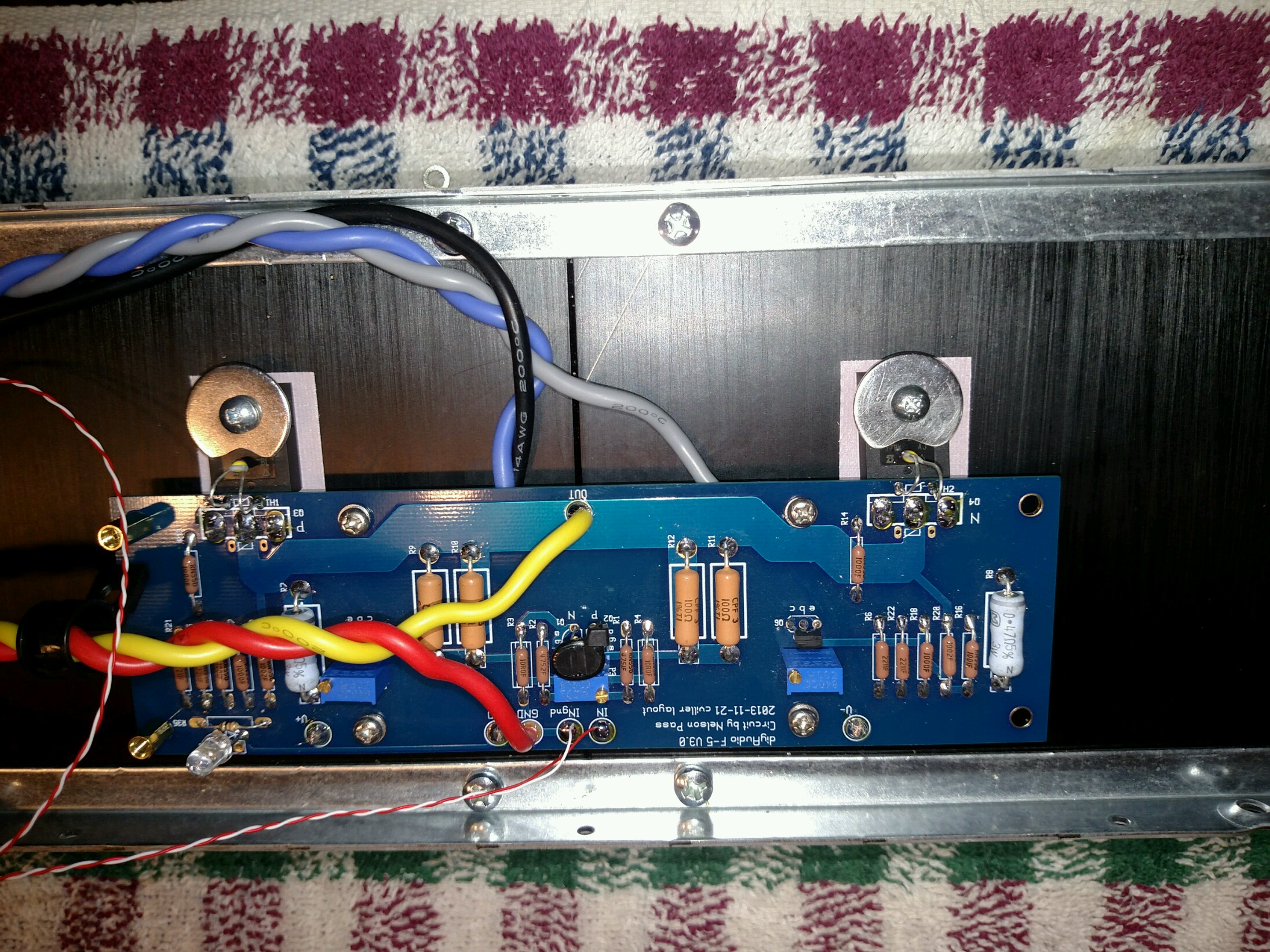

Has anyone built the 50 watt version of the F5 (non-turbo)? He's saying it's possible, right?
"Increasing the power supply voltage is the obvious way to get more power out
of an F5. You can simply raise the supply rails to +/-32 Volts and get 50
watts into 8 ohms right away without other modification. 24 V AC secondaries
on the power transformer will do it. Don't forget to use higher voltage power
supply capacitors. Probably you should also upgrade R9 through R12 to 5
watt resistors. Depending on your heat sinking, you will probably want to
adjust the bias so that the power transistors don't run too hot."
