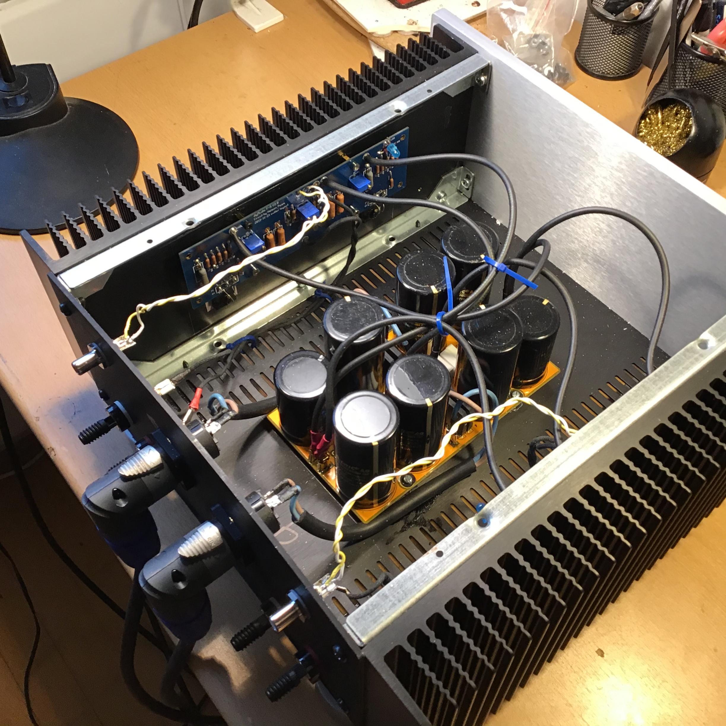

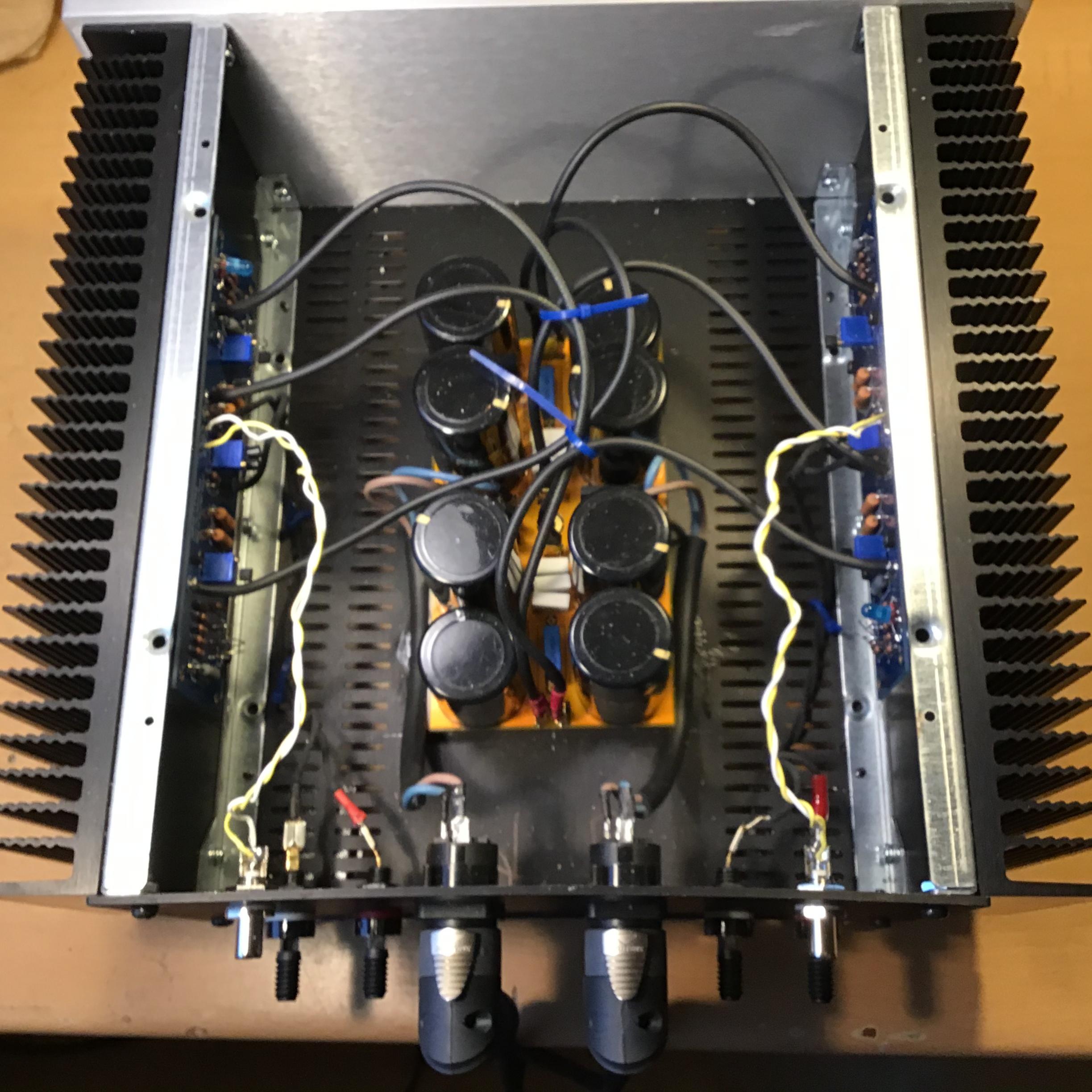

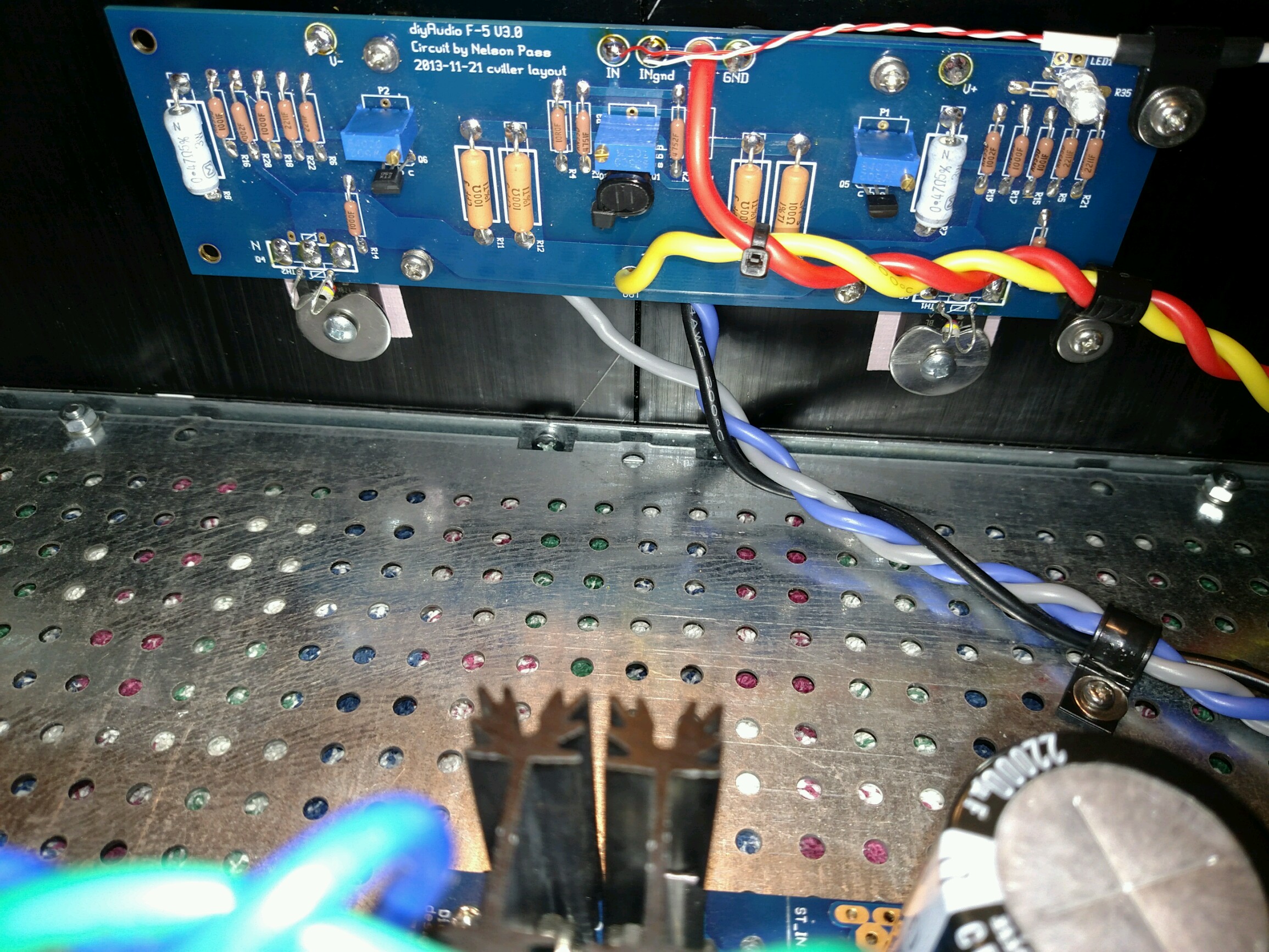

Had a little set back tonight.
A little too much much bending action on those wee little input wires on one board.
I thought I was being very conscious about it too.
Anyway, I was fortunate enough to wick the joints and re-solder it in place, holly sucker balls, did I get lucky.
Anyway, this is what I have created.

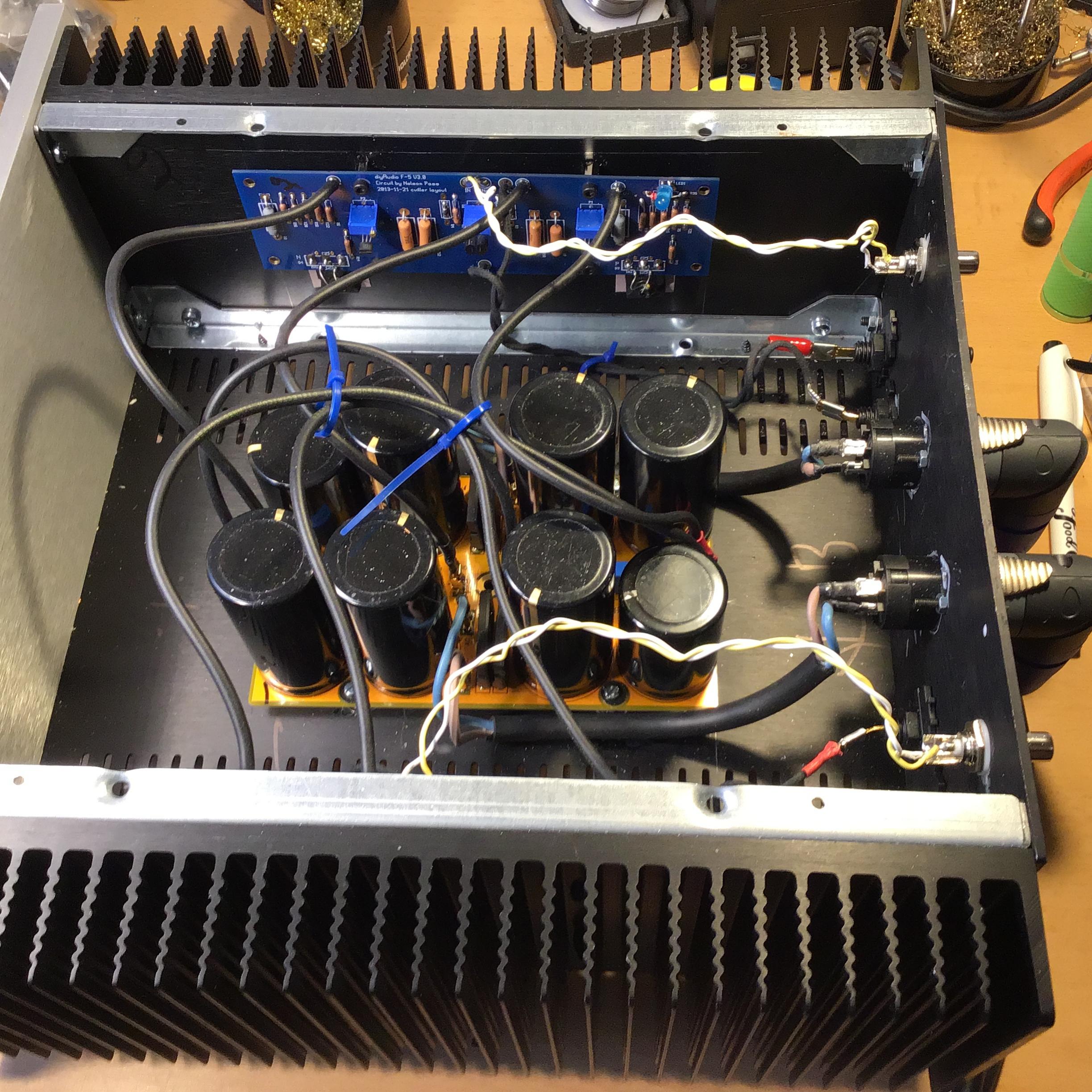

are you using a light bulb? do you have fast blow fuses? what max amperage are they?
if yes to all , you have a short (most likely to ground) somewhere
a simple approach would be to disconnect the power supply from the amp boards
1. test the psu - if it works
2. connect one channel at a time and test
- make sure that neither the positive nor negative rails are continuous with ground before you start.

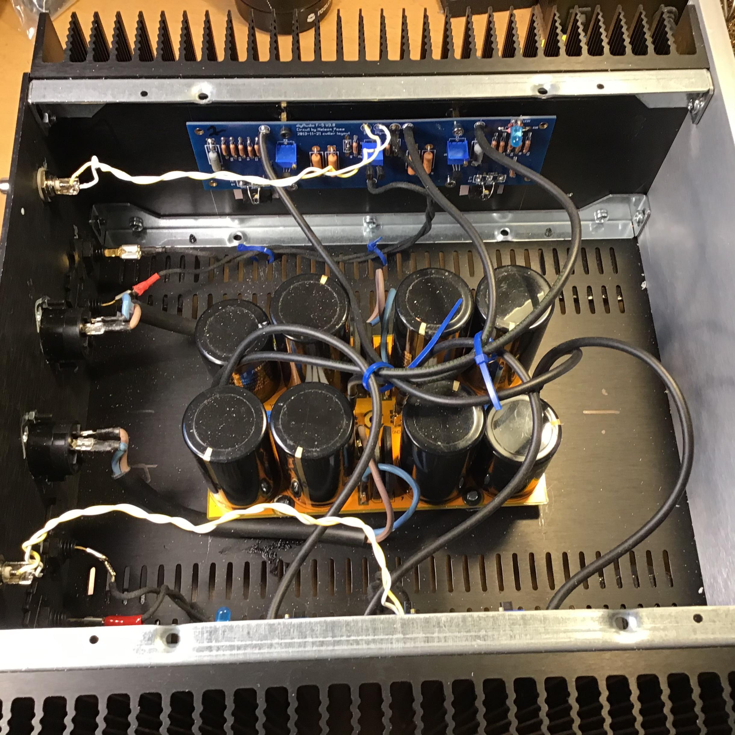

Hi bBel. Thanks for your feed back. I also suspect the power supply, as both channels do exactly the same - no LEDs light up and all 4 x 0.47R/3w resistors get hot and emit smoke plus the 3amp slow fuse blows. But I did measure the power supply before hooking things up. I have to measure it gain. Funny, my builds normally work.
If the resistors are getting hot you have lots of current going somewhere, so let’s take a look and see what we can see.
Please post well-lit, in-focus photos and many members with sharp eyes can look for what needs to be changed. 🙂
Counterclockwise may be full on. With the power off you need to measure resistance across R5 and turn P1 so that resistance is zero or as low as you can get it, and then do the same with R6 and P2. That is the only way you can guarantee the bias to be set to zero at power up. 🙂
Also, only have one amplifier PCB connected at a time when testing the amplifier. Any fatal mistakes will only ruin one side instead of both.

Here are pictures of my build. I will check the pots later today. Thanks all.
