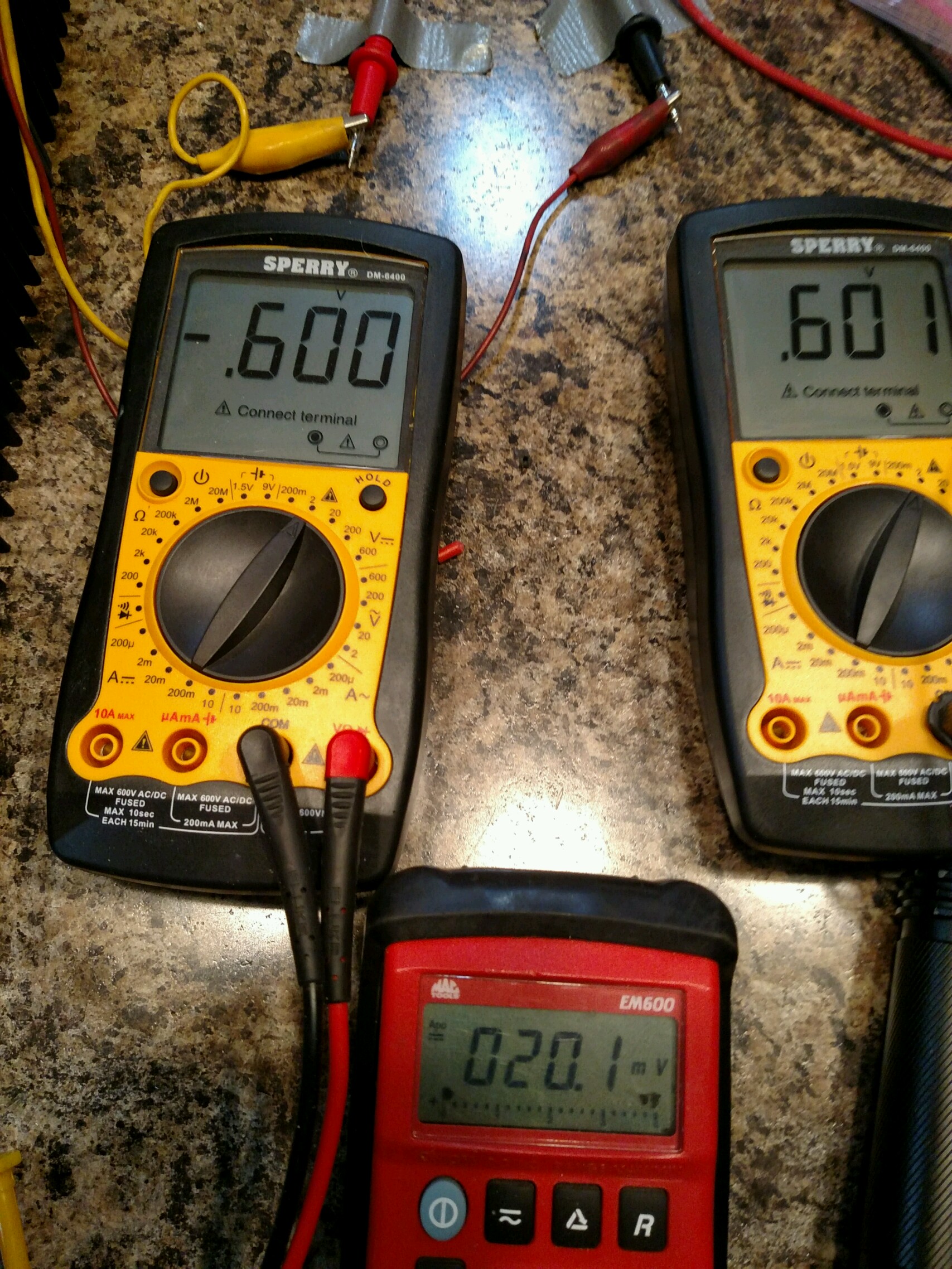

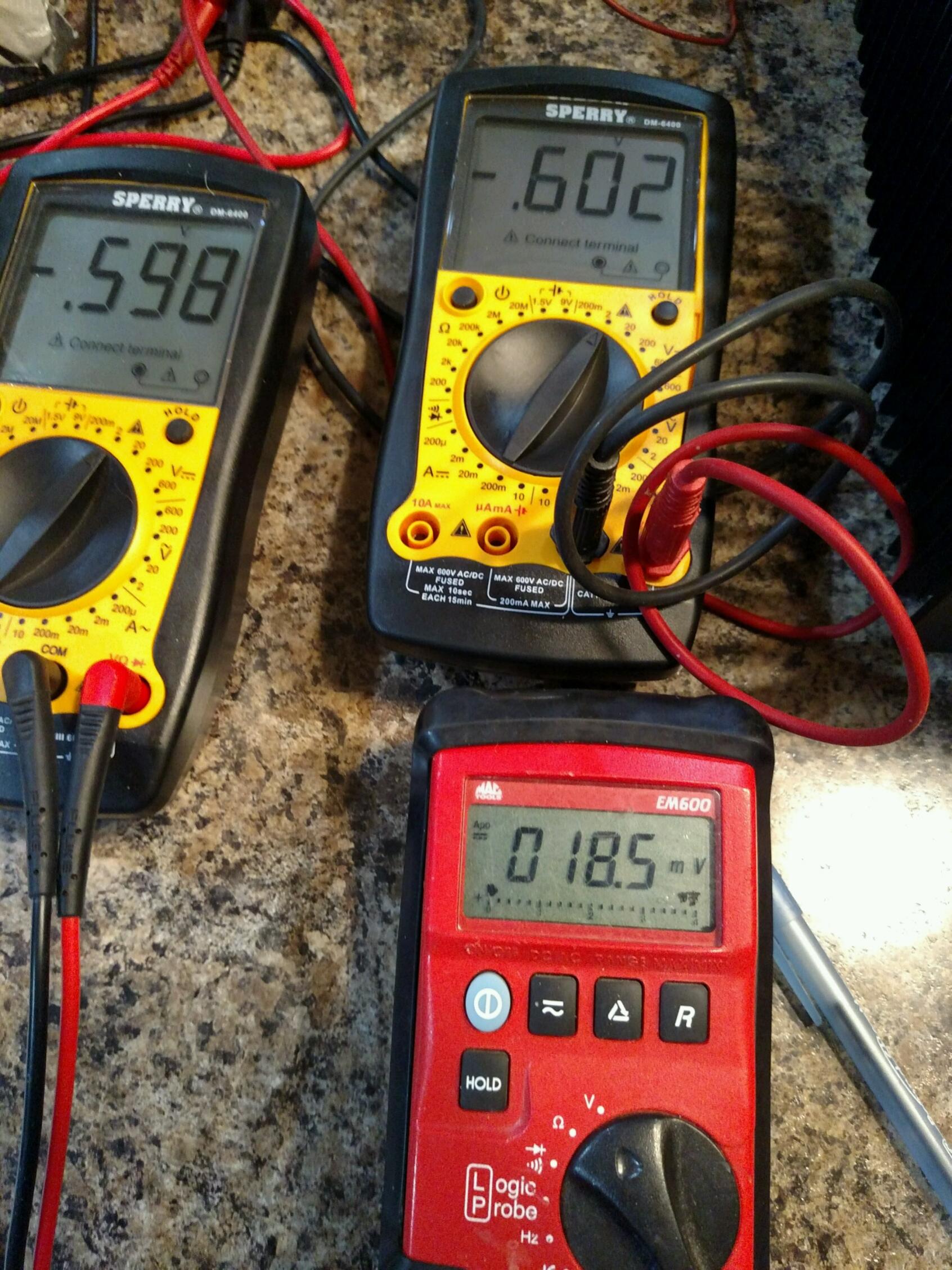

Ok, first let me express my extreme gratitude to 6L6 for going far beyond what I have ever imagined anybody would do in my situation.
Hats off to you sir and I owe you a cold one at least, thank you.
Also thanks to the other forum members as well, your help and input is explanatory.
So, the adjustments went good, at least for a first timer.
Pics show the DMMs on both channels.
The one thing that I found though was, you could adjust the pots and within 15 seconds or so of putting the top on, the readings over the resistors would drop to a lower value.
In other words, to get in the .60v range I would have to adjust the pots to .608 or so with the lid off.
Anybody else experience this?
My first thought was that maybe it was steel, I ordered all aluminum and it sure feels like it is aluminum, HMM.
One last check with the two channels hooked up and I am hopefully good to go

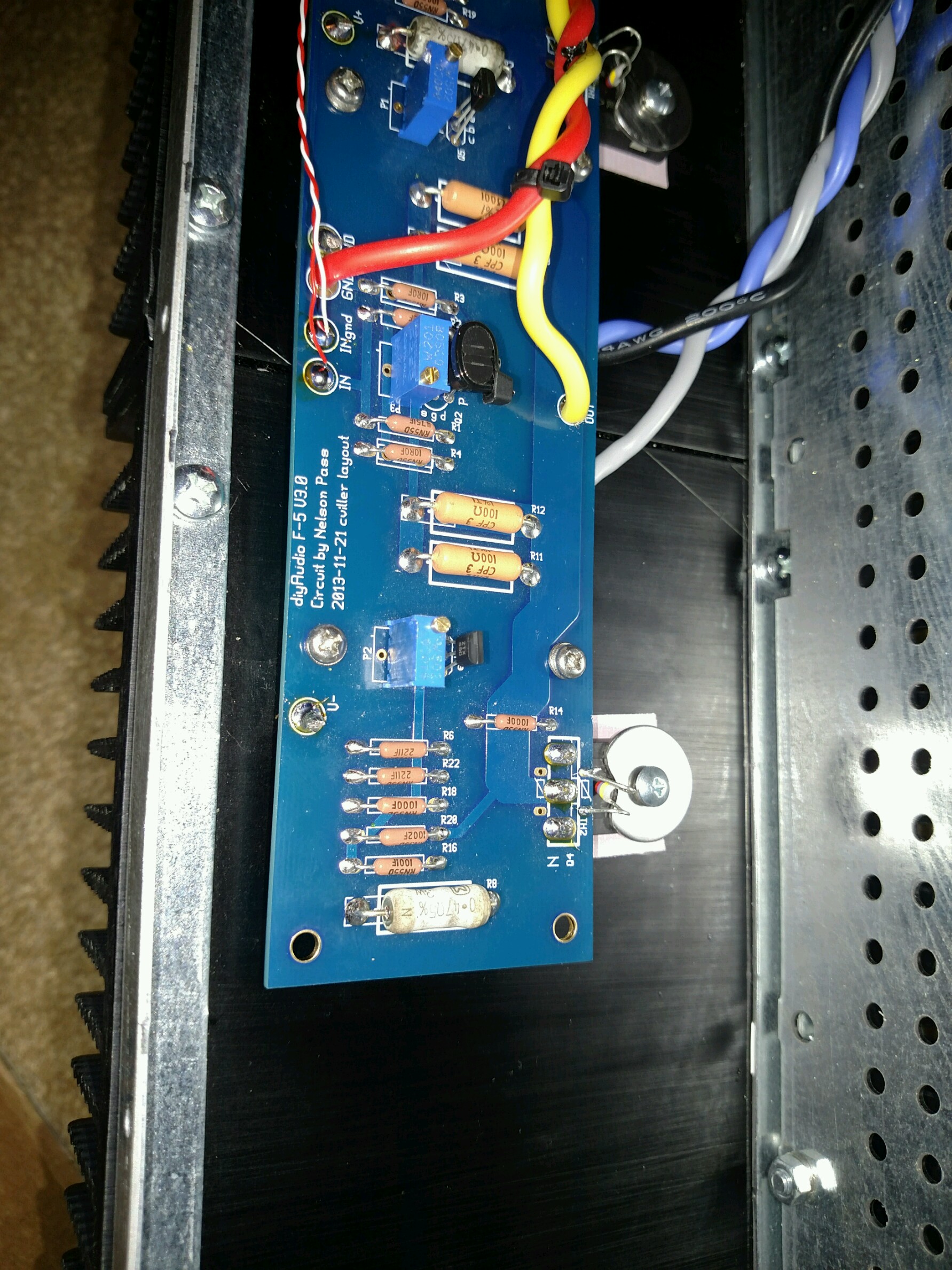

Unfortunately being the fricken OCD person I am I decided to re zero one side and see if I could get it closer and smoked a board, NICE.

Ouch! You actually got the magic smoke out? That hurts. 🙁
At this point, best to just take a break before resuming. Check for parts damage.
If you saw smoke then possibly the output mosfets and some resistors are toast. 🙁
Good thing is that mostly likely the jfets are fine.
Chill a bit...then please take pictures and post.

Yep those resistors look like they need to be replaced. Others far more skilled than I will certainly chime in with recommendations of proper test procedures to check other parts.

Hello flamethrower,
what a sh.t! i can't believe it. Because the numbers I see on the pic with the
DMMs were good.
So you had something around 0,6 V = 600mV over the bias resistors and an
offset at the louspeaker of ca. 18 mV. Those numbers are good.
Did the MOSFETs become extremely hot?
Bias resistors are 3W types? Better 5W?

You may have shorted either side of either resistor (the one you touched with probes to measure the quiescent current) to the ground... with a bit of luck, all you'll need to do is to replace the .47 / 3W resistors and the MOSFETs.
... also, you may have exposed the ZTX's to a high Vbe; so check those as well.
Your wires are soldered onto the PCB from the underside.... they are quite thick and require a lot of heat to solder properly -> this may have burnt the insulation and exposed the wires (underneath)... and they may have touched the heatsink...
Good luck man... keep us posted...
Could be the thermistor short to the washer on the top of the mosfet?

Edited to add - @Flamethrower - I have no idea if the thermistor failing and thus shorting could be a potential cause, but there have been a number of conversations around whether the thermistor should touch the package or the washer in such an event. I believe, but cannot be certain, that it's been recommended that the thermistors make contact with the device package itself. If I can find the post (I believe the one I read was from Zen Mod), then I will certainly re-post.
