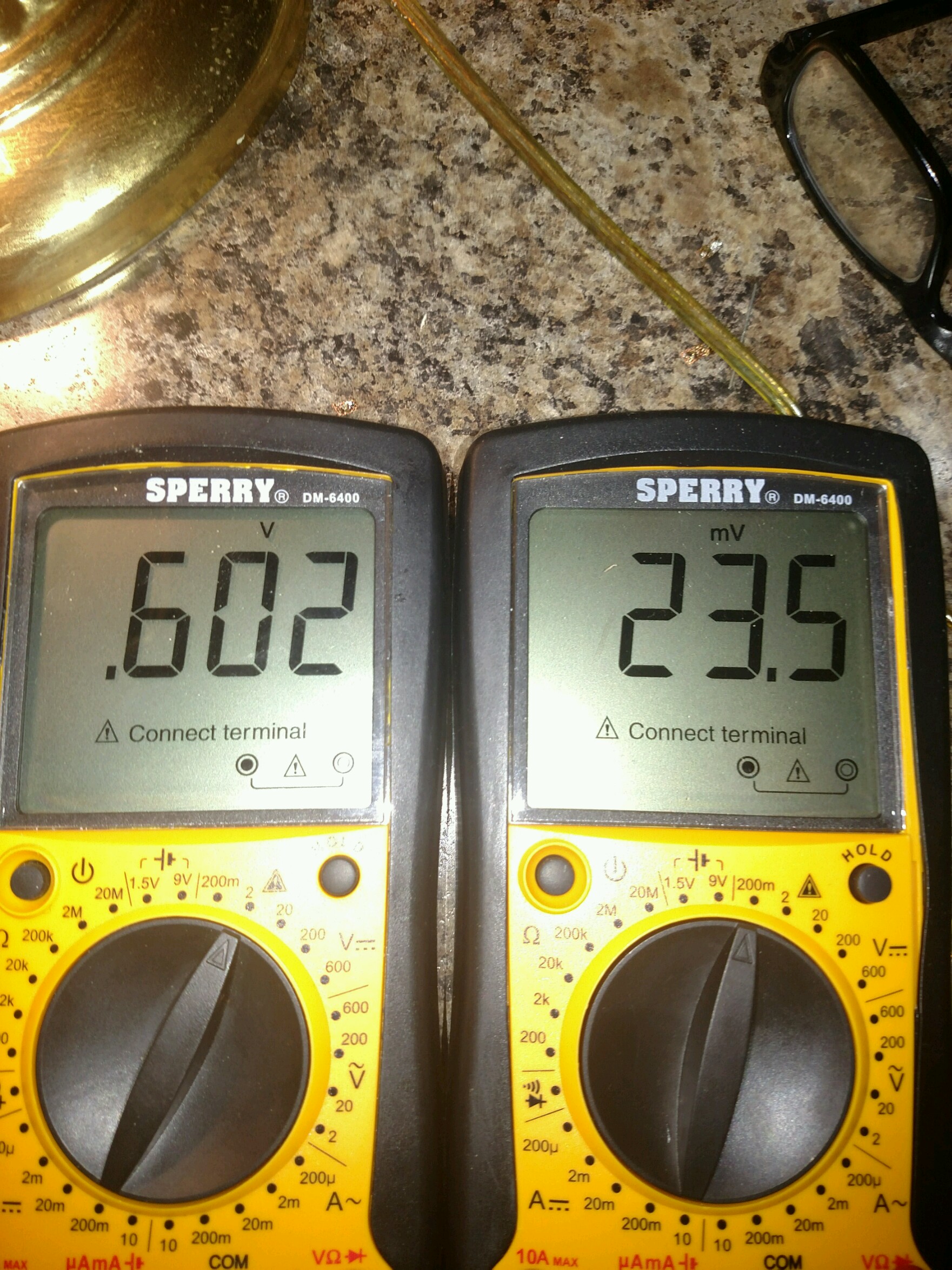

I got back to this project today after a much needed "cooling off" period.
After evaluating the situation, I went with 6L6 instructions to change the resistors.
I was actually able to stand the amp on one side and replace them without removing the boards.
So the pic are my results after maybe 30 minutes in.
It has been cooking for an hour now and is now .606/.607 and 24/25 mV.
Is that acceptable?
And how important is it to get them exact from channel to channel.
I am new at this so, be easy on me.
Anyway, things are behaving as they should so, hopefully I got really lucky and all is good.
Thanks for your help and support

Flamethrower - your values are about as good as can possibly be had. There will always be a little difference between the PNP and NPN sides of the circuits, and achieving zero offset is impossible, particularly when there is a signal. As suggested, go back and see if they’ve drifted in a day or two and if not, close it up, listen to your awesome amp and don’t touch for many years. 🙂
Tooppy - increase value of resistors R5 R6 to 4.7k (change resistors or add resistors in series) and re-bias. You will get the full .6v drop across the source resistors. This is a very common change to get the amp to bias properly.

@Flamethrower: Congratulations! Enjoy your amp.
@Toopy: That's usaully just a combination of jfet with Idss on the low side, mosfet with Vgs on the higher end. What 6L6 suggests will solve it. Remember to zero out the P1 and P2 before you power up after changing the resistsors. You can do that by adjusting P1 and P2 so that the measured resistance across R5 and R6 are low (say, no more than a few ohms)
