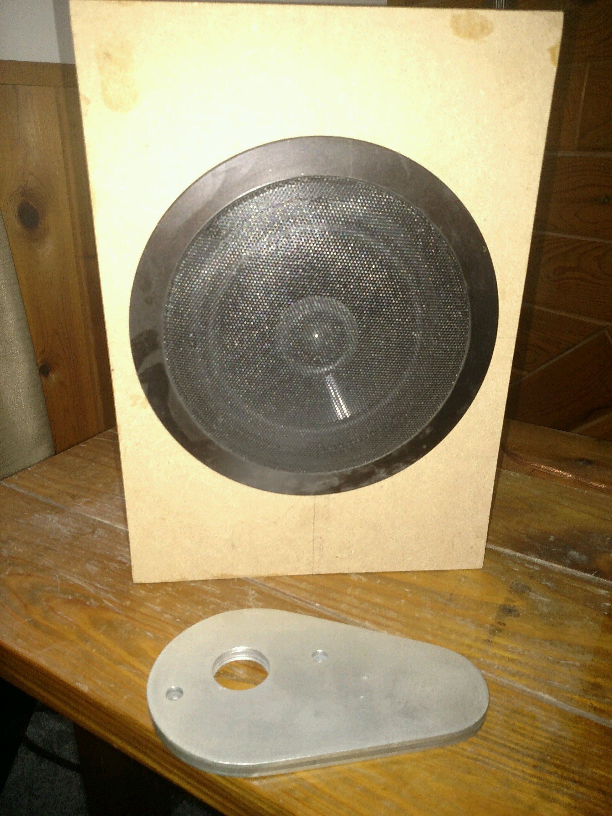

I got to sit down and listen to my amp for a little over 3 hours last night.
Quite a range of music genre Rittenour, SRV, Sade, Rikie Lee Jones, Robin Trower and Pink Floyd.
All through some speakers (in ceiling that I got for free when I bought a tv).
I had them laying around and decided to put them in some boxes for my wood shop.
(They didn't make the grade and were replaced by another set from a kit from Meniscus.)
So when I hooked them up I thought it would sound, well, bad.
I have heard far worse, I was amazed that they sounded as good as they did.
Plenty of bass, voices and instruments were clear although a little lacking in the high end but that is the speaker I think.
With what I heard from essentially a single driver speaker, I ordered a pair of Mark Audio 12p drivers.
Now I am all nervous about the speaker protection thing.
I just hope taking Zen Mods advice on keeping the NTC"s not touching the washers keeps me safe

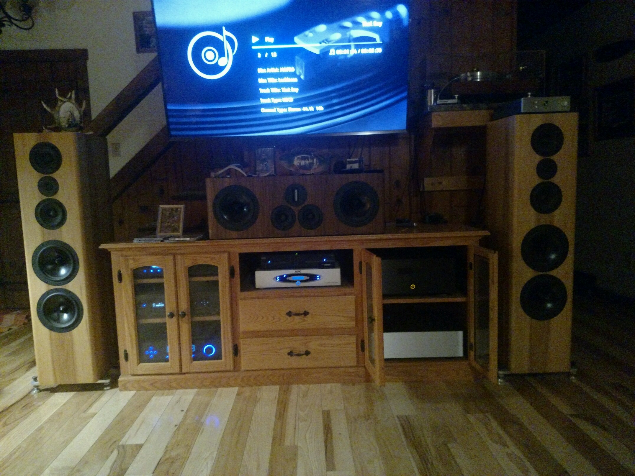

F5 BUILD
Managed to plug the F5 into my main system.
I know it is not optimal and will eventually be in its own system.
I have obviously spent a lot of time and money going the wrong way.
The sound is very clear, the instruments well defined, just a great sounding amp.
The amp itself is absolutely dead silent between tracks.
I am glad I ventured down this road as it was well out of my "comfort zone".
Thanks to all who have helped
What amazes me is I actually built it
Thanks guys

Nice looking setup!
Not optimal as being in a cabinet, although it does not get as hot as I thought it would.
Could still hold my hand on the heat sinks after a couple of hours of listening to music.
"Wrong way" meaning other than class A amps.
It sits where an XPA2 was and I could very easily live with it.
