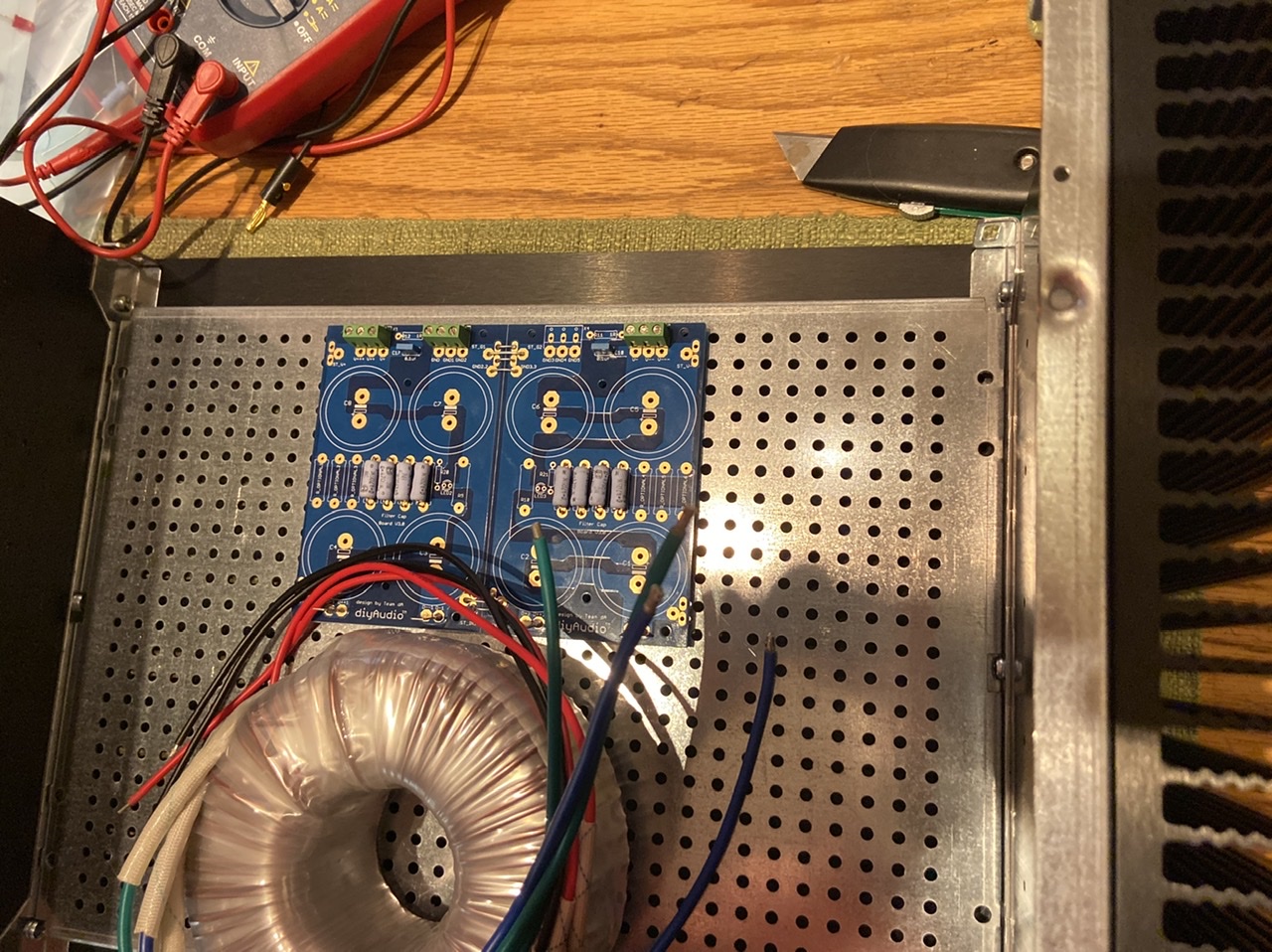

Spacing
Does this spacing look okay? I got the antek 500VA 18v which is a little bigger than the 400VA.. so things are a lil tight. As long as there are a few centimeters between the front faceplate and the transformer it should be okay?

Merry Christmas @jan492 -
re: Input snubbers and monolithic bridges - I wouldn't worry about it, but others may have differing opinions.
22k is fine for the bleeders
R20 and R21 - You can calculate the value to dial in your perfect brightness, or you can toss in something around 10k and rock on.
Spacing looks fine. If you like it better - some put the donuts under a mezzanine plate with the PSU on top or mount the donut vertically. If you mount your PSU board on some standoffs, you'll have a bit more room to tuck a portion of the donut under if you like. I think I've even seen some PSUs on the front plate. Lots of options to free up real estate depending on how you like it.

You could mount the transformer vertically -

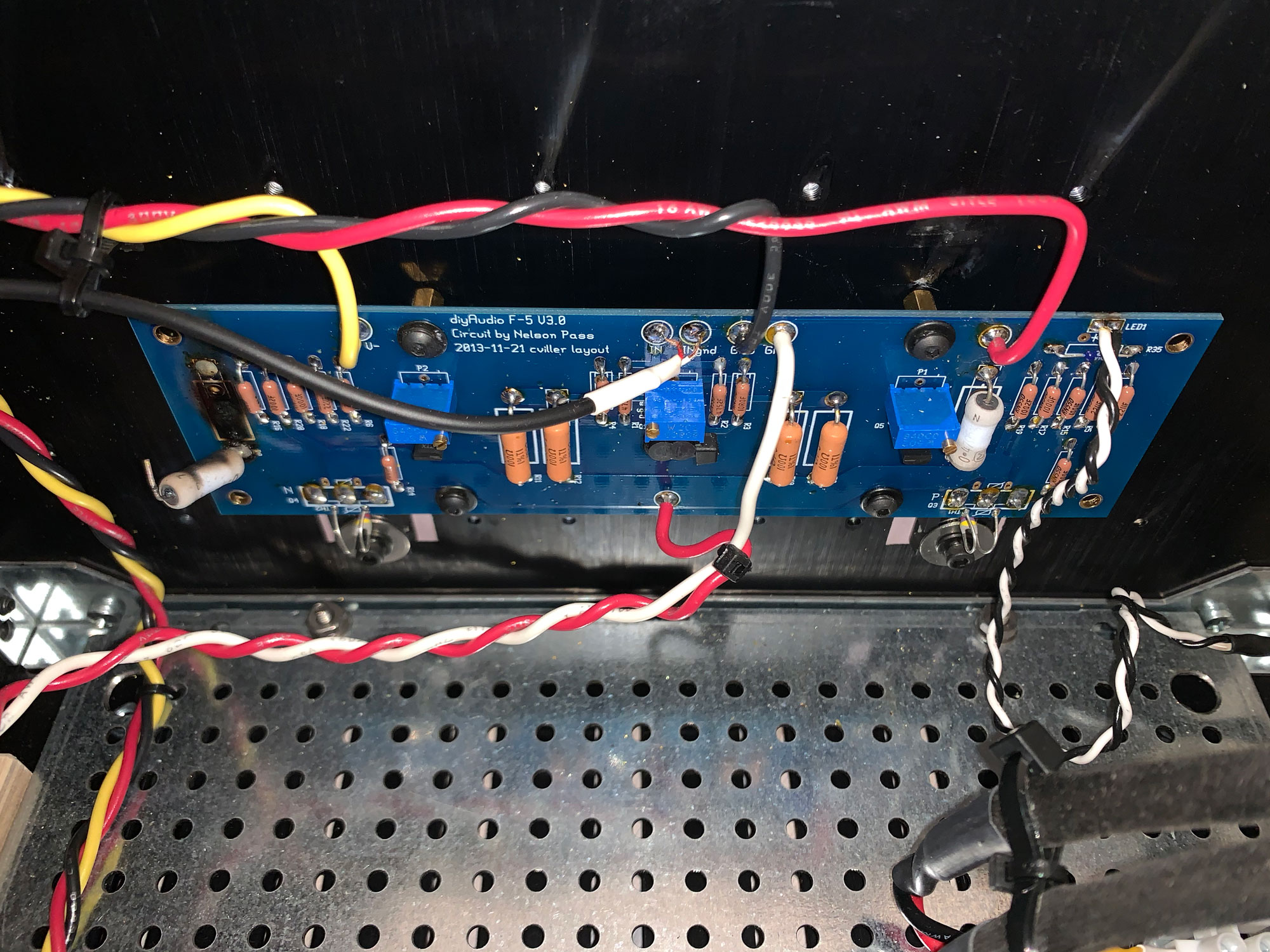

Fired (fried?) up the F5 today to try with Wayne's pre.... Haven't really listened to it properly since I built the AJ... But I've had it in the system a few times since then as I made mods to AJ...
Hmmmm..... Worked awesome last time I used it... I think I read someplace that someone else had a spontaneous frying after a period of rest on their F5. Guess this is keeping the universe in balance since my Wayne's build went awesome.
???? Bummed. Board fried? Obviously got hot enough to melt the solder—didn't catch it fast enough....BTW an amp about to catch fire makes a washing noise.
Ironically I have a complete F5 kit sitting in a project bin from the last near disaster with it....
Did you use keratherm only ?
This was my first non-ACA build... I did use keratherm only per the build guide....think there’s a dissipation issue?
I don't know if any testing could be reliable, place ceramic tabs then you are sure to eliminate one possible cause
