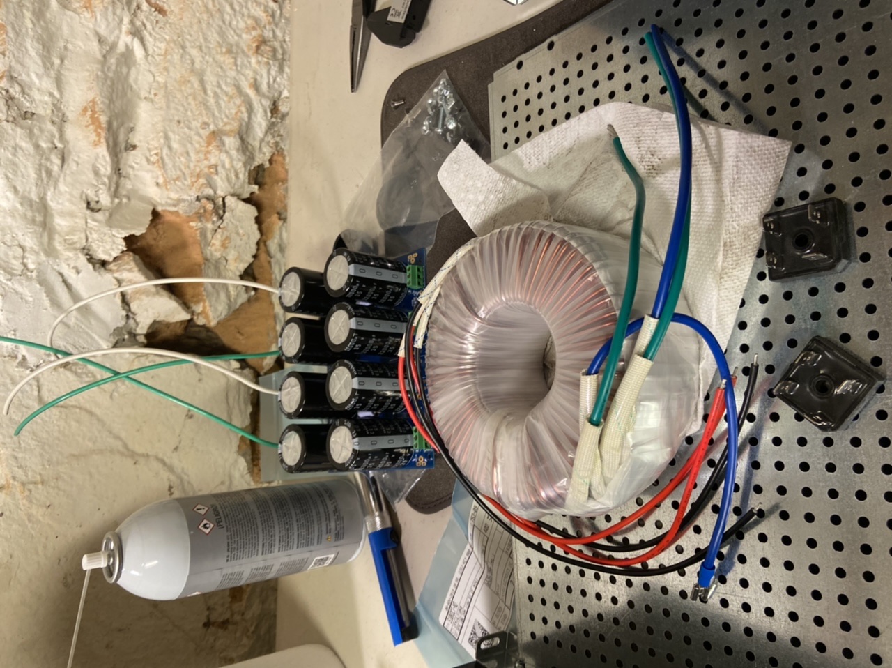

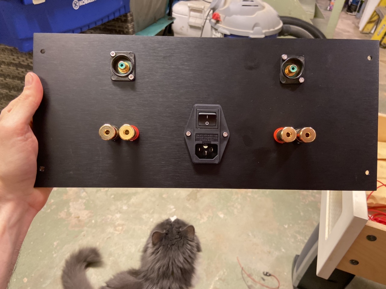

I have decided to mount the filter cap board to the faceplate rather than buy an L bracket for the transformer.

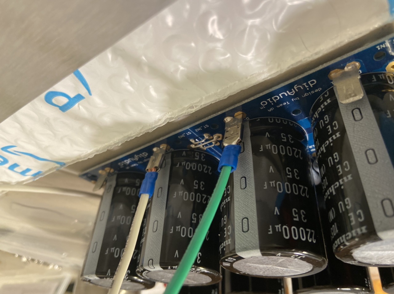

I have a couple more questions..

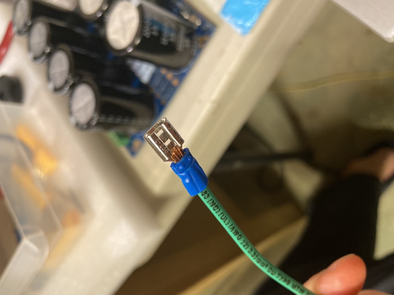

I have a ton of different color 18 gauge silver plated copper stranded wire.. and 30ft of black 16 gauge wire. I have wired up the mains -> switch -> C-60s -> transformer -> rectifier -> cap board all with 12 gauge wire using crimp on female spades.
12 gauge wire won't fit in the amplifier board holes. Can I use 18 or 16 gauge wire to connect the filter cap board to the amp boards? It seems a little flimsy after wiring everything before that with 12 gauge.. I suspect 14 gauge is the largest that would fit in the amp boards... but I don't have any of that.
Also, I've never wired a transformer before. Is there any safety I need to know about dealing with them? I know that I'm not supposed to make a circuit around them with the mounting hardware. Anything else? It seems like the plastic they are wrapped in is kinda flimsy and a little bit of wire metal is showing through in one spot.. It's on a part that will eventually be covered up with the rubber mounting thing.
Finally, do I need to use any kind of thermal paste for my monolithic rectifiers on the base grid?

Just down the road in Salisbury - Toroid Corporation > Products > Mounting & Hardware > Vertical > L-Bracket Mounting the PSU on the front can lead to some noise issues that can only be fixed by moving the transformer to the front...
A little thermal goo is helpful on the bridges, but not strictly necessary.
Transformer mounting is straightforward, use the rubber pads as you surmise. If you think you have a thin part in the wrapping, place a couple layers of good electrical tape on it.
Wire - make what you have work or go buy the right stuff, there’s no wrong answer.
The peeps at Toroid are really nice. I grew up outside Balto and still head that direction on a regular basis—I'd definitely see about a visit and get and L bracket. ~$10 for the largest one. If you use the L bracket make sure the toroid doesn't touch the bottom of the bracket when you mount it.

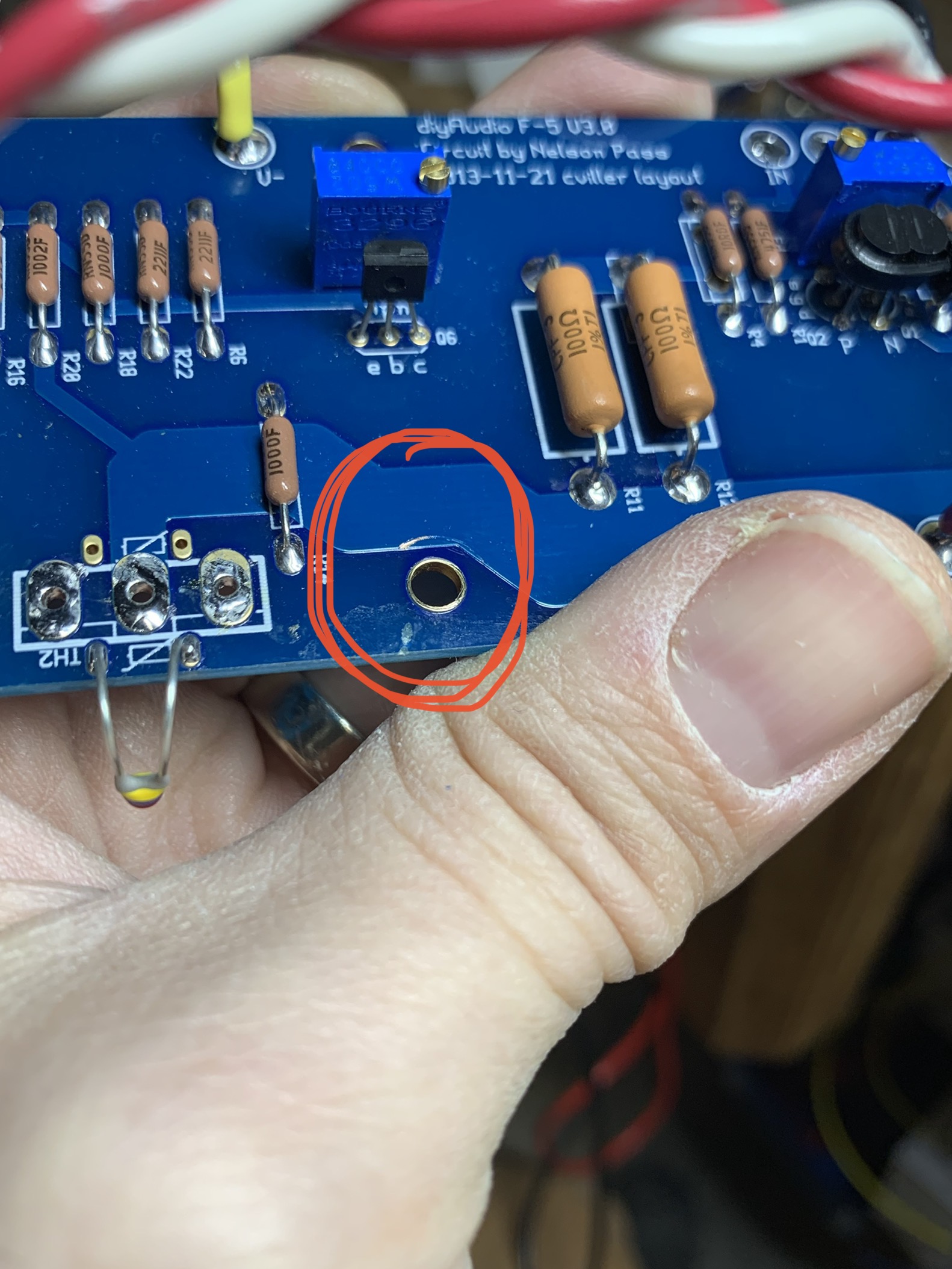

Per this previously unresolved issue—I don't like not having answers and everything "looked" fine... But I found the answer to this catastrophic short... See pic. This after taking the board out and cleaning it and testing the mosfets (roasted)....
Careful with your washers!
Yup! I used nylon washers elsewhere, PSUs and AJ build.... Certainly made the connection now—no pun intended—well... maybe
P side shows a little scrape through too...!!
I'll have it back up and running sometime next week.
I'll be checking mine now! I did only use the corner holes. I can see how having the full output shorted would blow it up. Did the Jfets survive?
After reading endless forum pages about ground loops (or some kind of loops) it has been made clear to me that my transformer should be in the front of my amp so that it's not in the middle of anything else. This avoids potential hum. L bracket ordered. If I could do it again, I'd do what flamethrower did and order the 3U 400mm deep chasis and buy a set of good M3 taps.
Nylon washers:
https://www.amazon.com/dp/B07MXBZZN2/ref=cm_sw_em_r_mt_dp_U_Gx3fEbQS1KRWY
Not sure about the Jfets—and they are the not cheap Toshiba's—replace resistors and mosfets and see what's what.
