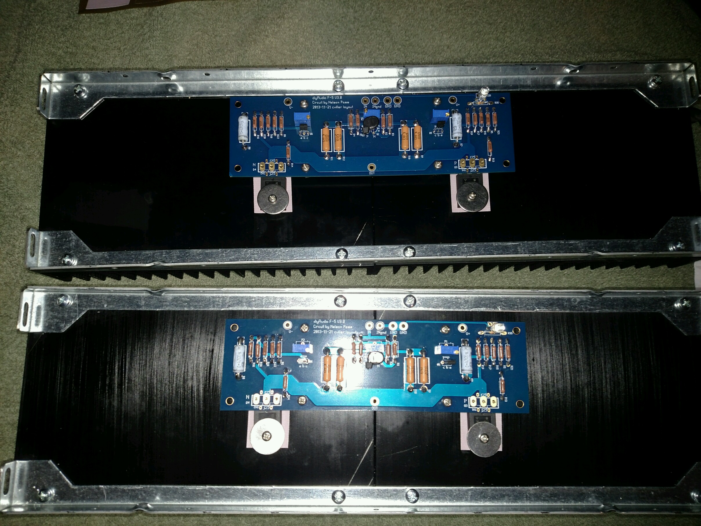

Progress so far.
Got one board quasi mounted.
The standoffs were ordered from Amazon as the DIY store had the kit back ordered.
Ordered two taps from MC, had to turn one into a bottoming tap and still had to file some of the threads off to get the shoulders to seat.
I used the shortest stand offs so the screws in the kit were a little long, that is why I used the nylon spacers on top of the boards.
Anyway, before I solder the Mosfets, do I put the Ktherms under them and have them secured?

Get enough space between the Mosfet and the board otherwise they may get in contact with some other soldering.
The keratherm "only" has been reported creating problem, being too thin the mosfet get in contact with the heatsink. That's why I placed ceramic pads + keratherm, doing so I needed to elevate the PCB of, at least, the thickness of the ceramic pad.
Keratherm alone is the generally recommended path , only problem when using keratherm is not to be too heavy handed and tear through the pad making contact with the heatsink below. Be sure to gently burr out the rim of the hole that you drill and tap. I use very fine sand paper to clean up the spot first too ( just in case there are small somethings sticking up )
I would recommend a fitting them to the heatsinks with keratherm in place prior to soldering - making sure your alignment is good before soldering.
with all that said - my M2X gave me major issues while sissy and aleph did not (from a heatsink shorting perspective. )

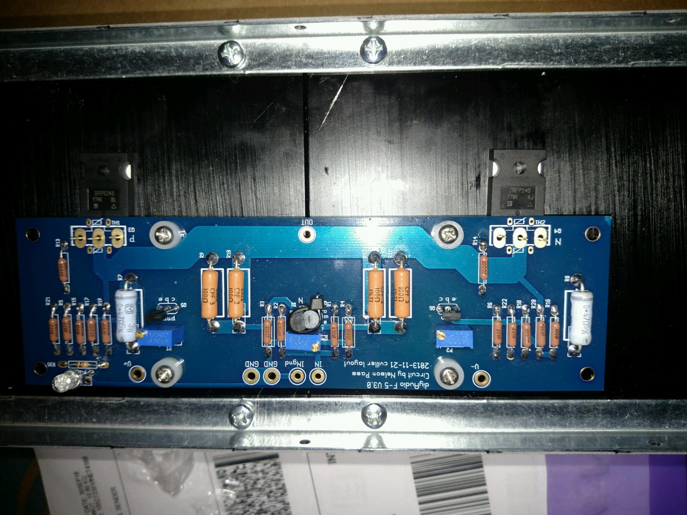

If you can get your hands on a small torque wrench with inch/pound settings (or the equivalent metric scale) you can accurately set the torque. The max recommended for the mosfets is 10 in/lbs. I used 10 in/lbs on my V3 monoblocks and have had no issues. These are my daily driver amps most of the time for the last couple of years.

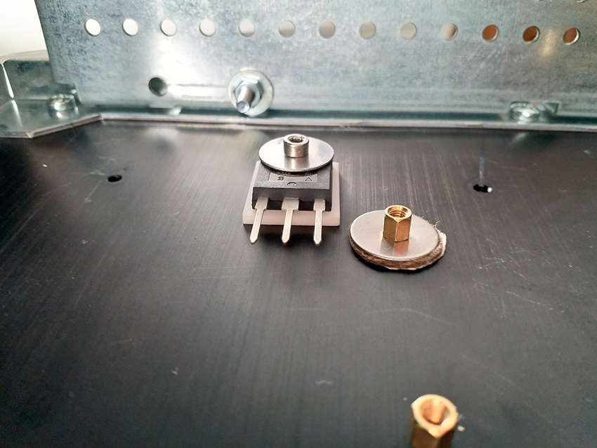

F5 BUILD
Got all of the holes drilled and tapped, that was a quite a process in its self.
Checked and double checked my 240's and 9240's many times.
The washers for the MOFSETS are a little bigger then I have seen in other builds, only ones I could source locally.
An easy way to de-burr is to go over the hole lightly with a much larger diameter drill bit in the drill, doing a very shallow countersink - much easier than sanding.
Large washers are good. They distribute the clamping pressure over a larger area of the MOSFET, providing better contact for heat transfer to the heatsink.
Thanks, will add the split washers and I did de-burr the holes prior to mounting the Mofsets using a larger drill bit as described making sure the Ktherms were not compromised
The big washers look cool!
6L6—I thought there was a little drama about the thermistors touching the washers vs the mosfet body? I've done so much reading, but if I recall, it was ZenMod that wasn't a fan of the touching-washer approach—and he had some specific reasons....Is that the ultra-purist approach? I've also read about some "flaming thermistor" experiences... Dunno if that's related.
When I DID NOT understand my 240s vs 9240s—and got to experience that funness—I redid it all and used a smaller washer second time around and had the thermistor contact the mosfet body...
What's the "official" explanation here, if there is one... (I'm looking at you next build).
THX!
NTC , scratch it and you'll get exposed resistor body, thus enabling contact with outer world
not one F5 end in smoke because of that
conclusion - lean it on isolated mosfet case and chill
